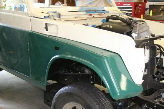

Ok, I've got a few questions after another thread perusal.
First, the rocker extension below the front fender. I see a benefit from a protection standpoint, but are there others I'm missing?
How do the fenders terminate at the joint?
I'm thinking you purchased this way, so the typical...
"what would scrapdaddy do?"
doesn't apply, so curious if you'd do it this way, again?
Other benefits beyond a full length slider?
Think the body will flex enough off road to be an issue?

I don't think you've reached this point yet, but on the upper to lower fender joint, are you going to tack or drill and bolt it?

The rockers were put on by Gary the PO. He got them from Lance at IPOR. The rockers are very thick and take the place of sliders. They extend up to the front wheel well. The front fenders have been cut and a lip bent into the bottom edge. I will drill and tap the rocker, so I can bolt down the fender.
I've often thought about adding sliders under the rockers, but like the stock look.
Edit: If this were going to be a more off road capable vehicle, it should have the sliders under the body, just for better protection, but I can't see any body flex issues the way it is. I'm not out to climb over big rocks, I'll go around.
When I put the two fender pieces together, I will use seam sealer between the halves and bolt together. Then final paint will be sprayed.

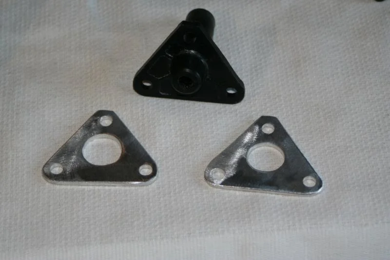

When I took the wiper arms apart, to be plated and found cracks in the black plastic mount, that bolts to the body and connects the wipers. I shattered one, while disassembling it. So, I needed to come up with a fix to keep the plastic together, as I'm sure that part is long gone.
Here's one attempt, alum. plates on each side and then epoxy them all together when bolting up. I made some out of 16 ga. steel, also.
exactly what I had planned to do with mine;) keep it up:cheers:
...one step further...grease the bolts, bolt inner and outer plates around plastic bases, and fill in between the plates around the perimeter with expoy- maybe even spread a layer of the glue on the inside faces of the plates; thus putting most of the torque load on the plates and bolts. those plastic bits ARE brittle. FWIW, a late pig W/W regulator will bolt into a 73 cowl- NOT sure about the earlier ones and the later ones are still on shelves at SOR, so you're not SOL, FWIW. YMMV. HTH:hillbilly:

If I had a little metal lathe, I'd make my own, but I don't, so yeah I'm epoxying it all together and call it good.
