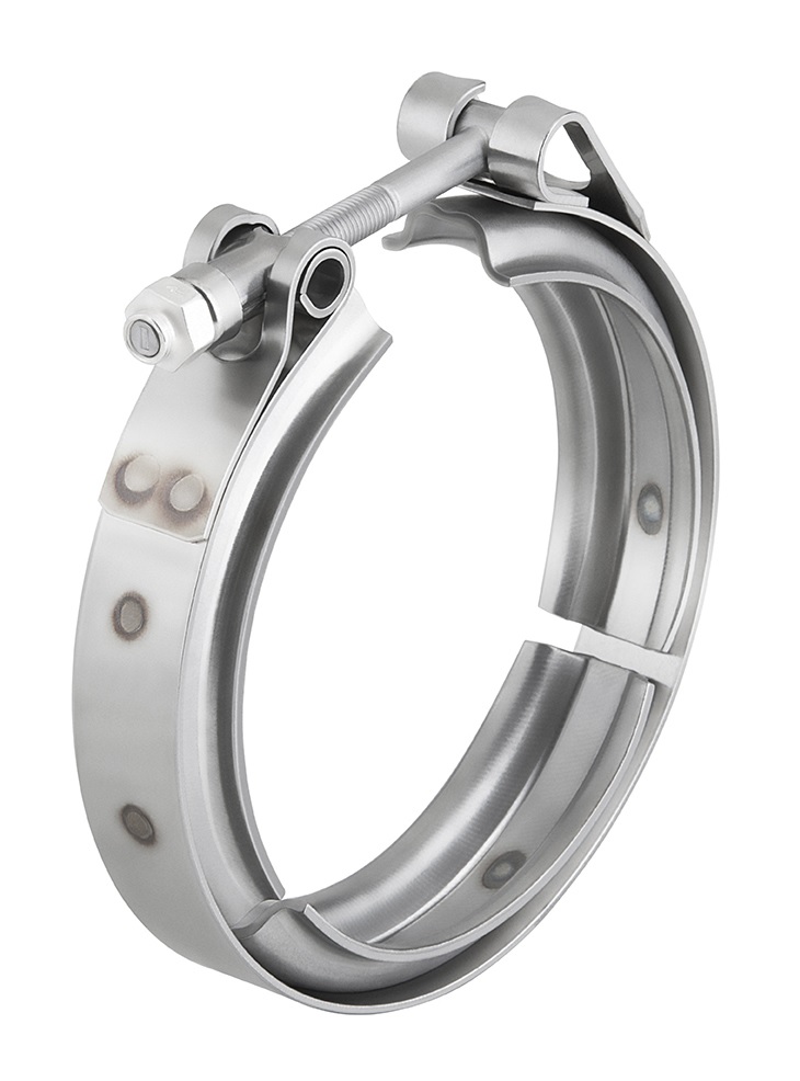

Both Copper and REMflex have suggested torque range get it wrong or have a fastener loosen up and they will leak but honestly this should be the easiest put of your day. If you are going to used standard hardware and give it a couple Ugga Dugga’s and forget about it then V-bands might be in your future but they aren’t completely problem free either so I would give it one last good try.
