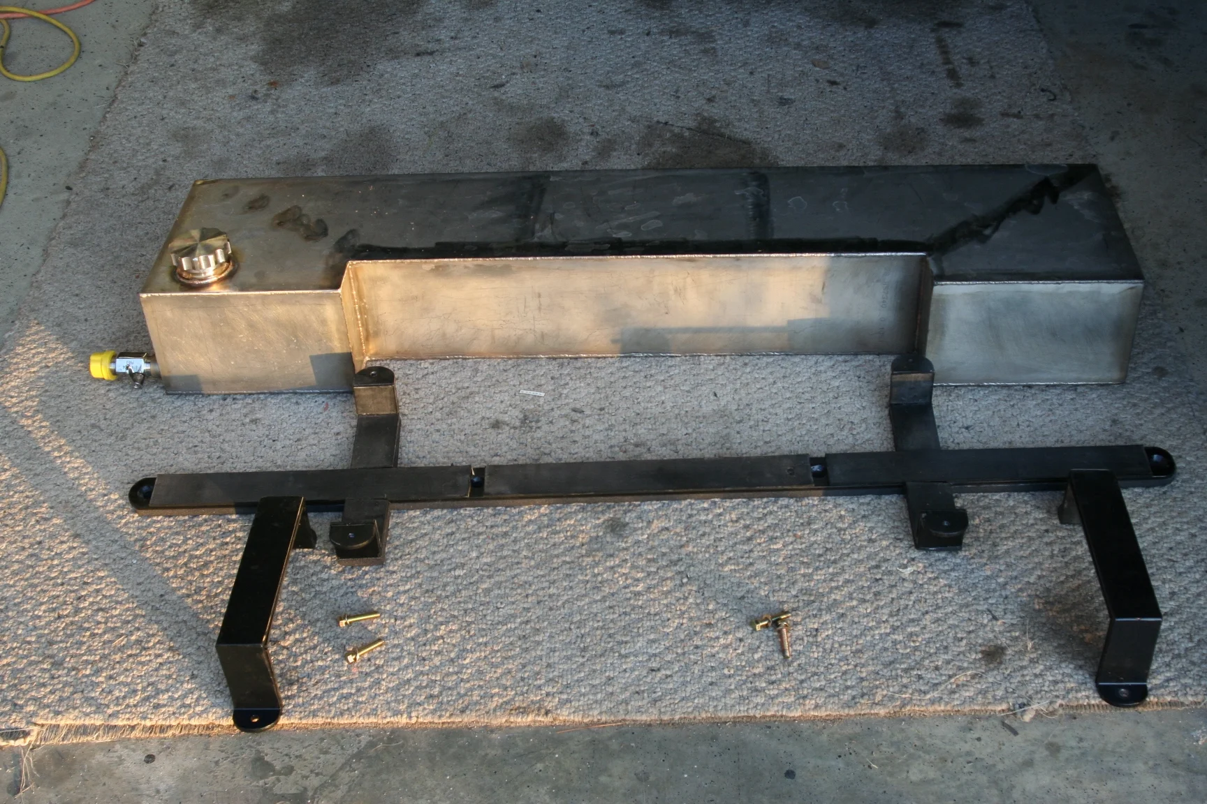

I'm finished with the water tank for now, but strapping it down was a concern. I needed to use the four holes in the floor that were for seat belts, so I came up with this. Everything has neoprene padding so as not to rub a hole.
