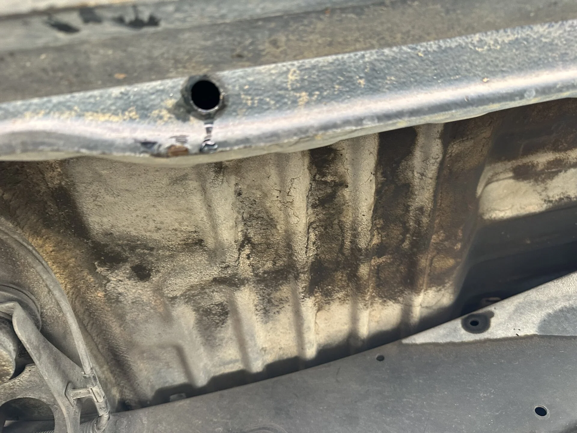

Driving during some heavy rain over the last few days, kept hearing a sloshing sound as I pulled to a stop or accelerated from a stop ( if you can call it accelerate). Thought perhaps the doors as the window seals are not good. Checked the drain holes and all doors dry as a bone. It was the drivers side sill pulled the rubber plugs on the bottom of the sill and about a quart of clear water ran out.
Any ideas as to where it comes in from?

Any ideas as to where it comes in from?View attachment 3449852View attachment 3449854
It's absolutely coming front sunroof drains; that's where they drain in to. Make sure the pinch weld drains are clear. If they're not, you have to remove the plugs to drain the rockers. You can use a zip tie to clean them.

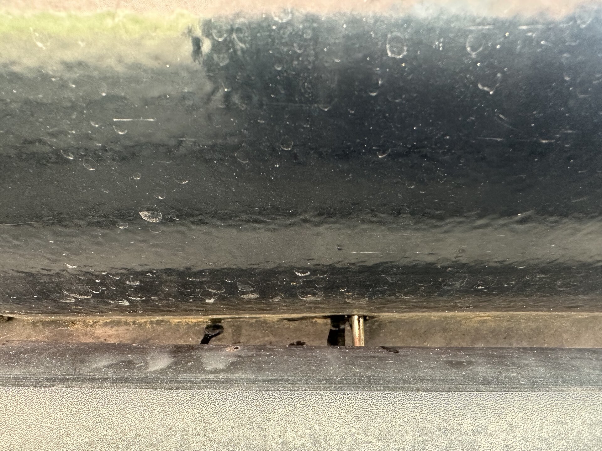

What is the 2nd pic a pic of??
It’s a view of the drivers side step, and the space between where you can see the vent.

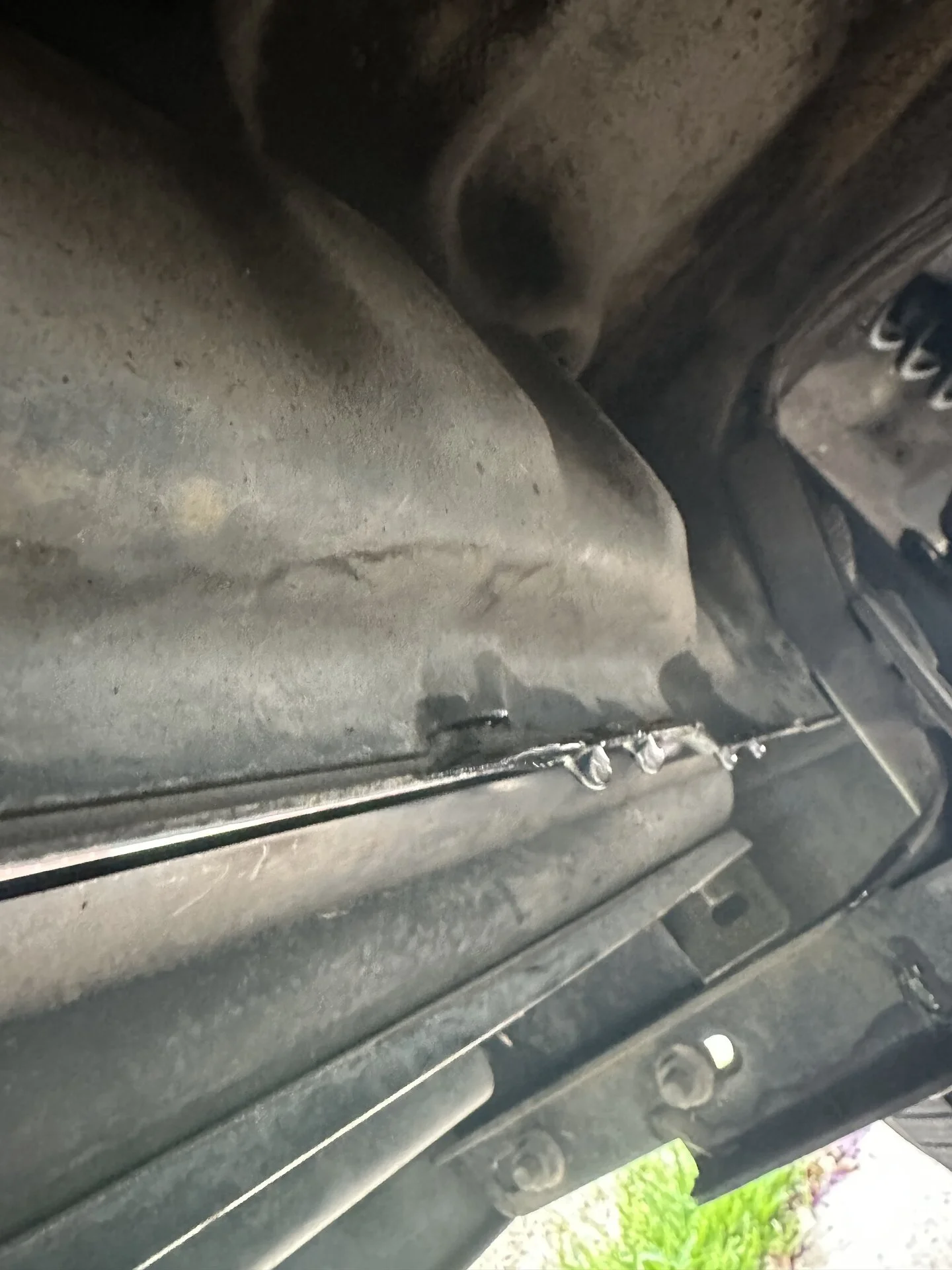

Flushed some water from the sunroof and it did dribble out the sill, although slowly. I found the vents on the bottom of the sill and used some soft wire to poke around. A bit of dirt came out. So I pulled a small rubber plug on the underside of the sill, removed the plugs and used a garden hose to rinse out the sill. Some dirt came out, and water flowed much better. replaced all the plugs after squirting some fluid film around inside the sill. Thanks for all the feedback. The sill has three of these vents along it’s length.
Flushed some water from the sunroof and it did dribble out the sill, although slowly. I found the vents on the bottom of the sill and used some soft wire to poke around. A bit of dirt came out. So I pulled a small rubber plug on the underside of the sill, removed the plugs and used a garden hose to rinse out the sill. Some dirt came out, and water flowed much better. replaced all the plugs after squirting some fluid film around inside the sill. Thanks for all the feedback. The sill has three of these vents along it’s length.View attachment 3452508
The water should not dribble out, it should run out. If it doesn't, the rocker drains are plugged. Whatever you do, don't put those plugs back in for at least a week, even if the drains are clear. Do not use any metal to clean those drains; you'll scrape more paint off than is already missing. Use a zip tie.
FWIW, mine were out for a year until I rerouted the front drains.
Got it. I used a plastic covered wire so it should be ok. Plugs out and will blow some air into the sill. Pax side is good, water flows freely.

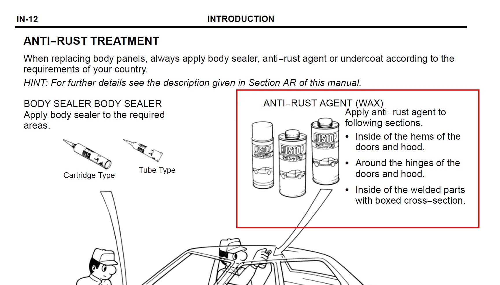

You are correct:
This is from the collision repair manual. It's in the 80 series Resources section.
