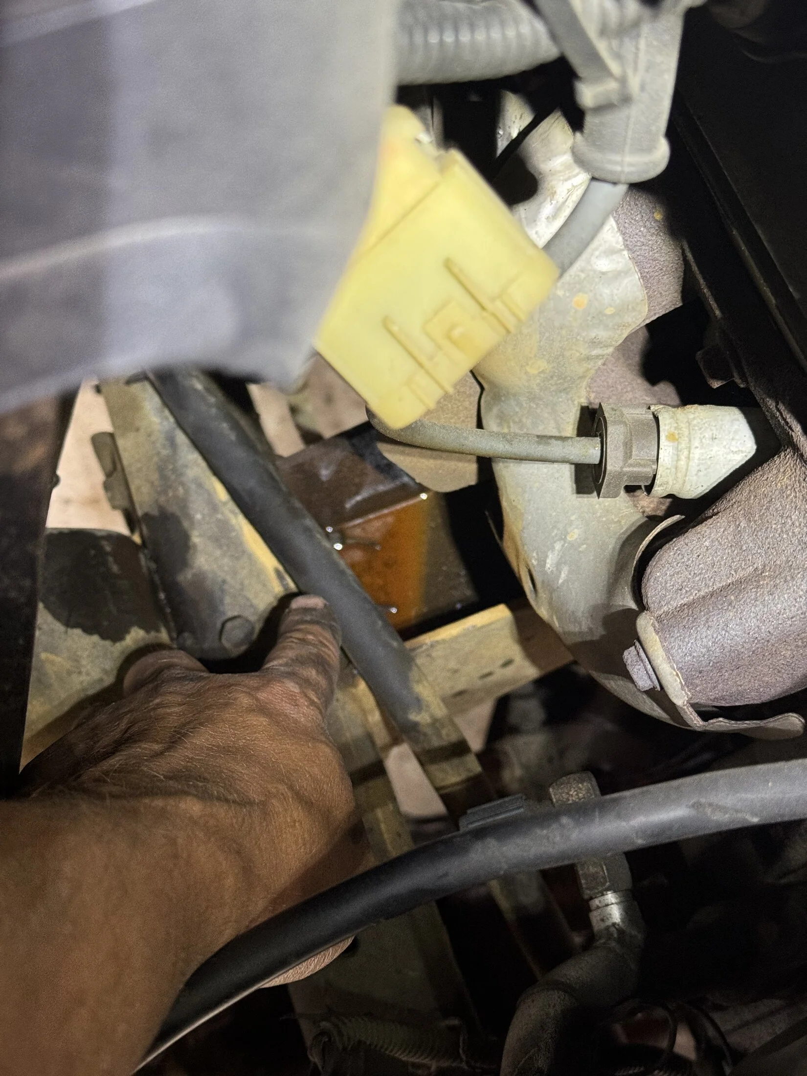

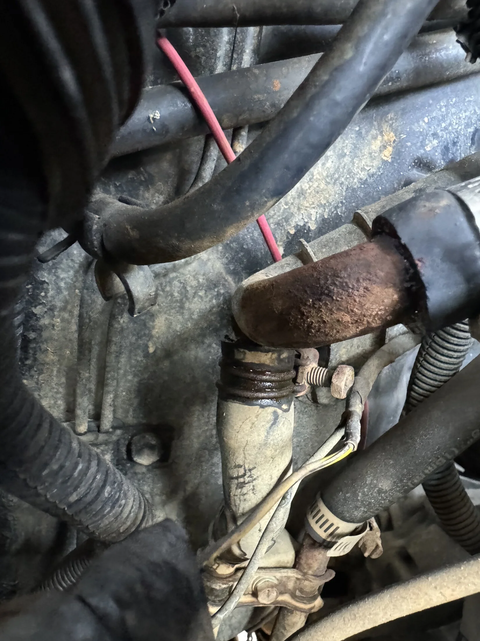

So did some digging around under the hood today. I was losing coolant and noticed a spray pattern under the hood and on the firewall, turns out one of the heater hoses was getting dug into by a hose clamp.
I repaired that and another heater hose that was ran in a way that was going to end up with a puncture. After that I bled the system but oddly enough I. Not getting hot air out of the front dash. It has to be a door blender issue. As I can touch the heater core and it's hot and the rear heater works. Everything seems to moving correctly when I move the levers but I think internally the blend door is not ending up in a way to direct the air thru the heater core. When switichng between hot and cold the air temp only changes ever so slightly. Luckily I intend on ripping apart the whole interior and will figure it out then.

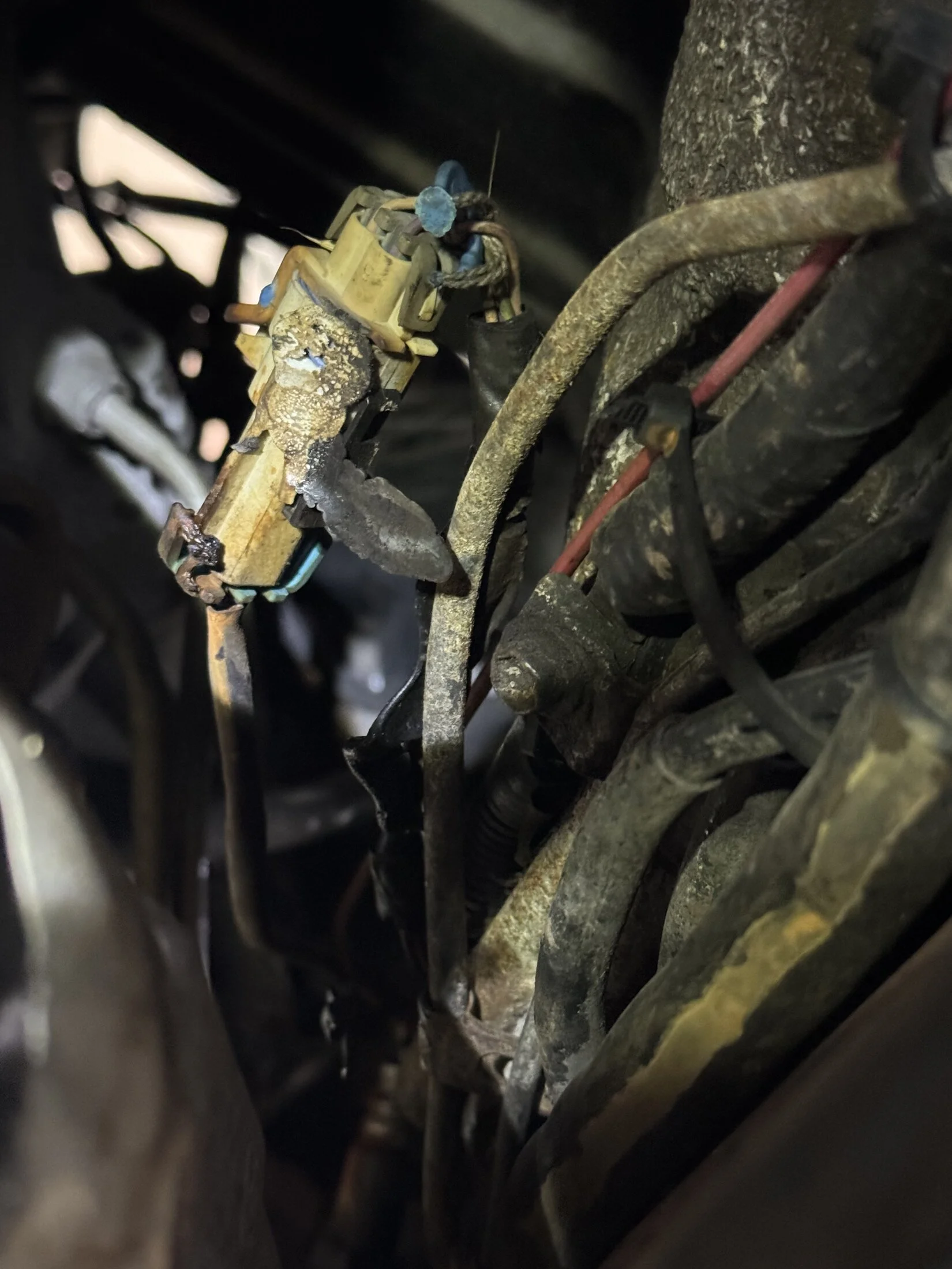

Then I started chasing some random.cables that were run super extra funky and noticed that they were essentially sitting on the catalytic converter. I yanked out what seemed to be wires for flat towing and set the almost melted o2 sensor plug out of the way. Good enough for now.
These were the flat tow wire for lights. Super large wiring. I think it was a home type wire loom.

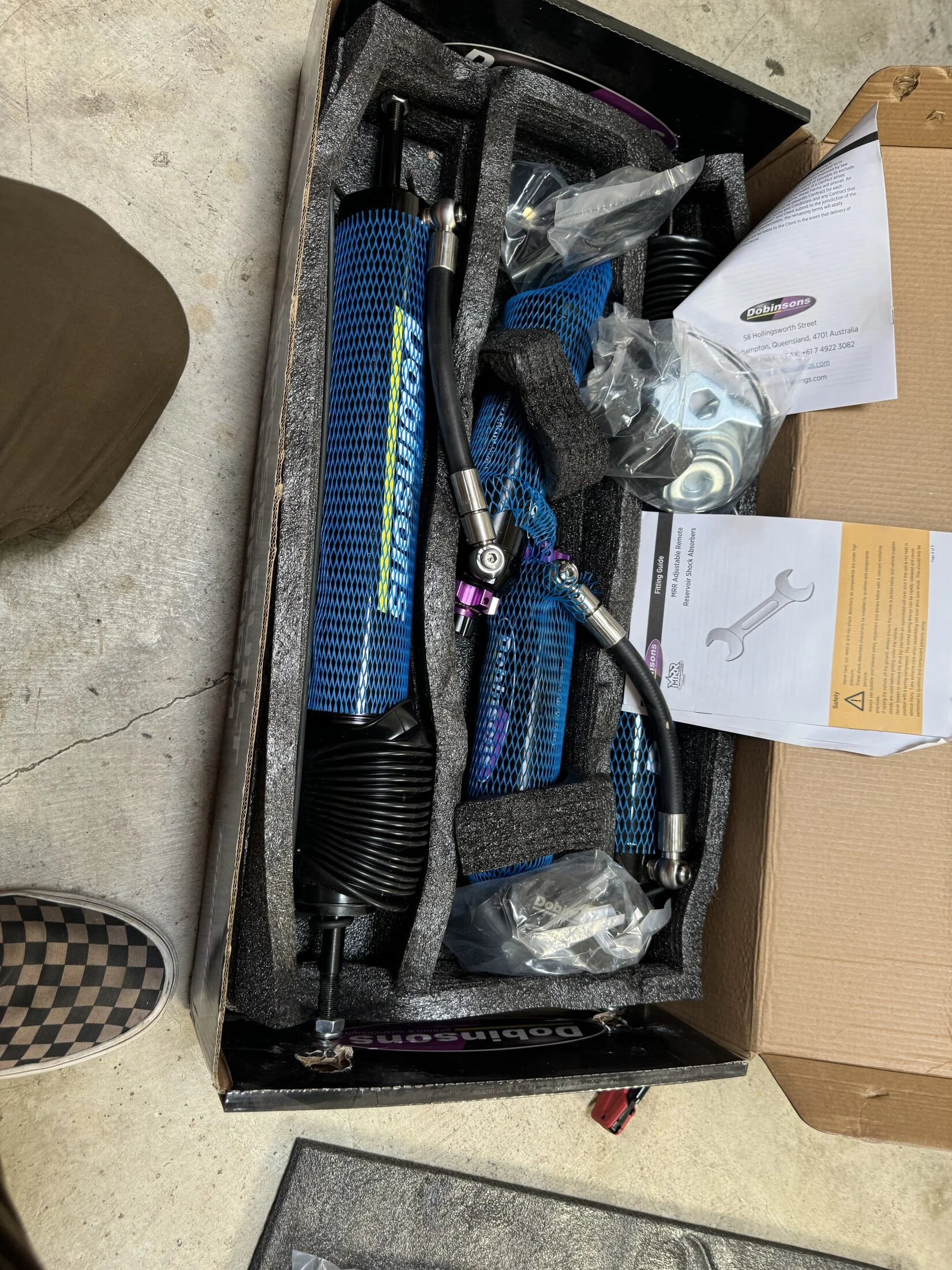

Next steps are to get 80axles home and start the rebuild on them. Waiting for a couple different quotes and hopefully will have parts in my hand sooner than later. Then I can get to work on doing the front coil swap.

Mine leaks from time to time there too. I REALLY need to get some new OEM clamps. Looks like you do too.
Dont take this as like factual, im just saying this out of personal observation, but i feel like the GM water pump pumps at a higher PSI than the 2f or 3fe does or something... which means more pressure in the hoses. The radiator cap on the stock 5.3 is like around 16 psi or something. I believe the Rad cap on the fj60 is 13psi.
I know i have a high pressure radiator cap on mine ( 29-31 psi) to try and raise the boiling point of the coolant, and its blowing the seals on a few of my clamps. ESPECIALLY the rear heater hoses on the underside of the truck and the ones in your photo. Im getting to the point where i might just delete the rear heater to not worry about it anymore
Maybe its the radiator cap, but ive talked to a few guys with ls swapped 60s that have some hose leakage here and there. Especially on the rear heater stuff

I might give those a shot, im going to toss an 18 psi cap on there first to see if it helps any haha i feel like im way over pressurized
I think I have a 15psi but my test runs are super short
FSR Said my cap was a 30 lb cap but I just looked and its stamped 20 on the top. 18 is like 6 bucks so im going to give it a shot
You guys see the top of his radiator looks like the cap or something has been leaking for a while or is just me?
Just went back and looked and youre right. I cant tell if its coming from the cap or from the overflow hose but its for sure leaking quite a bit. Might be time for @Lucky1386 to get a new cap as well.
