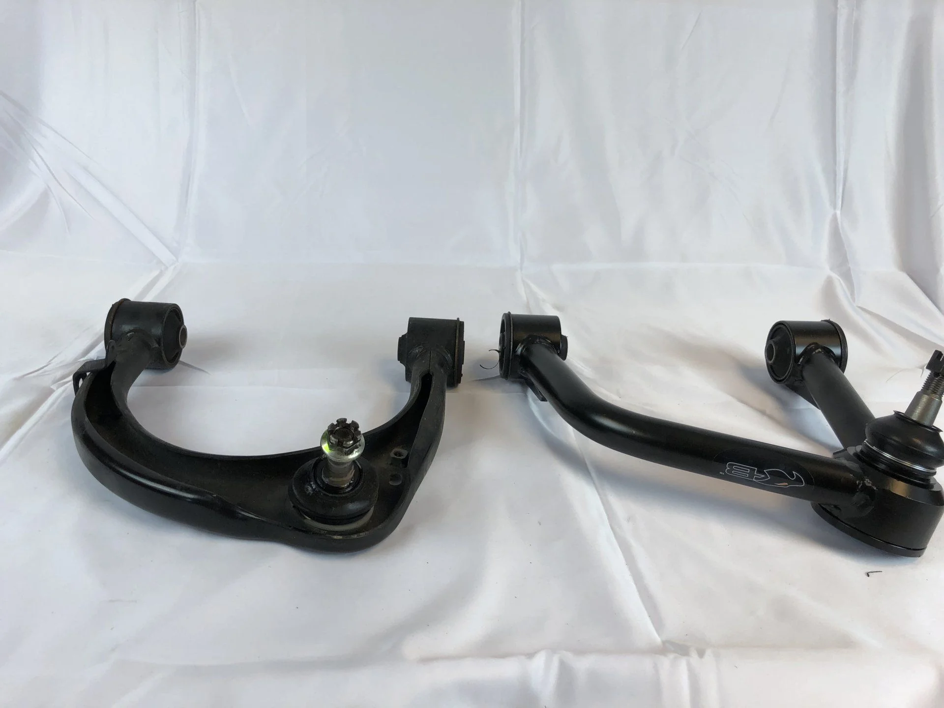

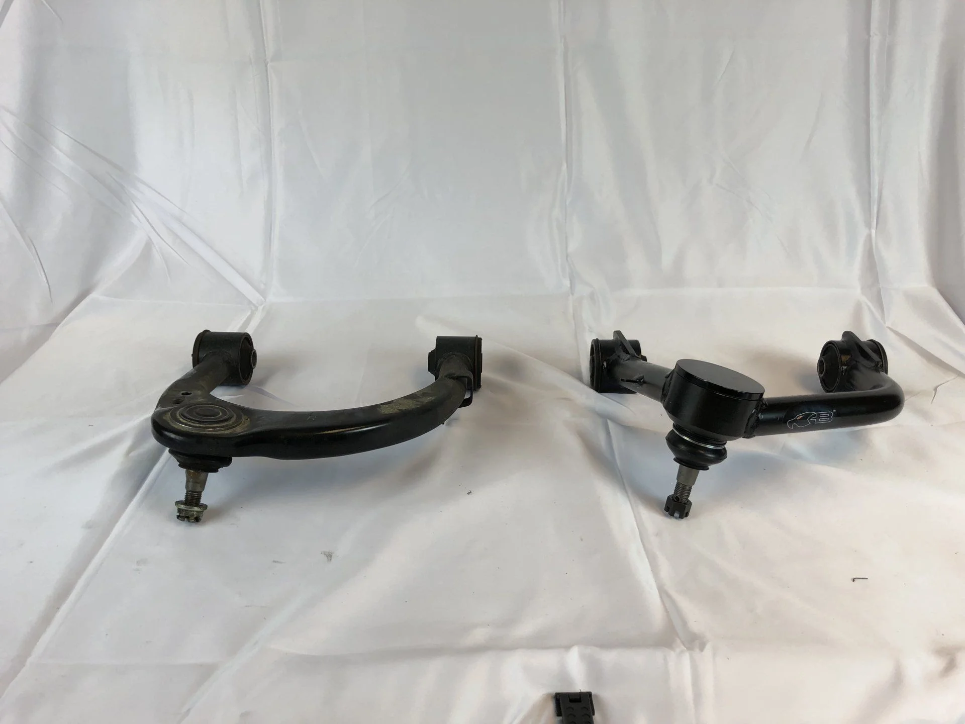

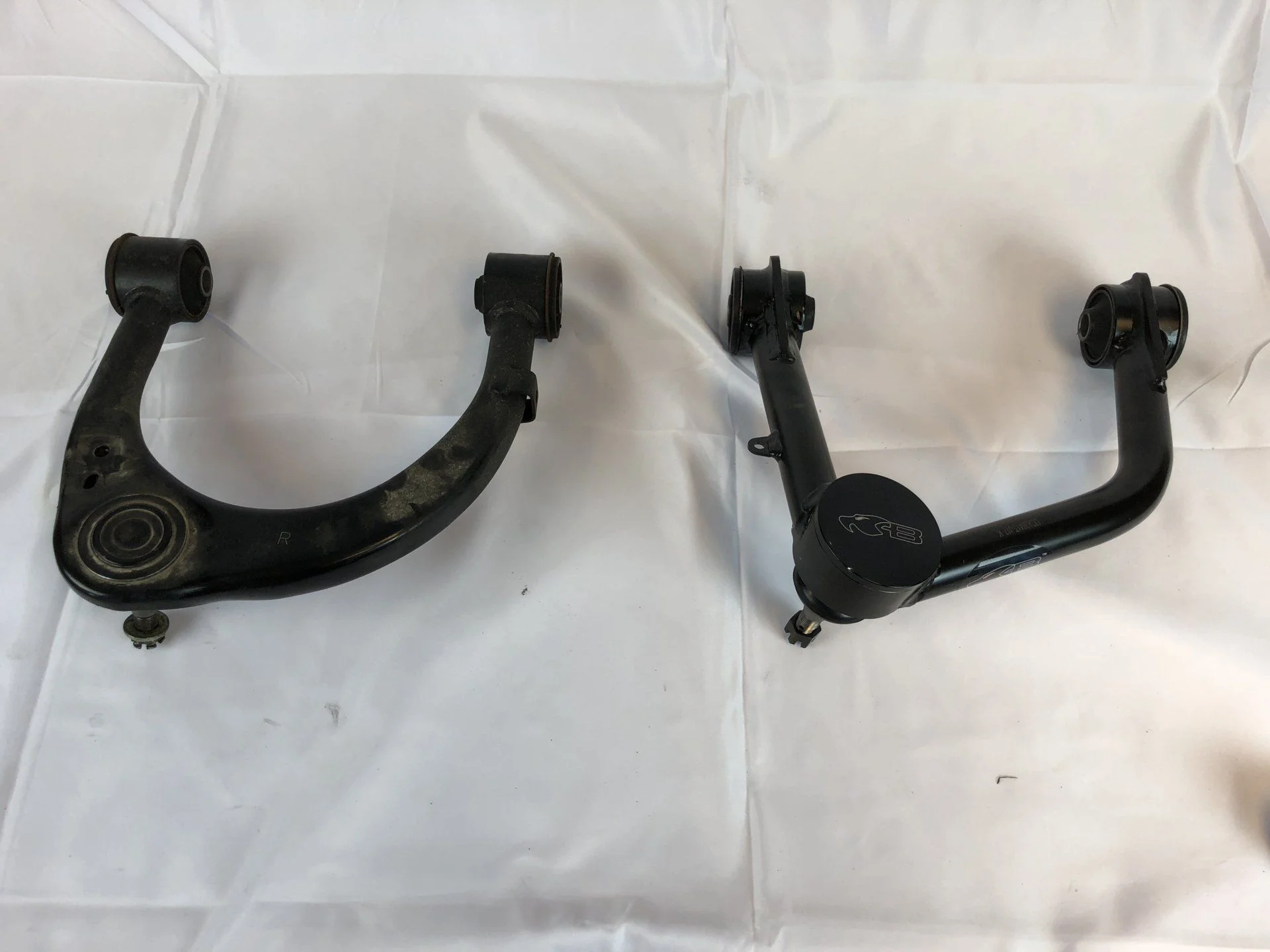

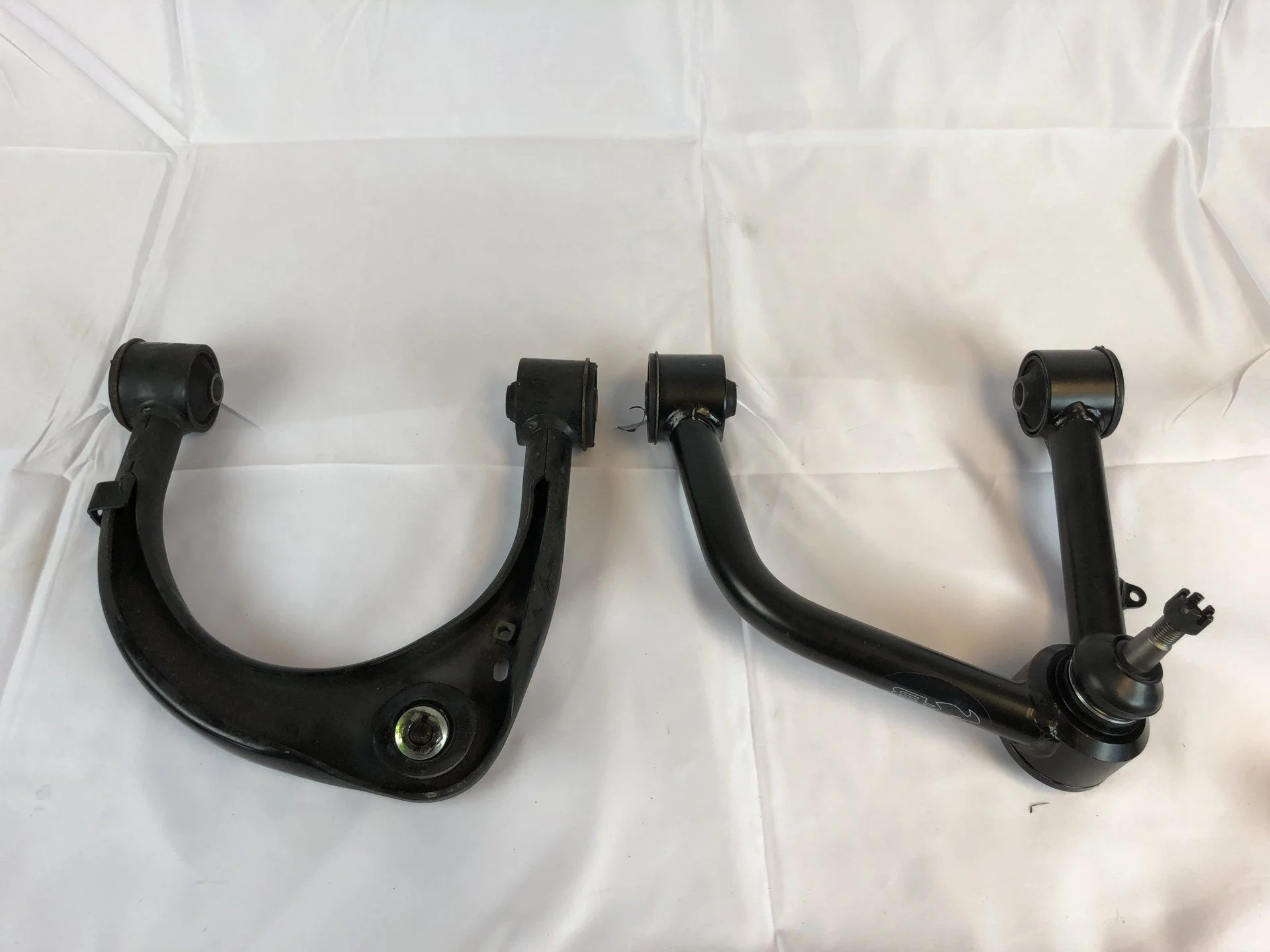

@dockbox those UCA's look very interesting. I've been reading many people's experiences with aftermarket UCA's and the blackhawk appear to support all the features, that everyone laments not having. Do you have any pictures of these next to an OE UCA for comparison? Also, I'm going NO higher than 2 inches with my suspension lift. Will these honestly be too much?
These should work great with only 2 inches of lift. Normally, you lose caster when a vehicle is lifted. These have built in 3 degrees of extra caster, but shouldn't be too much as there is still adjustability to dial in the proper alignment.
