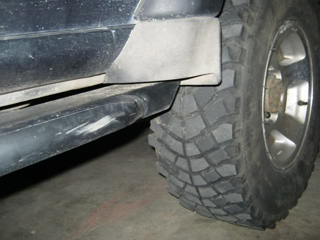

Yes, they will work. I have FJ80 front mud flaps on my FZJ80. They were on it when I bought it. They work, you just have to drill 1 hole in them to attach to the wheel well. They work well & are also several inches shorter that the FZJ80 flaps which helps keep them from getting ripped off by terrain.
I trimmed them to fit my Metal Tech sliders. You can make a cardboard template and trim it until it fits nice. Then transfer the cardboard template to the flap and cut away.

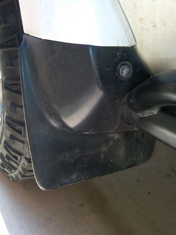

I've been happy with the step sliders as they are very easy for the family to use on a daily basis, plus they are built stong and offer great protection. I had them built with some tabs welded to the bottom front and rear so I could use the high lift on them with out it slipping off. I did try it and they worked. I did get some minor flex of the step rail pushing up but it worked to lift the tire off the ground. We have a RTT and these sliders are nice to stand on when setting up camp. Attached are a couple of photos of the slider and mud flap. I used some old flaps and drilled holes to allign with the holes used to hold the factory flap in place.

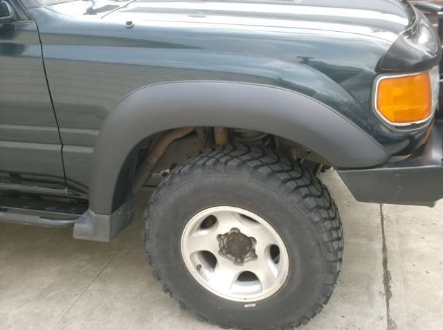

I trimmed the factory mud flaps to work with Slee's "Step" sliders,
I then added some welting around the area I cut, to give it a more finished look.
CDFarmer nice fit to the mudguard. can you post a couple more pics from the side and rear?

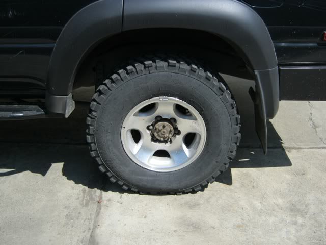

These are my bump it offroad sliders, I need to get them tack welded because they will move (but not bend) when you bash on them.

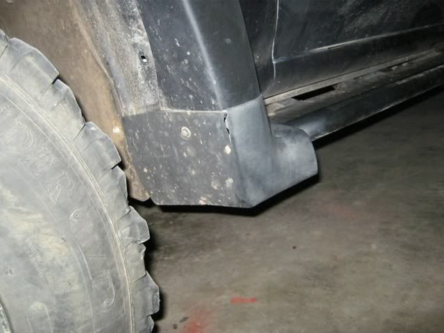

I used the stock front flap that is meant for stock running boards and used a heat gun to mold it around the 2x6 sliders. It came out pretty good.

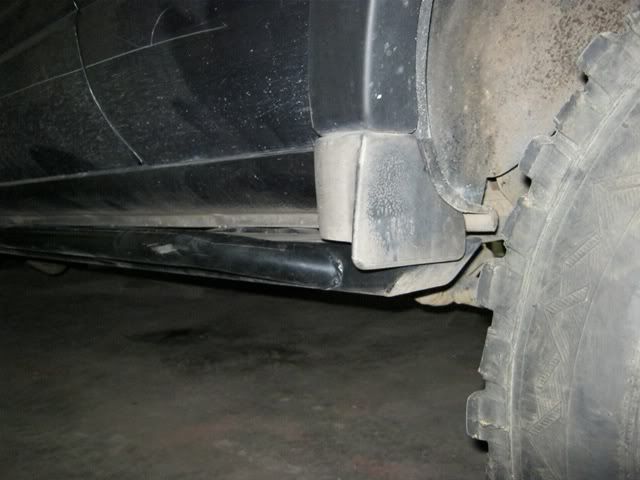

Slee sliders. Non-running board (non-USA?) Toy mudflaps from Beno. Trimmed flaps to fit with shears and sharp utility knife.

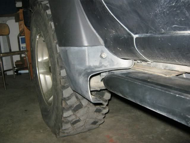

Here are my new Metal Tech sliders. Got them on the current sale. :bounce:
I got the mud flaps on, but had to cut a rectangular hole in the front of the mud flap to fit over the front edge of slider. You can see where I had to open the flap in the second picture.
If the slider was just about 1/2" shorter, the mud flap would fit perfect.
These things fit so well, I was very impressed with the fit and finish.
