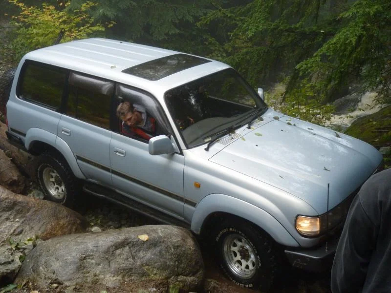

'Cruisin sliders, no mud flaps though, I should really get on that one day and put them back on.
That last pic shows my door dent that not even the 'Enigma approved' kick out could have stopped, 'twas a rather large rock ;)
