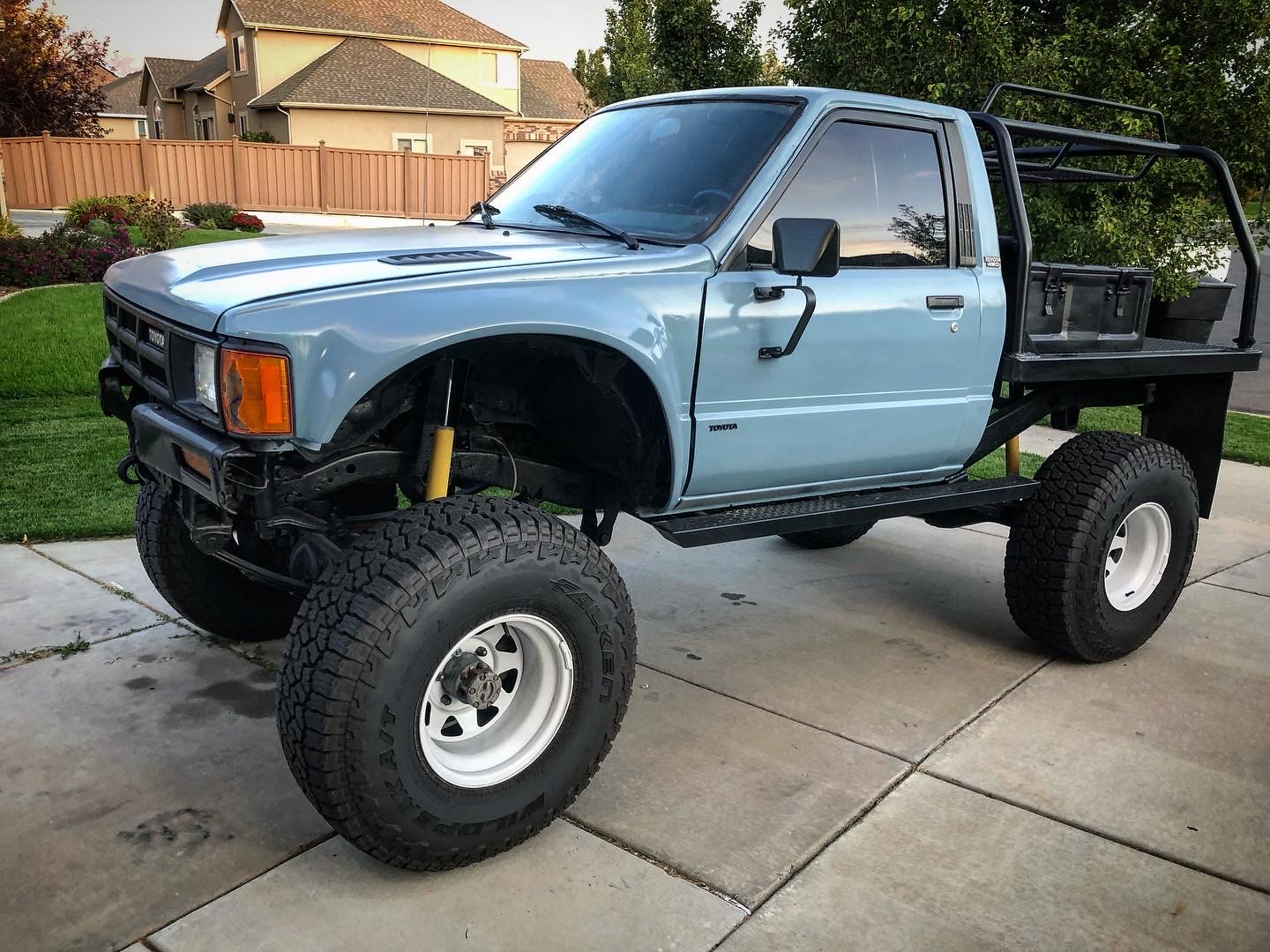

Rectangle tube sliders work well as a step and can be great sliders too. They are strong and the flat surfaces slide easily on obstacles. We made rectangular tube sliders for both of my son's minitrucks. Their trucks will get wheeled hard and needed a strong slider but also needed a good step because the belly height of the minitrucks is very high when the trucks get lifted.
Untitled by Adam Tolman, on Flickr

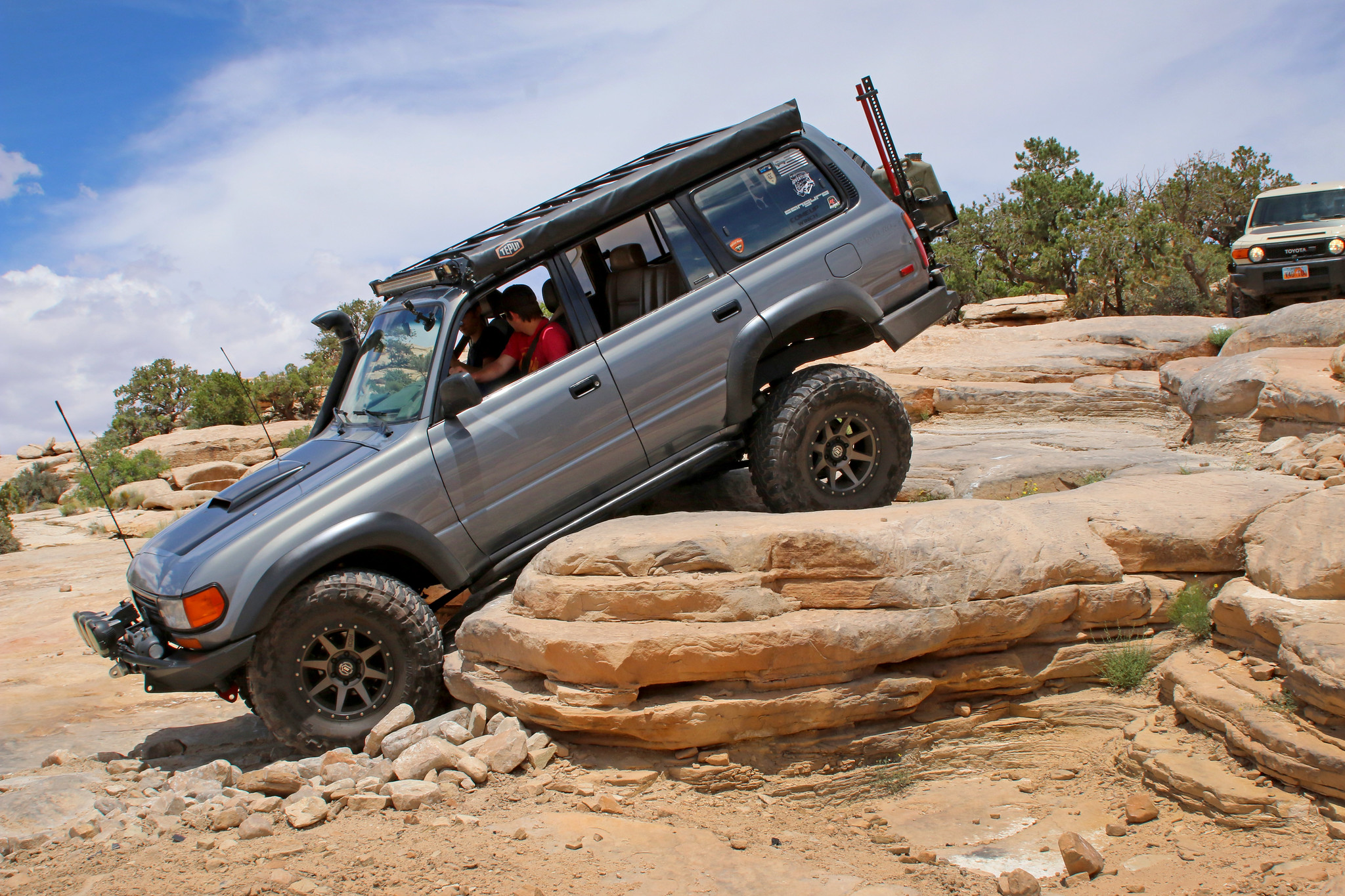

I have had Trail Gear tube sliders on both of my 80s for almost two decades now. Yeah they require a bit of custom fabrication to address the front leg of the sliders and fitting them around the exhaust but otherwise they are easily the best bang for the buck sliders out there IMO. I have beat the snot of of both sets of mine and they have never dented or bent. I'm not tall so I use them as a step and my wife who is 5'3" definitely needs to have them as a step.
IMG_3250 by Adam Tolman, on Flickr
