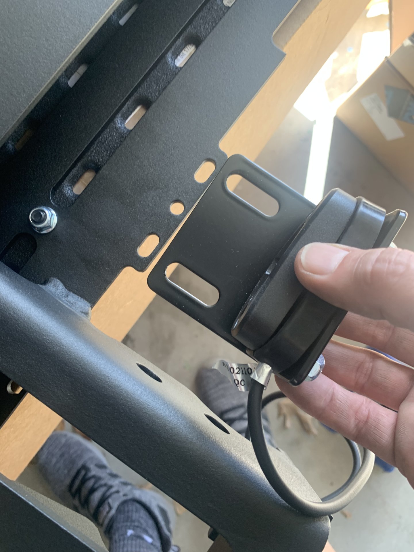

The lights shoot out sideways and not down?
sideways.. but you still get a lot of light.
interesting! It could be the camera angle, but do they hang down below the slider mounts? As in, they may get knocked off on a scrape?

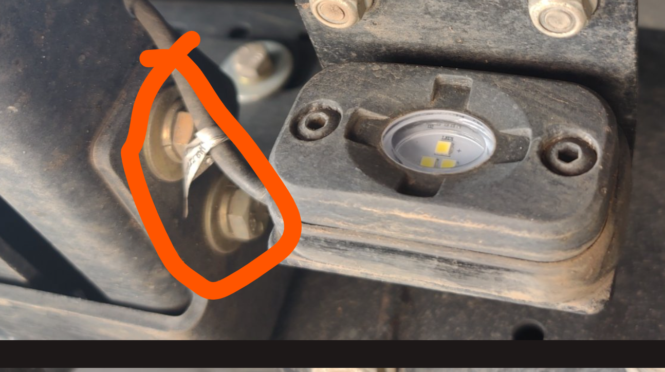

Photos are of my installation
Any reason you have lock washers on the bolt side?
I think it may be the angle. They mount from top of slider, so don’t end up below. No comment on his lock washer placement.
Nah they are all tucked inside the step.
No idea. Ask SLEE. They did the installation.
Interesting!
I always thought the lock washer went on the nut side. Maybe slee knows something I don’t. Or maybe the intern put your sliders on 😂😬🤷🏻‍♂️

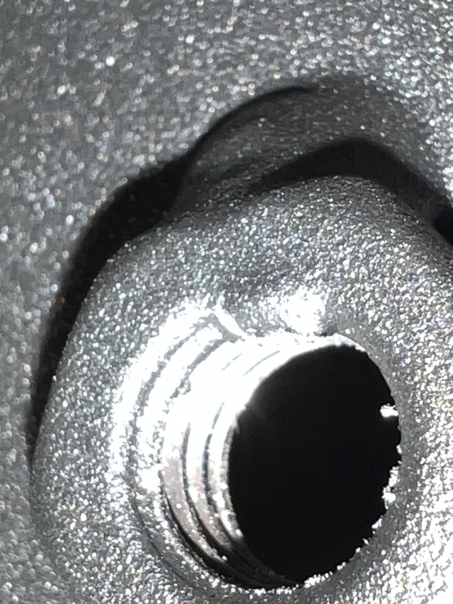

I was test fitting all the things when I noticed one of the bolts wouldn’t thread into the captive nut on one of the arms.
At first I thought, “no big deal, maybe some power coat stuck in there.” But it was a much bigger chunk of metal. I send these pics to Slee, and they respond back with “tap the nut.”
And then I responded back with, “Please verify the thread size to tap with or send me one.”
And then get this message:
There are ultimately four ways to handle these imperfections;
  • Use a pick tool and try to remove
  • Use the bolt and thread in by hand with a rachet and use the bolt as a thread chase
  • Use a Thread chase
  • Use a Tap
It’s definitely not PC, the bolt won’t budge it, and a pick didn’t work. Maybe the nut was damaged when they welded it on?
I’m a little annoyed. These things weren’t cheap, and now i have to deal with fixing this before I can install. I don’t have the size, so I have to order and wait until it arrives. Plus, all time I wasted e-mailing and complaining on here 🥴
Would you be annoyed as well or just deal with it and move on?

Must have been the intern responding to your question. LOL!
