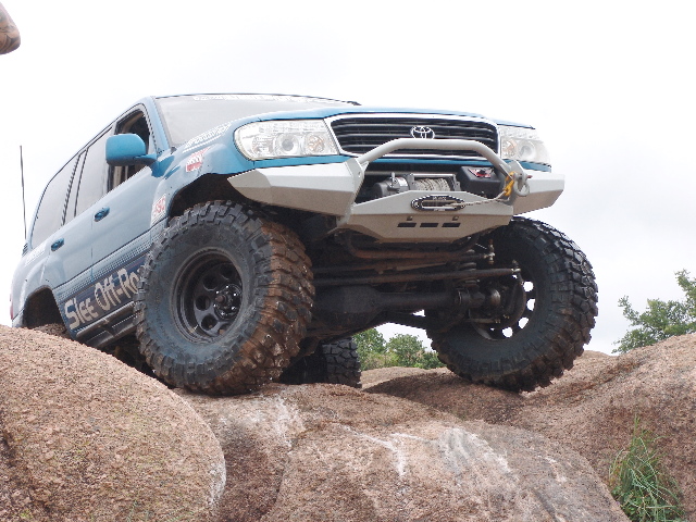

I'm not talking about the dip on the bottom to make room, I'm talking about the dip in the top surface. But to each its own. Always glad to see some new stuff coming out.

We did that so that you can see what is going on with the winch wire as well as cosmetic reasons. If you don't the front becomes really big.
I would think a cover would be a bad idea. The 100s are bottom breathers. A large portion of the radiator actually gets air from the bumper.

I like it. Nice and clean design, and tucked in. Would be interested to see what a hoop looks like on it, for lights. I like that you can fit a big winch on there, these are not light trucks, especially loaded for expedition. I really like the design for the recovery tabs. I bet that once it's powder-coated black, you won't even notice the dip on the top, and I don't even mind it, it's part of the design.

The winch is a M12k. It will accept that and smaller. The M12k might require the solenoid box to be mounted under the hood. Still figuring that out.
We did include vent holes at the bottom. One of the big reasons for having the opening is so that you can keep an eye on the winch cable. Winches that are completely covered are a pain when it comes to spooling the winch cable in properly.
As to the tow points, those are 3/8" mounts going to the frame. We will still double them up on the outside to prevent side pulls from bending them.

Christo, is your M12K going to be mounted feet forward? Hard to tell from the pics...
It is feet down but the front is also mounted against the face of the bumper. So it is mounted in two planes. As long as the front is against the face, then it is ok since most of the load is then against the face of the bumper.
PS, we are close. We need to figure the bar work. Sort out some details on winch mounting, solenoid location, license plate location and inner structure of the wings. However this is the final shape of the bumper bottom 1/2.

No idea on the price. As for the rubber stripping, we are going to see what we can do and find. We will have light tabs, but probably not god light inserts. The wings are already an issue to get strong and we have to completely box them to get enough structure. I am not that keen to cut a hole in the front face and thus weaken the face.
I will take some measurements to show the difference between the ARB and ours. But I think we are 4" closer to the body.
