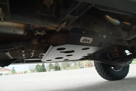

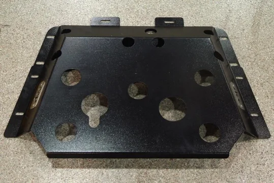

I stopped by Slee the other day and was presented with this beauty.
Aside from one stubborn bolt, it bolted right up. Drilling out broken bolts takes a lot of time so lube everything really well and take your time. You do need to make sure to support the t-case and transmission when unbolting the old parts. I know one person that dropped the assembly on himself (not me
) when he mounted up his skidplate. Luckily, I learned from his mistake.
Thank you Christo, and the fine folks at Slee, for making these for us.
The one pictured is pre-production so a few things may change on the final version.
Thank you Gary for all you do for me and the shiny bolts.

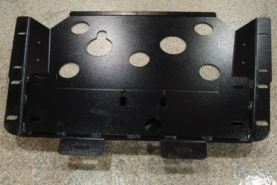

I do like the no bolt heads exposed to getting knocked off.
