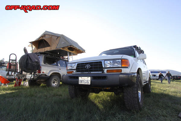

Hi All, just wanted to chime in on the new Slee Skid Plate (aka Transfer Case Belly Plate). It's an amazing piece, thoroughly planed and executed.
I got one out to San Diego, and the guys at ORW were very impressed with the ease of installation. Less than 1hr for the whole job.
It completely replaces the transmission cross-member, as well as the whimpy tin thing on the transfer-case. Fully protected now and ready to hit the trails with confidence.
I know Slee makes these for the 100 series, but now us 80 guys also have a option for full belly armor.
WEIGHT - Big Concern? Not really.
I weighed the Slee Belly Plate before installation--51lbs. Weighed the factory t-case skid and cross-member that came off, 18lbs. Subtract the old pieces from the new Slee belly pan and you're really only adding 33lbs.
I'll lug around another 33lbs for the piece of mind of not being stranded on the trail because of a cracked case. That's just me.
Nice work Slee!
