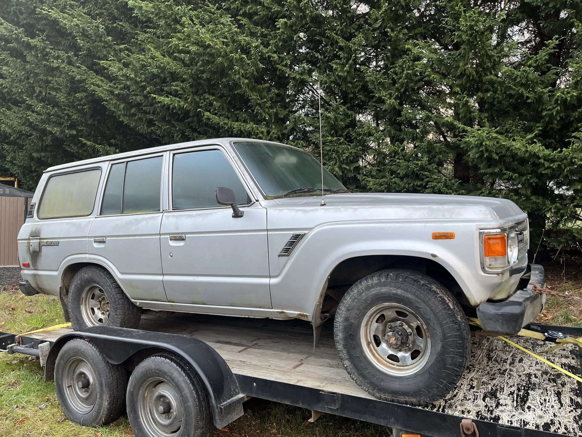

I never get out of the 40 forum, so this is a new experience for me.

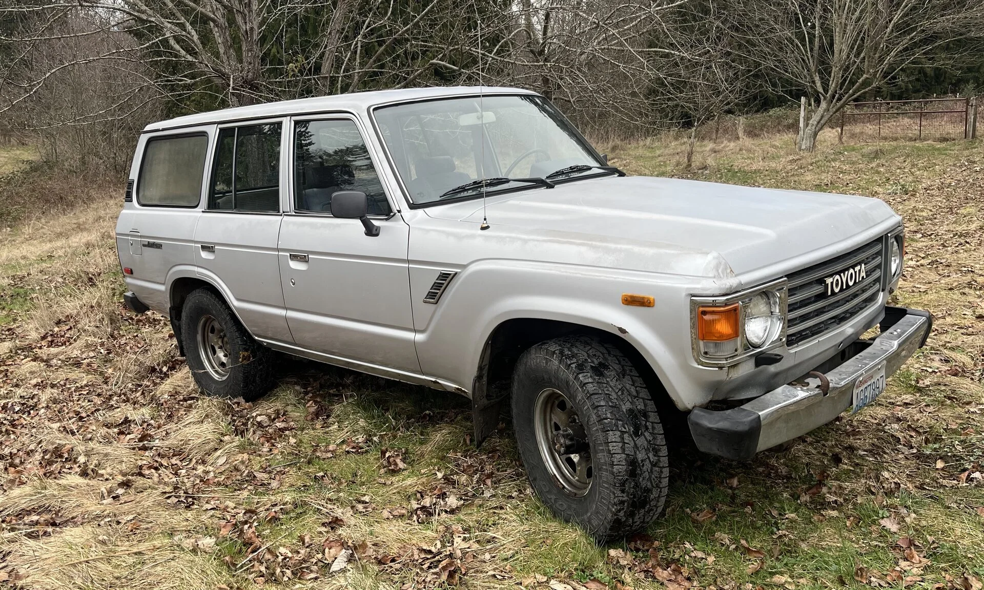

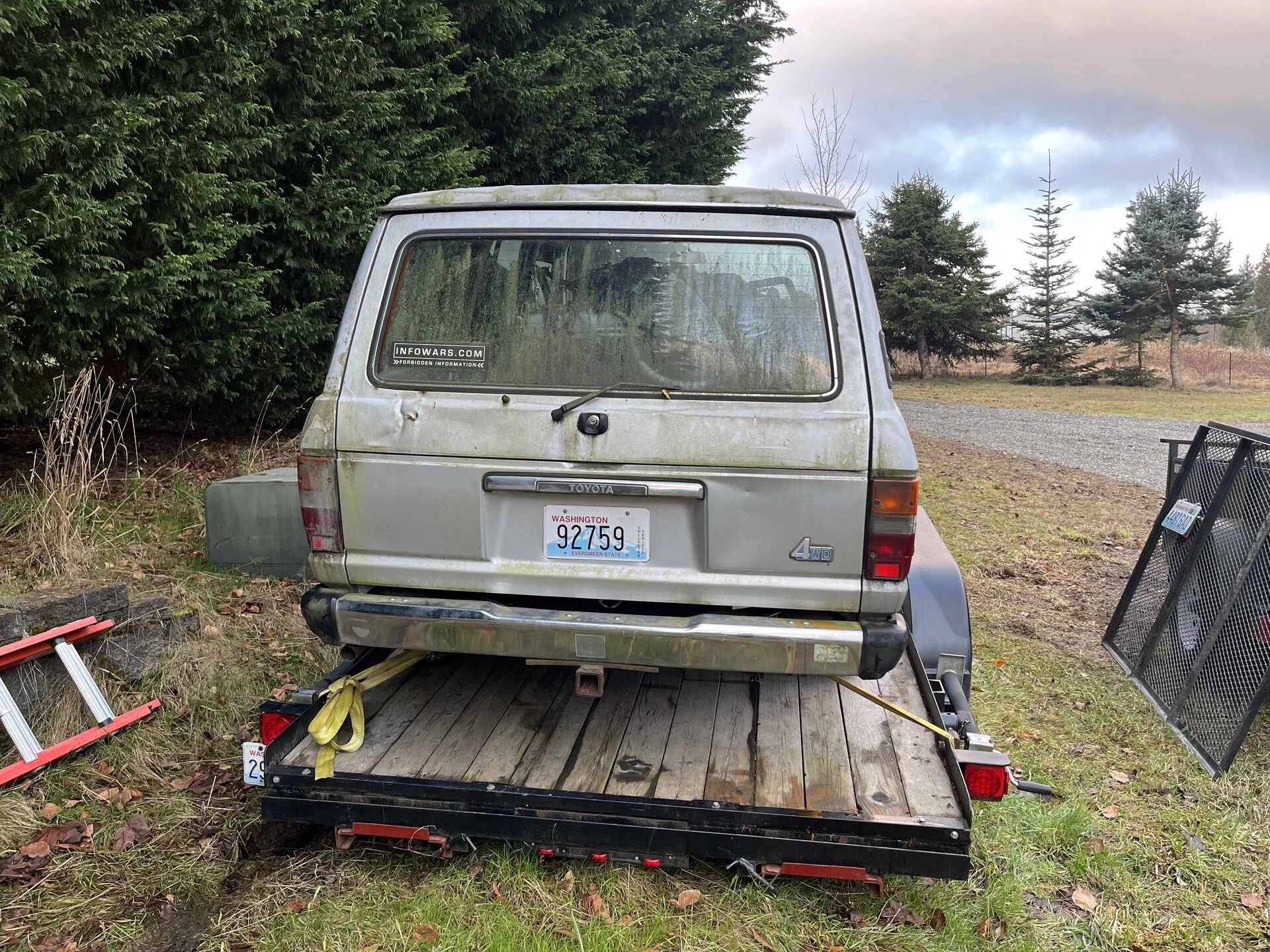

I’ve wanted a 60 series for awhile and my wife saw this 87 posted on Facebook yesterday with a bad head gasket (posted as an 84). She messaged him for me and I hooked up the trailer. Couple hours later and some difficult pushing and we had it loaded on my flatbed.
Was told it was bought less than a year ago with a bad head gasket. I don’t trust anyone I don’t know so in my mind, at worst I need a new engine (no offense, he’s a member here and seemed like a standup guy). Battery was dead so no chance of a compression check but I could spin it over by the belts/pulleys. The body looked great in the dark and interior looked good too: pretty complete, seats that need recovered and some typical peeling clear coat on the paint. Very little/no rust so that’s a plus.
Today in the light I’ve had a little time to look at it better. Really pleased with the overall condition and I was able to get it to run! Has a man-a-fre Weber conversion and desmogged. Ran like crap; definitely a few dead cylinders. But no weird noises and it would idle on its own (poorly). I’ll get a compression and leak down test and see what’s up. Telltale signs of “head gasket in a can” snake oil fix residue on the rad cap.

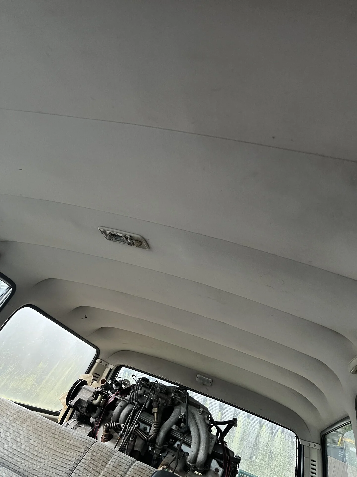

Oh, and it came with a 3FE in the way back. Word is that engine is good so we will see.

Great options,- a 3FE swap, 2FE conversion..........
I will most likely sell the 3FE. I’m in no hurry so the 2F works for me. I have a Sniper setup in my FJ40 so if I do efi, I’ll likely go that route. But, I haven’t looked much into the 2FE conversion yet.

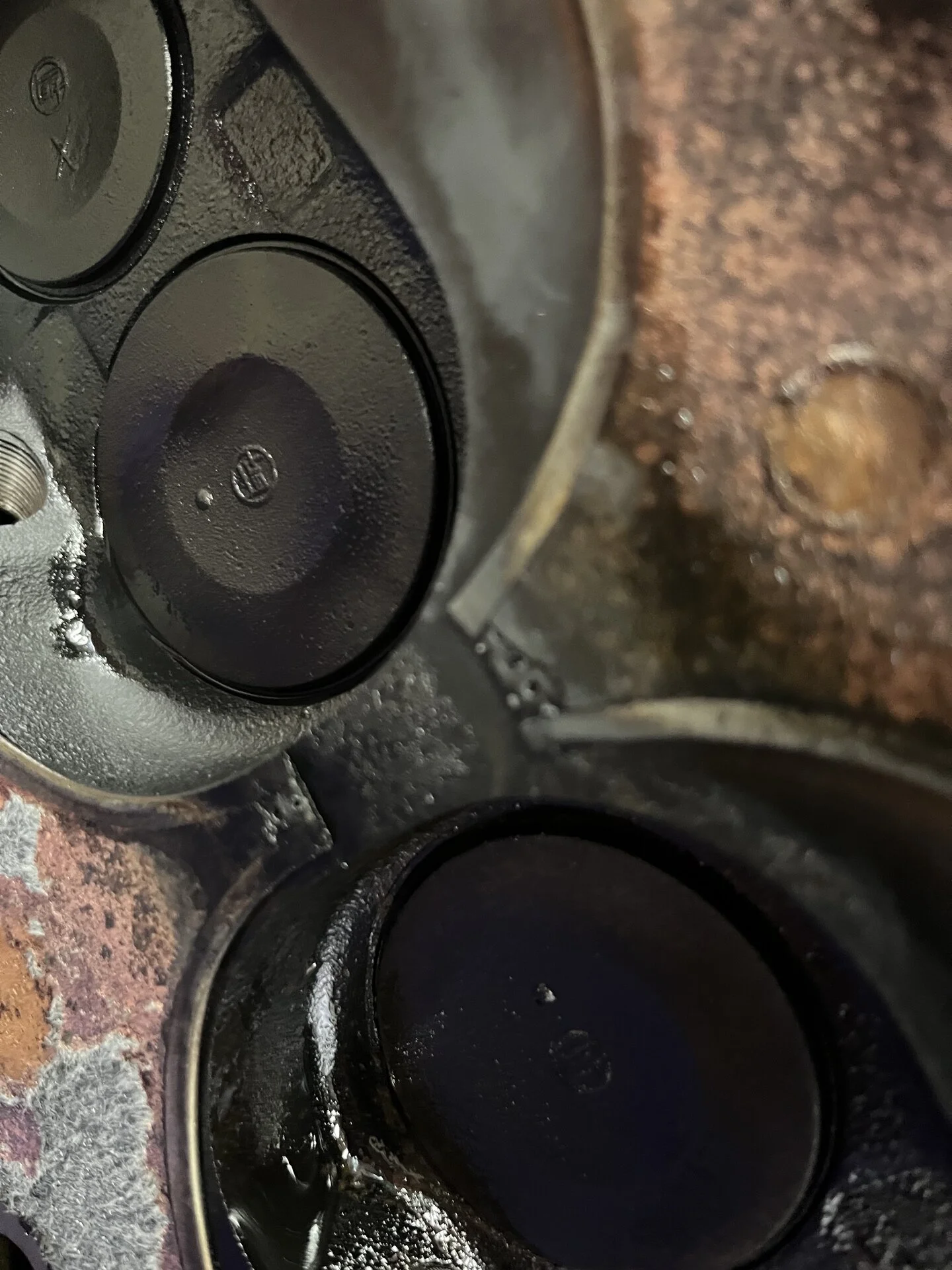

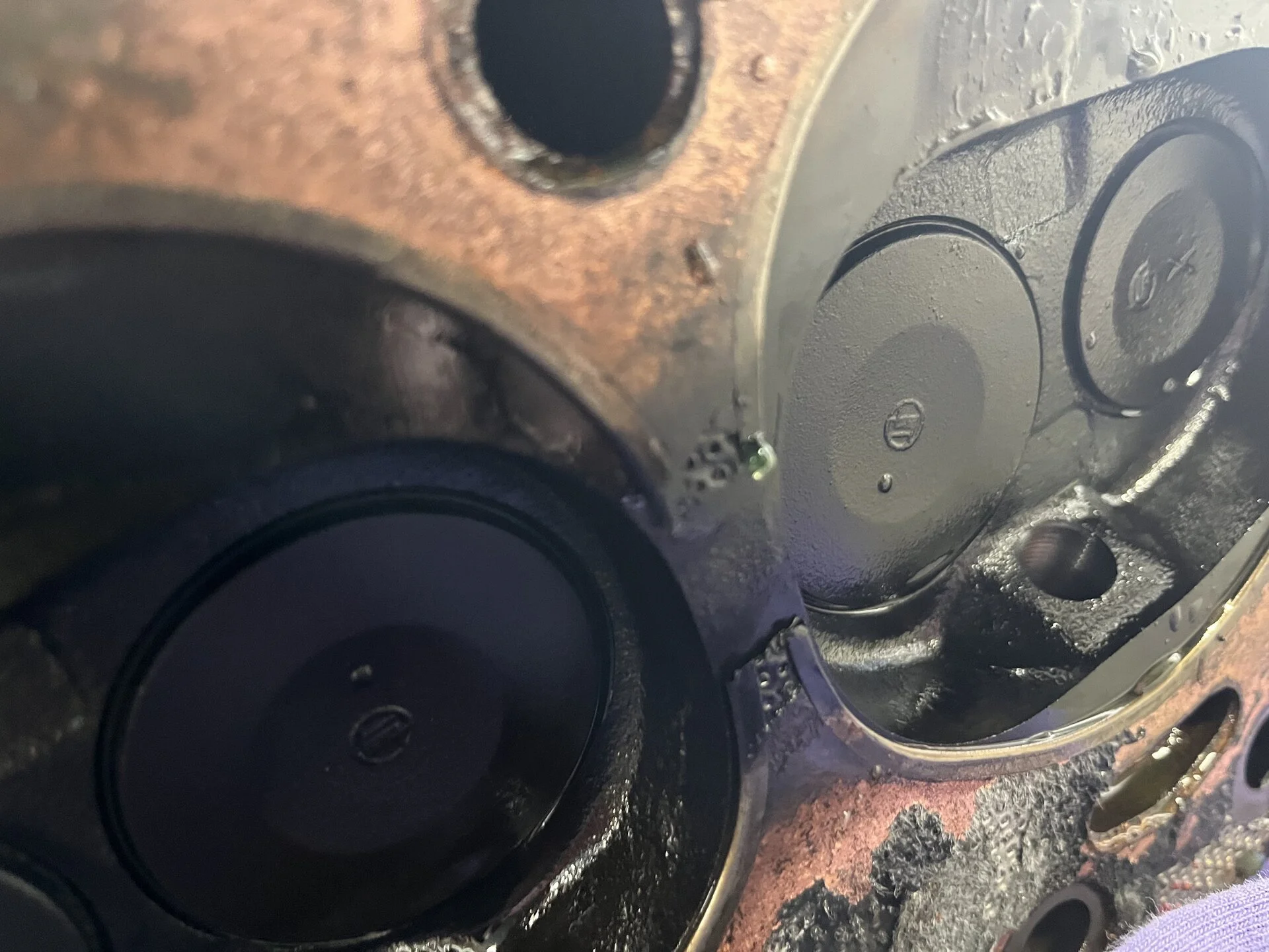

Head is off. Wonder why there was no compression? Could blow air in cylinder 1 and come right out plug hole for 2. Same with 5,6.

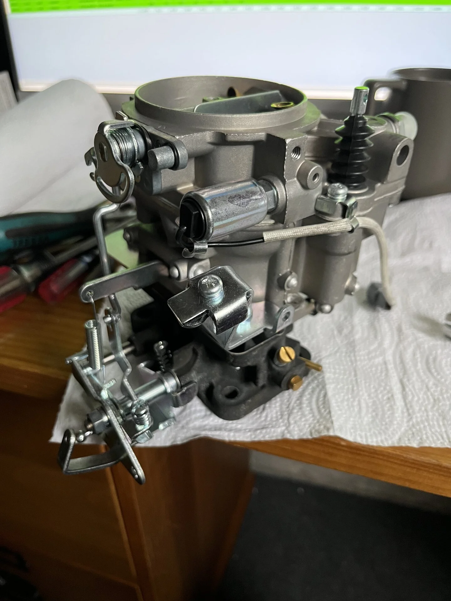

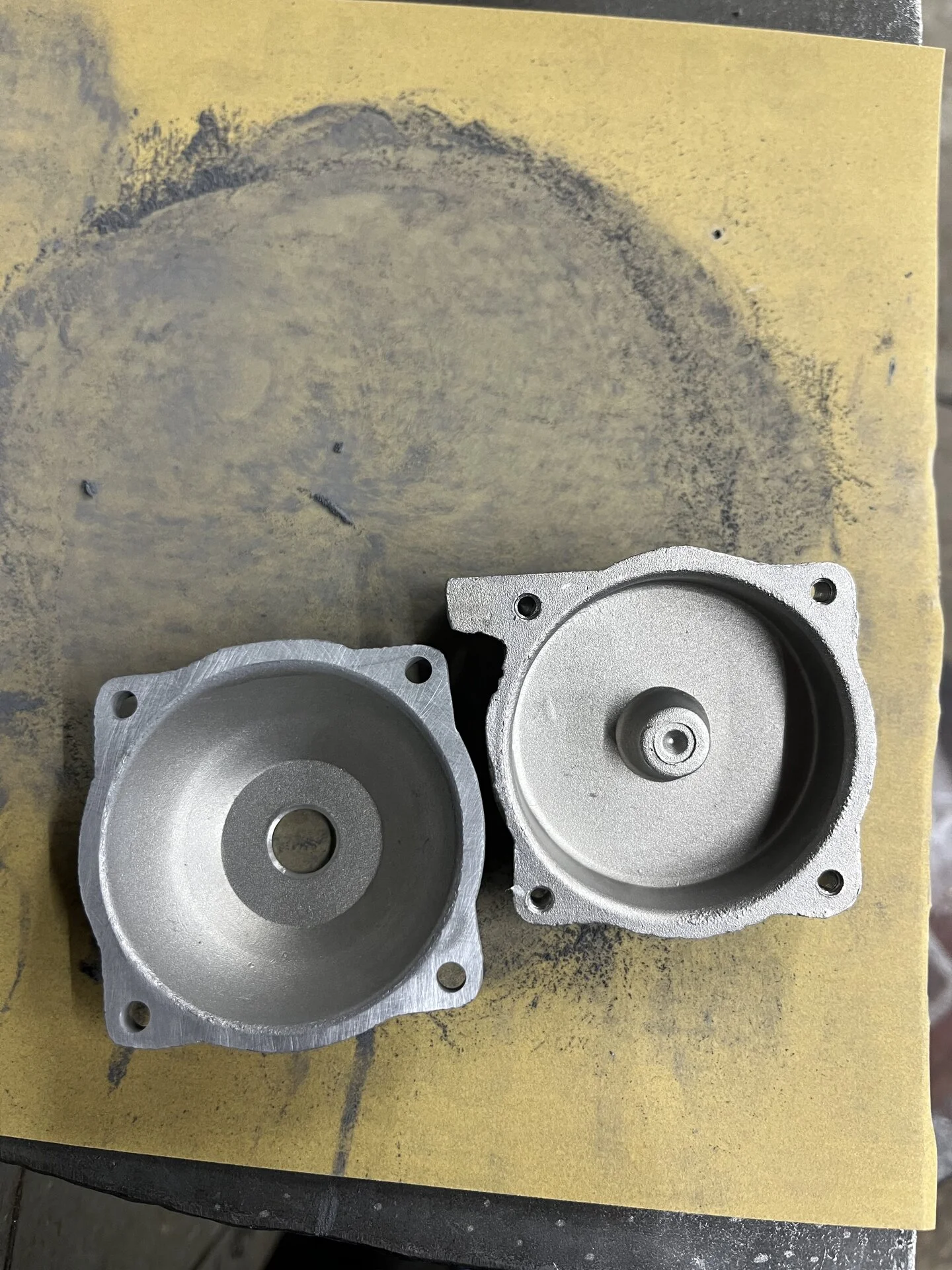

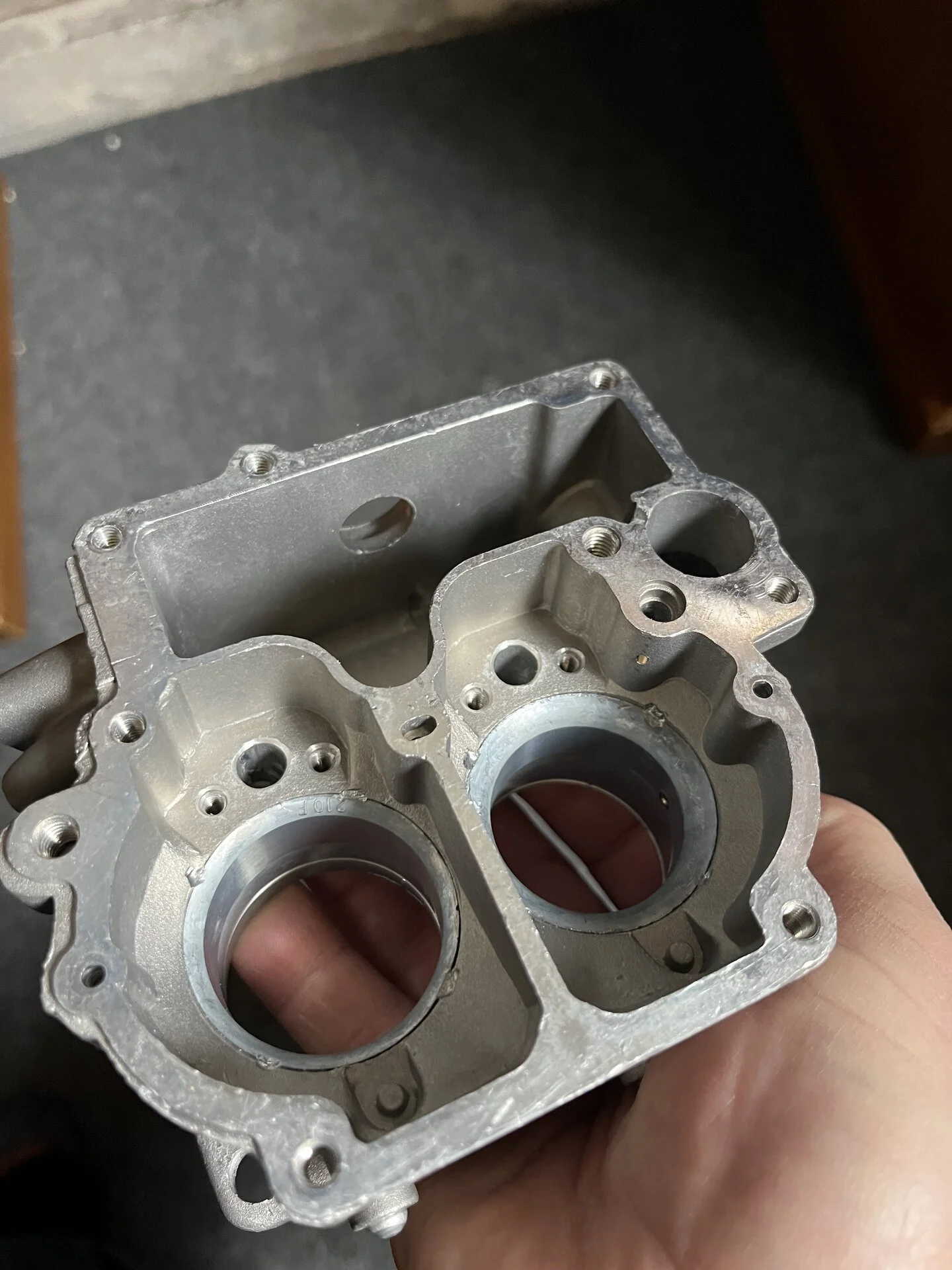

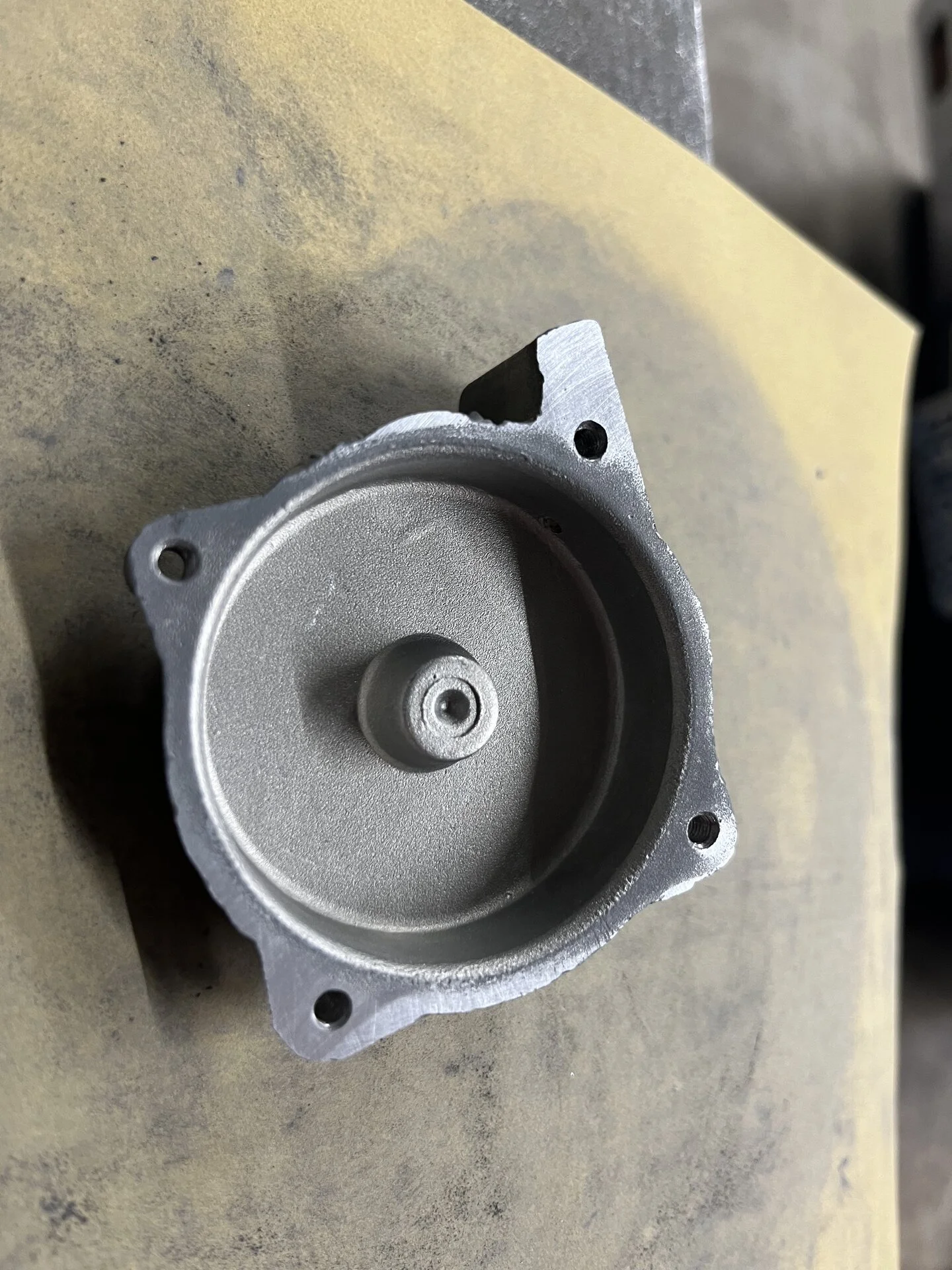

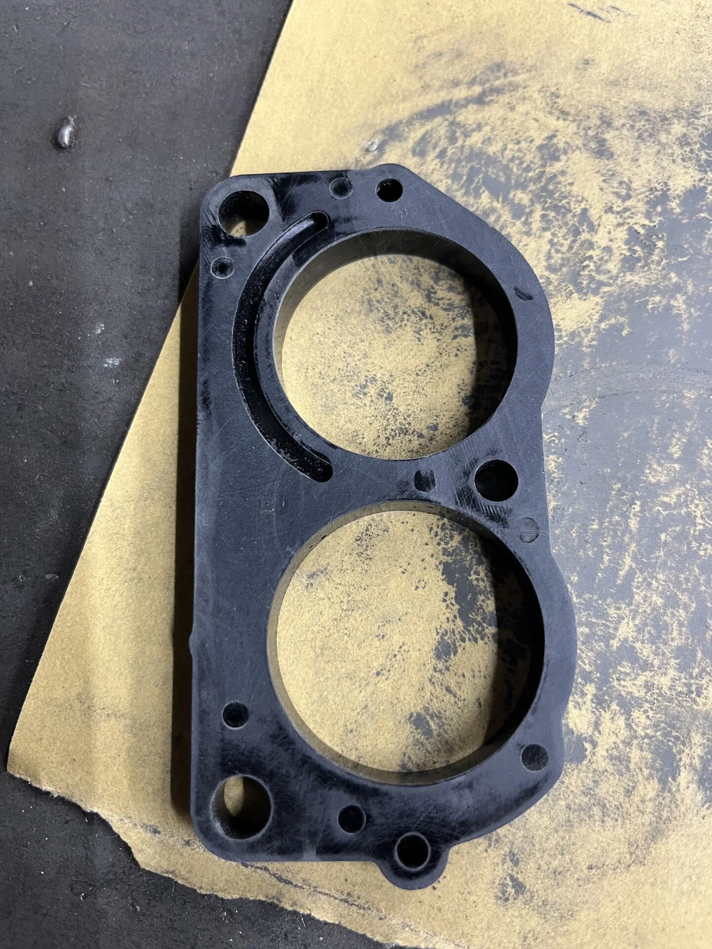

I’m waiting on the head to get back from checking for cracks and surfacing. In the meantime, I’ve blasted the intake and exhaust manifolds and painted them. Today I started rebuilding the brand new Amazon knock-off Aisin carb. What?! Rebuild a new carb?! I’ve dealt with a few of these and they’ve ranged from good out of the box, to real bad. This one was ok but would’ve given me some tuning issues. I bought the Keyster kit right when I ordered the carb. I use the keyster gaskets, float needle and accelerator pump plunger. Usually, I find these full of manufacturing shavings that’ll clog passages and this one didn’t disappoint. The rest of what I did to it is just fitting parts better. I have a machined flat surface I put some 400 grit sandpaper on and with firm, but gentle pressure, sand all the mating surfaces in the carb. It’s surprising how far out of straight these are. The middle of the carb body to top gasket didn’t even have impressions in it from being bolted together. Here’s some pics. The vacuum secondary diaphragm housing was so bad it wouldn’t even hold vacuum.
Hard to tell but really “choppy”, not smooth or level surface before sanding.
Sanding the plastic mid spacer.
Secondary diaphragm housing with half sanded, the other as delivered.
After a bit of sanding. 2 opposing corners aren’t even getting sanded yet since the others were so high.

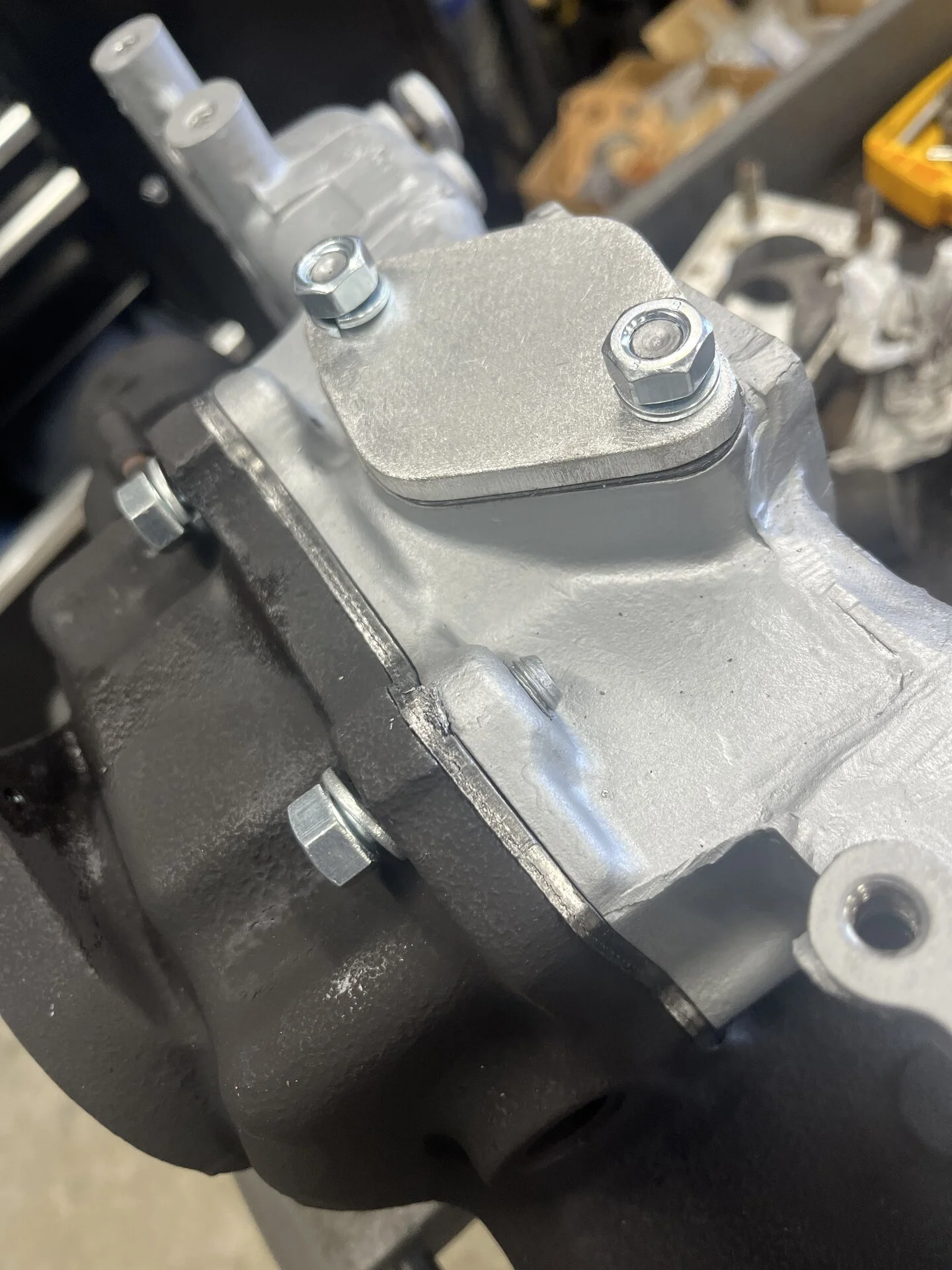

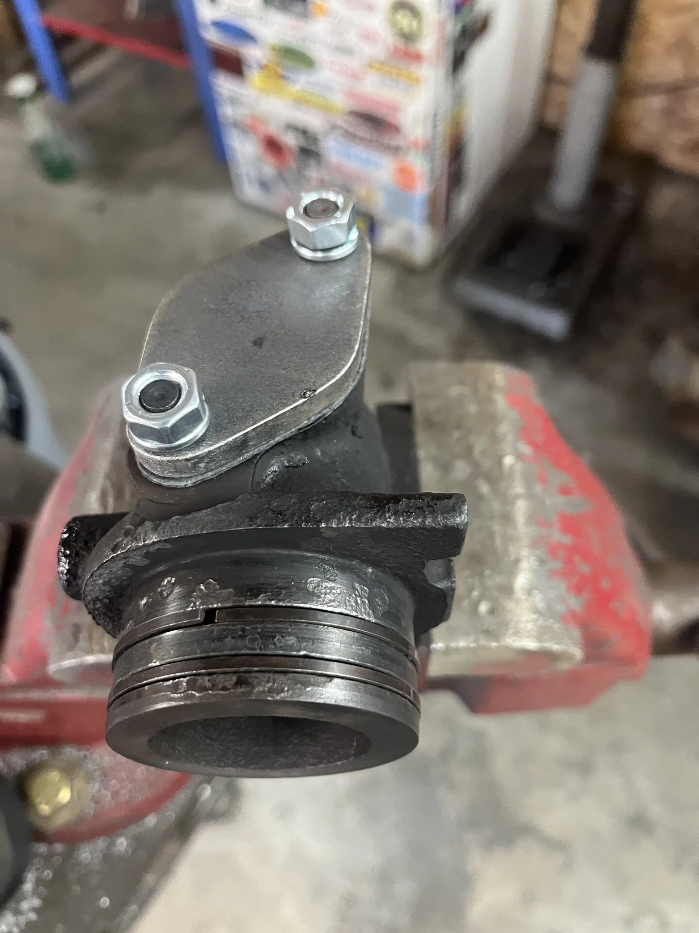

Got the head back today. Made new EGR block off plates and got pretty much everything back together. No coolant because I didn’t have big enough hose clamps for the big radiator hose off the water pump. But I’m impatient and wanted to see, so I tried starting it anyway. It lives! Sounds pretty good but ran less than 30 seconds. The idle solenoid wire is (I’m assuming) taped up in the harness so I need to find it and hook that up. Also tried disconnecting a big power wire that was coming off the coil to feed the electric choke. The coil stud snapped so I need to try to find one of those tomorrow.

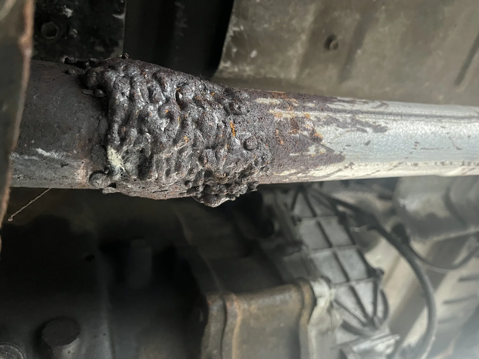

When I was underneath it, I saw these skilled welds on the exhaust…. Every connection from the down pipe back has these. So that’s on the list

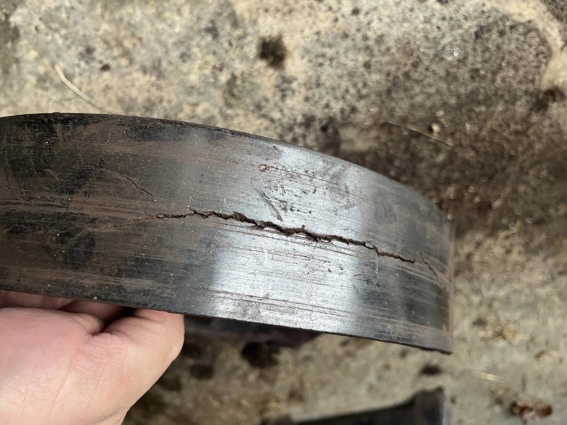

Parking brake wasn’t working so I assumed the bell cranks were seized and I was correct! I love being right. Drivers rear was seized with parking brake activated (good thing I didn’t drive around too much yet). Was a pain but got it loosened off just enough to get the drum off. Passenger side was seized not activated because the wire inside from crank to actuator lever was snapped. Once drums were off I verified neither rear wheel cylinder did anything when the pedal was pressed. Besides that, rusty drums, cracked shoes, dead spiders. Typical brake job after sitting for years. Blasted the drums for paint and waiting on parts. Front brakes work well and look pretty decent so they’ll get bled with the rest then look at them deeper when I get to the knuckle rebuild.
