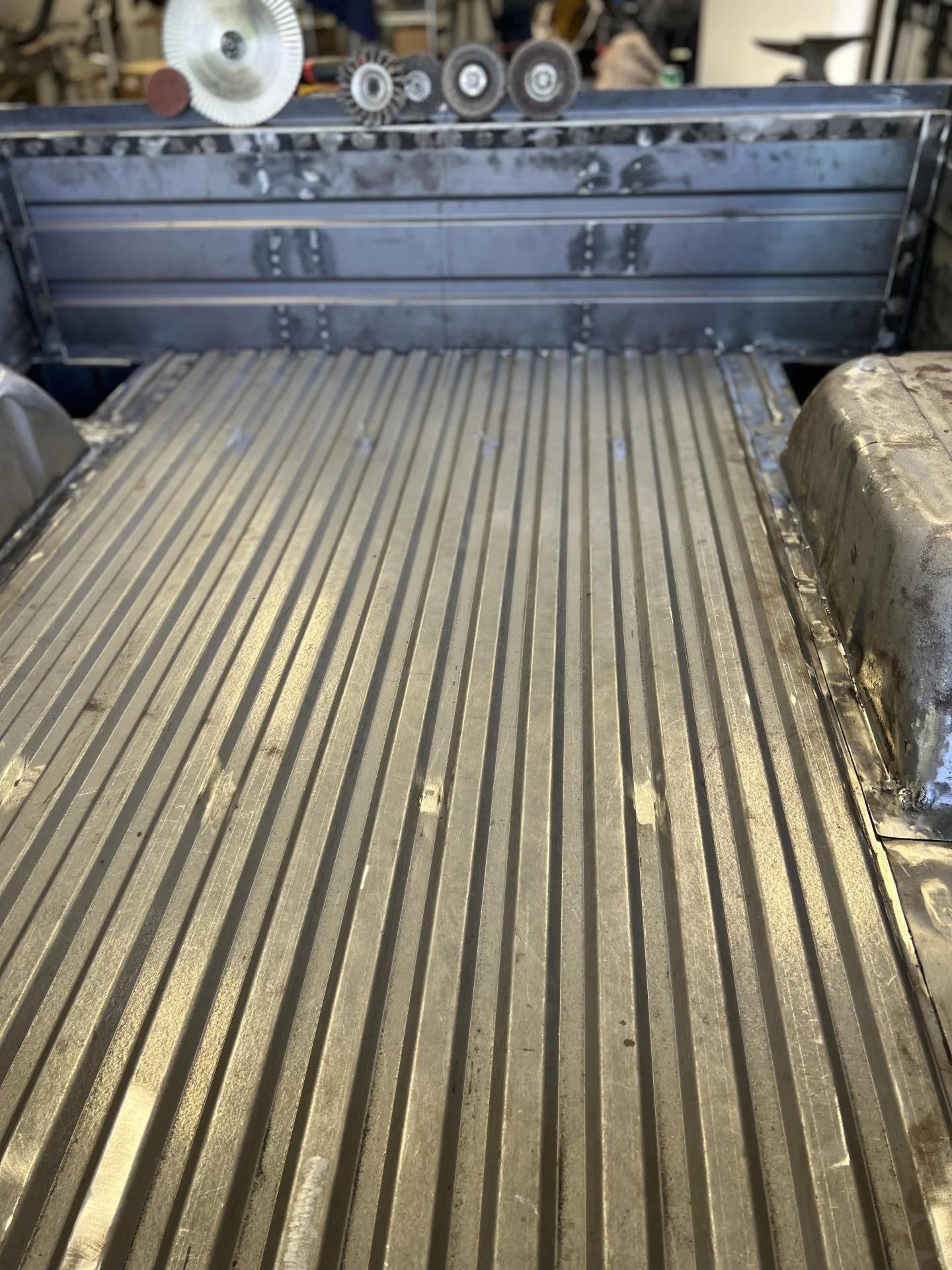

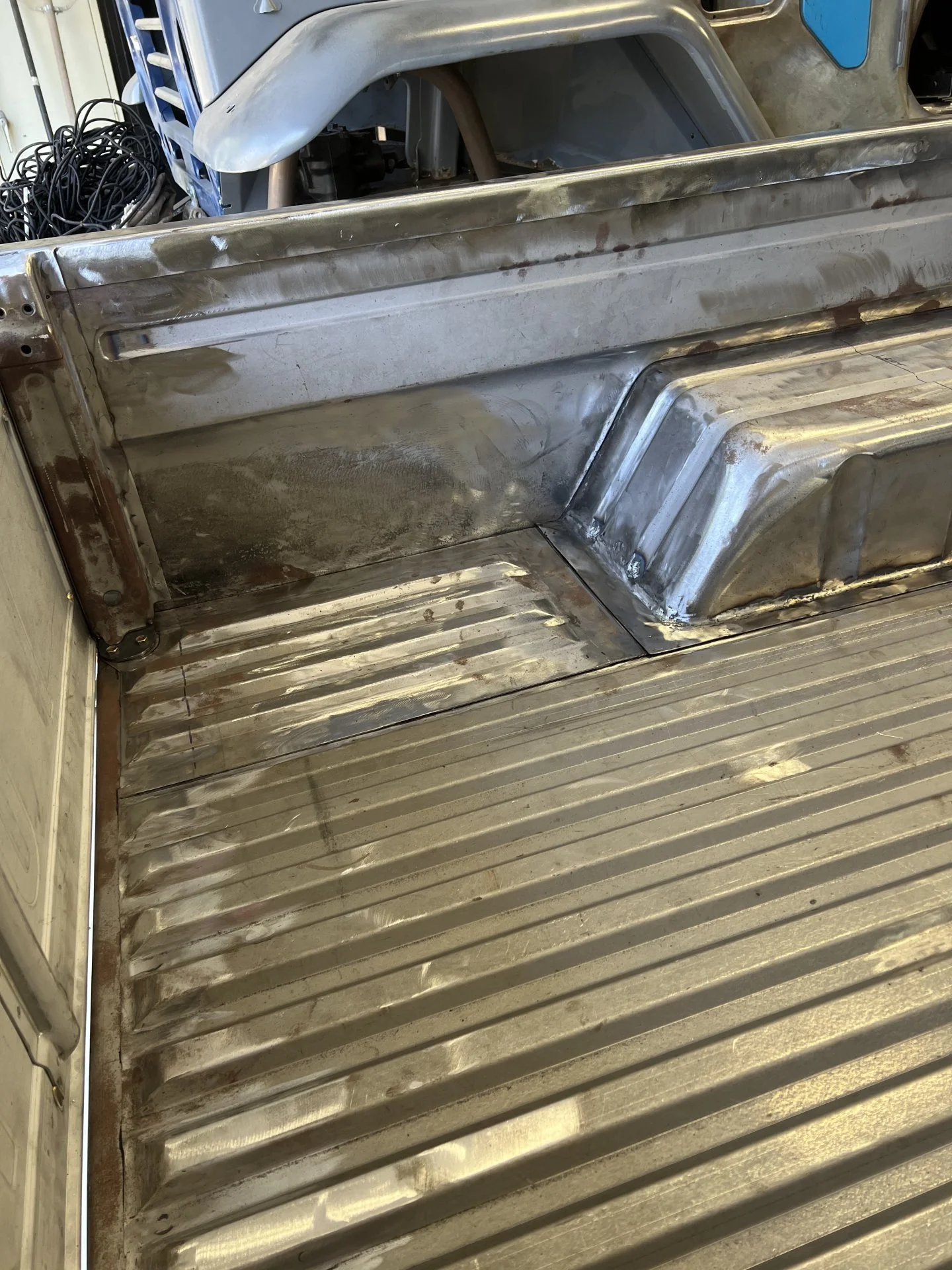

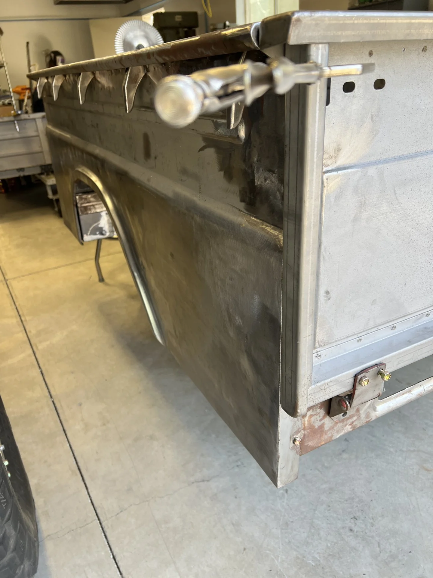

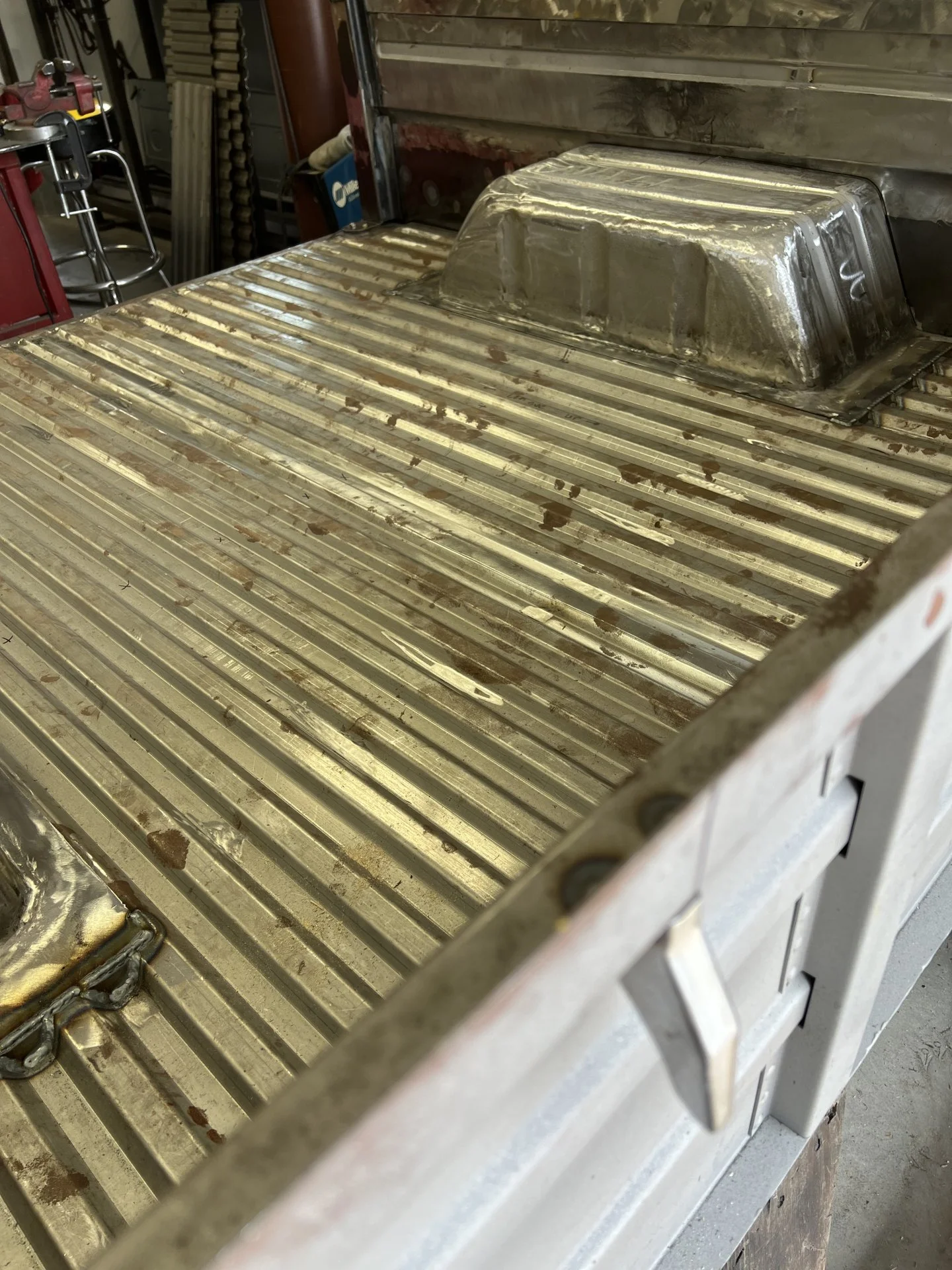

I made it over the hump with the 35 bed today I do need to flip the bed upside down and finish a few welds maybe a 1/2 hour then it is ready to go to primer powder coat. the first 3 pics are of the sides and frontally within a 1/16 or less a very light skim coat will take care of it with custom fitting the side fenders as involved as they were they came out pretty dam streight and nice.
The remainder of the pics are of the inside showing all the rosetts have been ground down and looking good. The compartments in the front I made for the batteries to give a little room in the front engine compartment and disperse some weight off the front. The trailer bed is well on its way and won’t take much to finish it for the same process of powder coat primer, after a good day it is prob time for a cold one.

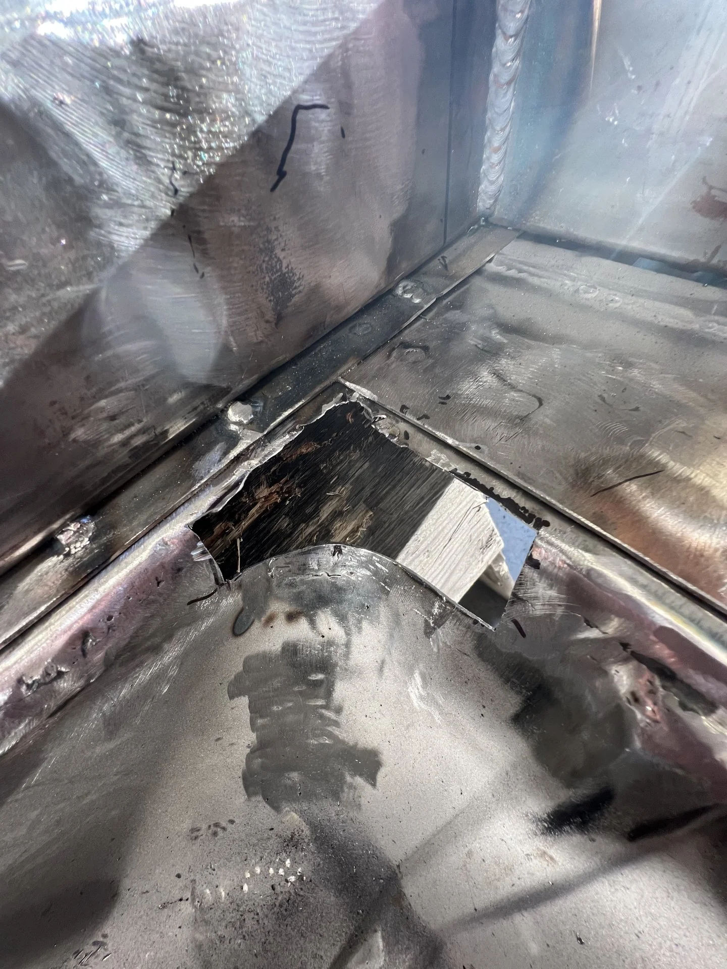

When i turned the bed over for final welds i found some pin holes in a part of the wheel well so back at it for the last of the rust repair knowing that on the final media blast it would blow it out. Sooo the top ledge needs a bit more work as you can see it is not finished but the insert is mostly fit. It was a buggar, small and hard to hold so i tack welded a little handle if you are wondering what that piece was

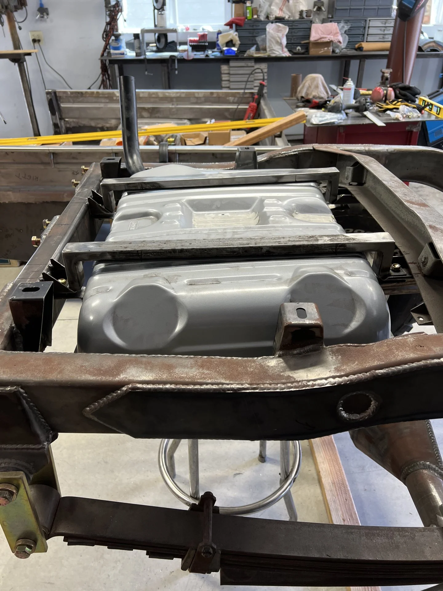

Sorry if I missed it, but what tank is that? Looks almost like a generic tank that gives you options to put the full and pickups wherever you want.

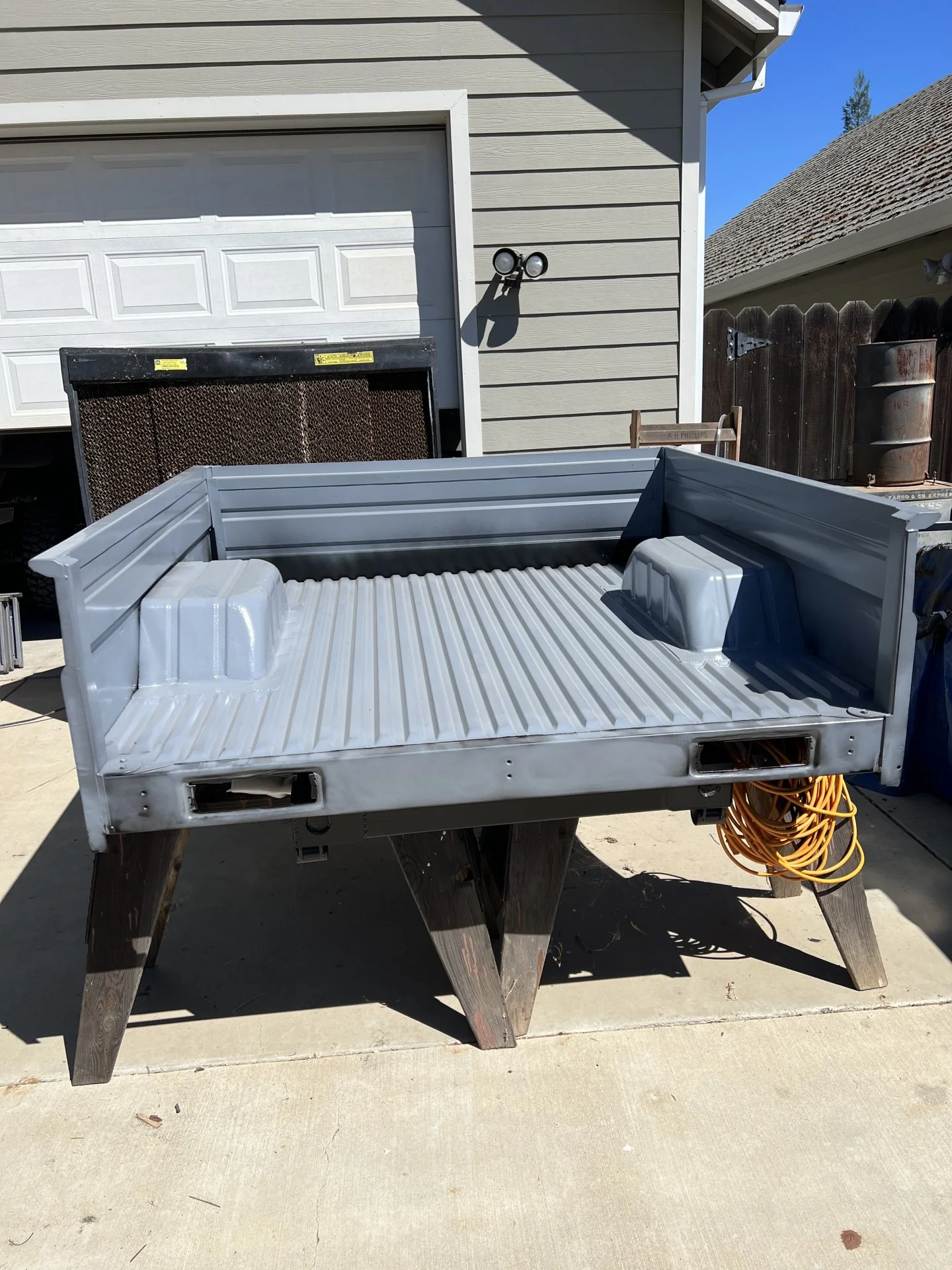

It seems like i have been working on the same thing for ever but yesterday i was able to get the second finish on the bed to the trailer. With the fit on the fender skins and the wheel wells it has been a challenge, the little inserts were a pain to make and weld in. The pics I took so the special install to the bed floor so it would have some drainage I still have a wee bit of finish welds to the bottom structure and finally i can get the frame, axel, and box to the sandblasting/powder coat primer so it will be ready for paint. After that gets back the 35 bed goes next for the same treatment.
It has been awhile but i have been working to finally get to a point of completion on the beds and ready for primer powder coat. I just got home the trailer from the sandblaster and had it powder primer coated now it is ready for finish body work which will be minimal, did all the rough out myself. The bed on the trailer is loaded and ready to hook up to the pick up and go through the same process tomorrow and should be ready for the trip home next week. I have many little pieces to go through that process, and other body parts. This long journey is finally looking like the light at the end of the tunnel has turned on and i am just fine with that
