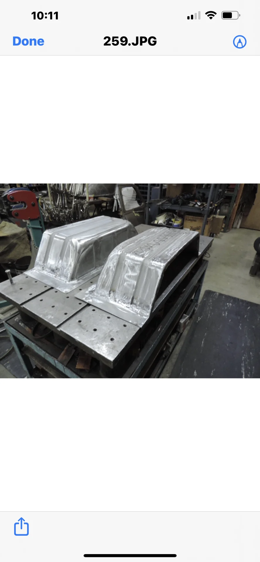

Today was devoted to catching up on loose ends, grinding all the welds straightened the top rails to the bed and all the welds to the trailer that that needed to be completed after we took the bed off the frame. So here are some of the welds that we finished and i sent the frame out of the garage to get some space to button up the bed boxes . The final destination is the powder coater/blaster to get them ready for the painter to complete his part. i keep inching my way slow but sure.
The long awaited pieces for the 35 bed are being shipped today, so now i can install them when they arrive maybe Friday. I will have more pics when i install them. The final process will be final blasting and primer powder coat the whole unite that will keep it from getting a rust coat before final paint.
Very nice. Where is this being fabbed?
I have 2 rigs being put together my original 45 is in Idaho, this one that is a 45 the 45 clone stretched 8” is being built in my garage in the chico area
Oh so you fabbed these? Awesome!
No a friend up in Washington did the repairs on them, they were bent dented and rusted out but original. He has all the specialized machinery power hammers etal it was a bit above my head but done so i can move on. most of the other stuff i was able to do. on the build here. The 45 in Idaho another friend has done a great job at building it i go up once on a while and play like i am helping him it is great to spend time with him as i have learned a bunch in our 27 year friendship and many projects in the past.

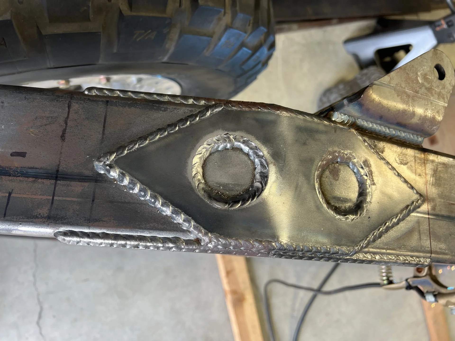

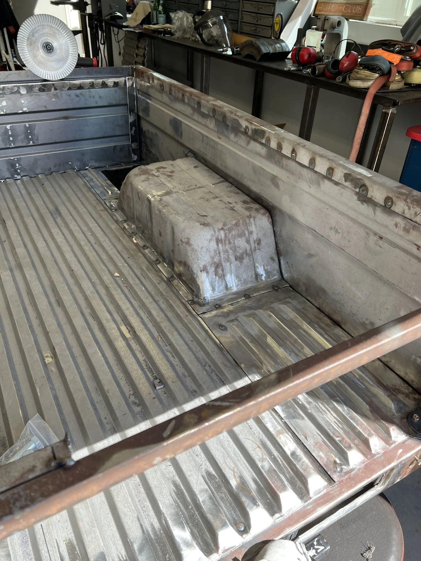

In this setting I have put aside the trailer box and focused on the finish of the 35 bed. These beds seem like it never ends however I am making progress and getting closer to total finish. Today i have pics of the passenger side fender on inner fender wheel well in place and all rosetted on. Sllw and go with the welding so I made sure i didn't warp the previous work. still there will be a little bit of shrink disk work to move some metal around and get them flat. My goal is to not use any filler almost an impossible Task but it will be just a skim coat to make the areas perfect. Lighting was an issue so it was hard to give you a good view for your eyes.

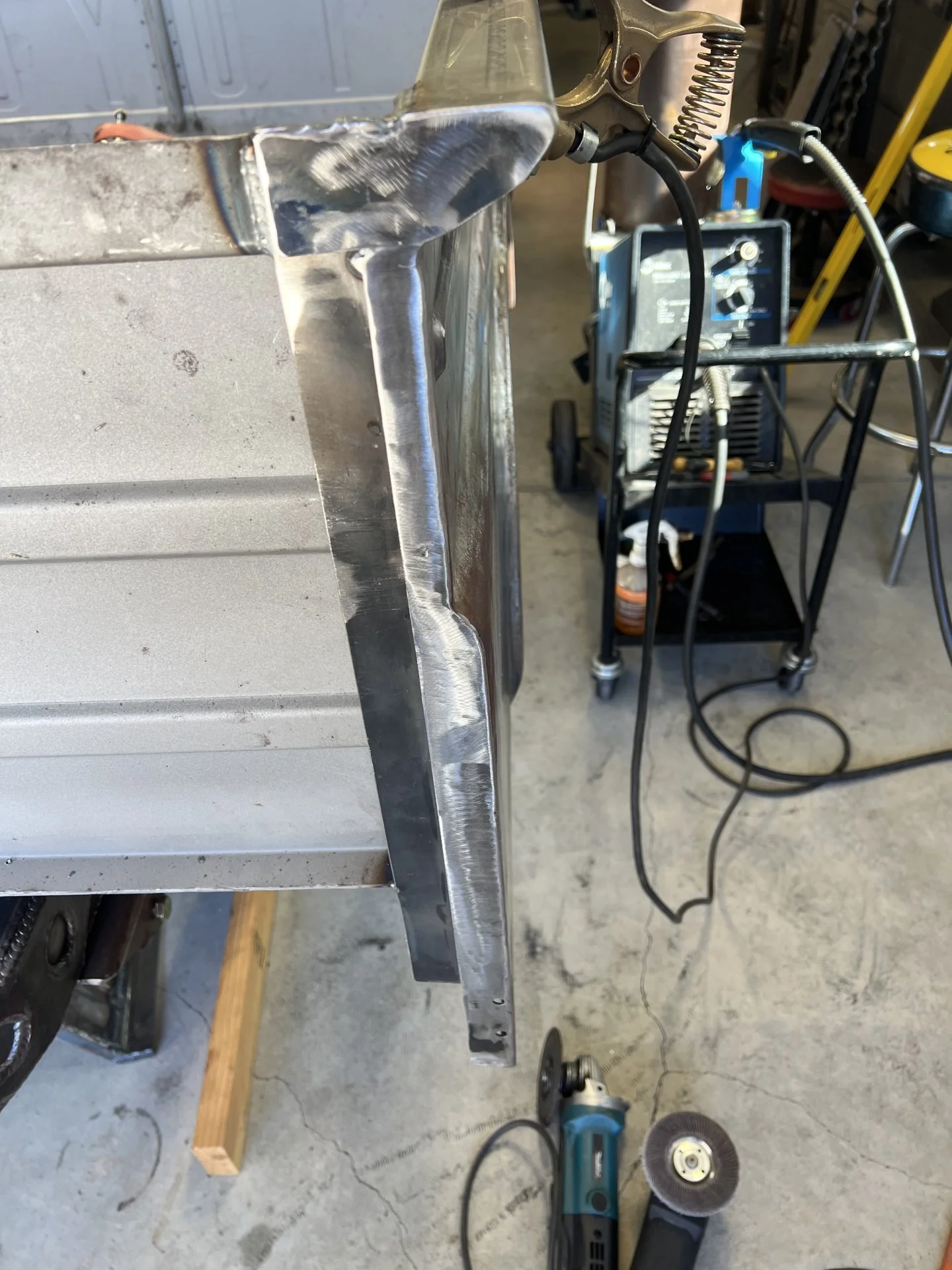

Now for the outside quarters , it seemed like there were a million rosetts I did back the weld areas when possible with a copper block while welding. then used air to cool down the area , made the back of the welds very smooth and will be able to clean them up with little grinding. Don’t think I got any warpage at all.
