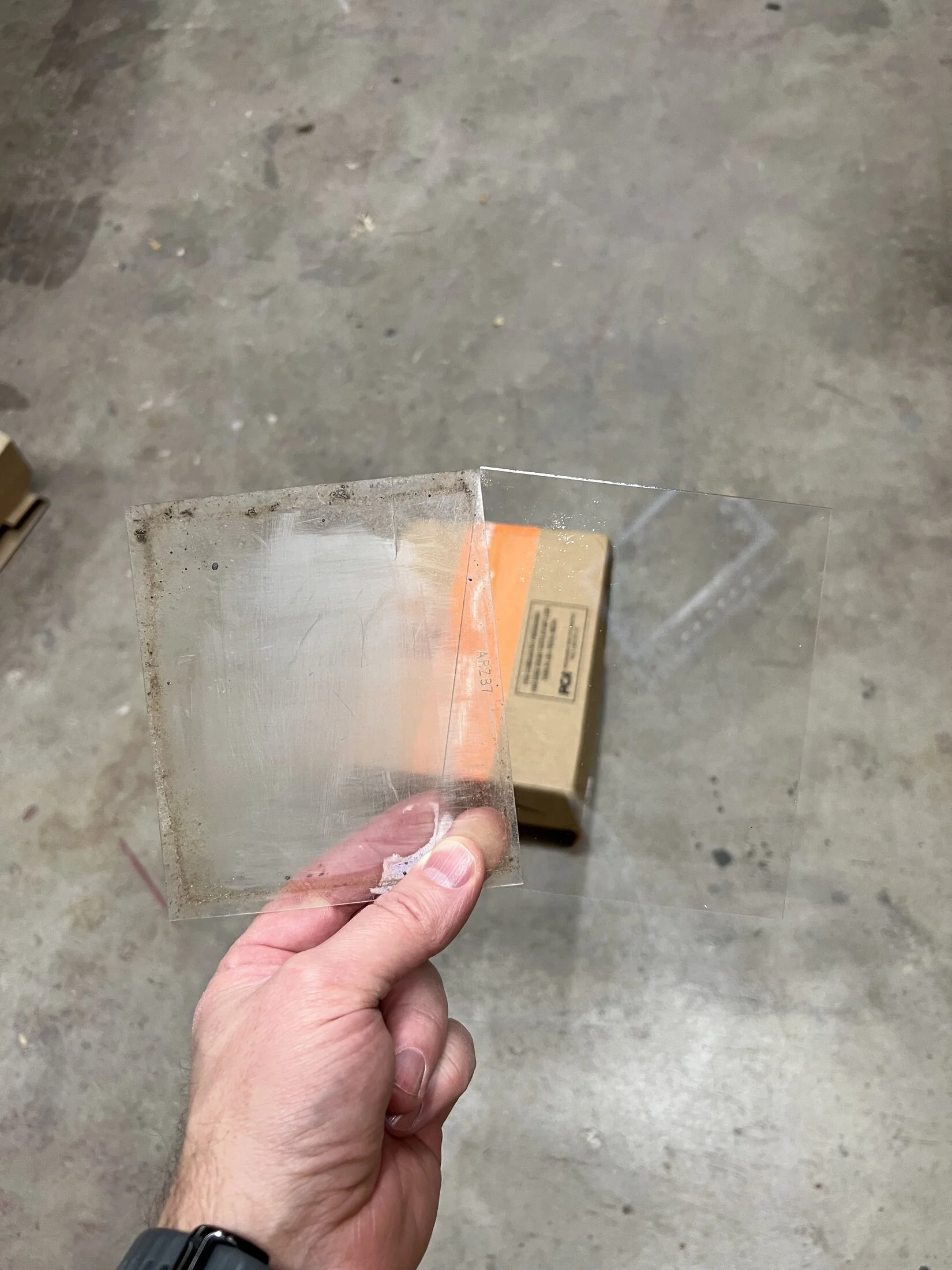

You are supposed to be able to see through your mask? I must have been welding blind. I got replacement shields last week and I finally put a new one in today. Wow. How cheap am I.
I probably need to change mine out it's been a while :rolleyes:
Been there done that! Probably back to doing it now….

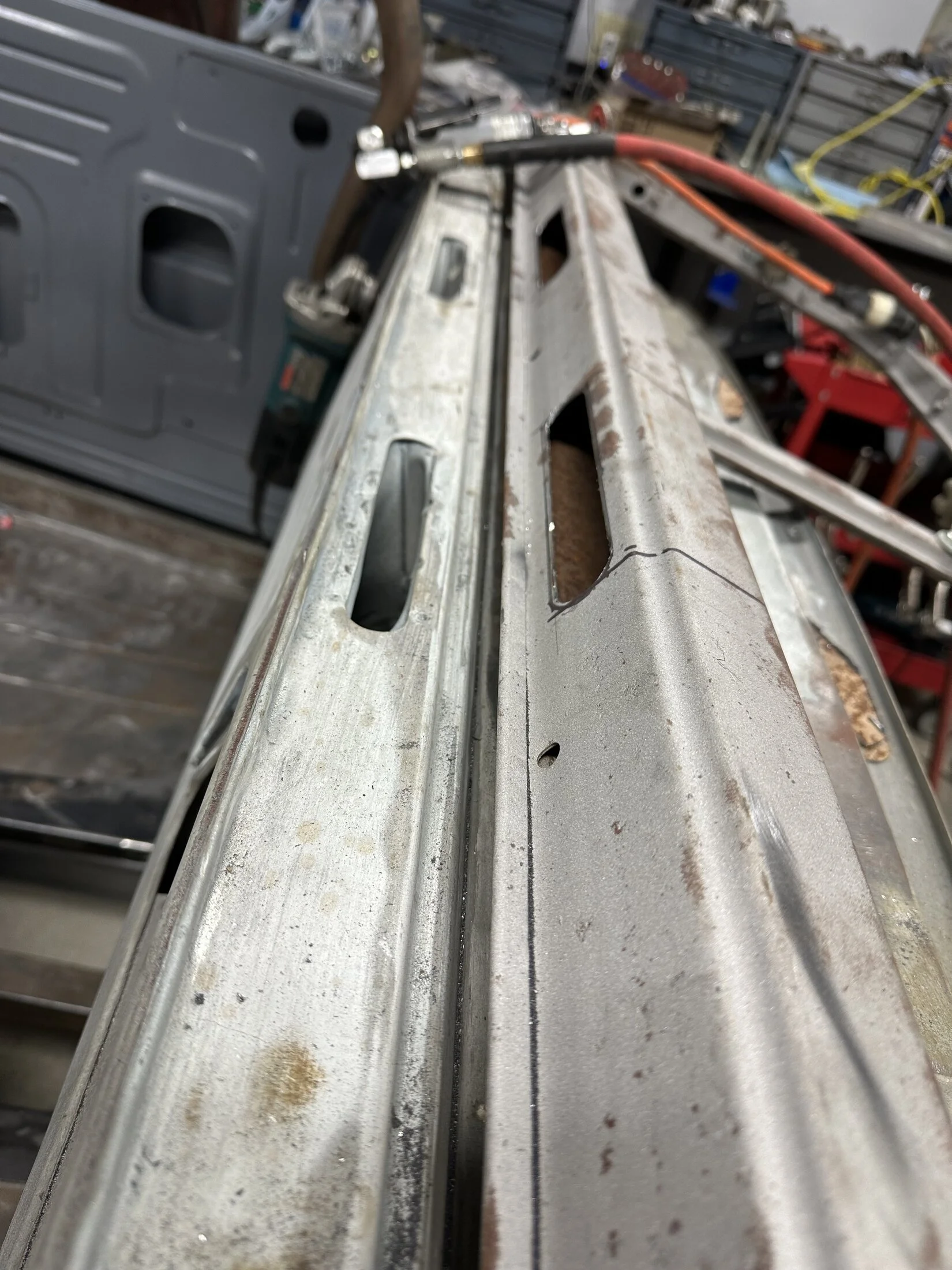

Thursday I did a bit of work on the Pakistan windshield with the safari kick out windows. In earlier posts it is shown installed. The charge of the day was to install the wipers that I had from a 72 tub had to do some mods to get it to install and work, done.
Then to check for fitment just time to do some minor mods not much in the way. However the big part was to match the tub defrosters vents from the tub and cut the slots and match it to the wind shield opening’s.
pics below 1- showing the defrosters in the tub 2-showing the slots in the bottom of the tub wind shield and 3-showing the final hole coming out of through the lower windshield to the glass. It took a bit of attention measure 3 times and only one chance to cut once, turned out good. Next to work on the fiberglass top an do a final fit to the drip rail.

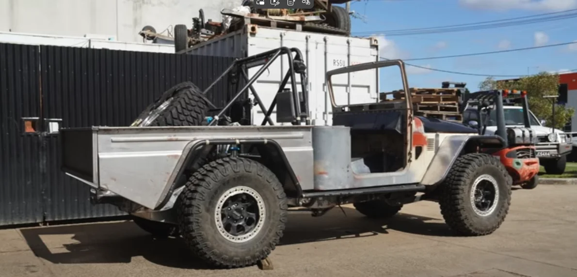

Where has this build been in my life? Any updates in the last 6 ish months?

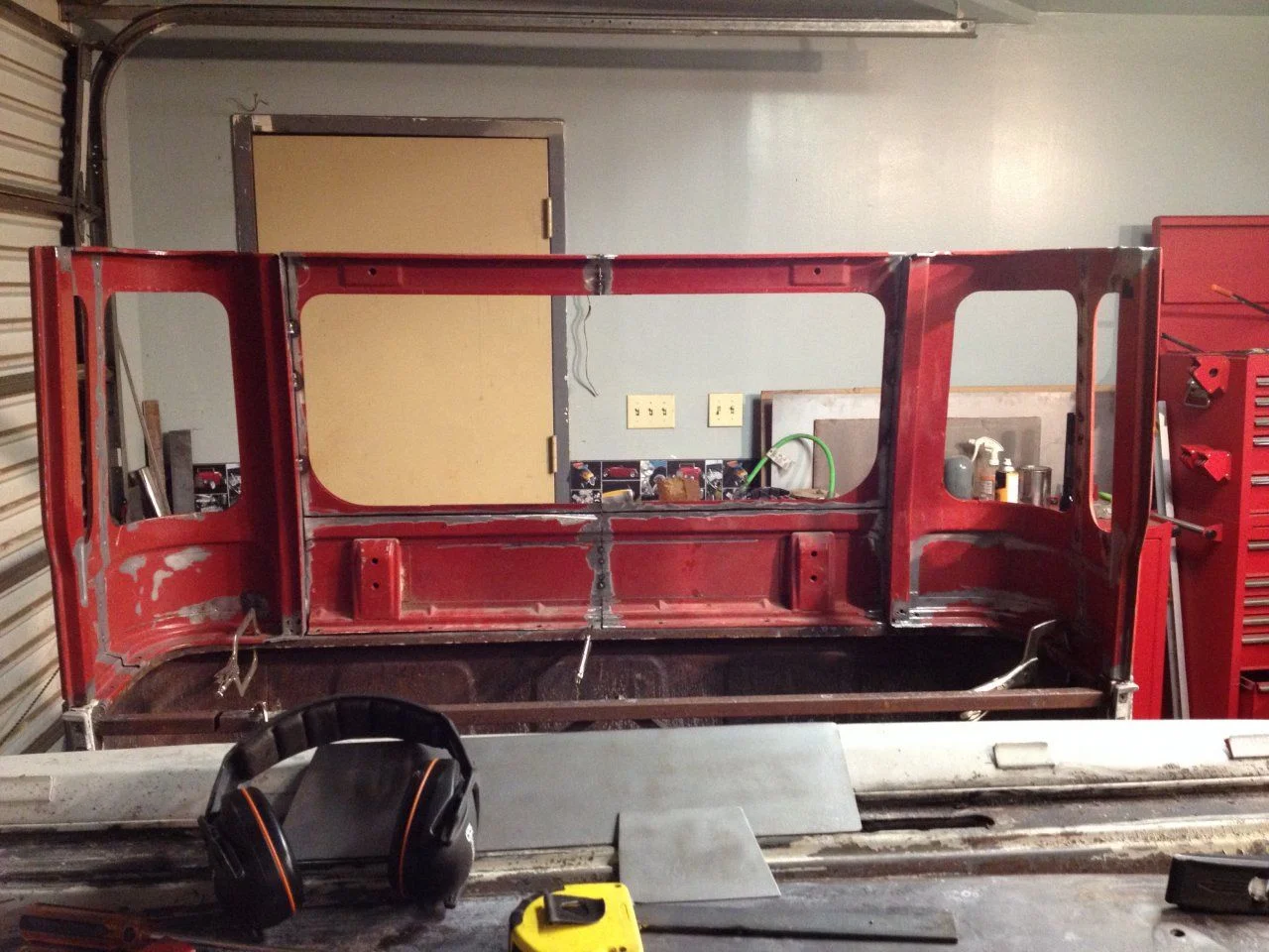

I am now doing a very similar cab stretch using butchered 40 hard top parts and will have a very similar shortened popout window like yours. By the looks of it I will end up with about the same amount of stretch. Having Bud from BudBuilt bend up some 3/16 corners for me. I am also now falling in love with the stylesides more and may see if Kevin can make me some side blanks to sell with a tailgate. I may shoot for something like this:
Coincidentally, I am also putting in a 606... I did not catch in my read through or searching, but what transmission are you going to run? I am torn between the 722.6 NAG1 auto adapted to the split case or an NV3550/NWF Black Box to split case. Luke from DPUK has a manual valve body in the works for the 722.6 but could be years out.

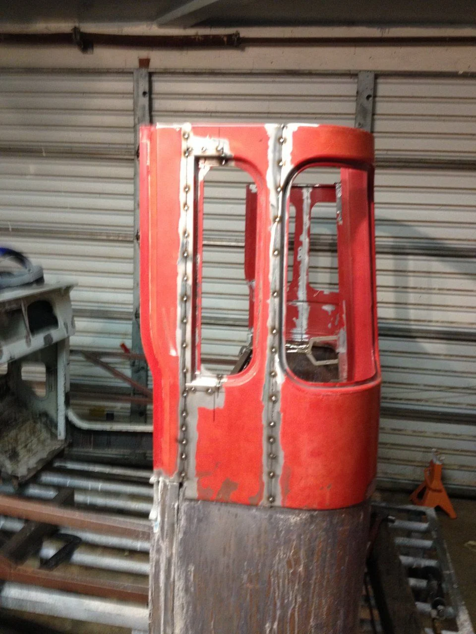

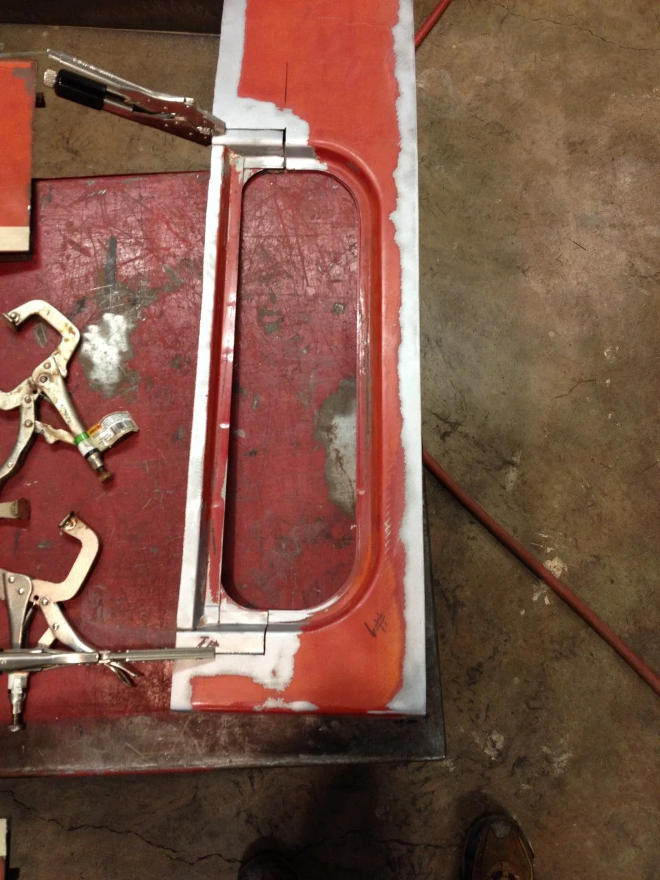

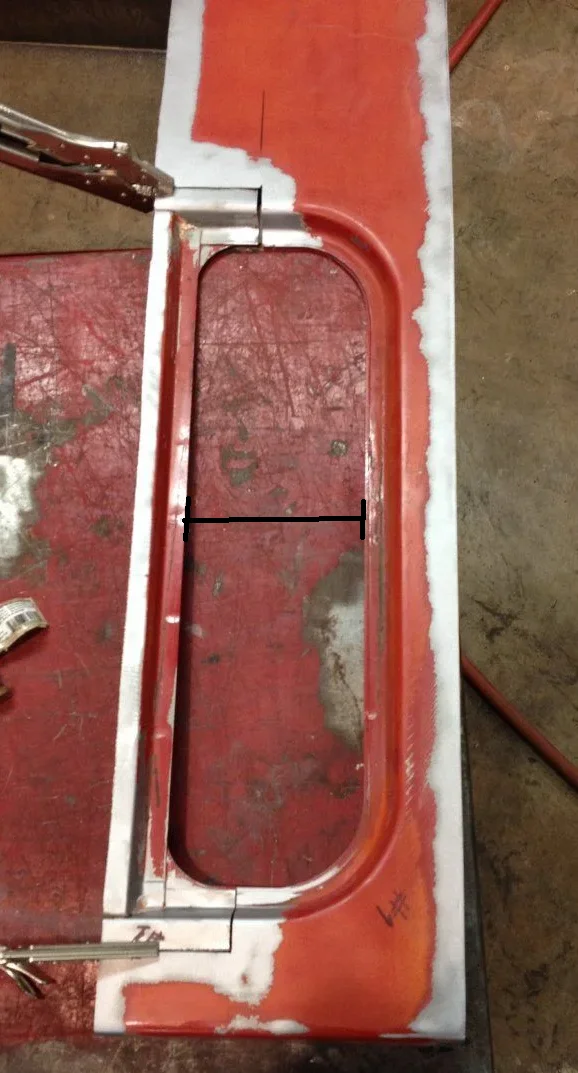

Thought I would share the process of the top and how I came up with my top build. I started with a 79 top so I could have the kick out window just behind the B pillar and make it opening for extra air to come through the cab. The pics will pretty much enplane the process as to the construction of the top. so here we go.
Question for you. How wide did your pop out window end up (on the inside bead) after shortening? It's about 6.75" originally, and I am looking at taking out a bit over 3 inches and wondering how that will compare. Just eyeballing it, looks to be close to what you took out. I was able to remove 2.5" from between the pop out window and rear curved window. Thanks
@47
If I understand you correctly Itis about 1/2 of the distance. correct me if i am not getting it correct.
