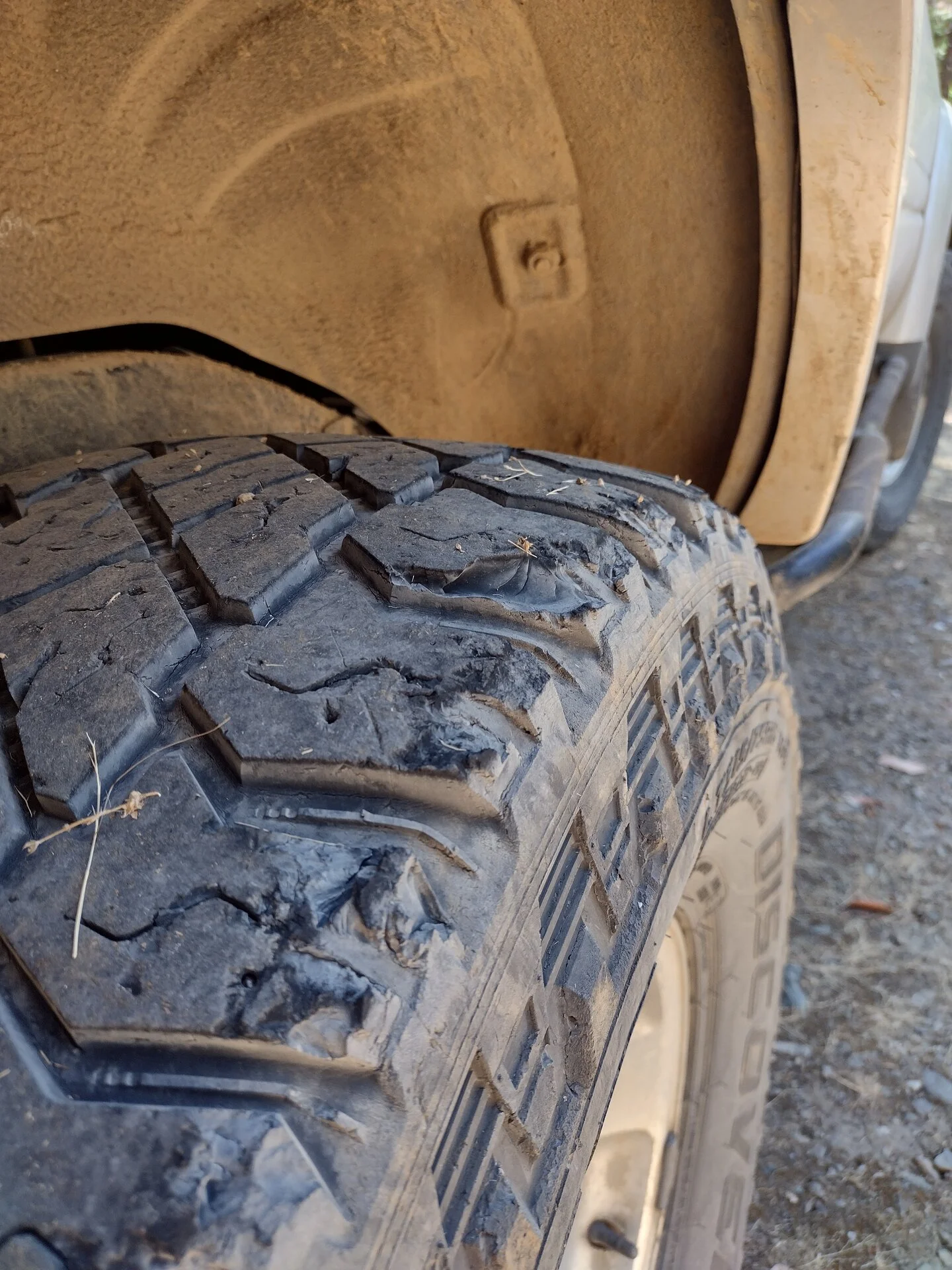

Uh, I ain't got much... Thanks guys, that was fun, lost a little rubber, lost a little paint and got spanked by a stick on the way out-
I'm going to be tire shopping soon anyways 😁

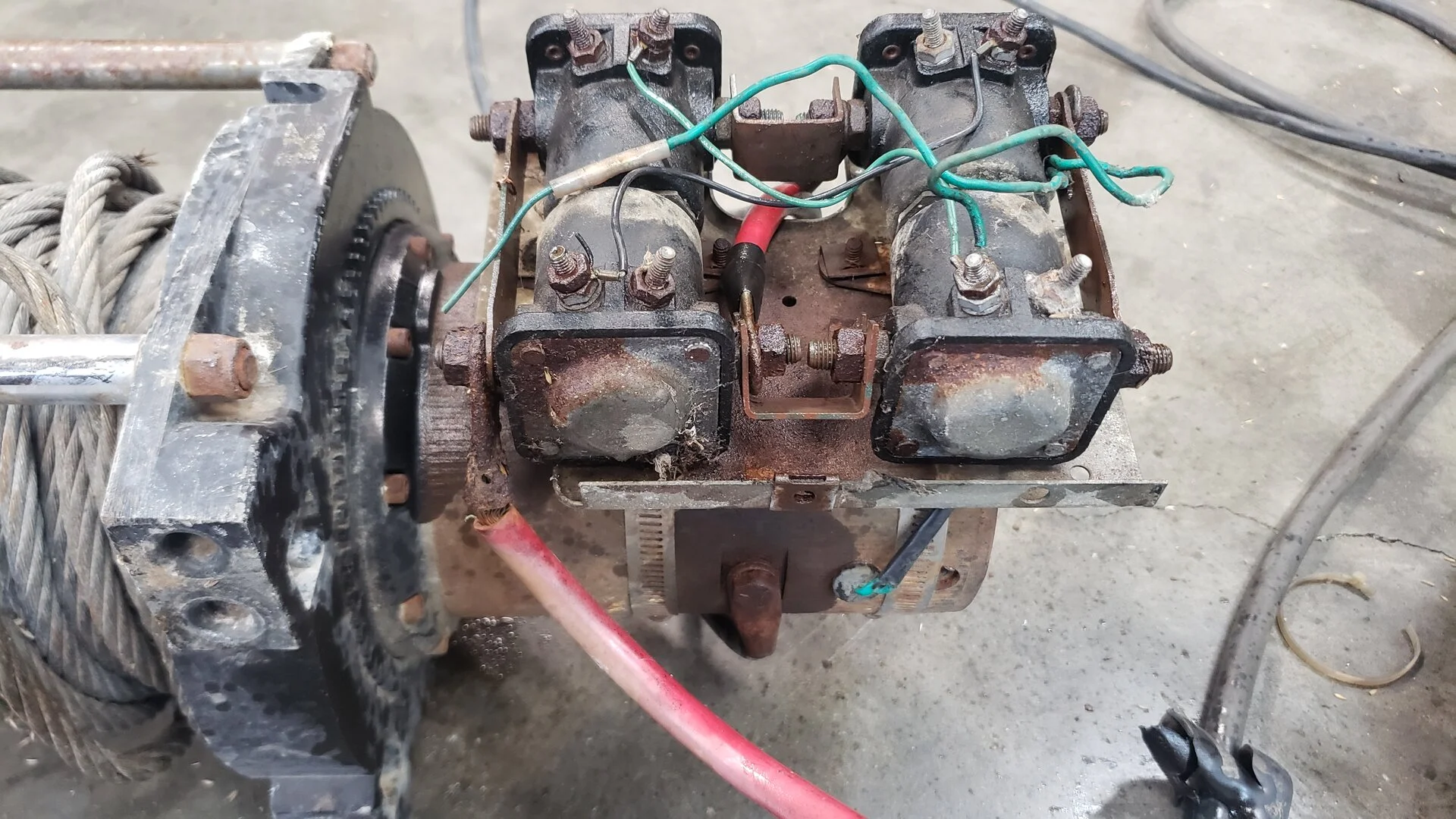

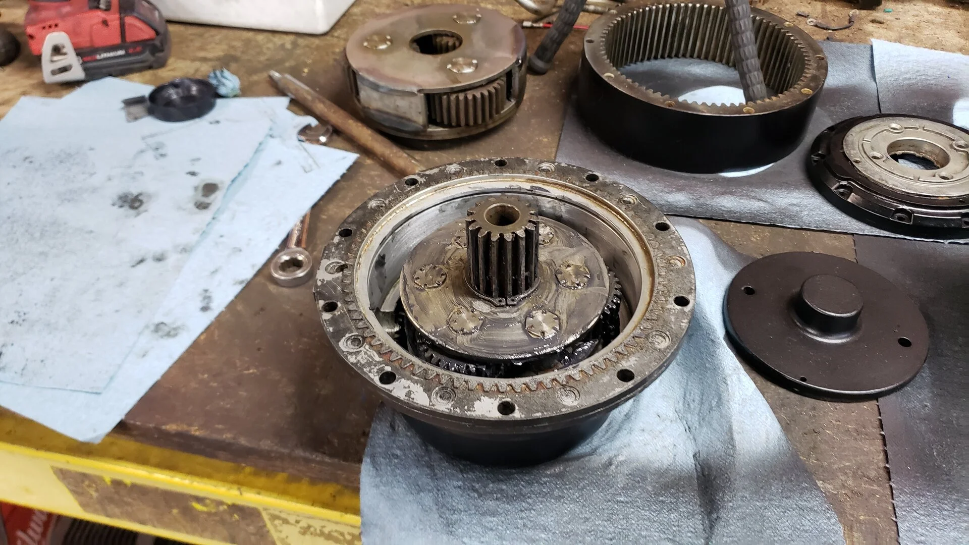

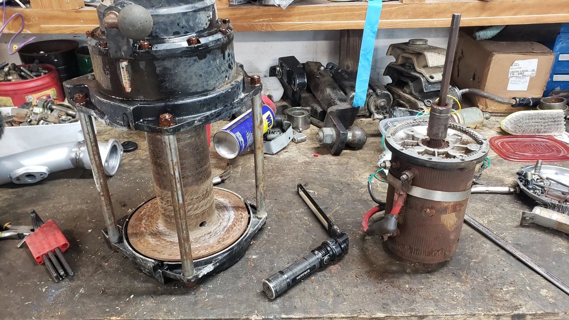

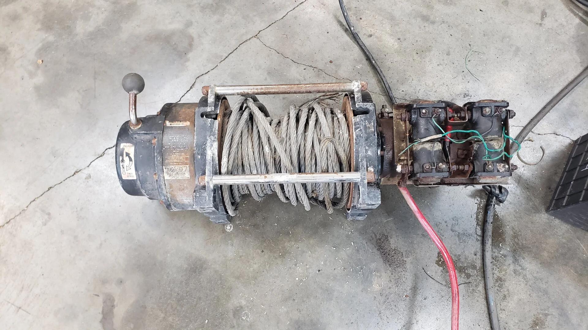

mx12085. i believe these are the original m12. unfortunately its not really clear when warn first started building planetary winches. based on info i can find, im thinking it was 85🤣
finding the origin solenoid cover in good shape is obviously rare. i need to get a remote plug.

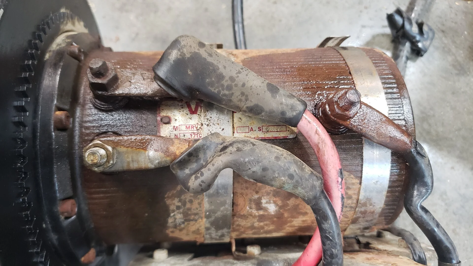

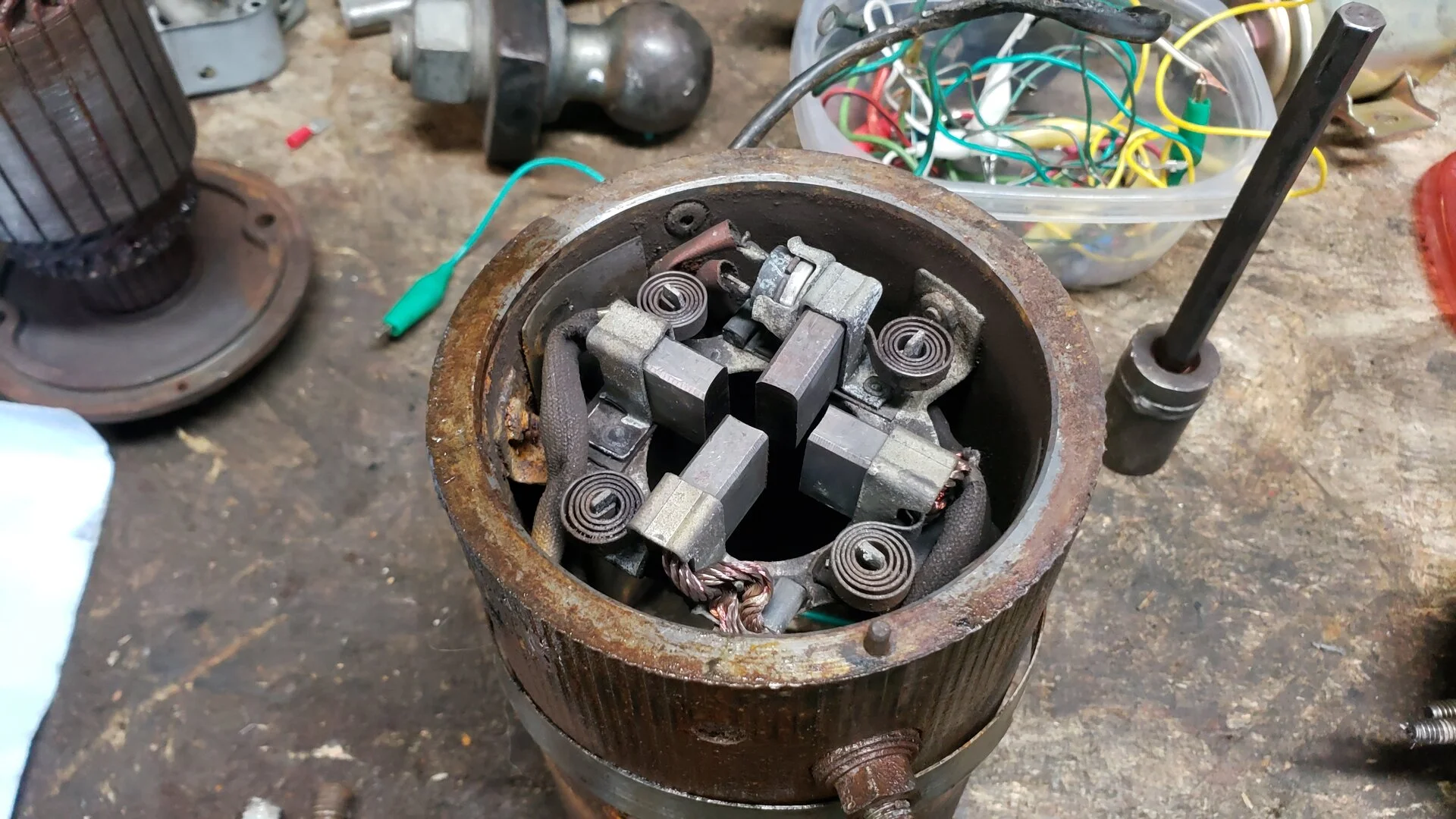

she fired right up when I put power to it. one of the field terminals was super crusty so it was a little slow one way.

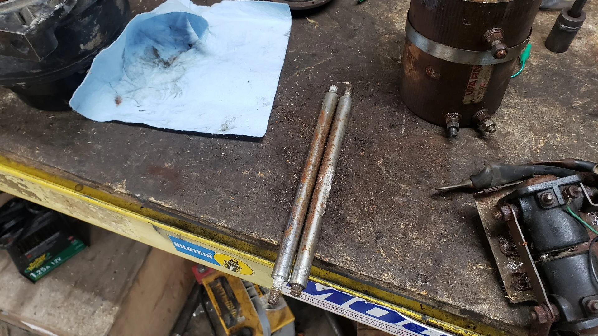

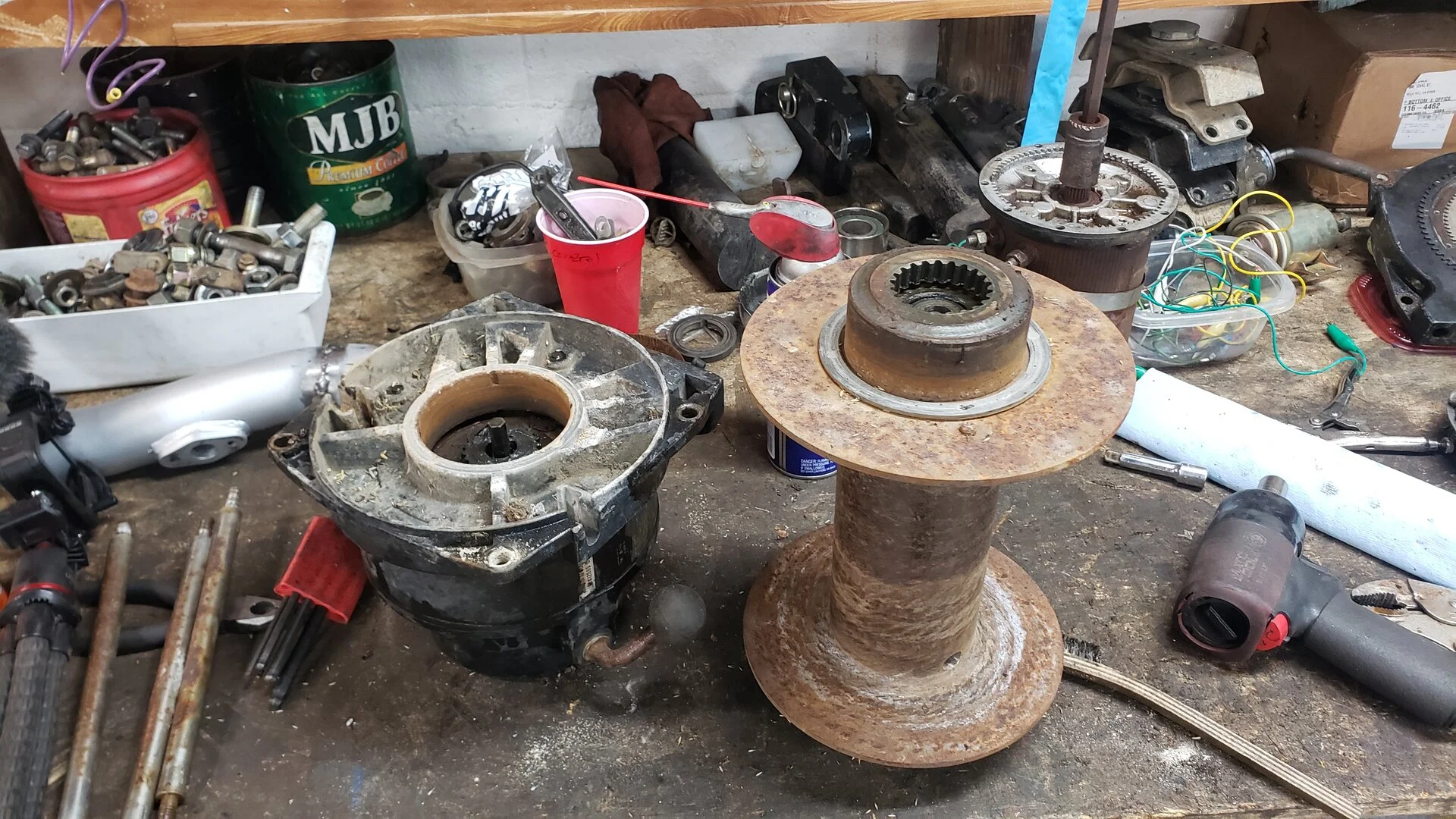

tore into it yesterday. other than the one terminal, one motor screw was kind of hard coming out. also broke 2/3 tie rods because of the rust.

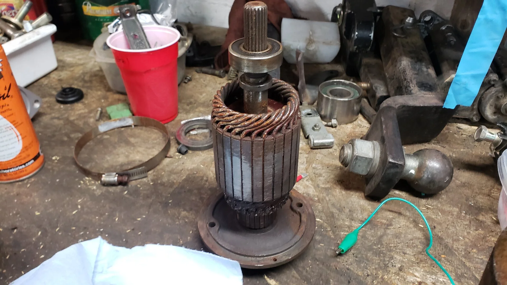

motor is actually in really good shape showing barely any use.

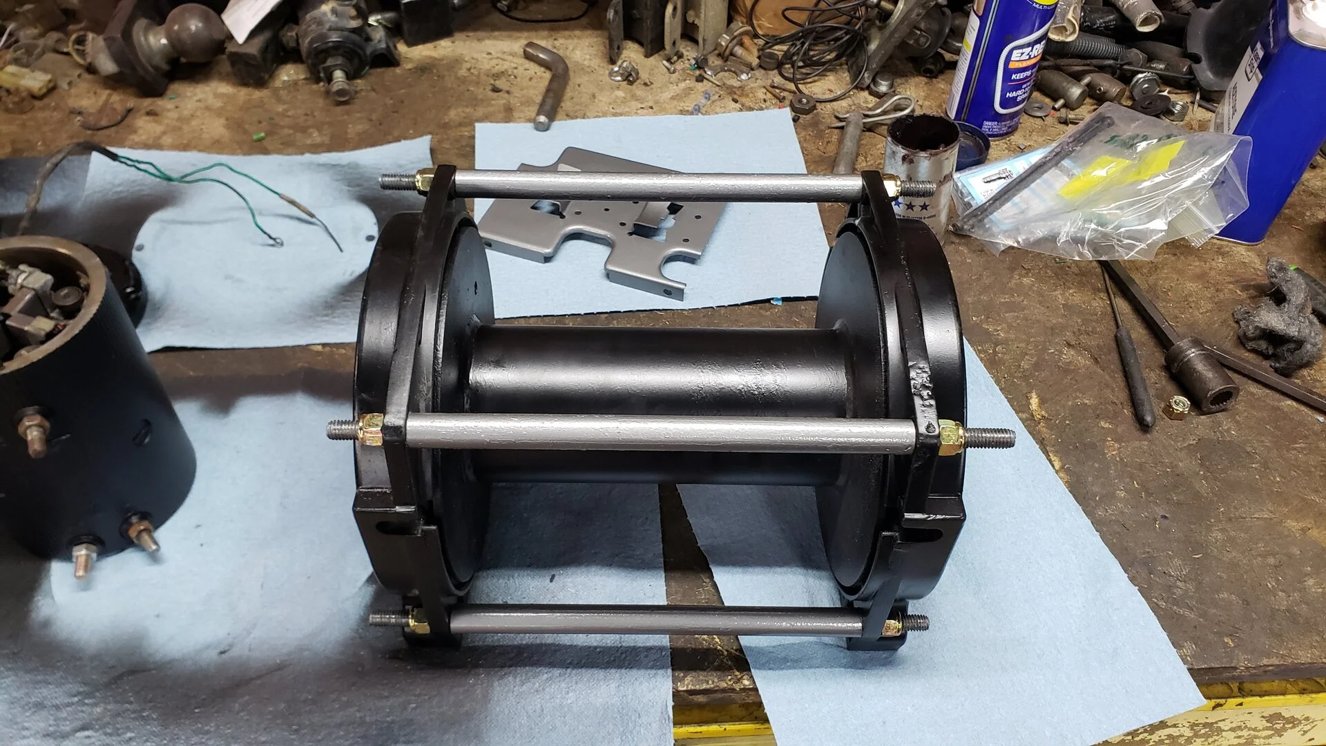

the original tie rods are steel. everything new is aluminium. i decided to remake these vs buying the new stuff. because A) steel vs aluminium. B) the new parts aren't bolt in anyway. C) they're fücking obscenely priced.

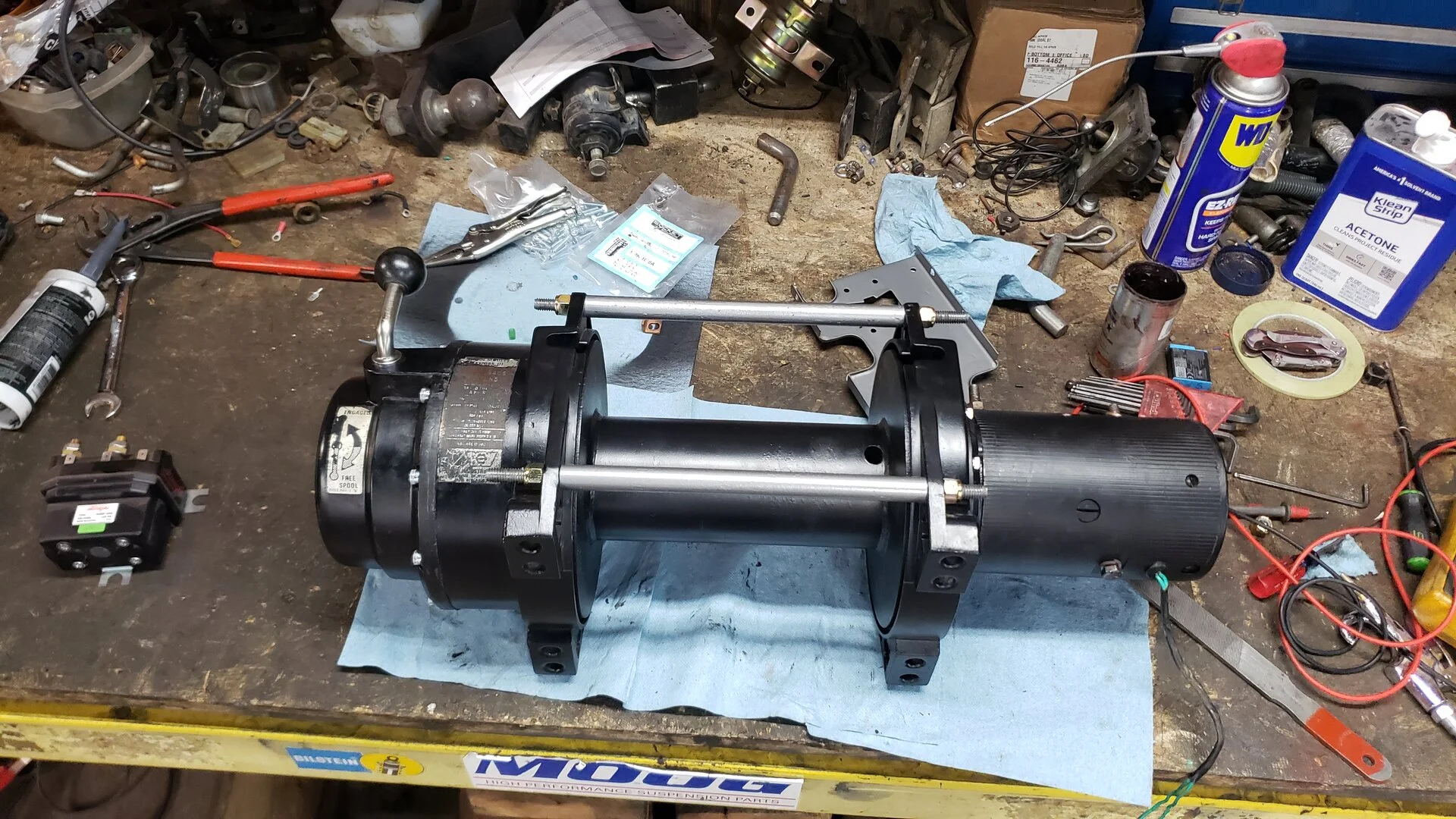

plan is to refinish, add the Albright, cables, rope and remote.
should be able to get more than the $150 i paid. 🤣
