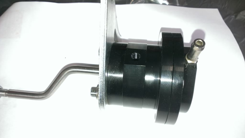

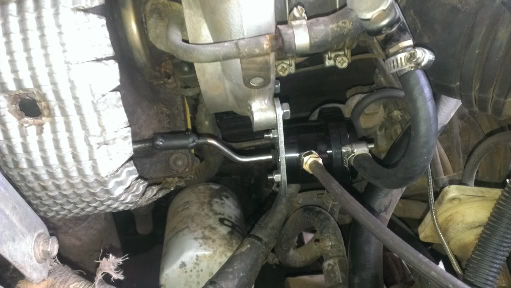

Fitted up a new wastegate actuator, it is a Kinugawa wastegate actuator with a 1.5bar spring. My stock one was wastegated at about 22-23psi but would overboost past about 2500rpm, was seeing 27psi over the weekend:doh: New one holds it at 24psi all the way to the governor. Only job left is to plumb the free air port into my airbox.
[/URL]
