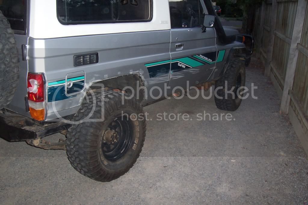

My car had a fair cruiser lean going on, about 1'' fall to the drivers side before I got into it! So yesterday I swapped the rear springs around, nearly level now! Also had to chop the lower rear corners of the rear guards so as my 35''s fitted, they only hit by about 5mm. Also mounted up my fire extinguisher and MAG light to the transmission hump. Last weekend I finished mounting up my new compressor air tank under the car and ran all the air locker lines.

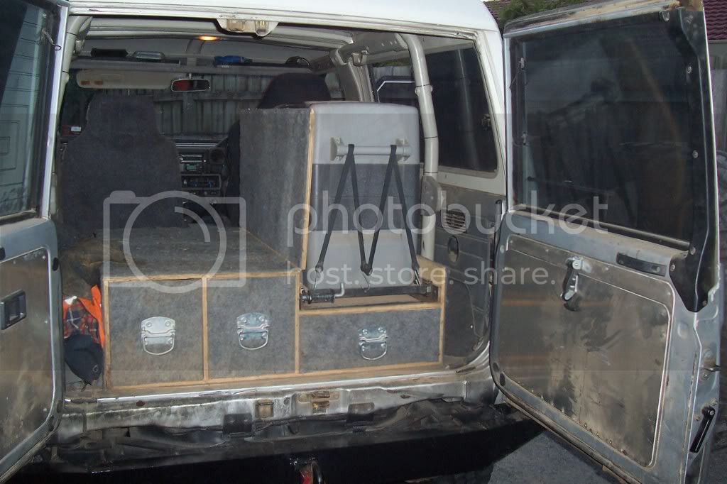

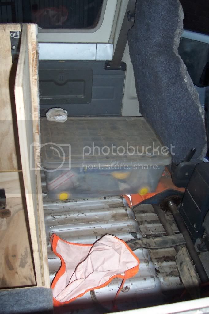

Some pics of the rear draws and fridge. A mesh covered cross brace will be put behind the front seats soon. The gap between the existing draws and the new cage will be filled with a lid and spare parts and low use items stored under there.

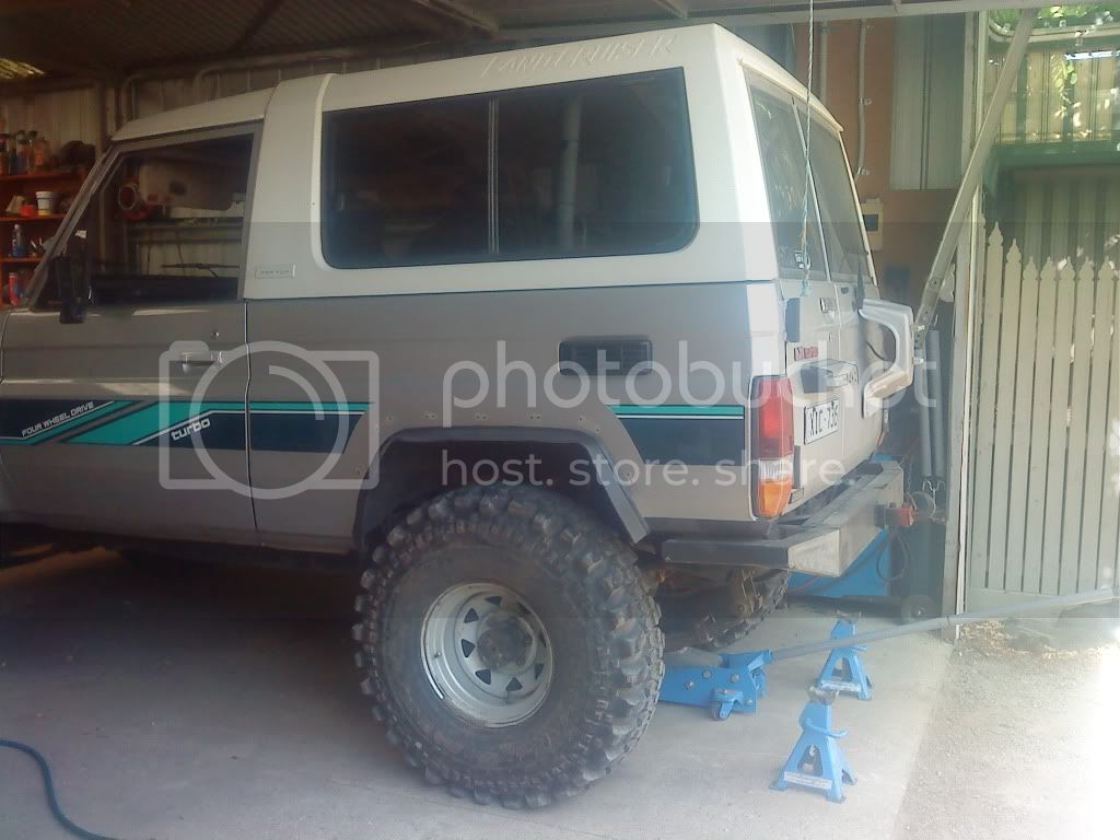

They 35''s fit reasonably well, unfortunately the springs cant handle the load I carry and the tyres hit the outside lip of the guard. Spoke with ARB today, $210 each for their heavy 75mm lift BJ74 springs. Going to get the part numbers and check these against the 60 series rear springs. I do not want to get caught with a to light rear spring as I will have a lot of weight in the rear of the car. At this stage I think I will stay away from extended shackles too, hopefully keeping the car more legal.

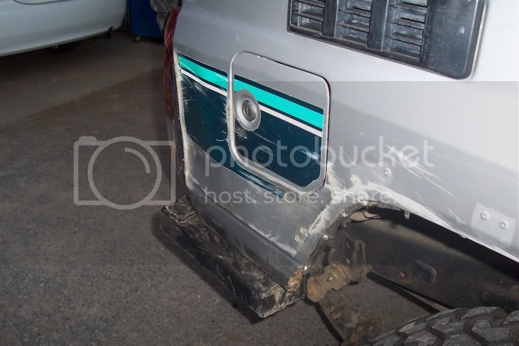

Tuesday this week was Australia day, I had a four day weekend and went away with a few mates. Did some damage to the car, slipped into a rut ~3' deep and punched in the rear quarter panel 2'' and ripped out the rear light. Have knocked most of it out, finding it abit hard to get the last creases out right near the tail light. More photos to come when I get them.

Have started beefing up the cage work, uprights going from the bottom of the step in the floor behind the front seats to the top factory tube are in. Hopefully next weekend the cross brace will go in and it will nearly be done!
