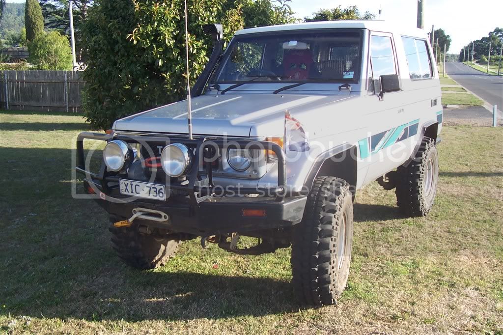

Build Silver Bullet - BJ74 Tough Offroad all rounder buildup

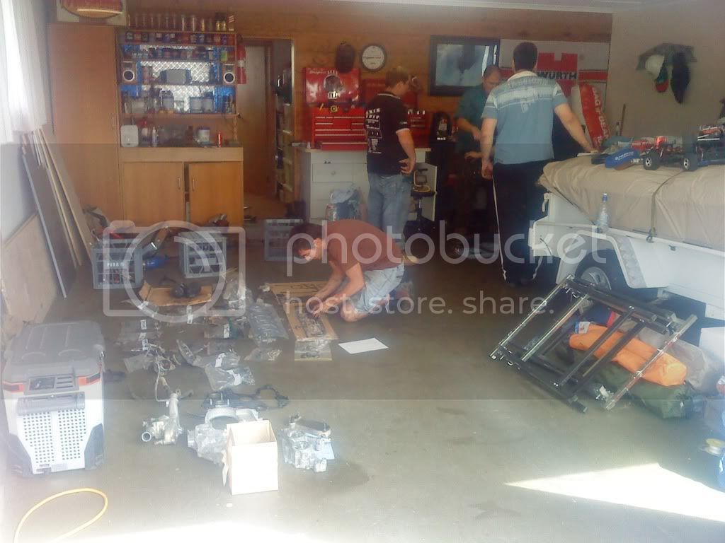

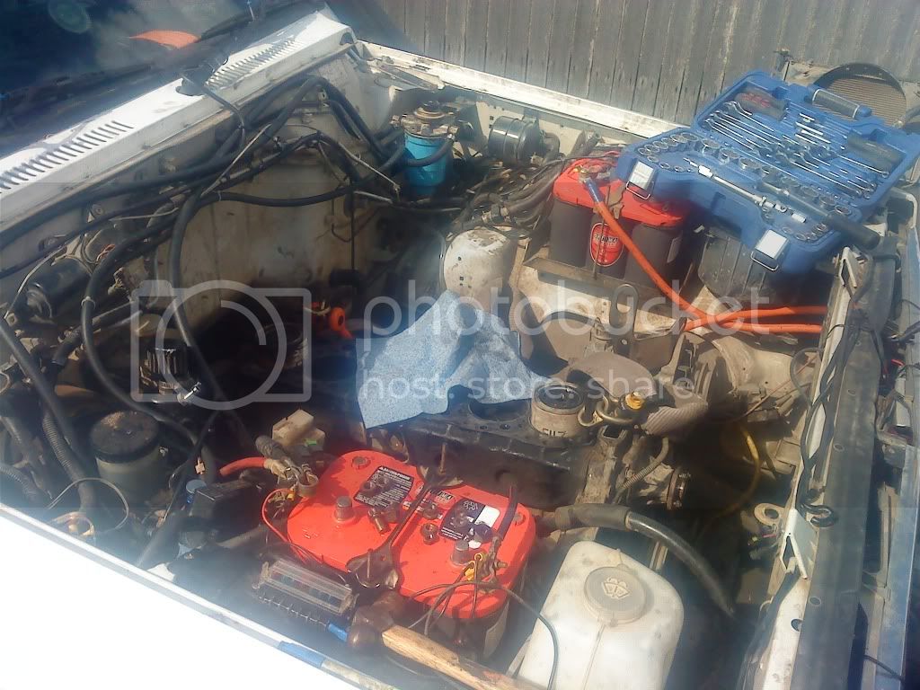

Yesterday was the first day of our Tasmania 4x4 trip with a few mates, unfortunately last night while 140km/h at 18psi boost my mates Nissan patrol lunched a motor. Conveniently we have come across a fully machined unasembled motor. So today/tonight we are building a engine and swapping it in to get on with our trip!
Well got my new gearbox in with clutch and lower gears. When we went to have the clutch machined every blood shop was closed! I had to do it by hand with a grinding stone, nearly 2 hours I spent on the thing!
The lower gears are awesome it is so much better to drive, with even low 3rd pretty useable on most terrain.
Sounds like you are gonna have a great time down there. Dont forget the camera;)
It was a TD42. Not half an hour before the motor dying we left a blokes place who had a machined block and fresh head ready to go. Got the car back there at 11.30pm, 12.30pm had the head off to see the motor dead. 1.30pm today, old motor is ready to be lifted out, everything unbolted and off. New motor just got the timing case fitted, oil housing, fuel pump, head to go. Some pics
Hope to have the new motor in tonight, out driving tomorrow.

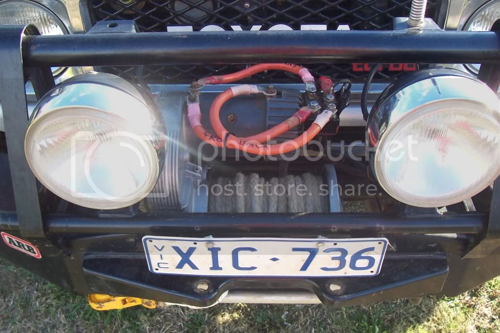

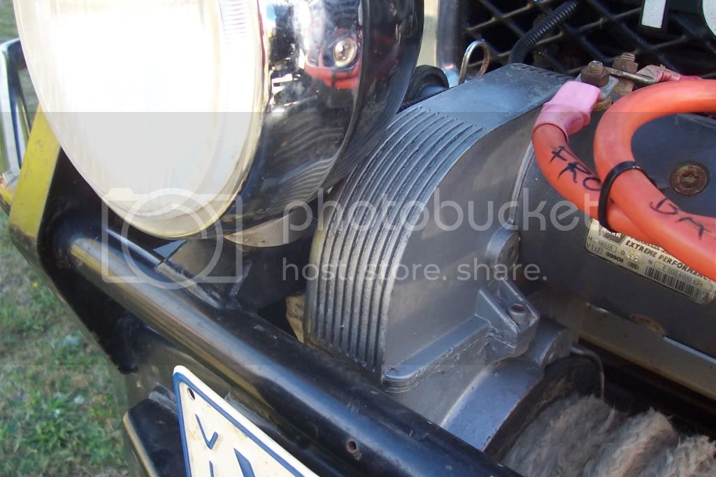

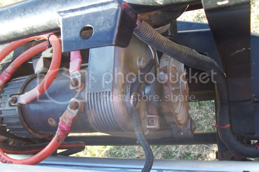

Here are some pics of a Warn 8274 with fibre rope, albright solenoid and 6hp motor fitted. It is a VERY tight fit but everything clears and works well. Unfortunately the winch is only a loner, back to the low mount soon.
Nice truck and excellent work on the roll cage

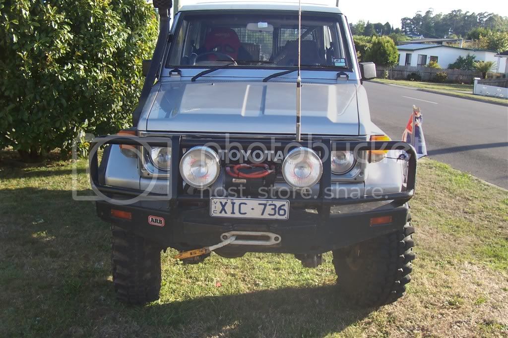

Question for you, it looks like the BJ 74 had an ARB Commercial Bar on it when you got it and then you swapped on your ADR Delux bar, is that correct ?
Reason I ask is I am looking at getting an ARB Bullbar for my BJ and am trying to see exactly what the difference between the Delux and the Commercial is, any comments would be great as I am thinking you have seen both side by side.
Cheers,
I've had four different bullbars, here is a rundown.
-Alloy - s***, good for nothing more than a carpark, after some minor shurbery hits the mounts were ovalled out and later I broke one wing off it and cracked all the welds.
-Old style TJM deluxe winch bar - s***, a mates 80 series reversed into me and pushed it back into my bonnet at low speed, I also hit an embankment with the opposite wing and bent it back 2'', for a steel winch bar they are weak.
-Old style 1st gen ARB commercial bar, very similar to TJM bar above in style and construction, now no the Red Barron with sidebars, has been used for recoveries with no problems.
-3rd Gen ARB 70 series ARB deluxe bar, SIGNIFICANTLY better design and construction than all previously mentioned bars, it sits higher above the chassis rails giving a better approach angle and winch mounting. The bar also fits the car shape better. It is heavier than the other bars I have used but I want the extra beef. I have had no trouble winching, hitting trees, embankments etc with it, hasnt moved at all.
One if my mates has a 2nd Gen ARB 70 series bar which is similar to mine but the winch mounting is a little lower and the wings angle more to meet the guards, it is also a good bar to have.
