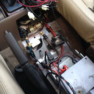

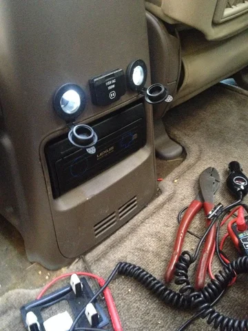

Like you I had to make my console fit my needs. Here's mine. Added led's in the power outlets, led in the console, additional fuses behind the changer door, and the invertor in mounted where the changer was. 4ga power wire coming from my secondary battery. All wiring is on plugs so I can quickly remove the console for service.
View attachment 1147324 View attachment 1147325 View attachment 1147328 View attachment 1147329
I had seen this before and the light coming out of the 12V sockets caught my eye. So you added LEDs inside the sockets? Could you share a close up pic of where exactly you installed the LEDs?
