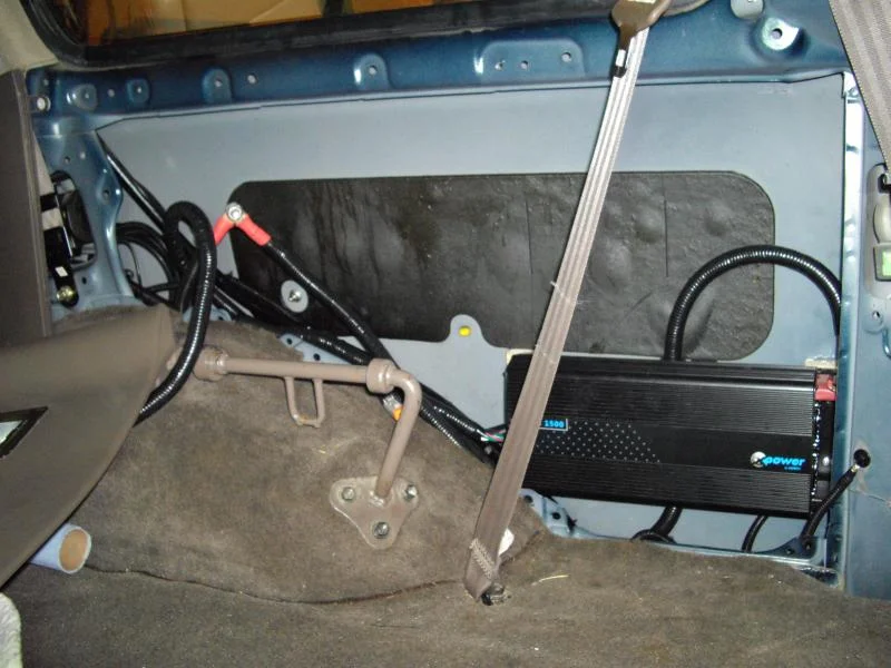

I started my project last May and got interruped several times over the summer with projects around the house. Today I finally got around to finishing up the wiring to my inverter. I have summarized what I did below:
-Photoman's alternator brkt
-130 A used alternator
-Upgraded alt wiring and 175A fuse to isolator
-OEM second battery tray
-Handmade washer bottle relocate brkt
-120A battery isolator and two marine switches
-Odyssey battery
-Xantrex 1500W inverter with aux cooling fan
-Lots of wiring, misc lugs, terminals, plugs, fuses, heat shrink, and tiewraps
The main battery is only for the engine starter and the aux battery (Odyssey) provides power for the vehicle chassis and winch (yet to be installed). One of the switches will provide power to the winch when needed, and the other will be used to combine the batteries if needed.
Future plans include adding 12VDC sockets to the rear and front, a 120V external socket (OEM Tacoma bed version), and perhaps a 400W inverter under the shifter console. I just ordered a Hella map light, and will install that in the next few weeks. Overall I am very pleased with the results, but it took a lot longer than anticipated, and cost a lot more too. I think overall I have over a grand invested in the system.

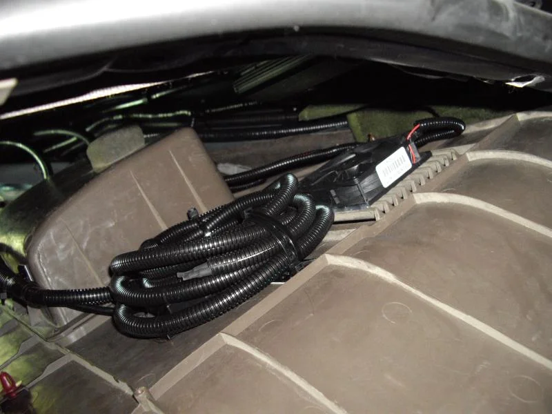

Some more pics.

What is that junction where the two big wires are coming together below? From the picture it looks like they are just "floating."
attachment.php
Those two wires were just joined together temporarily while I did some trouble shooting (they are normally attached to the ON/OFF/Disconnect switch). When I first fired up the inverter, I noticed my aux cooling fan did not spin. At first I thought I had f&&ked something up:frown:. After some investigating I found out the cooling fans in the inverter only come on when required (my aux cooling fan is wired in parallel with one of the inverter cooling fans)
As an aside the inverter is just screwed to two wooden blocks I hot glued to the rear quarter panel. It took a few attempts to get the wood to reasonably match the surface contor of the quarter panel as it was not flat as I first assumed:bang:.
