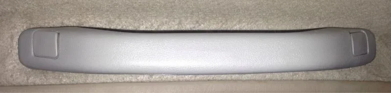

Ordered driver side grab handle from Beno, with the lift and larger tires, it will be nice to have.

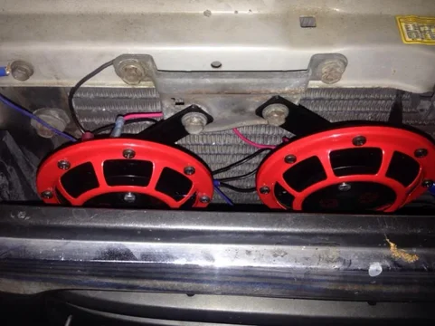

Received my hella horns. Trying to determine if I need the relay piece that is included.
I will Install them tomorrow.

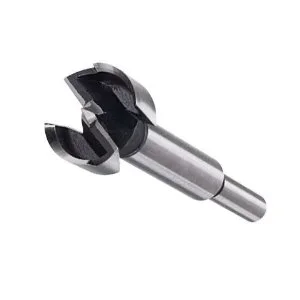

Take a cordless drill with a 1 1/4" forstner bit like this:
Drill the two holes, remove the flat nut type piece off of the main plug of the USB outlet, put it through the hole that you drilled. Put on the flat nut from the inside of the center console. Tighten.

Installed the grab handle this evening. It's OEM but not the perfect color.
Finished hella horn installation.

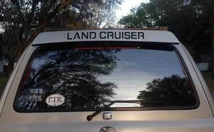

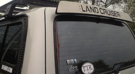

My rear "Land Cruiser" emblem is faded plastic, it was driving me nuts, I wanted to create something for the rear spoiler, something that stood out, like a Land Cruiser should.
This is my first pass at this new project, I'm pretty happy with it. :)
cool, can you re-mount your camera behind/between?
I think I have enough room to create a mount point there for my camera. It's the perfect location really. I've got to design a bracket for it so it works like it should
