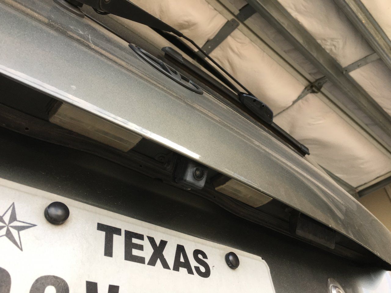

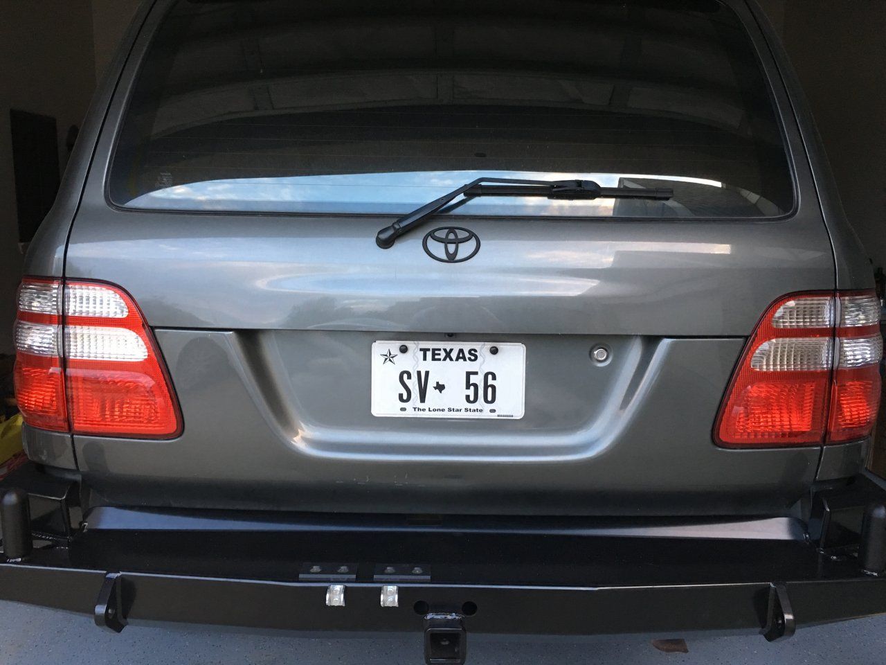

Yay! What did I win? :clap: It's an Alpine camera, not sure the model #, but they come with the mounting bracket.
Doesn't help with twin wheel carrier.
No it doesn't, but for people not running carriers its clean and factory looking.
