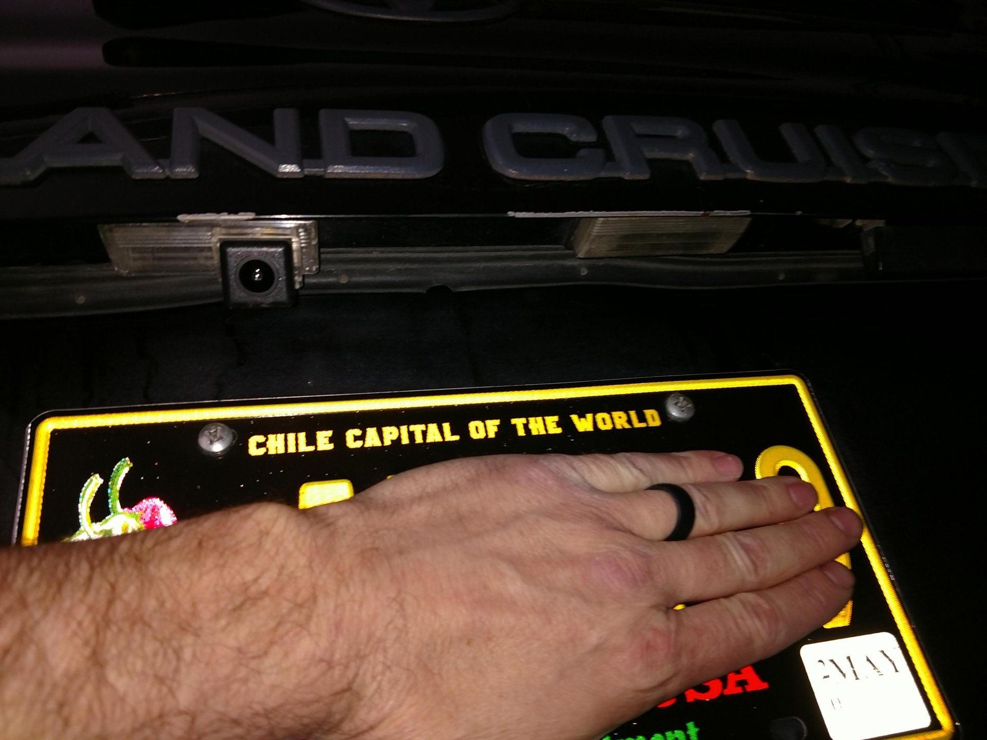

I bought a cam that was designed to replace one license plate light, using the same snap-in mounting. Still has a light on it, looks factory, no new holes.
Can your share mole details on this camera? Amazon? Enquiring minds want to know.
I have one of these as well, purchased on ebay. Try and get one with straight lines not the predictive ones.

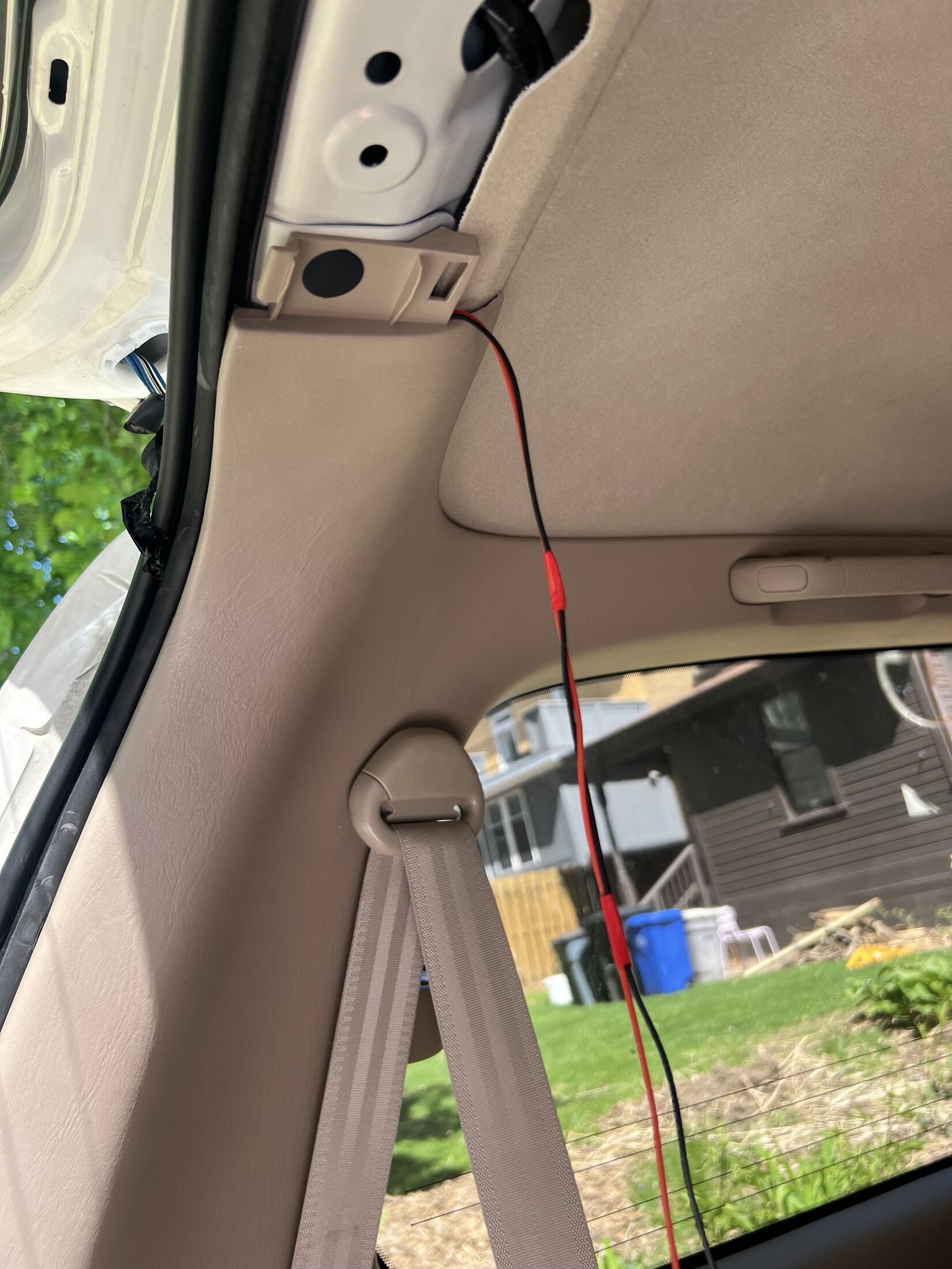

Just added a backup camera to our new-to-us 1999 JDM UZJ100.
Installed this camera:
aSATAH 12 LED Car Rear View... https://www.amazon.com/dp/B07MWDQYV4?tag=ihco-20
And this monitor:
Backup Camera Monitor Only - 5... https://www.amazon.com/dp/B019GQLNJU?tag=ihco-20
So a whopping $50 or so in parts.

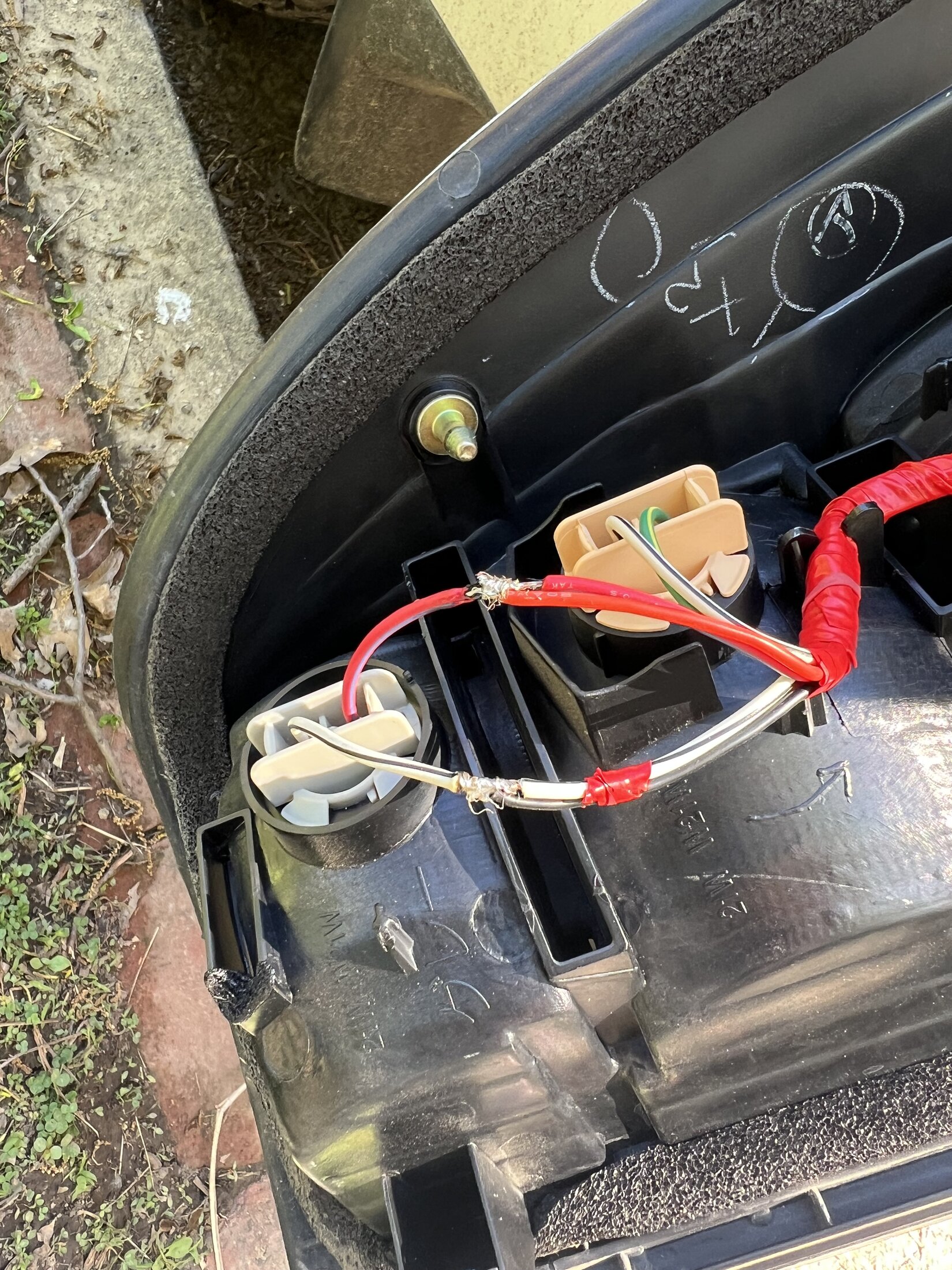

Tapped into the left backup light power and ground, cutting off a little insulation, poking new wire through, then twisting and soldering.

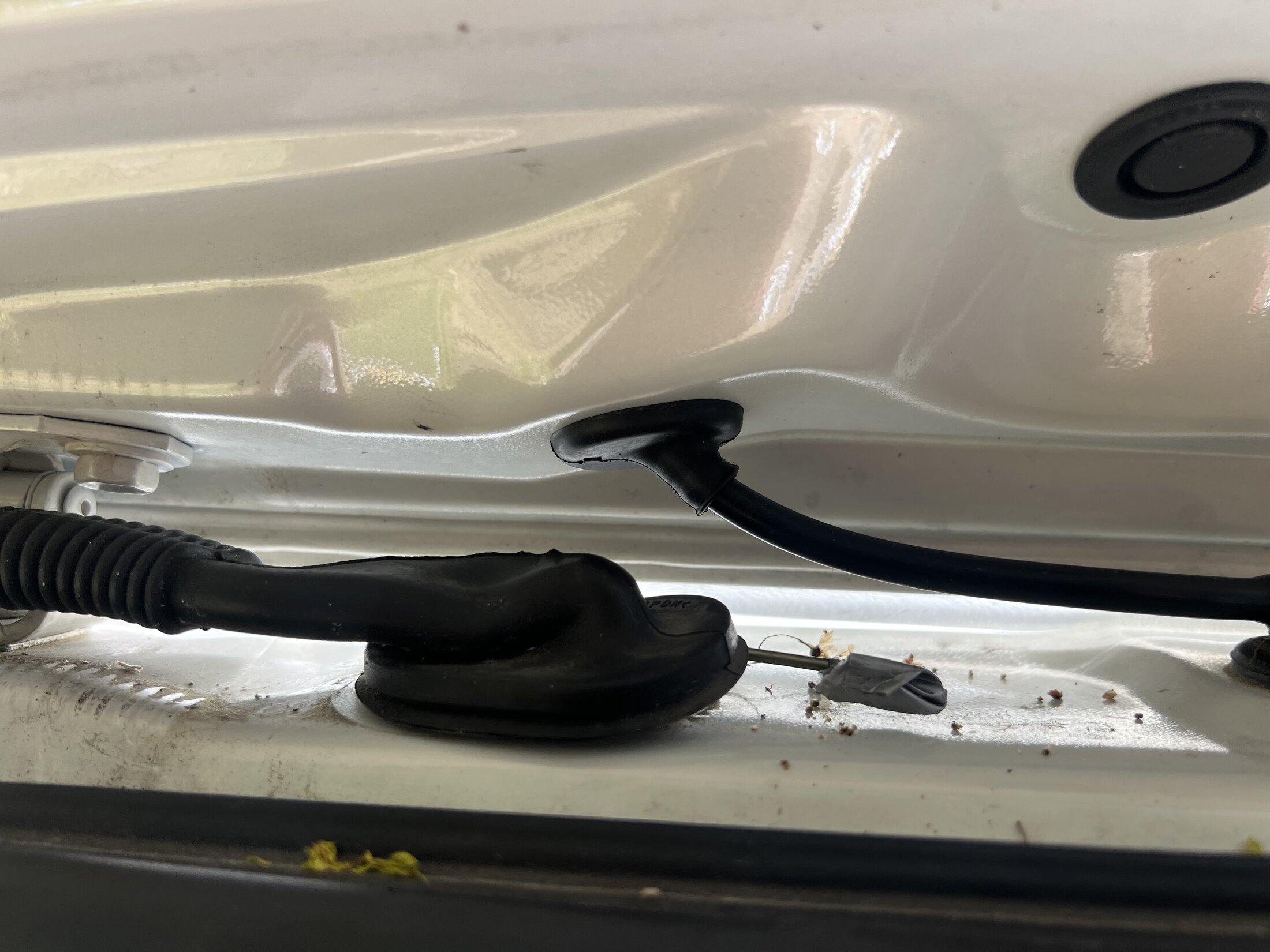

Ran that up to the top rear and then used a coat-hanger to fish it and the RCA cable for the monitor through to the tailgate.
For the monitor, I ran the RCA down the right side of the cargo compartment then forward along the trim to the driver’s (RHD car) footwell and up to the camera. For power I traced the power lines for the Japanese toll thing (Japanese ezpass—japanezpass, if you’ll pardon the expression) and removed it and commandeered its ground and switched 12V connections.
Works great and is a total game changer—we couldn’t for the life of us tell how far we were from other cars…our ‘04 has a backup camera, and we always took it for granted…
