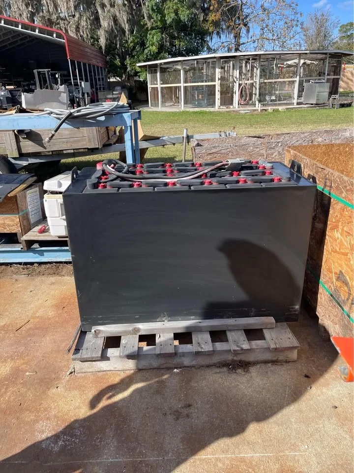

I do see forklift batteries for sale on FB locally. This one for example:
This has the wrong dimensions but looks like I eventually should be able to find a deal on a battery. @cruisermatt took a leaf out of each of the rear springs of my 70 pickup but I think the old boy should handle 2900 pounds on-road (hopefully).

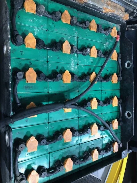

The battery in my Toyota is of the molded bussbar type, but several of the cells are iffy. Thought about doing the bypass thing. Might try it on one cell just to see what happens but long term I think I want a new battery.

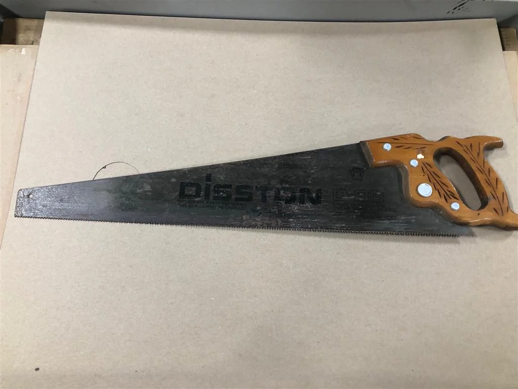

I have an old Disston just like that, I've used it often, although it has been awhile.
I suppose the fused lead bars might give lower resistance, but dang, bolt-on leads is so much more versatile if you have a bunch of modules that can go bad individually. (Btw, there are bunches of vids on YT showing folks in Pakistan casting lead in place to replace electrodes etc on lead batteries, pretty neat and seems easy enough.)
I would think bypassing a cell or 2 would not be a big problem, like 46V instead of 48... A bunch though might tax your motors.
But one issue would be if you have some bad cells, that suggest the whole pack is on its way out. So do you want to throw money at it piecemeal? And at what point do you stop?
