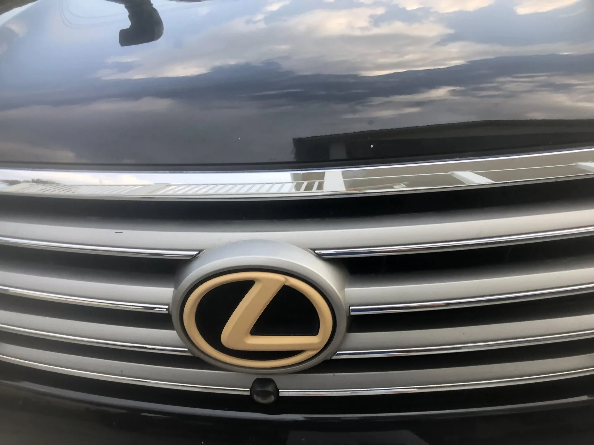

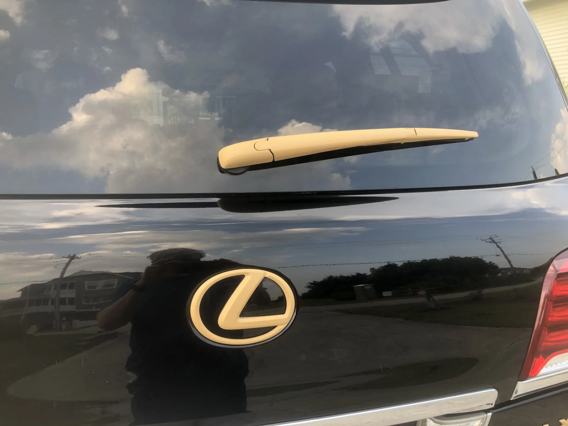

Planning to hyper or plastidip my 'L' logo emblem, and just remove the others. Any suggestions there?
Front grill DIY recommendations? Wrap or paint / dip?

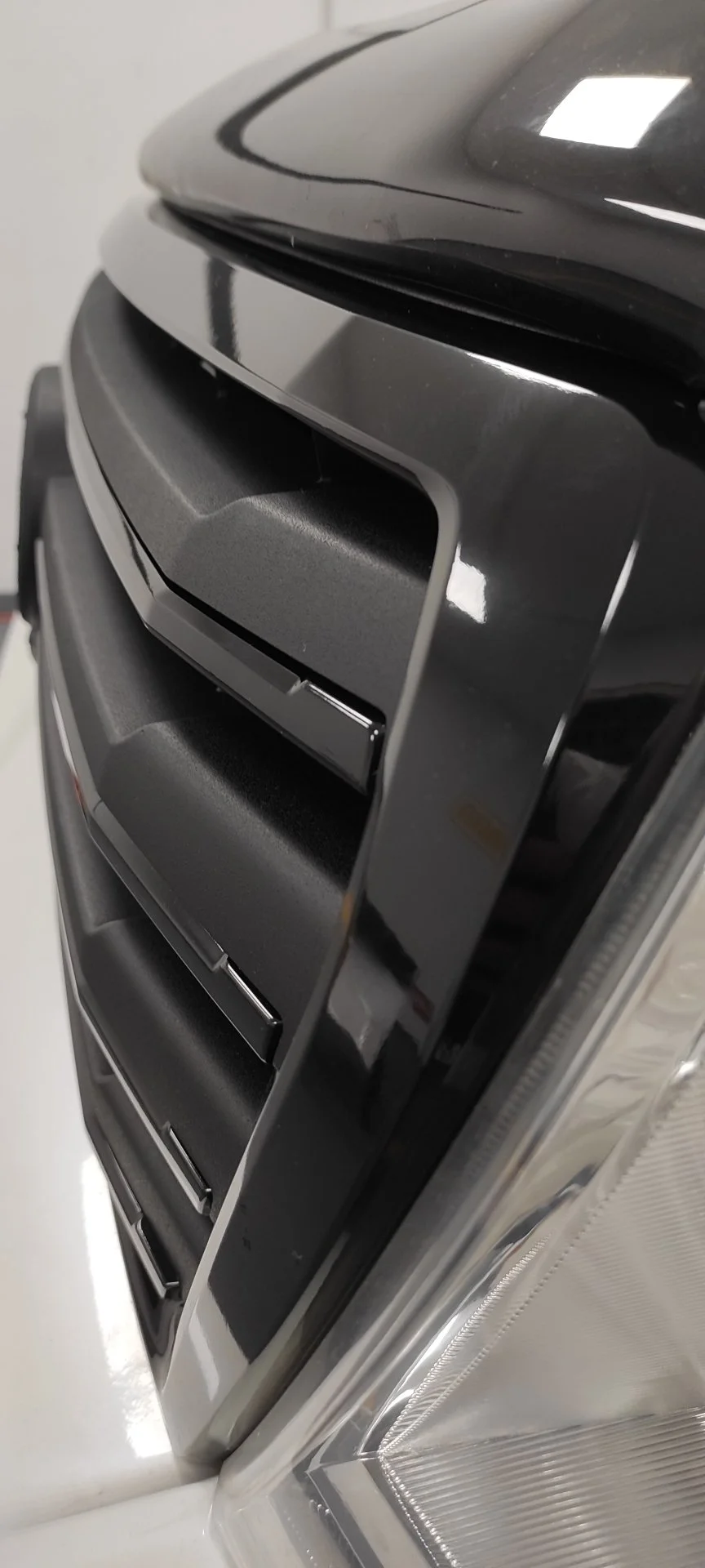

Even the front grill has a lot of prep to remove but due to its design, it will have to come off the truck for paint.

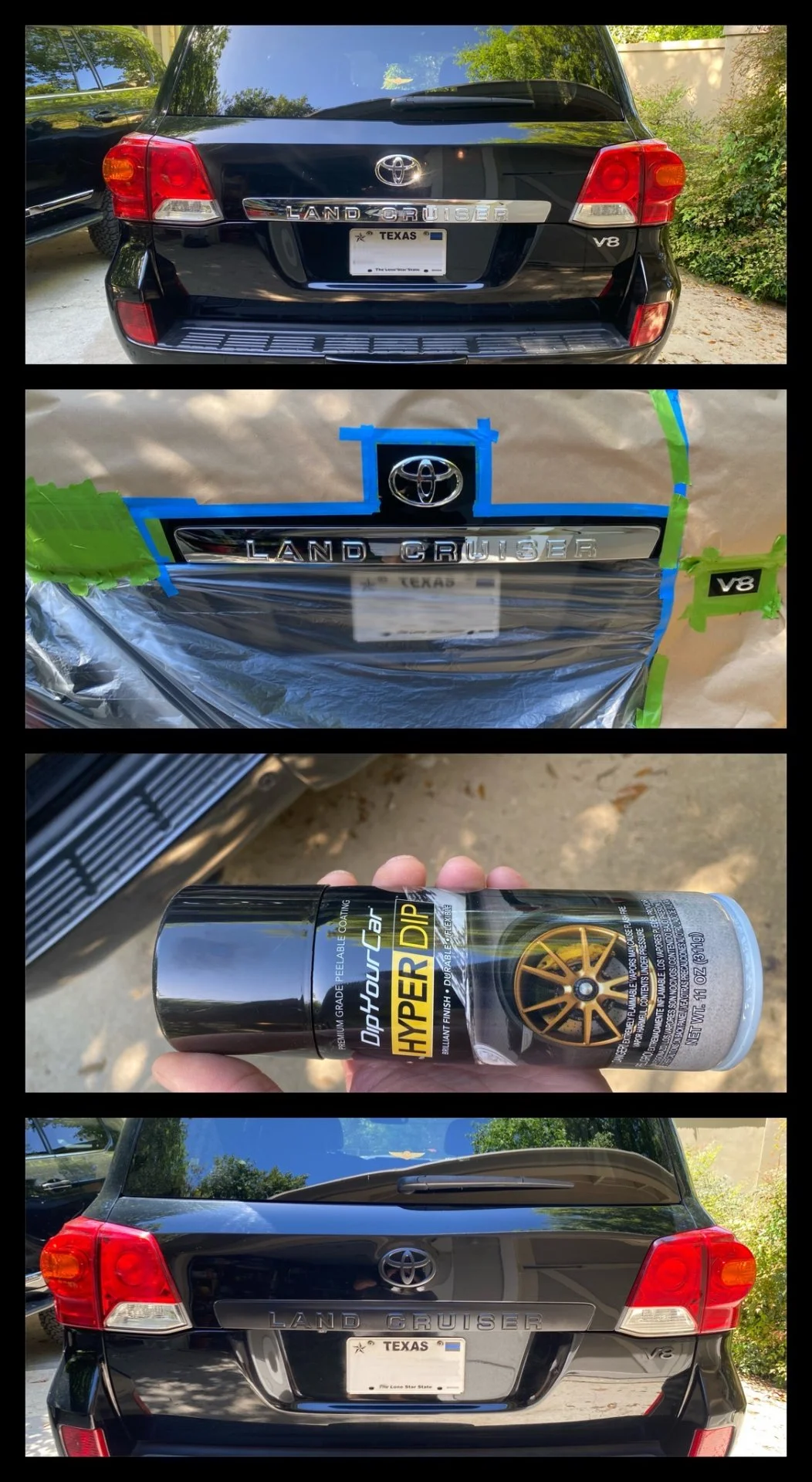

I've found hyperdip more durable than plastidip. I removed all trim parts (except the rear hatch emblems) for painting. I prepped and treated them just like I would for paint.

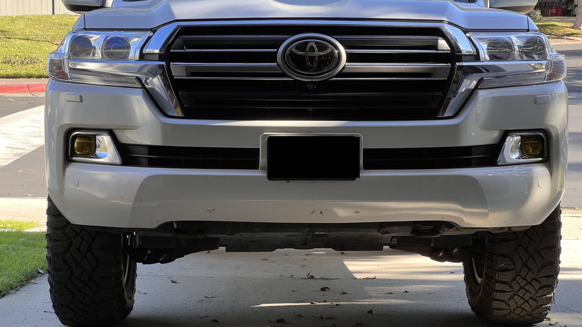

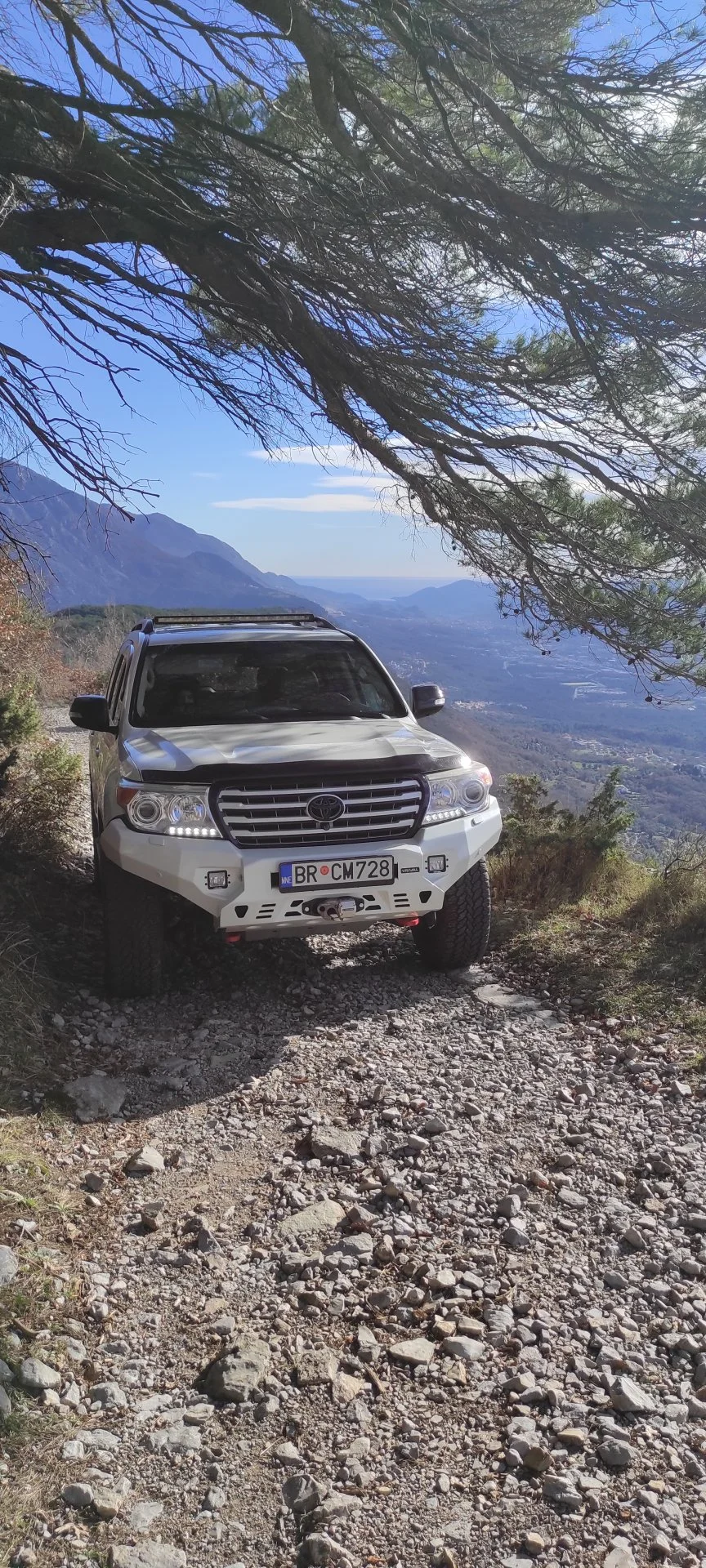

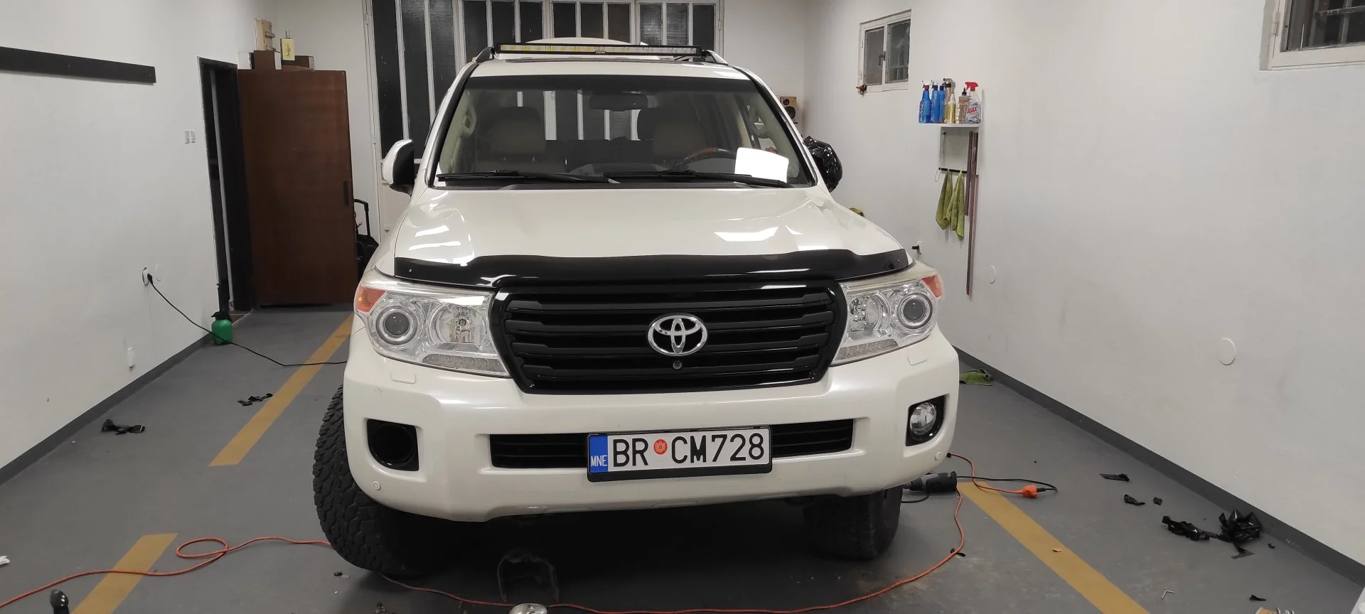

I used 3M satin from Amazon to edit my grill… Not the easiest thing to do, but with some patience it should do the job…
3M Satin

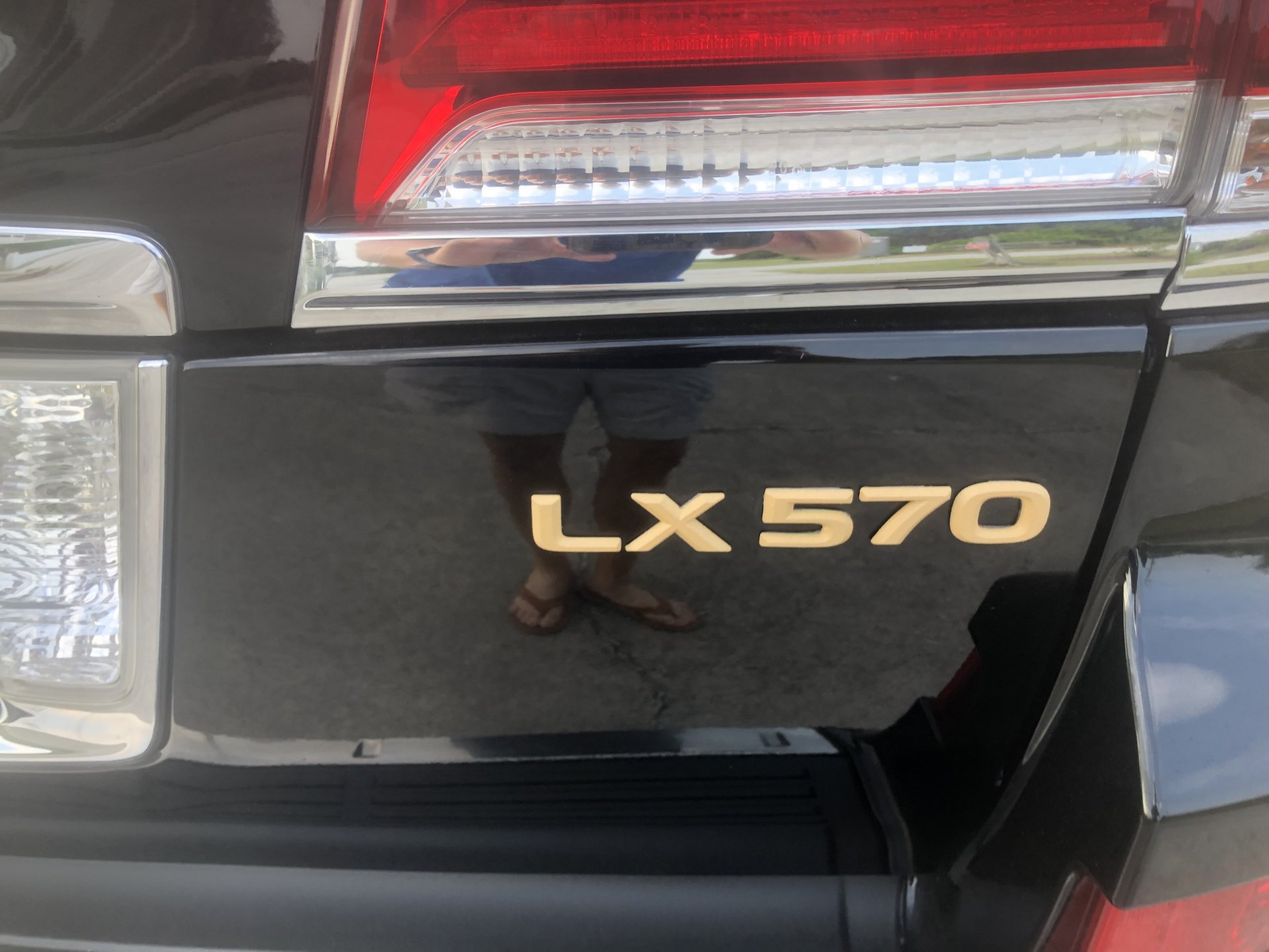

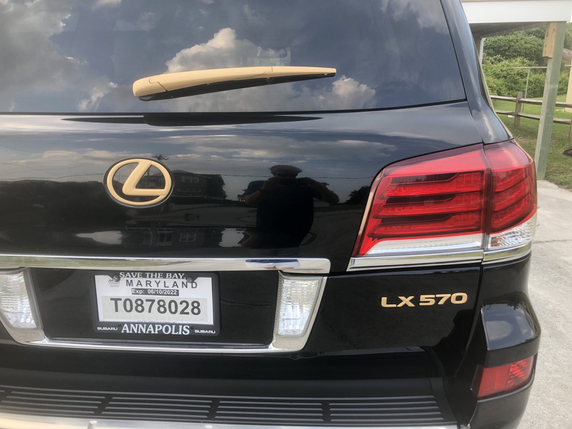

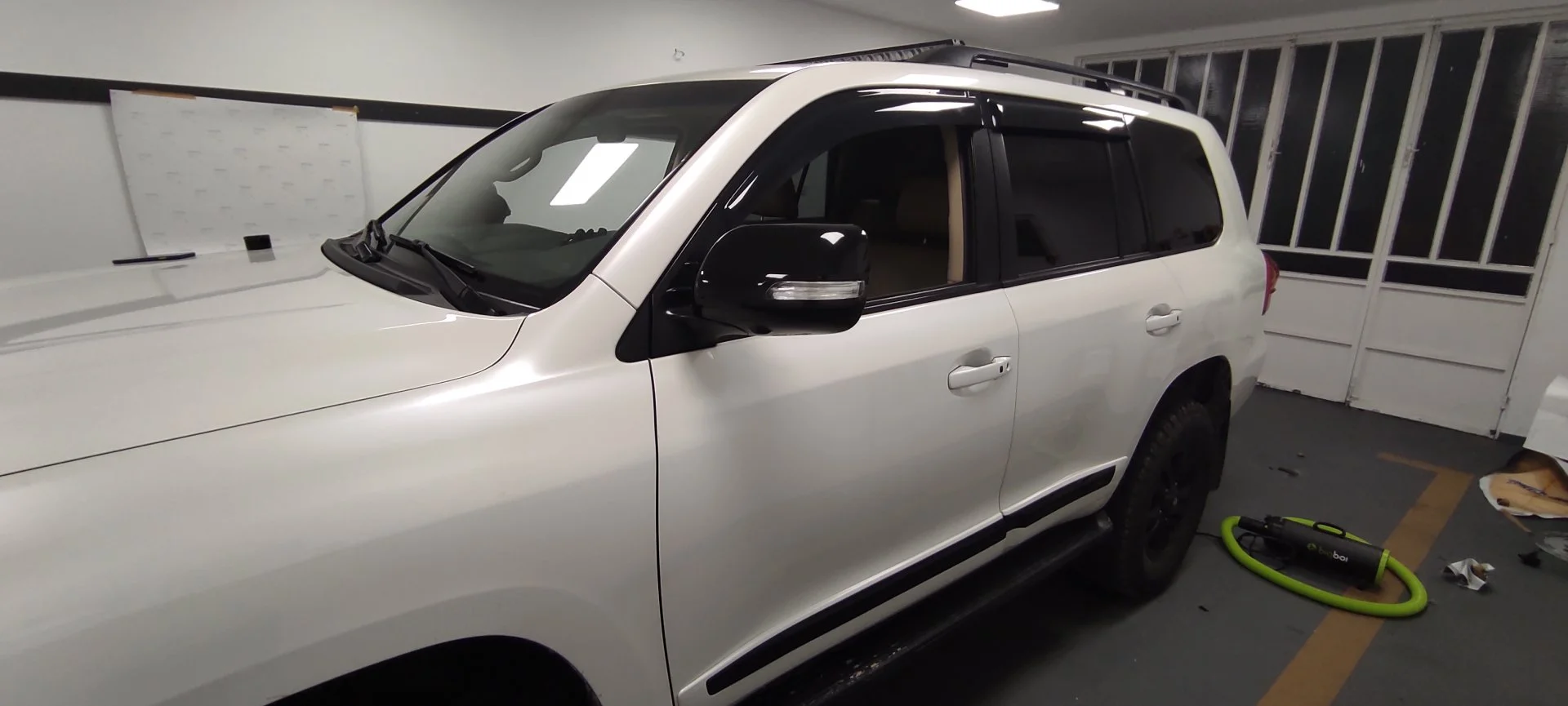

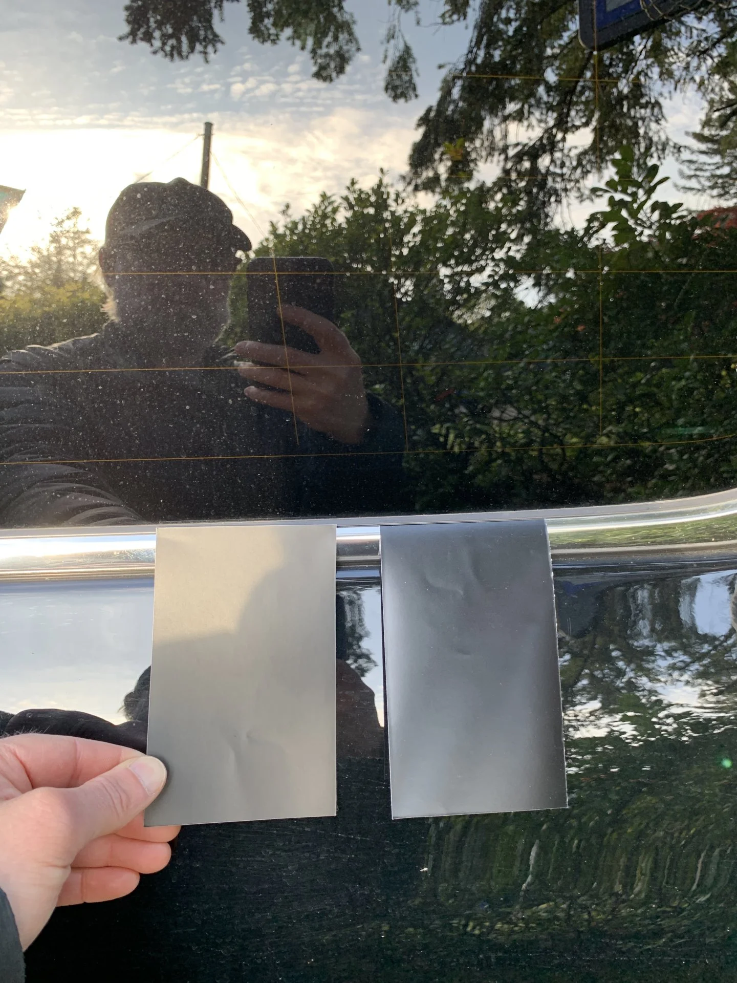

I just ordered new window seals for mine with the land cruiser part numbers since the rubber was getting old anyway. Wrapped the back side window chrome door strip chrome in matte but I think I’ll end up redoing it in satin. It looks good but it isn’t the same shade as the new doors.

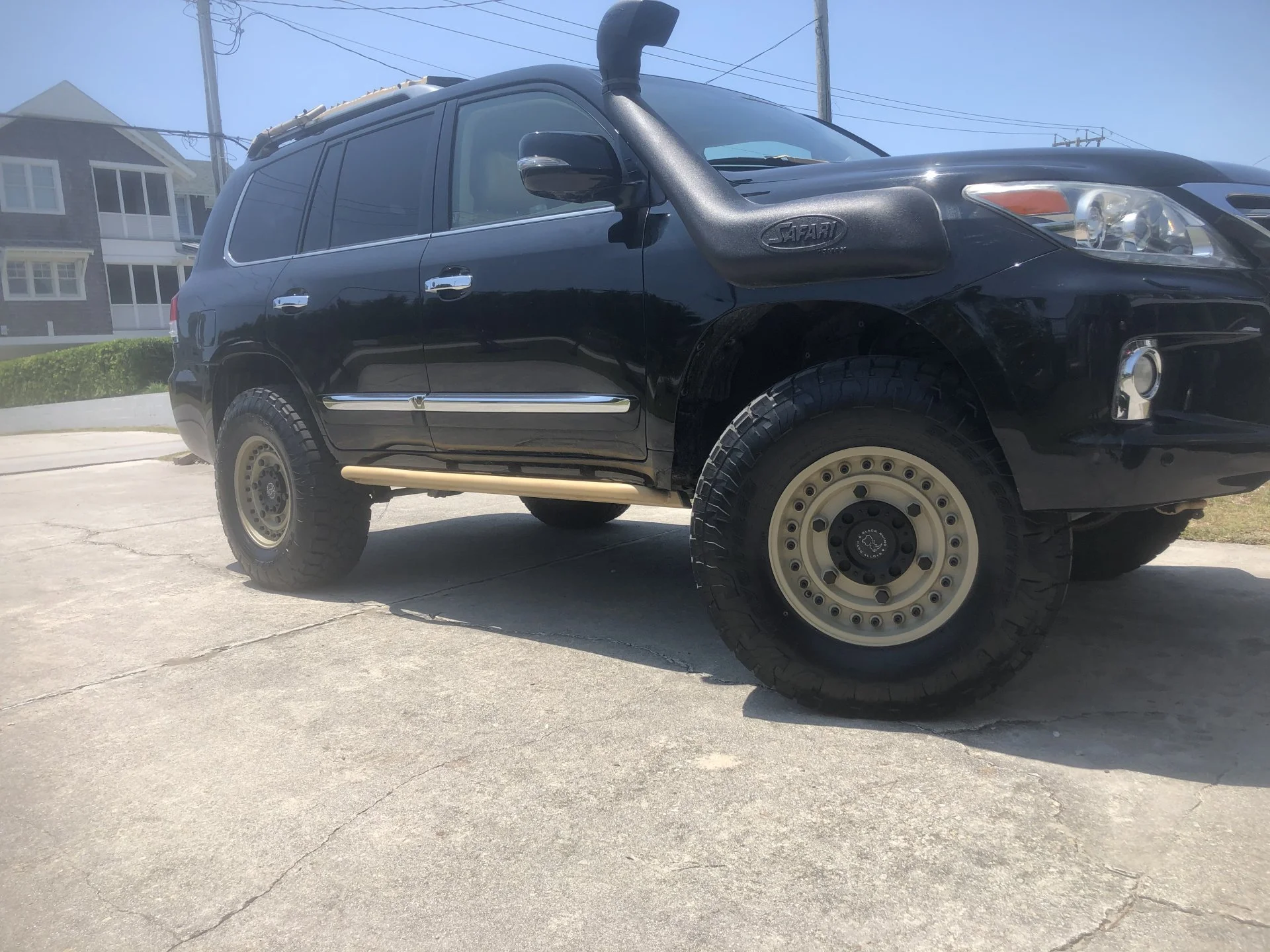

Trying to figure out what to do on the handles. I do t think it looks too bad in chrome and I don’t want to lose the touch to unlock feature

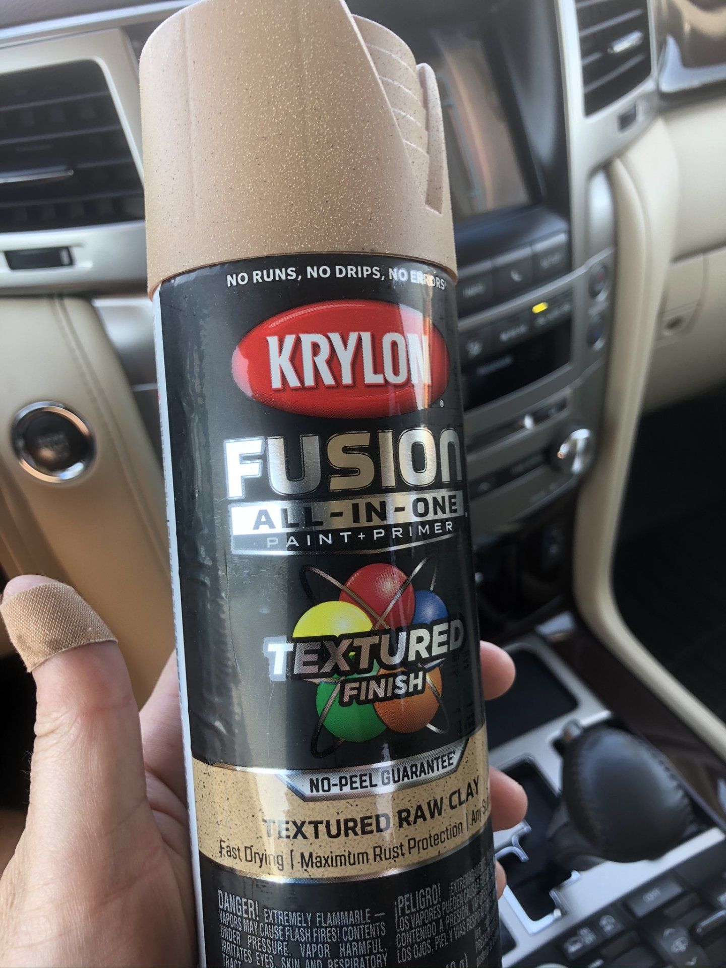

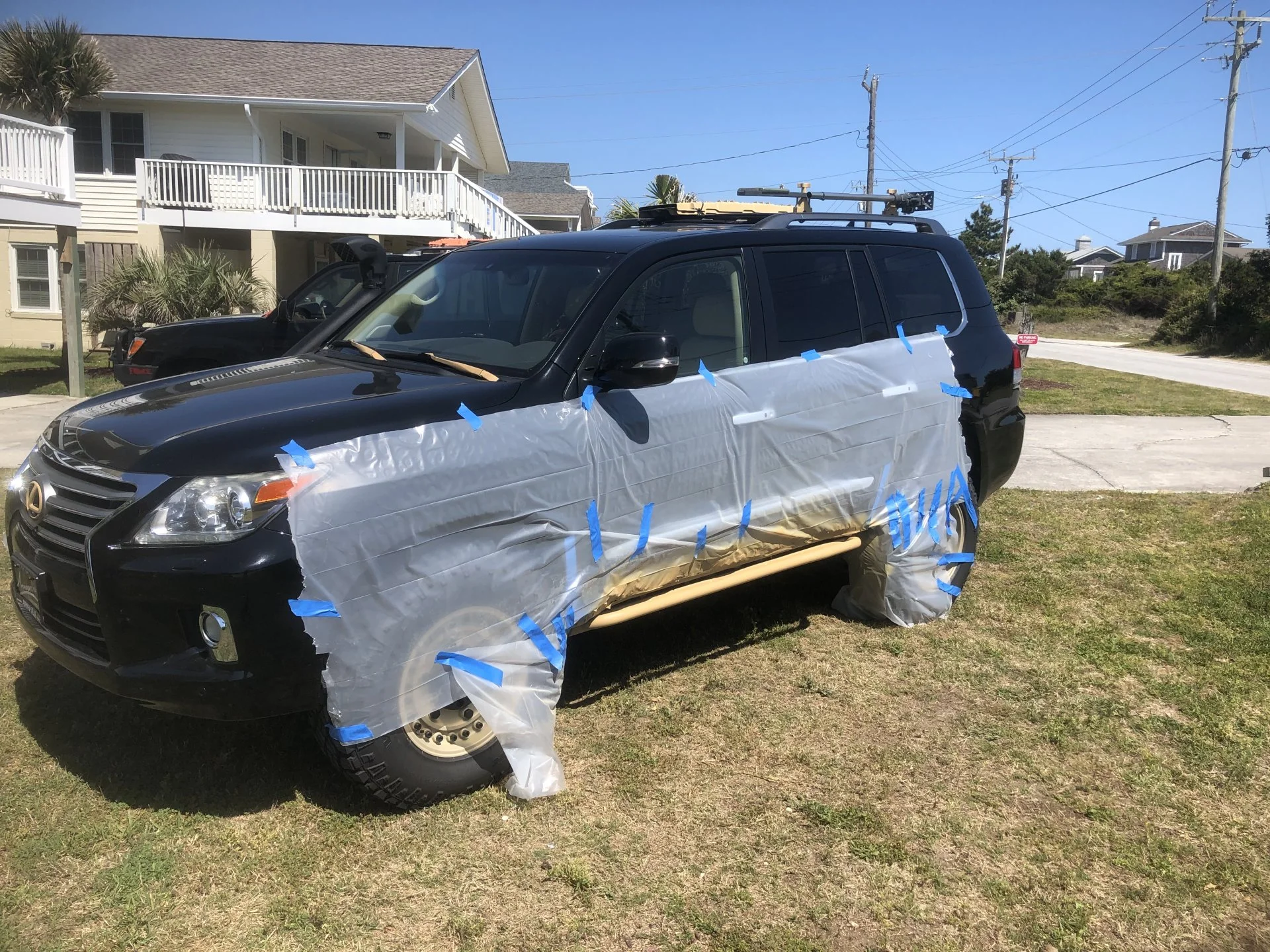

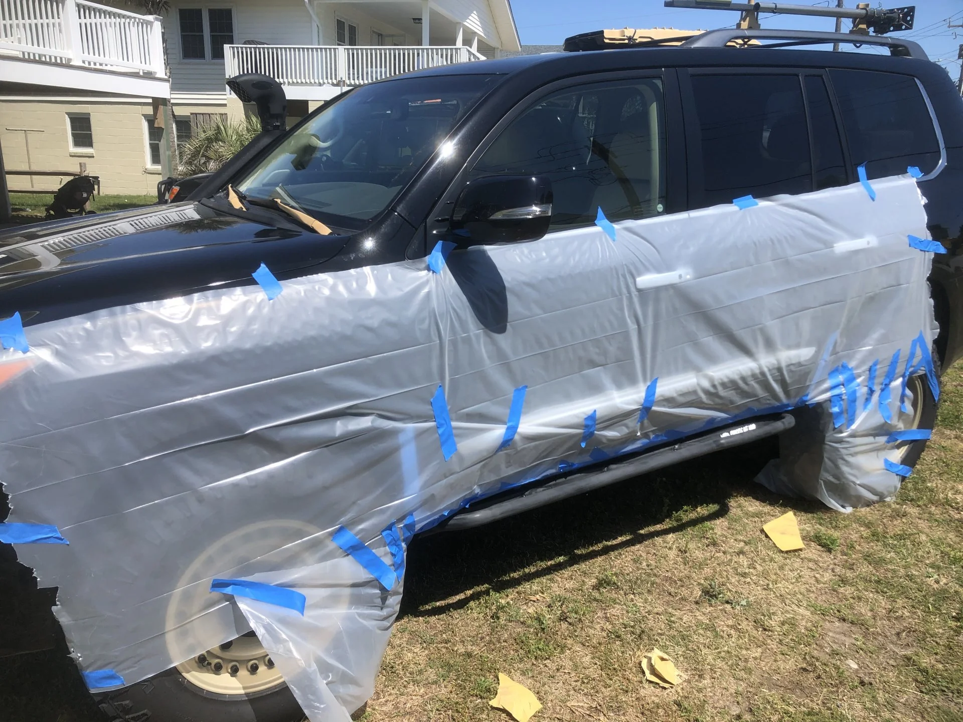

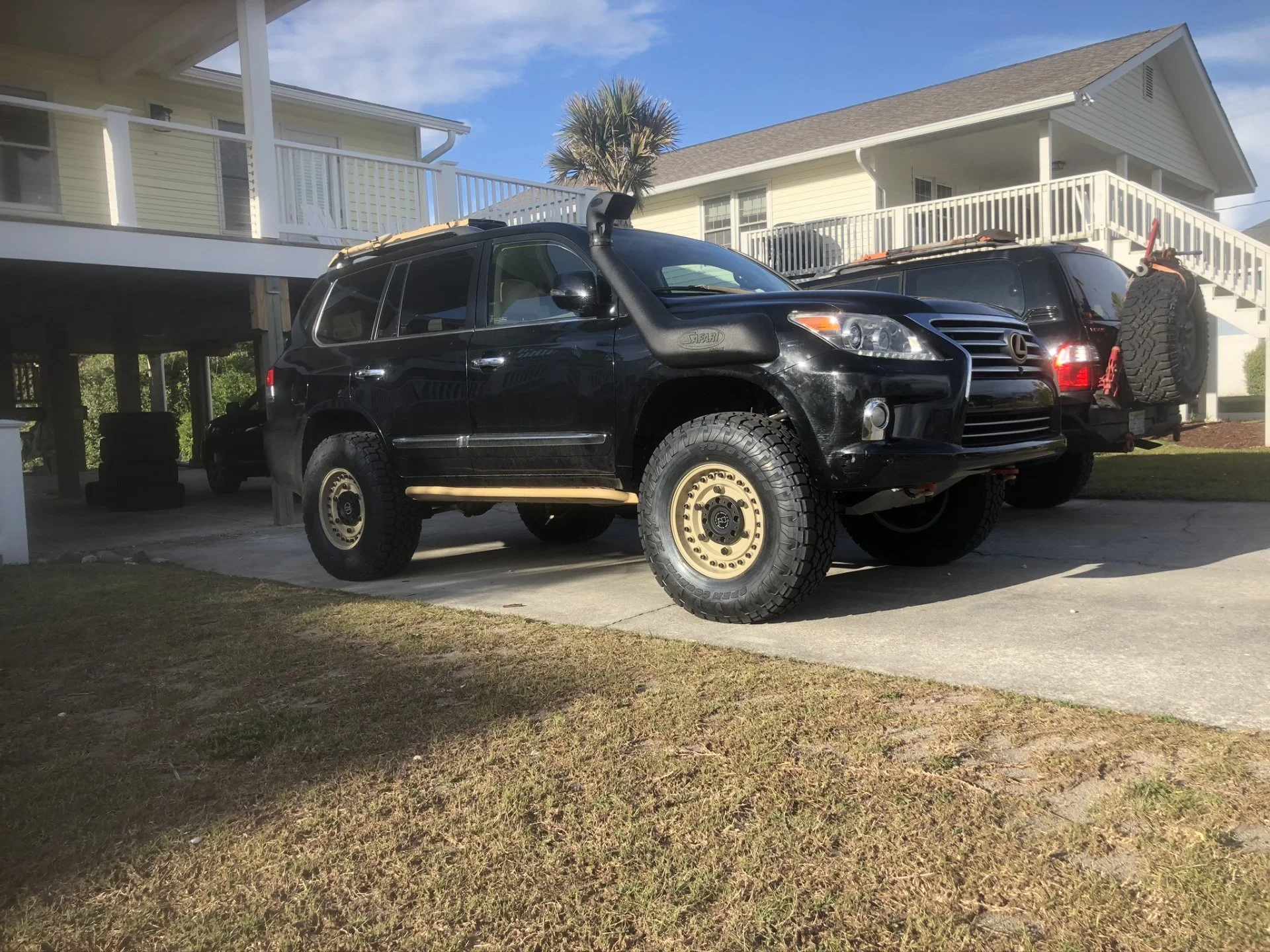

I got rid of some of mine, going to do the rest. Sanded with 220, 3 light coats of primer, 5 light coats of paint.
And some more...
Last two. Need to do the rest of it.

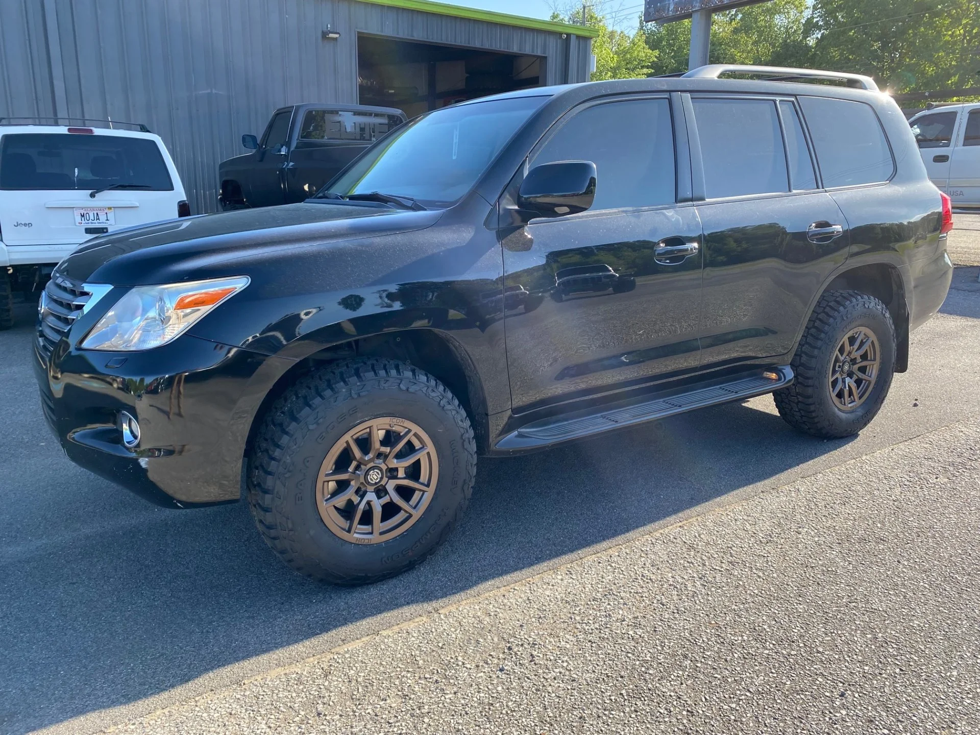

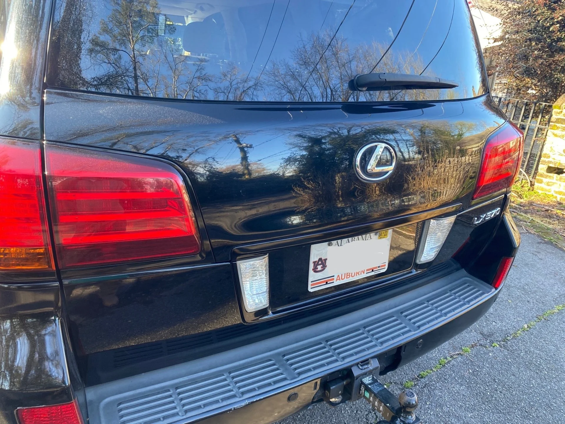

Cleaned well followed by 99% isopropyl alcohol, taped. Put about 6 coats of the Plasti Dip followed by 2 coats of Plasti Dip clear.

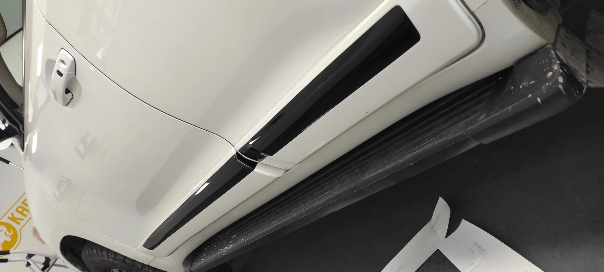

Peeling at the bottom edge after 2 months from opening and closing. In retrospect, would not have done it. I don’t like the finish and I think it will peel even worse. I wrapped the chrome on the side trim, and have been much happier with that.
In the future, I may have this professionally painted. Will not Plasti Dip it again.
