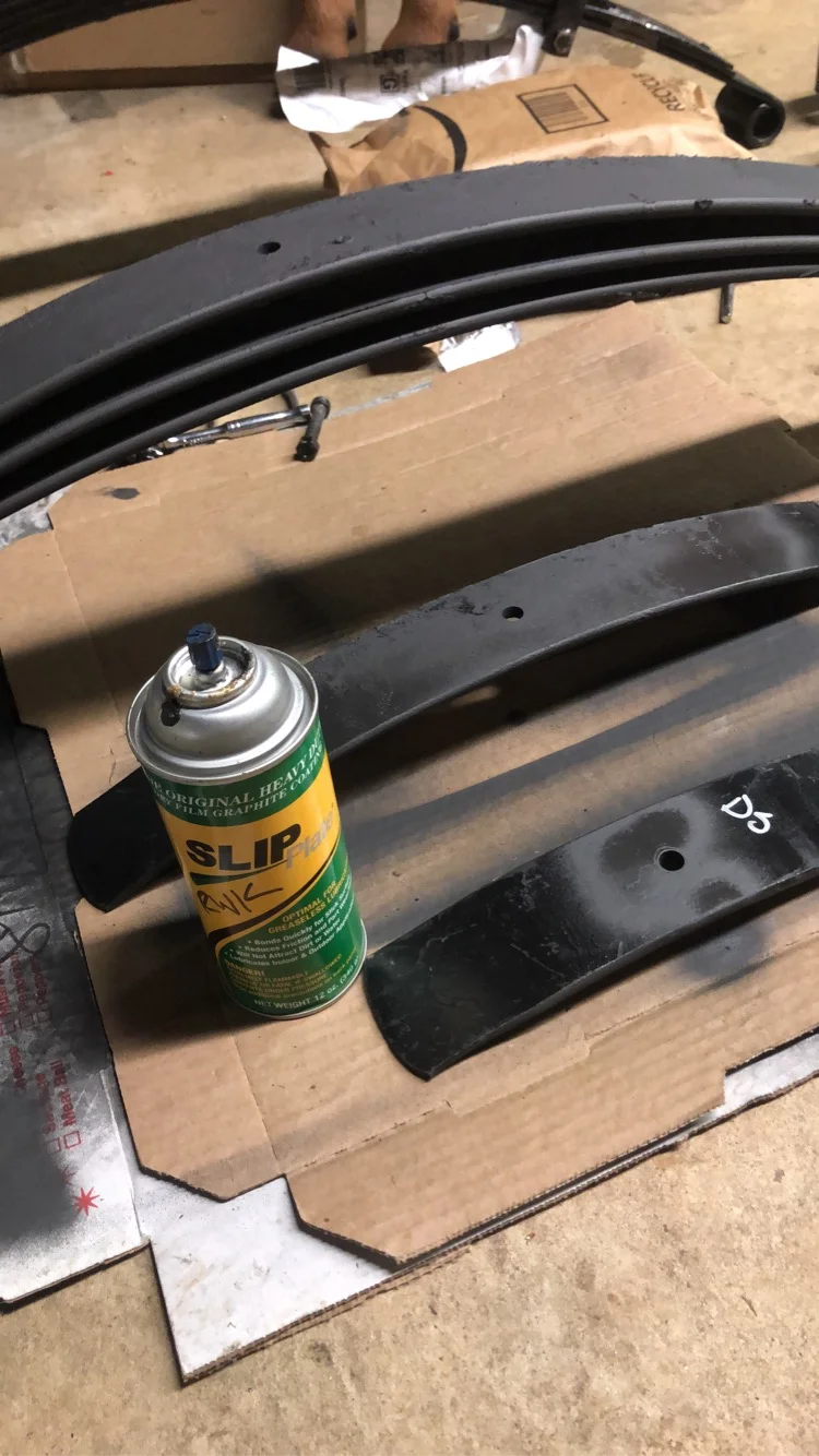

Maybe this:
Disassemble, clean thoroughly, paint between leaves with Slip-plate, reassemble, paint outside with black paint of your choice as needed.
Done.

I took my springs apart, made sure they were not stuck together from paint, and coated them with Slip Plate. Then once that was dry I hit them with some moly grease near the inside ends of each leaf and by the center hole, assuming these would be the points of most wear. Im thrilled with how well they rode right away!

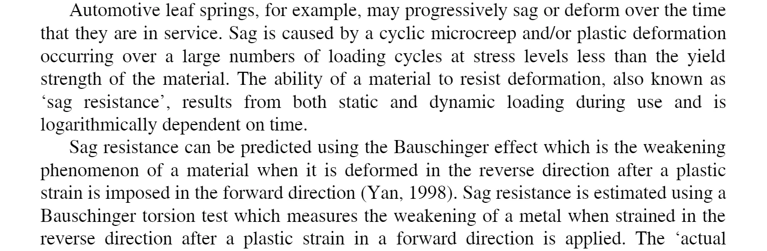

I was curious about this statement
"Starting in the mid 50’s the steel used to make springs began to change over to SAE 5160 which does not like petroleum based products, grease/oil/etc."
I googled SAE 5160 and petroleum and found in every place where this was discussed used the term "does not like". That seemed odd to me and suggests it originated from a common source. I have seen power plant components of all types filled with grease operate without deterioration for many years - when lubricated properly. I initially thought it was perhaps hydrogen embrittlement with the hydrocarbon in contact with the high strength steel but the research I found concluded the grease would actually inhibit that process.
Looking further, I found this in a research survey of various degradation mechanisms for coil and leaf springs. This makes sense if the lubricated leaves flex more and more often (made worse by bad shocks) due to loss of damping due to friction. Any metallurgists in the crowd?

I think you’re over thinking this. Cycles are a constant based on use regardless of if you lube them or not. There are the same number of bumps in the road. The leaves are designed to flex independently and must have some movement to do, sliding along each other with the stack flattening under each load cycle with the different curves of the leaves. Increased friction would only inhibit this and increase spring rate by making them less “flexy” with the extreme to demonstrate the point being gluing or welding the spring leaves together.
Many of the nicest leaf springs have pads at the ends of the leaves which reduce noise (friction) and create a small gap between the leaf point and the next leaf. This is viewed as a feature.
The forces applied by the vehicle hitting a bump are what they are based on factors outside the spring. Maybe flexing (deflecting) a tiny bit more could be what youre thinking but less of that that would lead to a harsher ride and I can’t see how allowing the spring components to slide with less friction would be much worse than the localized stress concentrations that would happen at the leaf points to the leaf above from increased friction, a resistance to sliding as the leaf above tries to flatten out the leaf below, all during the same number of cycles. If anything increased friction could cause increased heat which has its own impacts on steel deformation.
