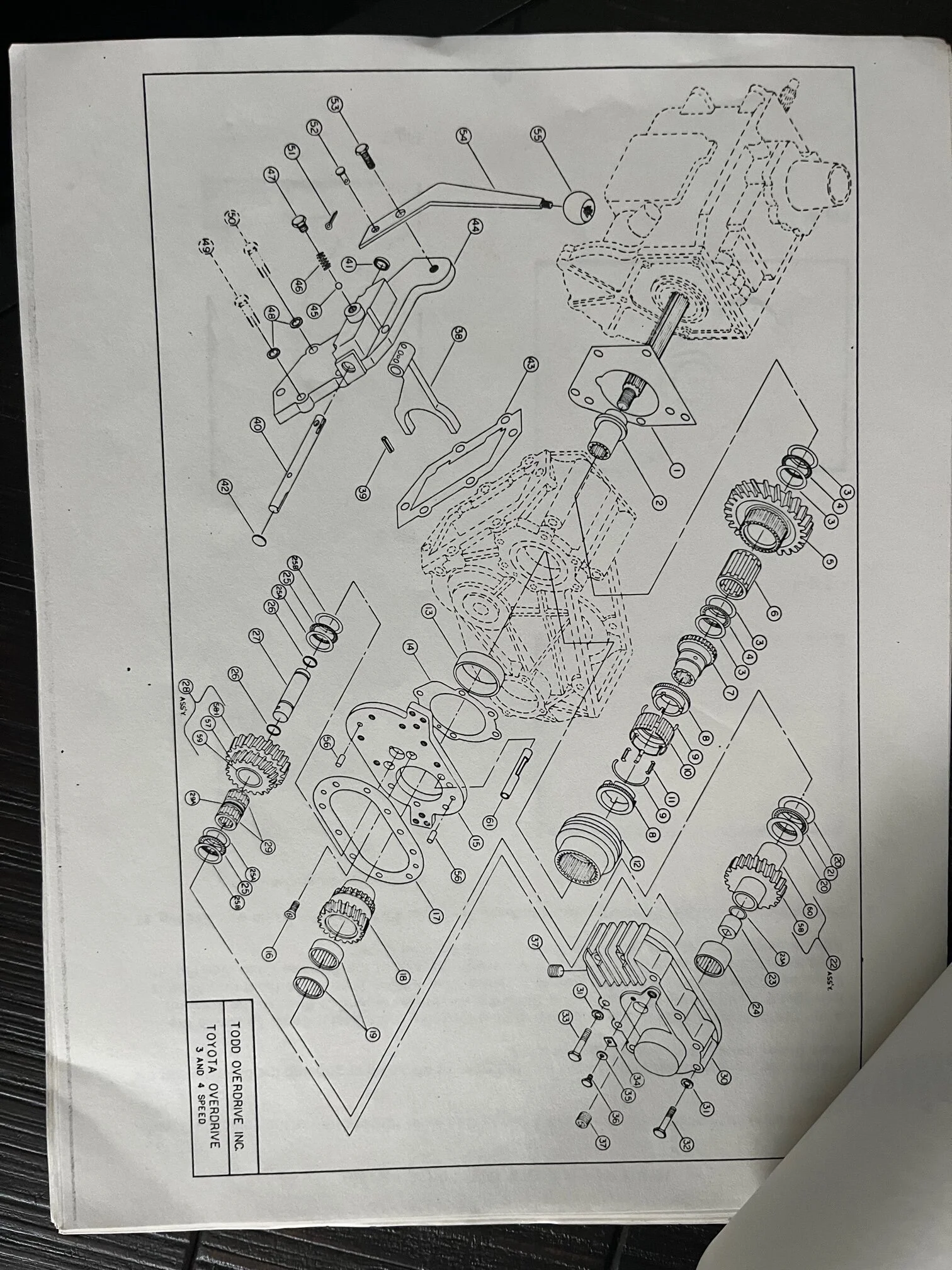

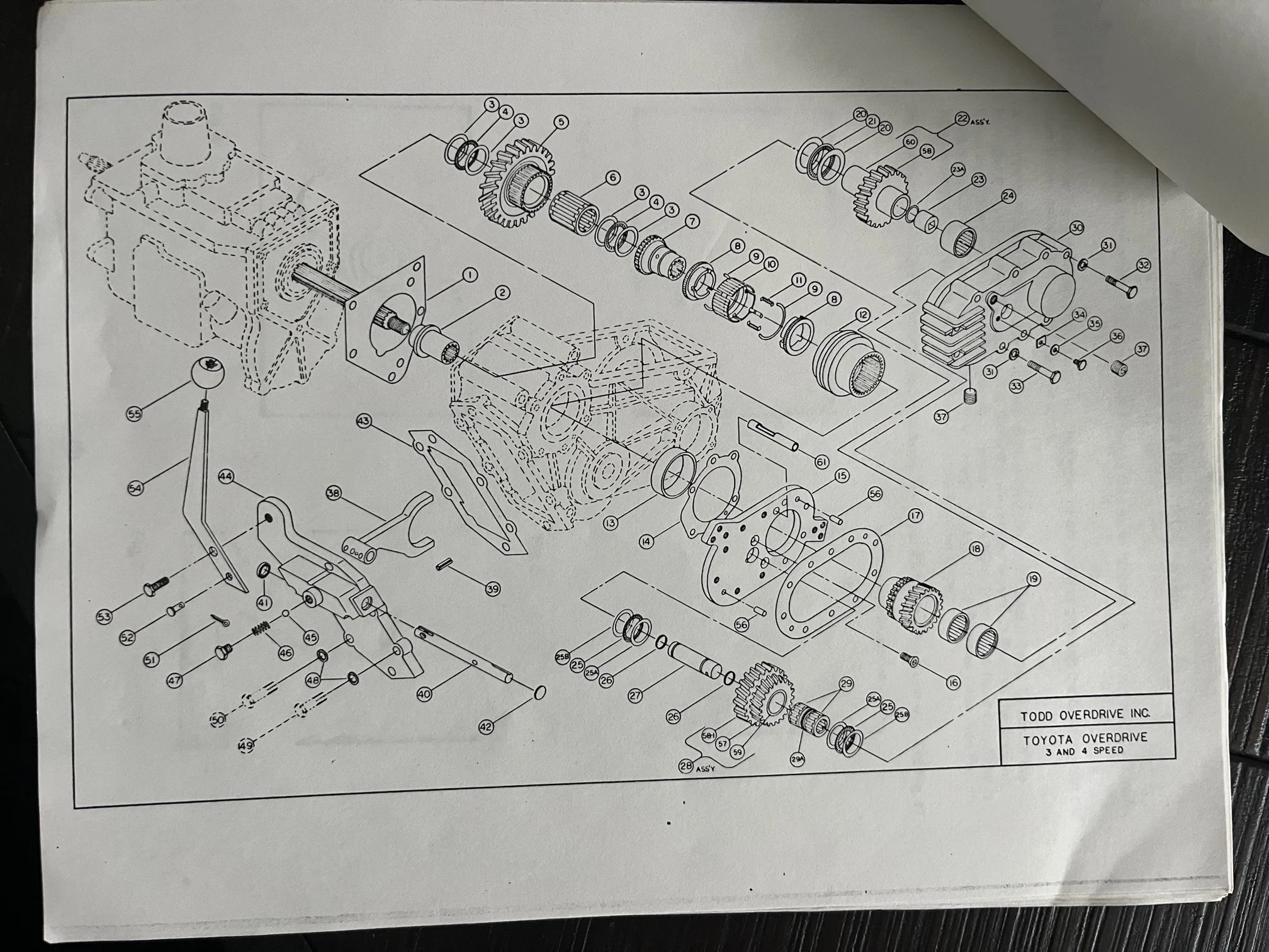

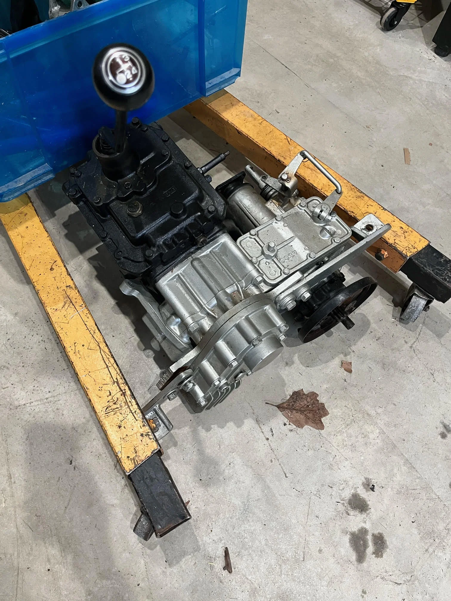

Does anyone know where I can find this shifter? It is not the transmission shifter. It is on the lower left side, and the shifter to engage the Todd Toyota Overdrive. I've tried Google searching "Todd Overdrive Inc" which is printed on the exploded diagram, no luck, and on that diagram the shifter is part number 54. I also searched on Ebay Motors Parts, no luck.
Any help would be appreciated.

Good job with your research. Posting Pic's is very helpful. I would just make it. Cardboard aided design. A first approximation is the hole spacing. Measure that distance on your unit, and then scale up the drawing to match - cut it out of like 3/16 or quarter inch plate, bend. Die on some threads and screw on your shift knob of choice

Me too (learning every day). Here is another image of that diagram but I rotated it to make it easier to view:

So I think the thickness is the notch in part 40. The bend is to get plumb to the angle of the case. While not a true engineering drawing, it sure looks to me to be some what to scale.

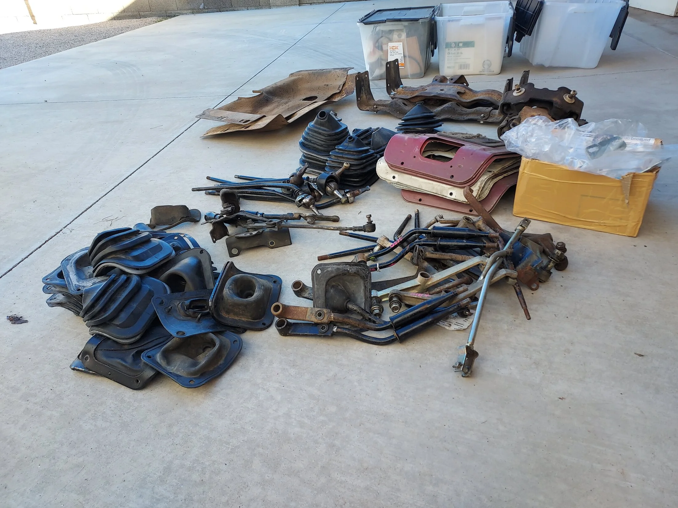

Would be easy to just modify some thing already made. The FJ62 high low range shifter comes to mind. But shorter than what Todd used. But I've seen 60/70 series transmission cane extensions available on eBay AU. Transmission shift cane and FJ62 transfer case shifter share the same threads for the knobs so those extensions would work. Personally I think that flat bar looks crude and home made. By the thickness I wonder how much force is required the to shift OD.
Lower center in this picture is a couple FJ62 transfer case shifter. Top of the flat section has a hole with a rubber bushing with a steel sleeve. Looks like enough flat bar below that hole for second hole and grind off the rest.
Would say PTO shifter but besides being hard to find that are not that stout.

Good news! The seller of the drivetrain let me know they did find the shifter for the Todd Overdrive unit while getting everything ready to ship. Woohoo!

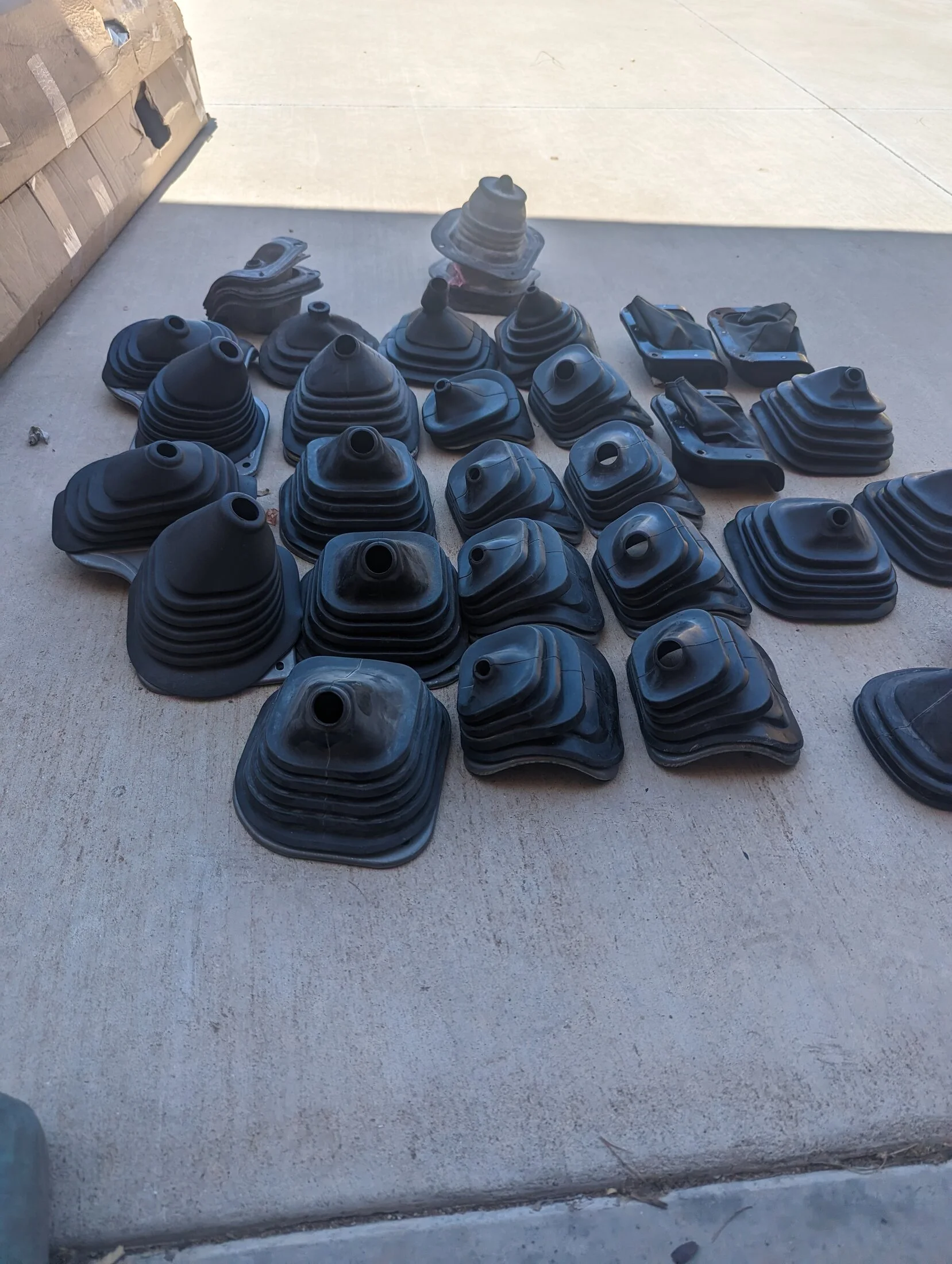

Do not believe there is a Fairey overdrive boot in this picture. Those are leather and designed to mount to a flat surface. Most transfer case boots for the Land Cruises are made to fit on the right side and angle back.

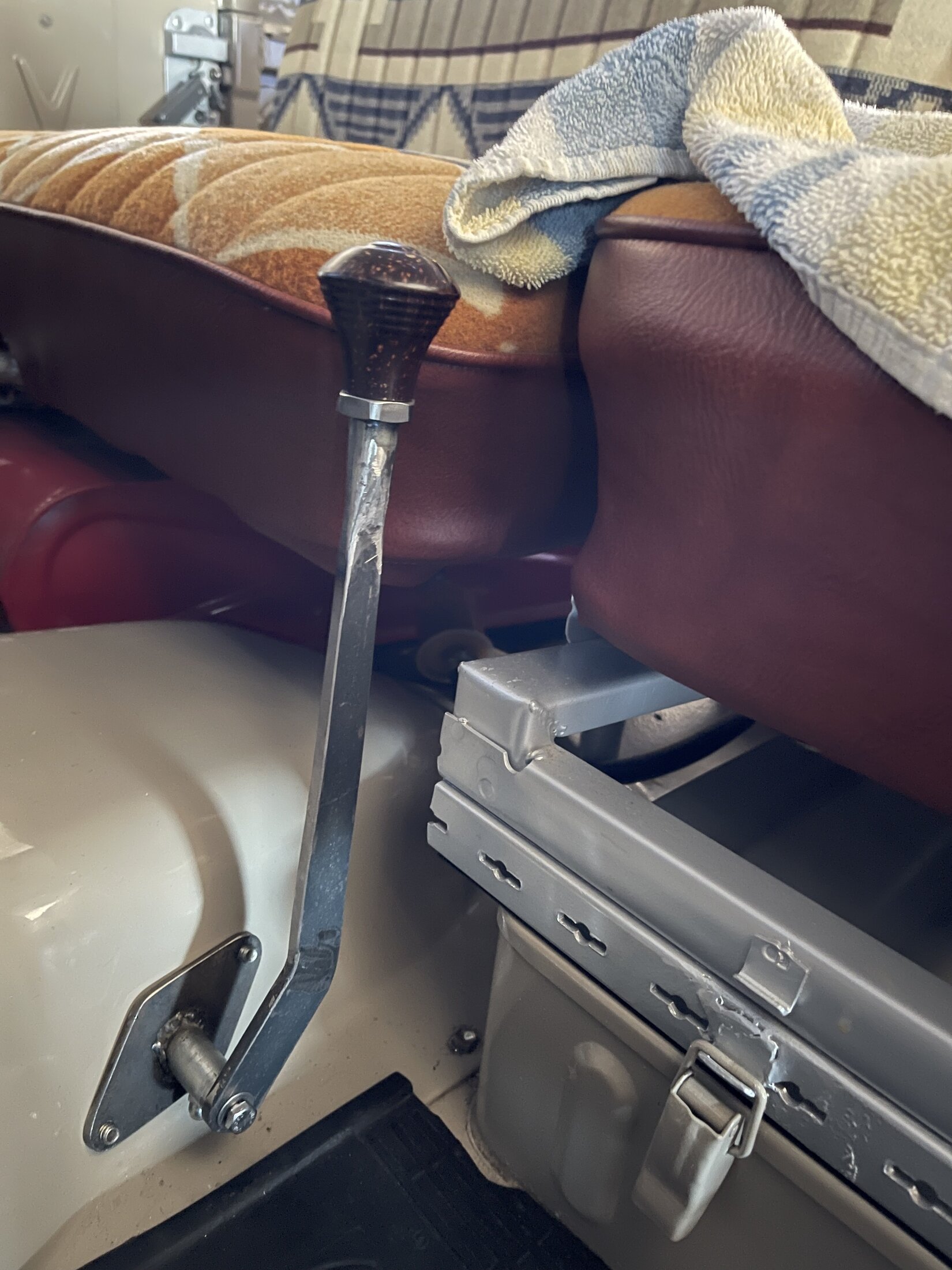

Made my own for my Bone-O-Drive overdrive…flat steel, threaded end for the knob, cool beens antique Bakelite knob…..and I used a shaft through the tunnel instead of cutting a gaping huge hole for a shift lever…. Use your imagination, get creative….
