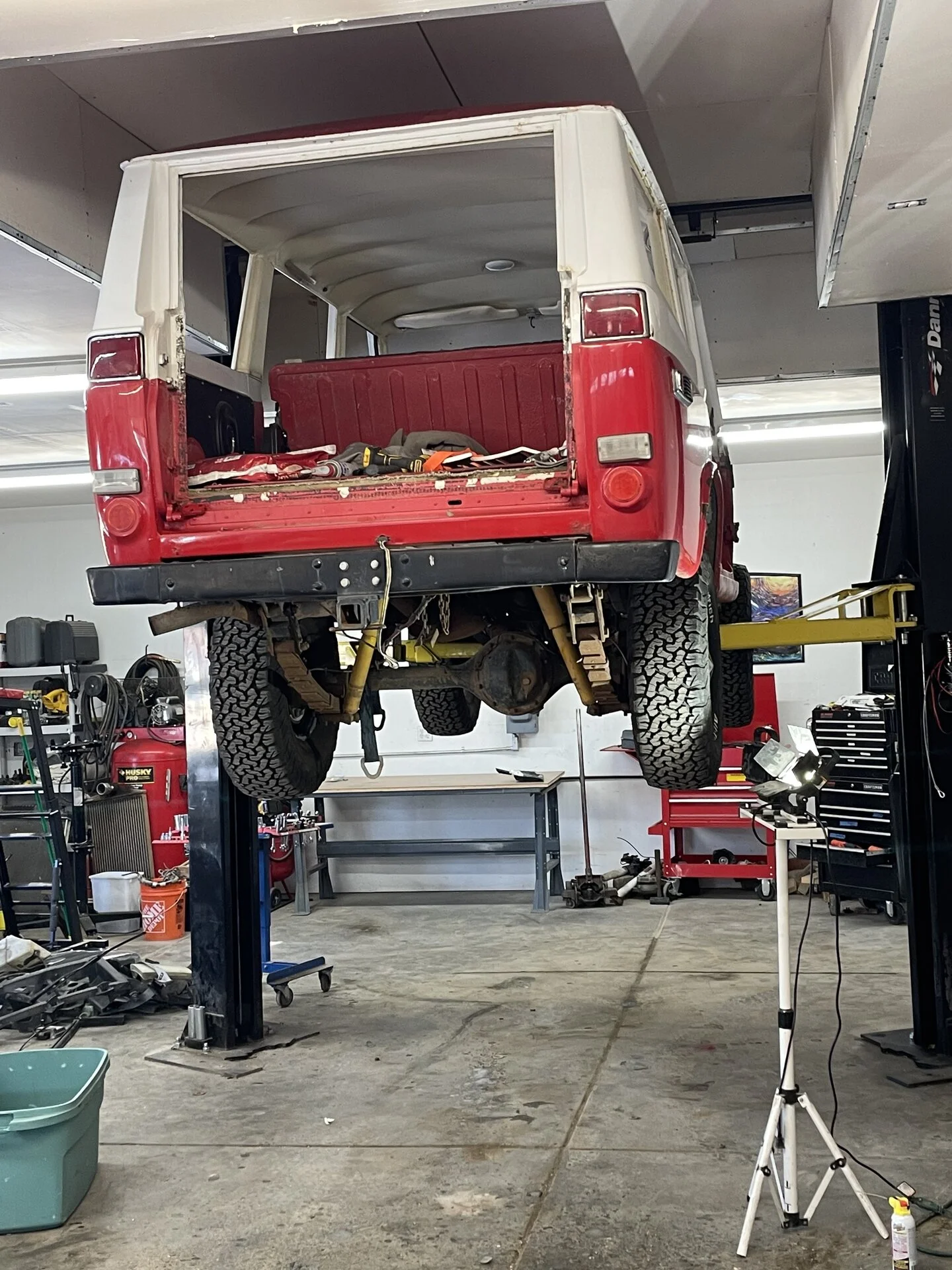

Rust repair has commenced. Going to be a pretty substantial effort, I'll try to keep the thread going with pics. Been looking forward to this...hope I don't regret taking it apart!!

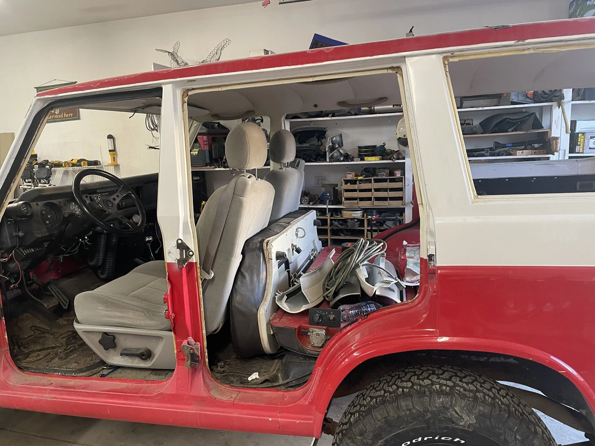

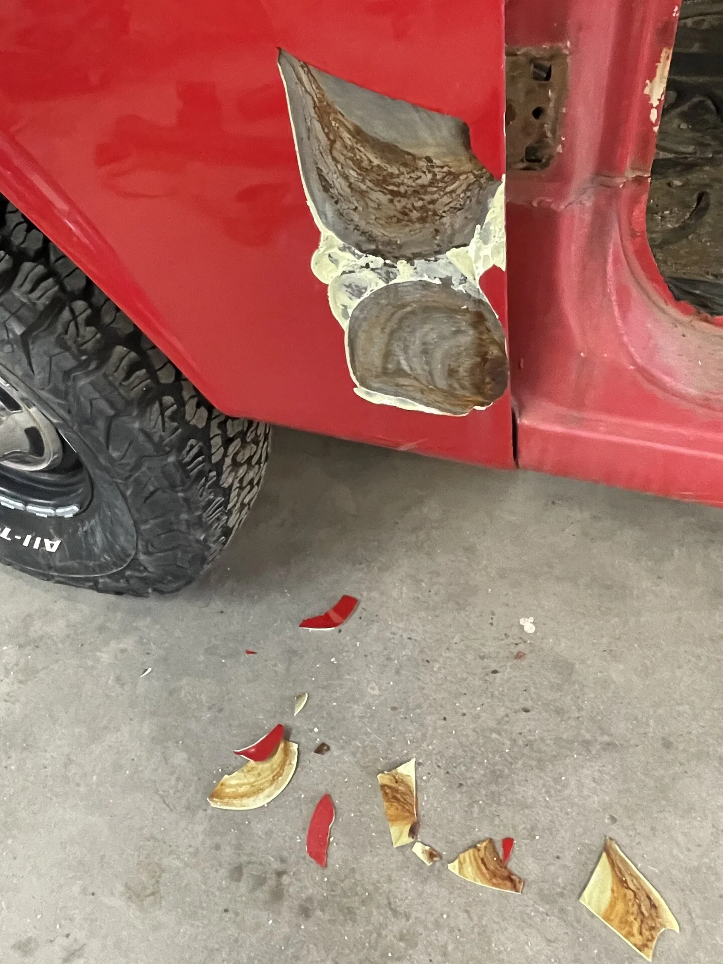

Managed to get both rear bed windows and windshield out with the seals, which were still good, intact. The weird thing is so much of the exterior has a thick layer of bondo even tho there are no rust holes or dents. I get the feeling the previous painter/body work guy was a hobbyist. We’ll see what else crops up.

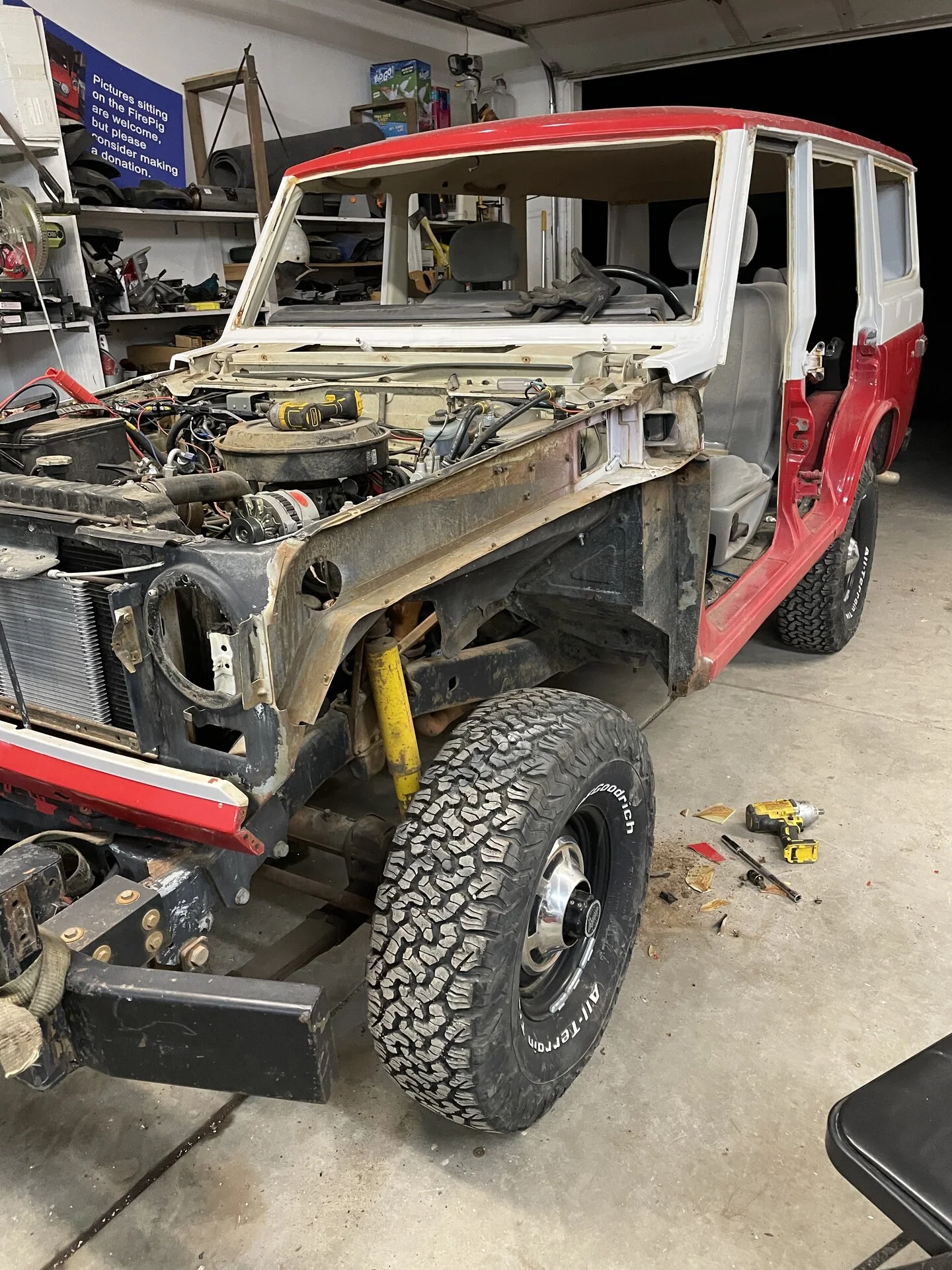

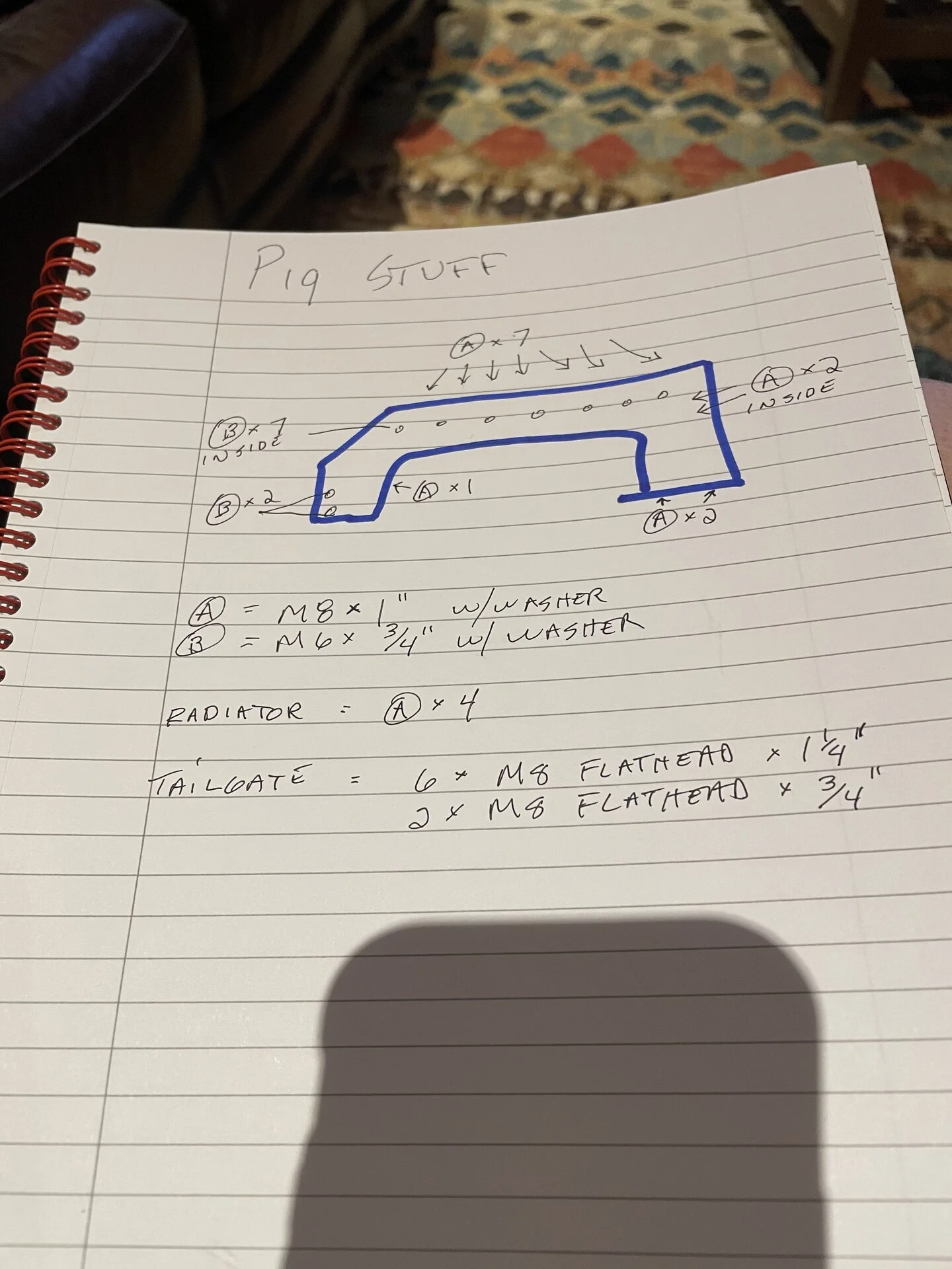

Decent progress today. Got other fender, tailgate and most of the perimeter stuff around the engine out. I’m taking fastener notes cuz it’s always a pain to figure that stuff out later. Used an old school tool to get the flathead phillips screws on the tailgate out. The good old impact screwdriver. You never need one till you need it! Soaked em in breakfree for a few days too. 😬
