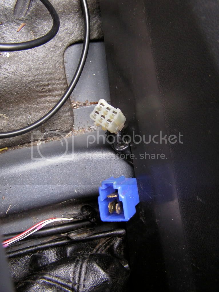

What is the OEM accessory that I do not have that uses the white plug socket normally hiding under the center console?
I'd like to use it and mate it to the blue plug which is....

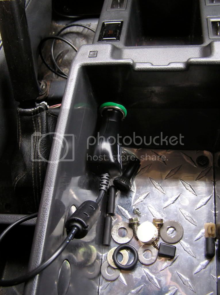

Via...Sheila's surplus cigarette lighter socket, which I installed for an in-console accessory plug. Nifty, huh?
And with more of that aluminum diamondplate, I made a new floor for the bolts to hang onto to mount the console. I bet most 60 series have big ol' washers to reinforce those cracked mounting bolt holes. This was my upgraded solution. I used a piece of paper as a template and cut that rectangle in about 3 minutes.

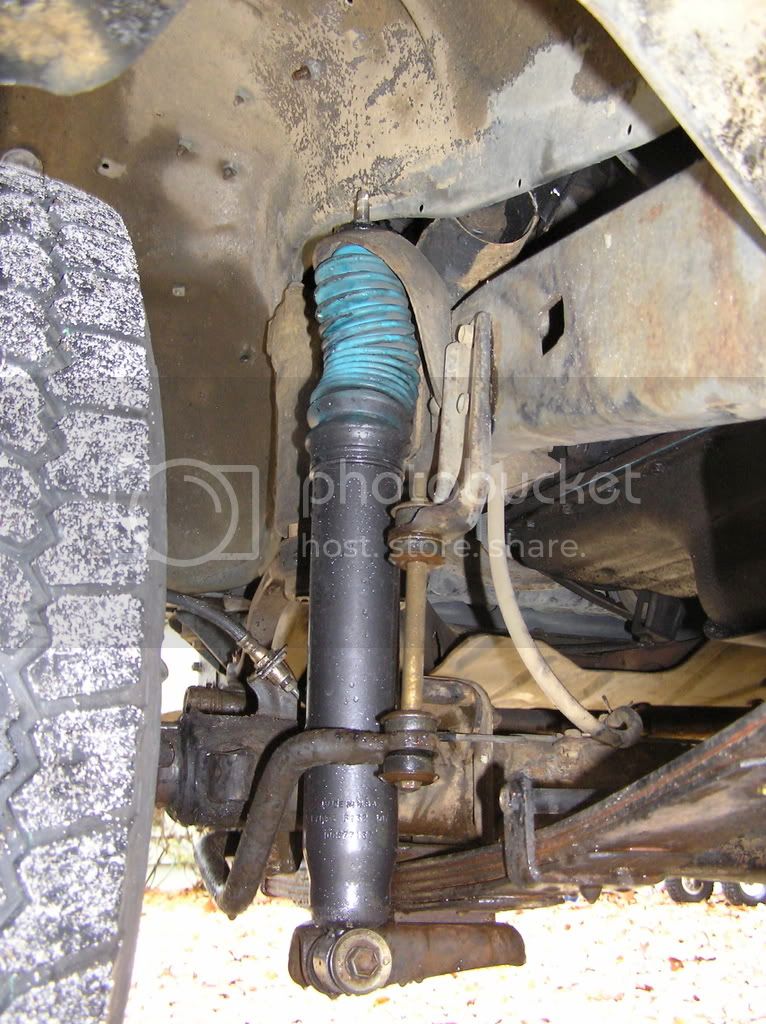

Pro Comps shocks up front, furnished gratis (thank you!) by Dynosoar, which I painted hammered black Rustoleum. Rides MUCH better with shocks than without!!! Now I need to get and install rear shocks.

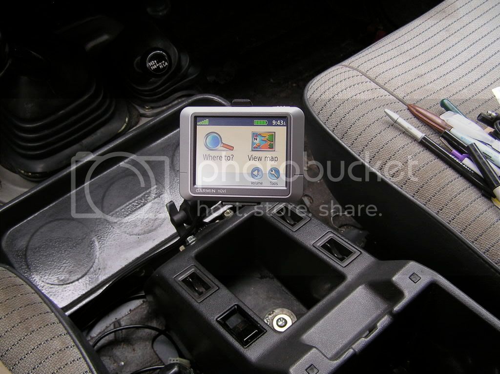

Only accessory that I can think of right now that ran to the center console is the saharan spec fridge. Have you tested it to see if there is power to it, and if it's switched power or constant?
Why not just power the gps off the same source as your accessory power already in place?

Hmmm. I'll check it. I do want it to be fused...
Just cause it is plugged in there does not mean it is powered, that was merely for the photo, if I am understanding your quesiton correctly. The GPS is currently powered from the normal cig socket on the dash, or if unplugged, from a rechargable internal battery. I could also get power to this new socket by splicing into the wire that leads to the heater switch, but I'd prefer a dedicated line, the one with the white plug...
As an aside, I took one photo of the GPS with my house on the map, which fortunately I was awake enough to realize was not too bright to post up here, so I went to the main menu for the photo which did get posted...
