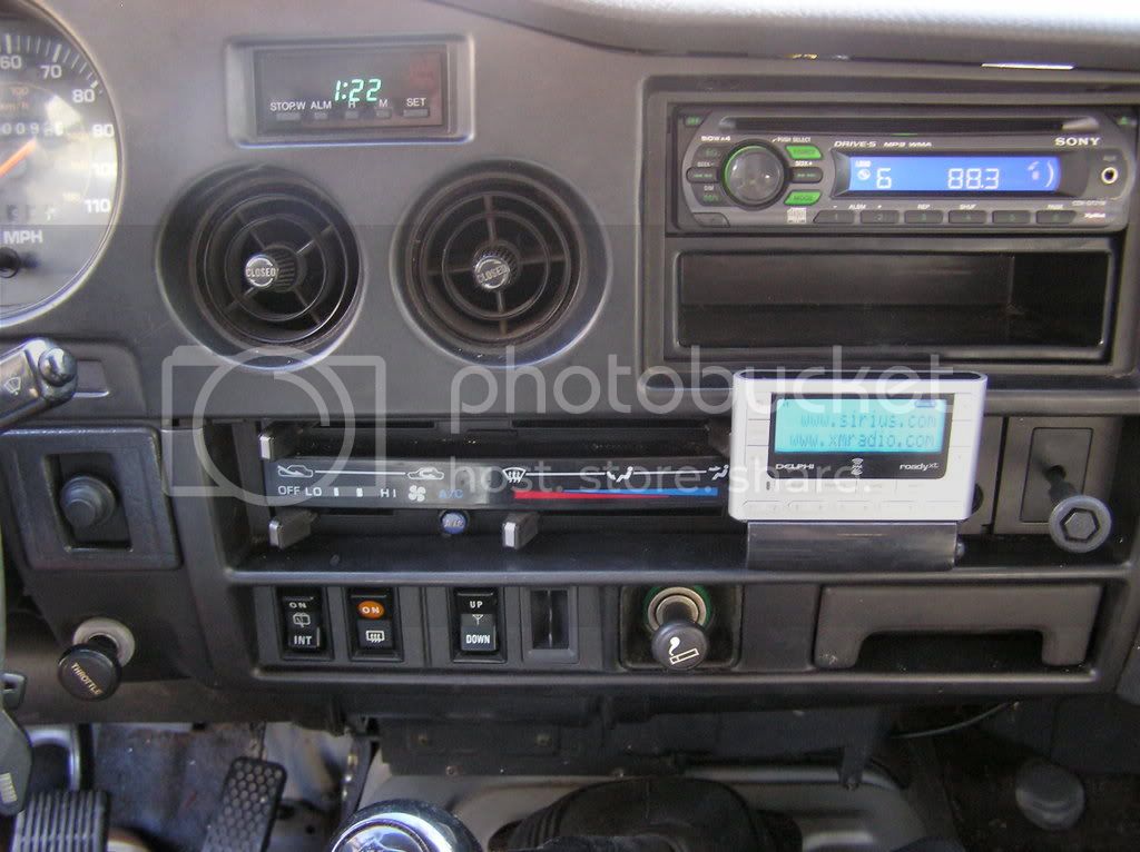

Behold, the KILL SWITCH...
To the right of the xm receiver. I had a spare hand brake adjust knob, that is it poking through the blank dash switch cover. I'll look for a sexier knob, but for now, it works perfectly. You just push it in to shut the motor down. Passengers will wonder, and so long as I am not sitting at a red light, it will do nothing if they push it.
On another note: I could not figure out why my stereo was not working. Upon close inspection, I realized that the mounting brackets have a little picture of a screw on them that says "8mm max". I peeked in through some of the vents and realized one of my mounting screws was touching a circuit board. I swapped out that screw for a shorter one and PRESTO! TUNES!!!
Glow far L, Kill far R.

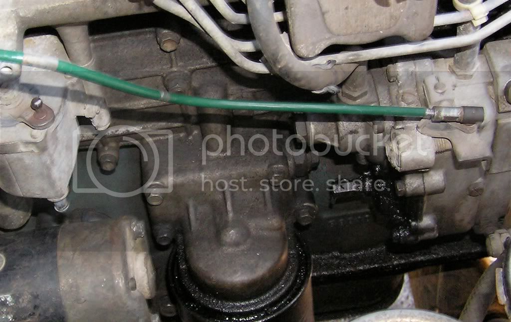

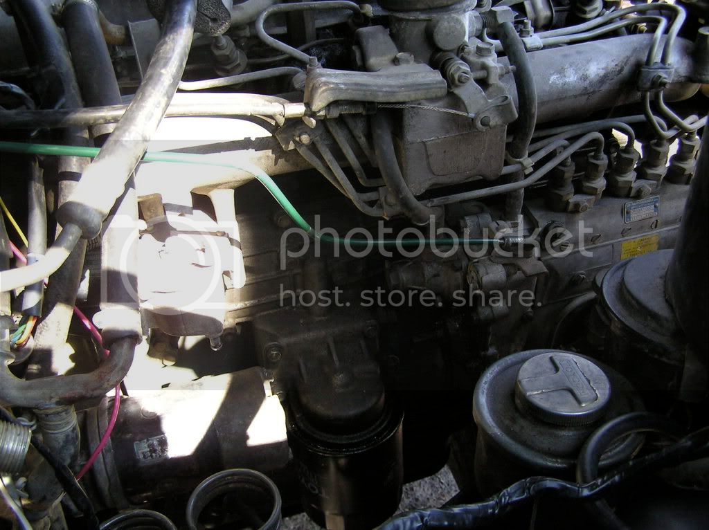

New EDIC arm (kill rod), with lovely S curves. As you can see, the rod is static and is spring loaded because the OFF lever is spring loaded. SLICK, huh?
Another closer shot, you can see I used the EDIC arm's ball joint end, and threaded the end of the rod to take that end piece (same for the knob end). Fits like a glove. Please ignore the leaky oil filter and injector diaphragm gasket (it is on the to-do list).

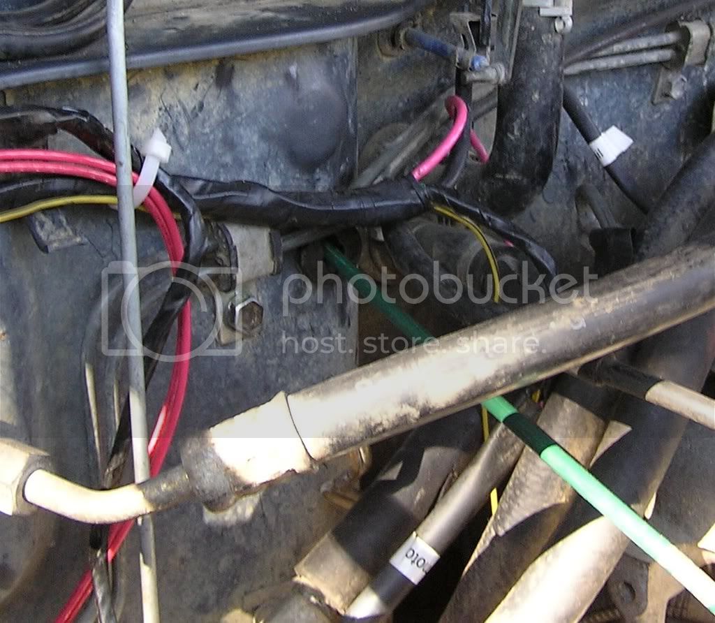

Nice grommet has the rod pass through the firewall just below the brake lines.
Odd thing: Depending on what style knob is on the kill rod, it changes the sound. The rod is a sound conductor and the knob the speaker. Not a rattle, but it is actually transmitting the engine sound. It is subtle, but noticable by me. I think I will place a rubber grommet in the dash switch blank hole to absorb these sounds.

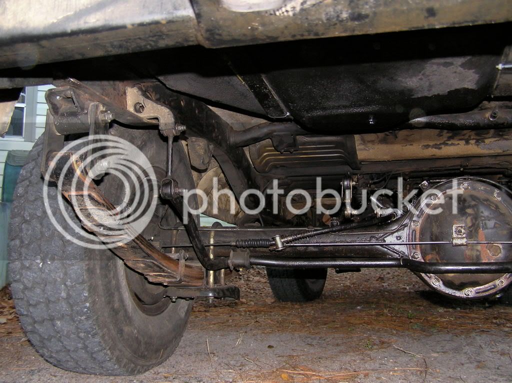

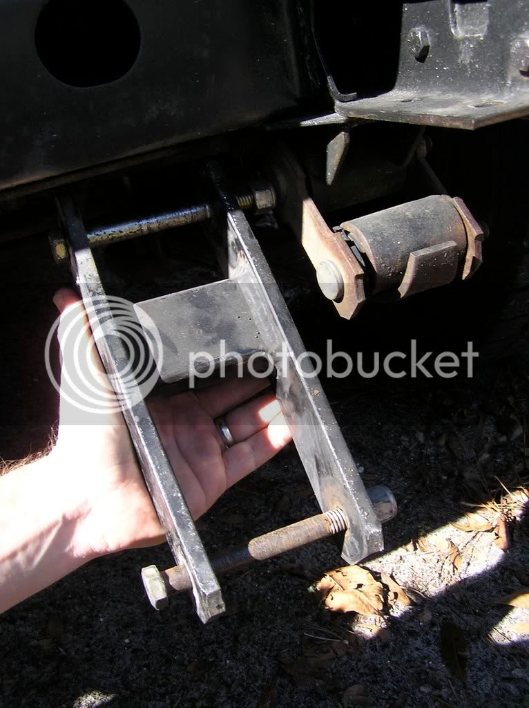

Do you think these shackles will be retarded? Will they change the angle of my driveshaft so much that I will need to cut and turn? Are they just TOO big?

Yes. Trash those shackles. They will make the truck steer like crap (slack side to side), ride rougher than your mom and the truck will follow every every tiny little groove in the highway because the castor will be so off. Not to mention how much fun we will make fun of you.

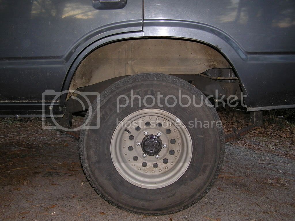

Threw Sheila's 2.5-3" Terrain Tamer lift springs under Tofu with the help of Mel Lowe yesterday. Thanks Bro. What did that take, 3.5, 4 hours?
Reused my U bolts. They were in great shape, the threads were bright and still gold.
Compared to the tired springs under the 62, the lift seems more like 4 inches. But, the shocks were done done, so the ride is sloppy, loose and bouncey (joke withheld).

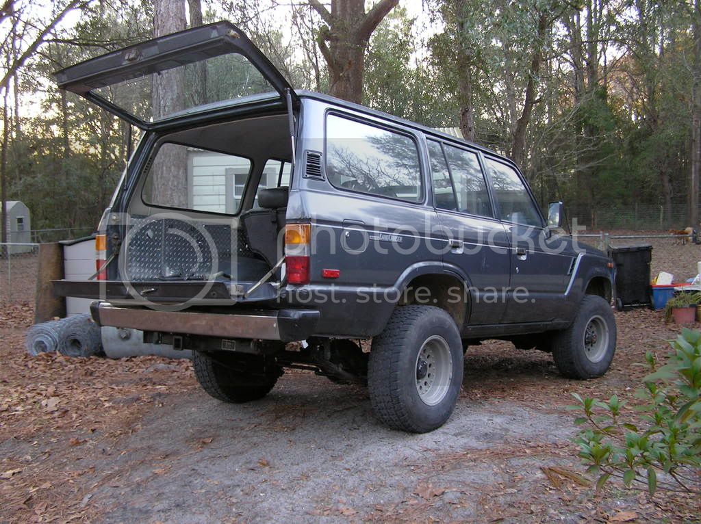

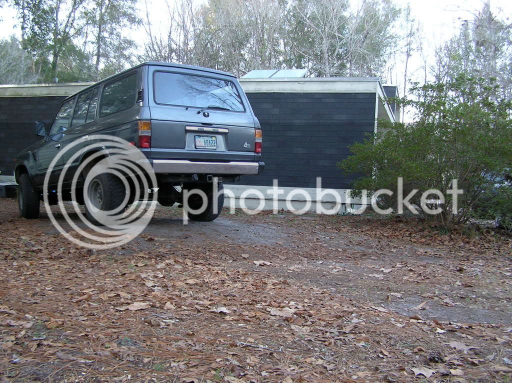

Appears stinkbug, but is level. The rear wheels are up on a dirt mound about 12" high.

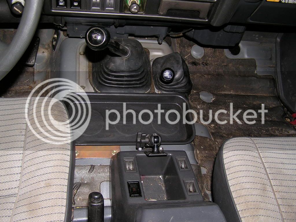

Craftsman magnetic tool tray, fits nicely here.

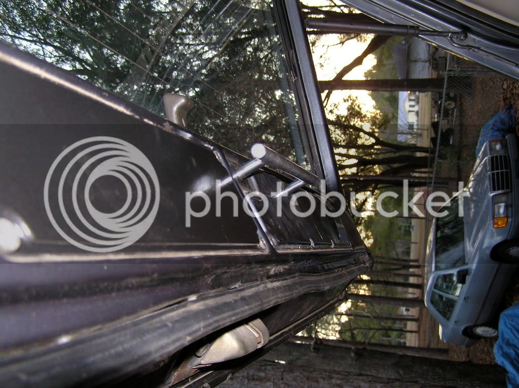

Note my replacement for the lift gate handle. I had to install it painstakingly with bolts though the threaded nutcerts from inside the panel. I was missing one above the driver's door and used the stock liftgate handle to complete the set in the passenger area.

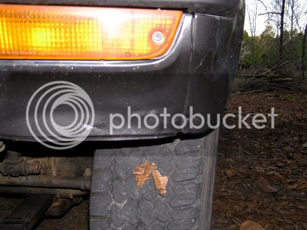

My only body damage. The vehicle came to me with this minor ding.
And again, this is the current condition of the only ding that happened since I have had the rig. I'll get filled and resprayed...

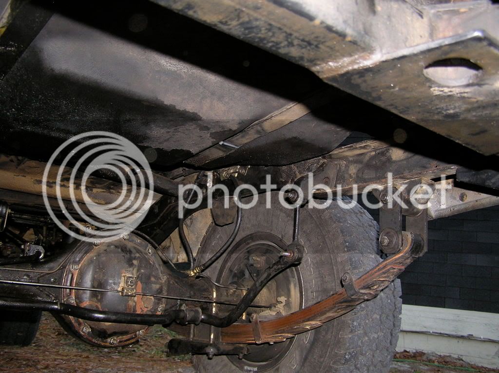

Springs and magnetic tray look great, but it seems you have a diesel leak!
That's gear oil slung back from the leaky transfercase. No fuel leak... The leak was severe and the coating it left has not been cleaned yet. Once that known leak is fully fixed, I'll pressure wash the entire undercarriage to give me a clean, blank slate and then see if there are any other minor leaks...
I appreciate the kind and generous gesture. I was going to replace them with quick-release pins, actually, at some point. I know they're currently short, but the short-term consequence is that it makes for a sloppier drive and nothing more, right? That and the fact that I have no shocks...
Which part should be horizontal? The part that attaches to the link?
