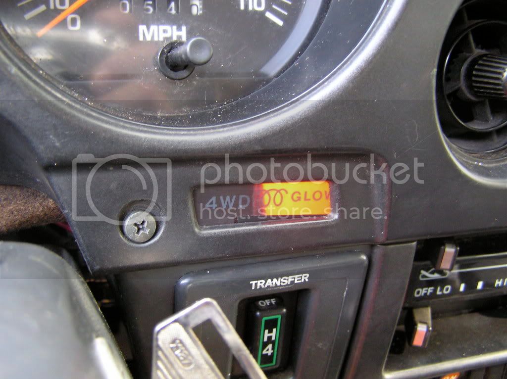

Crappy job of gluing the glow indicator plastic to the back of the 4WD indicator (after carefully sanding away the black paint obscuring it). Gotta redo this.

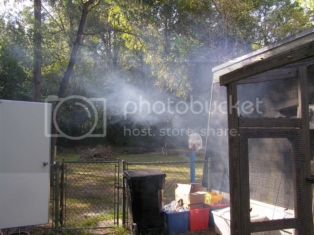

White smoke at start up:

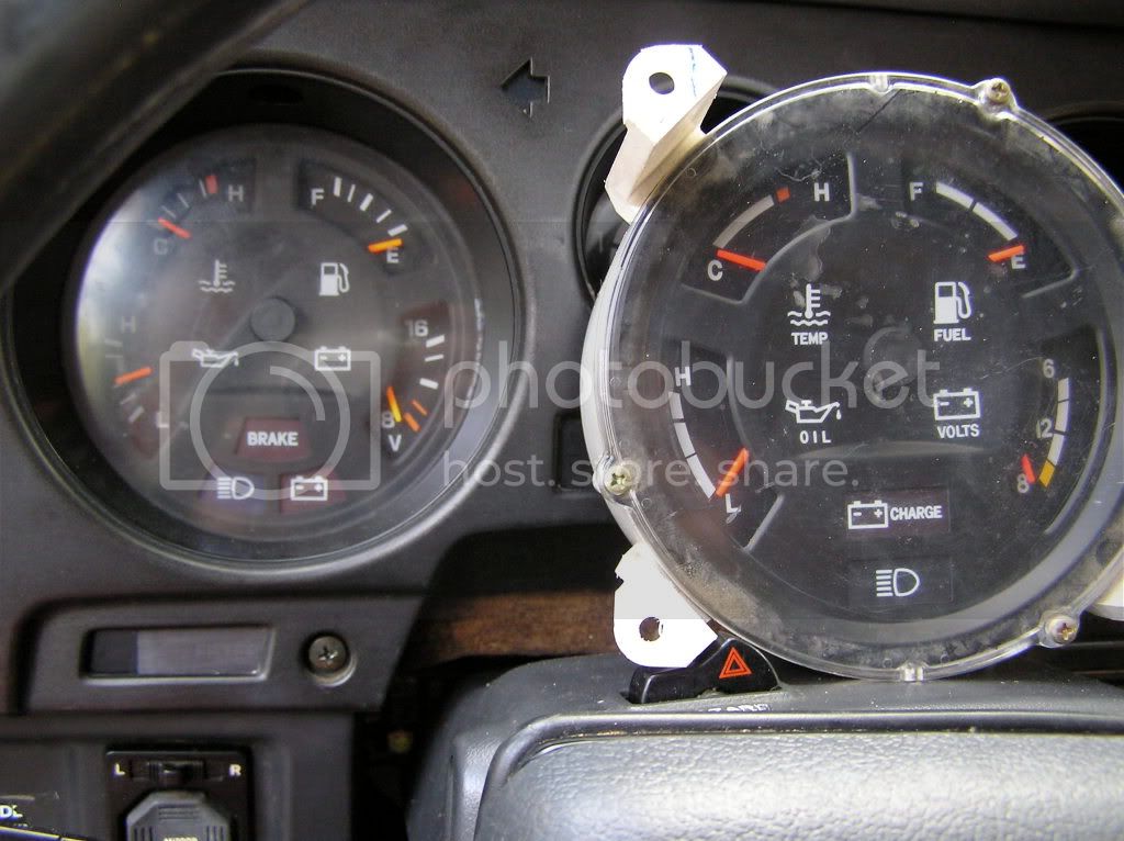

62 gauges L, 60 on the R. Note the difference in the indicator lights. The 62's brake light is there instead of in its own spot above the column.
After the photo was taken and the new oil pressure sending unit was put in, I realized that it is the gauge that got fried, not the sending unit. Now the needle sits well below the first hash mark and won't move...

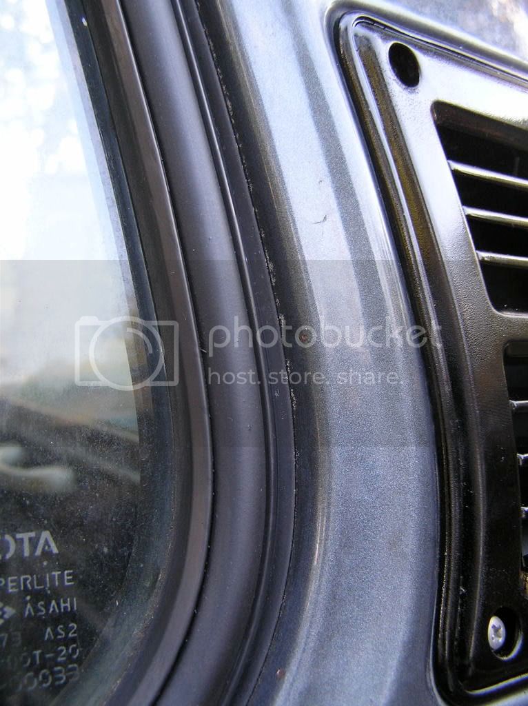

After drilling and pulling and new lens put on... Bummer.

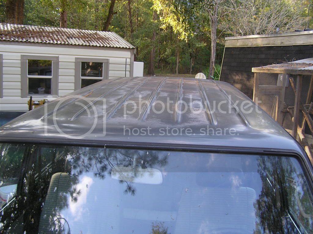

Faded paint on roof

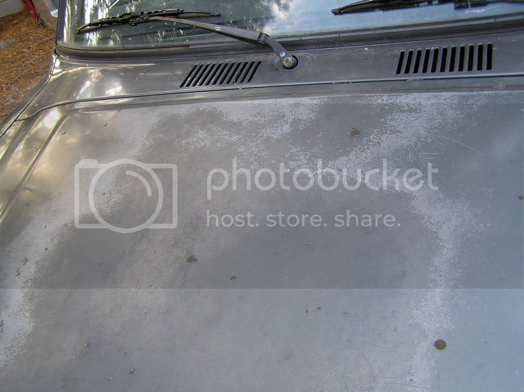

Faded paint on bonnet

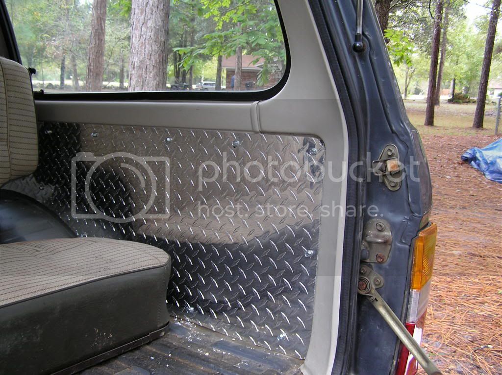

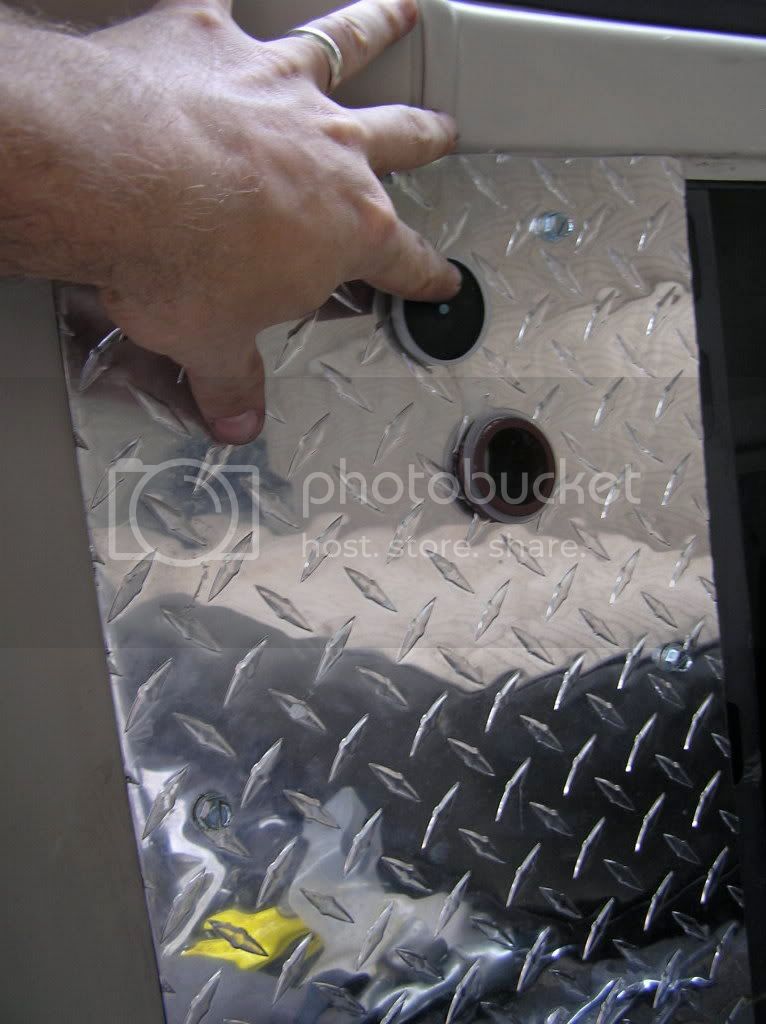

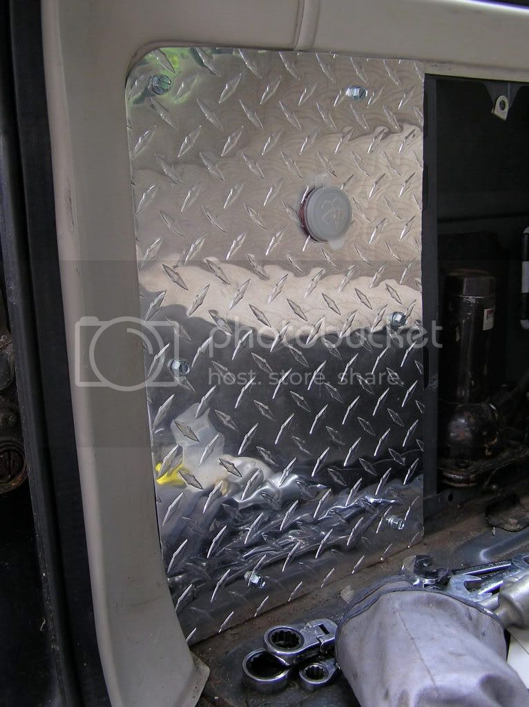

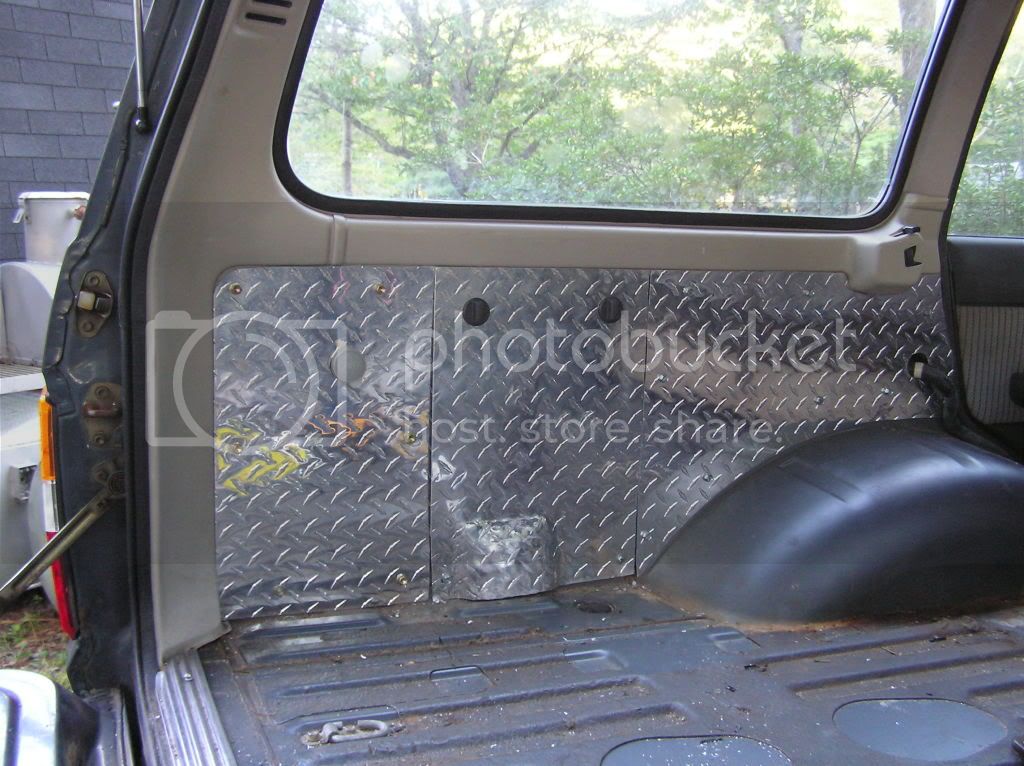

Gonna do this side like the original, in three pieces. The rear washer bladder fill neck was a tight squeeze through that hole, but once through, it fit perfectly. Now that pannel will not ever need to come off, unless repairs are needed.

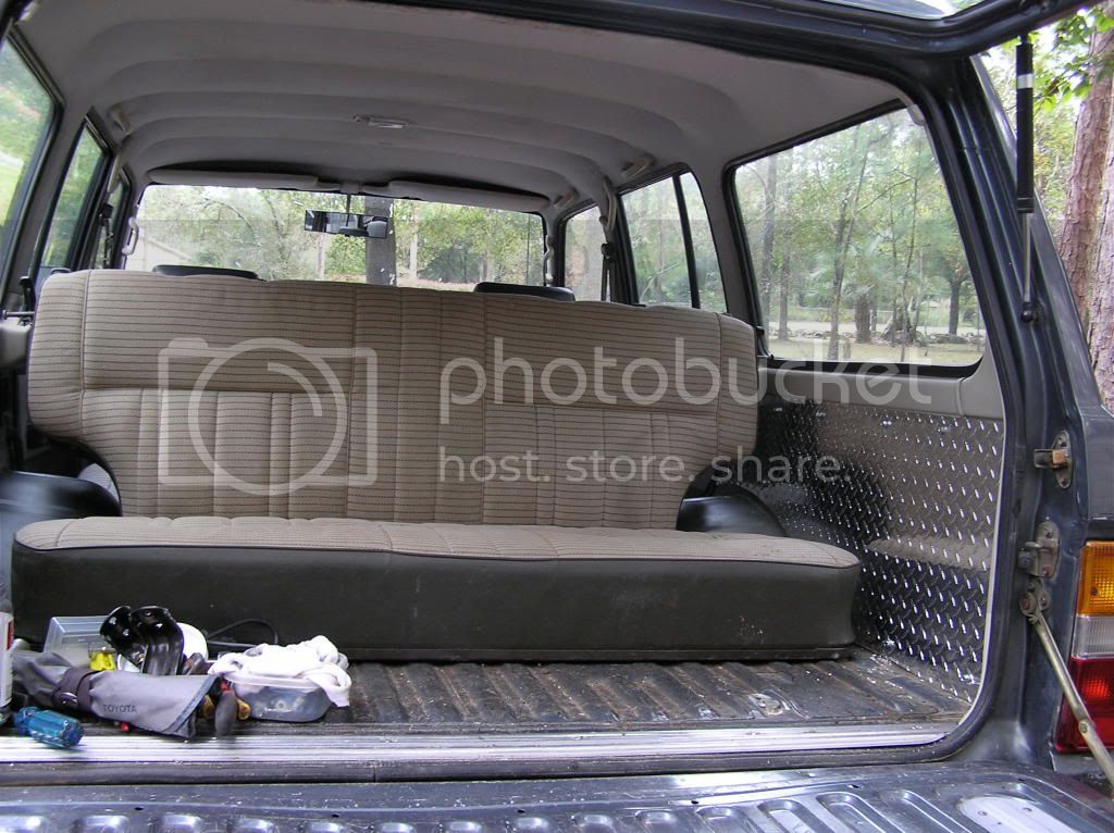

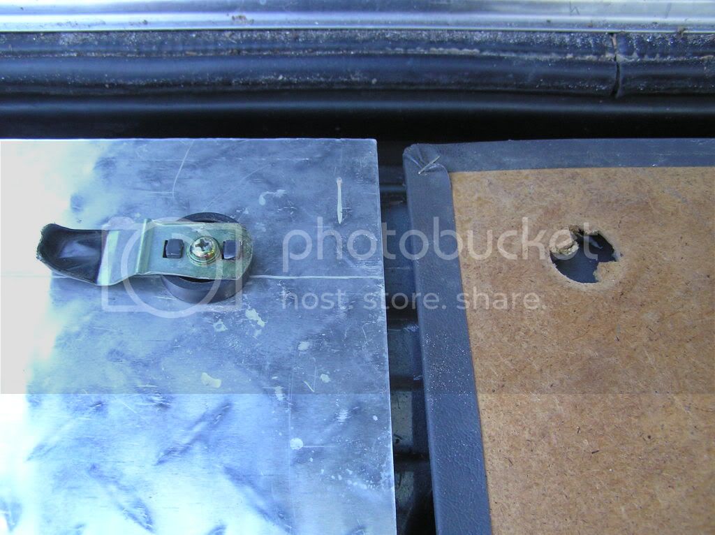

Possibly the first to try this? I'll rig up some quick-release brackets to bolt to the floor and some brackets to make the seat back and bottom one solid unit. Then Install seat belts and it'll do...
The rugrats approve!
Even with the seat back sitting on the floor, it sits up about 4" higher than the 2nd row. I can make them level by angling the back more to match the angle of the 2nd row, and give up about 4" of foot room between the tailgate and the seat. I think I'll do just that...

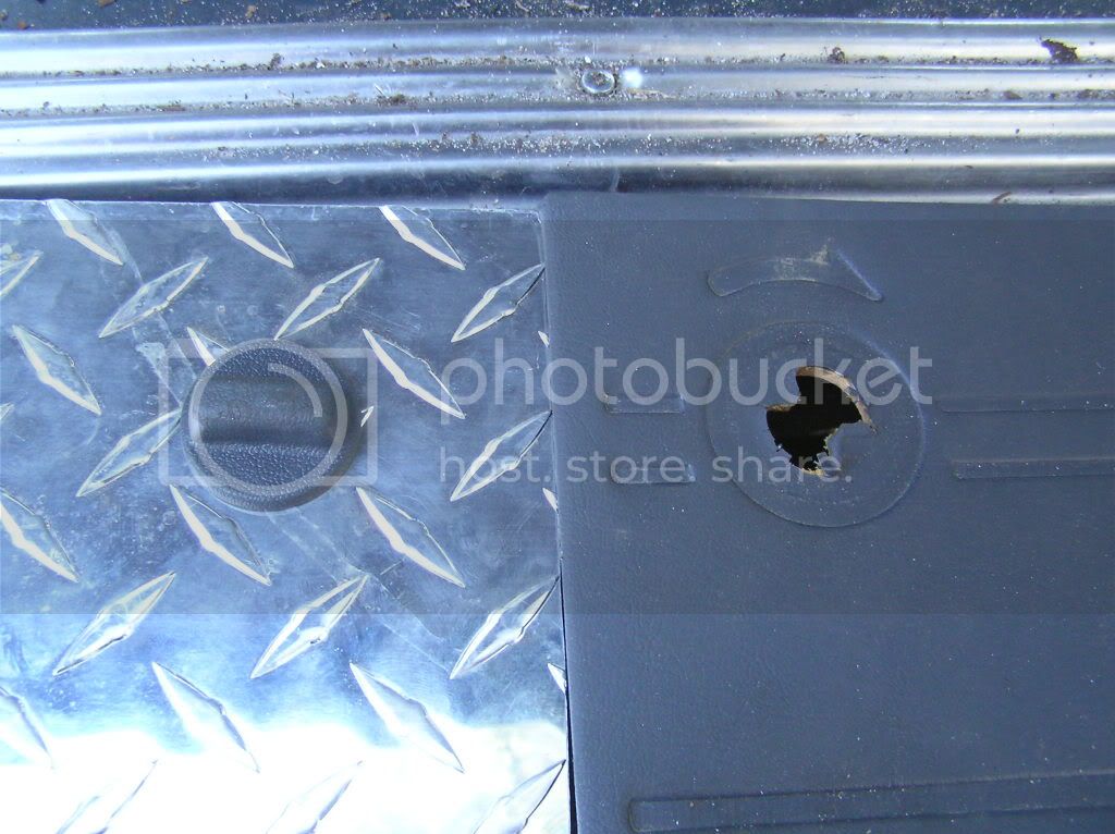

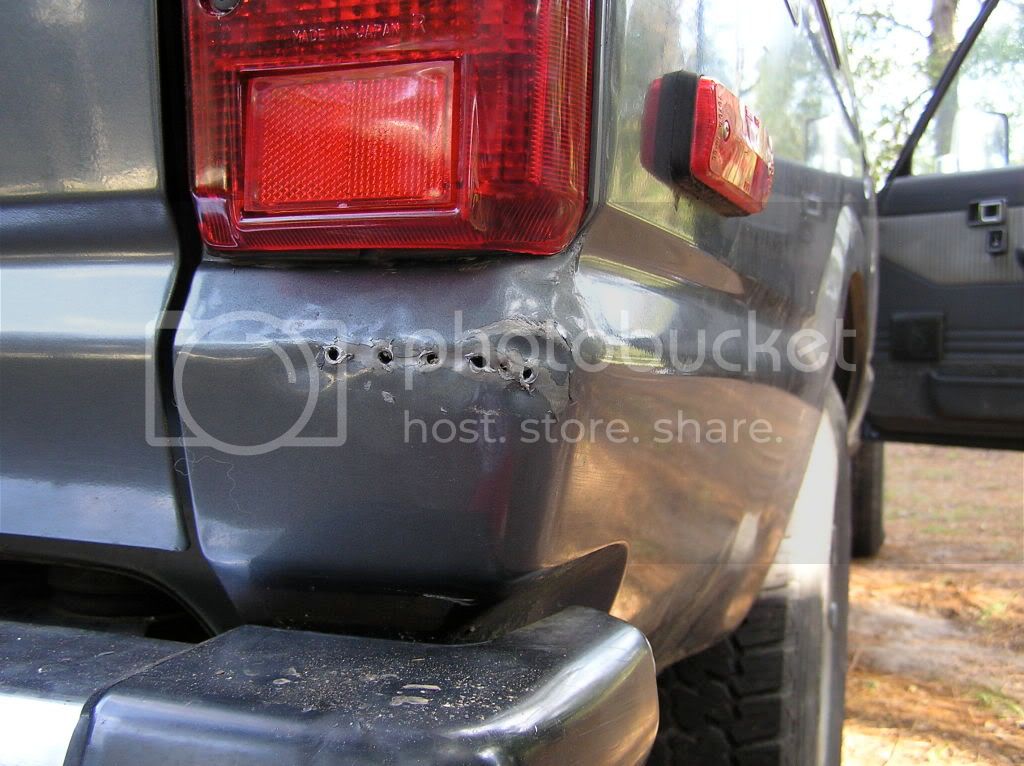

Self explanatory from here:

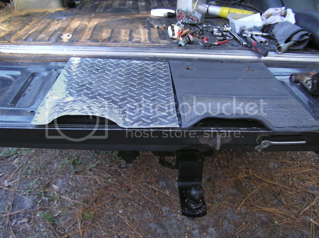

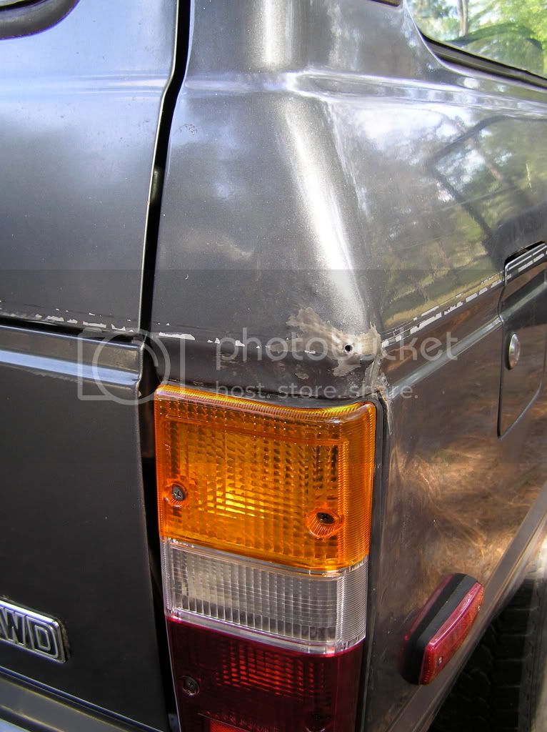

That buldge took a lot of whacks with the 3 lb. hammer and various sizes and shapes of wood behind it to reproduce. It's dumb actually, because the bottle jack is next to useless once you put bigger tires than 31" on there...

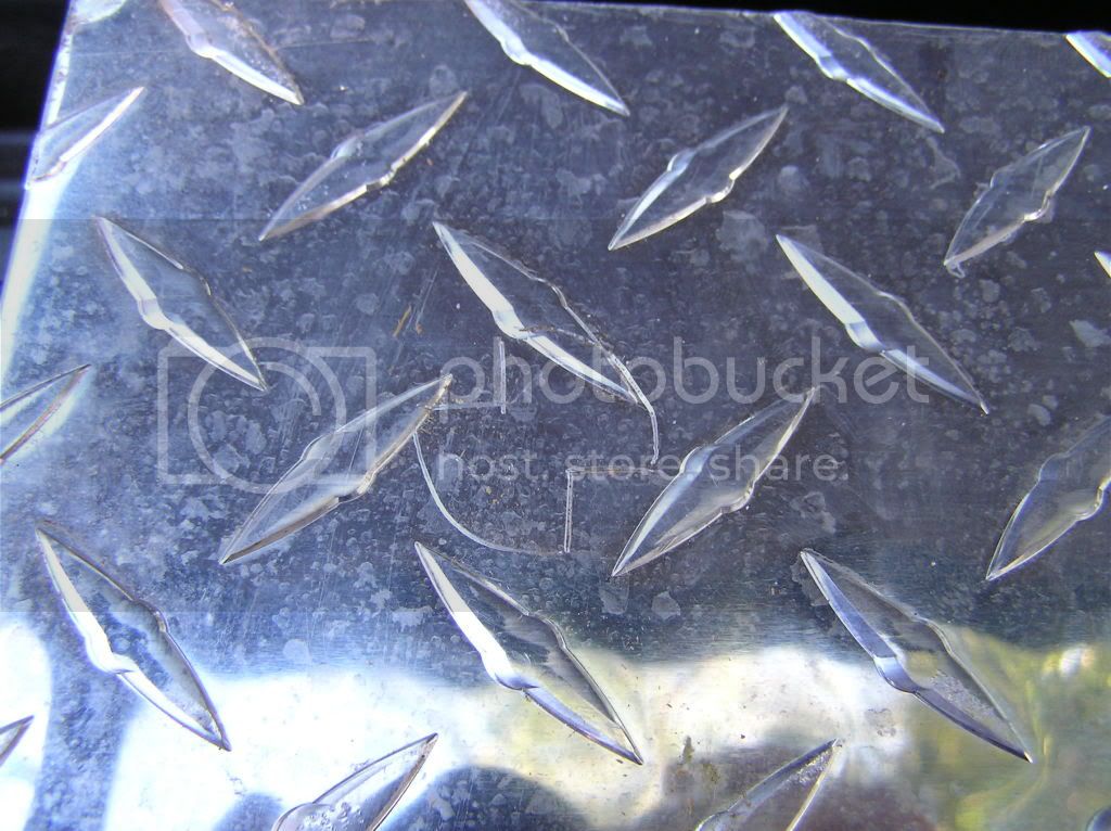

Diamondplate may be redneck and ghetto-fabulous, but it is really easy to work with (the aluminum kind) tough, light, won't rust, and is paintable. I'm going to Durabak it along with the floor, probably in smooth dark gray. I think the end result is very utilitarian and looks good. I'll add some small bungee fixtures and anchor points later.

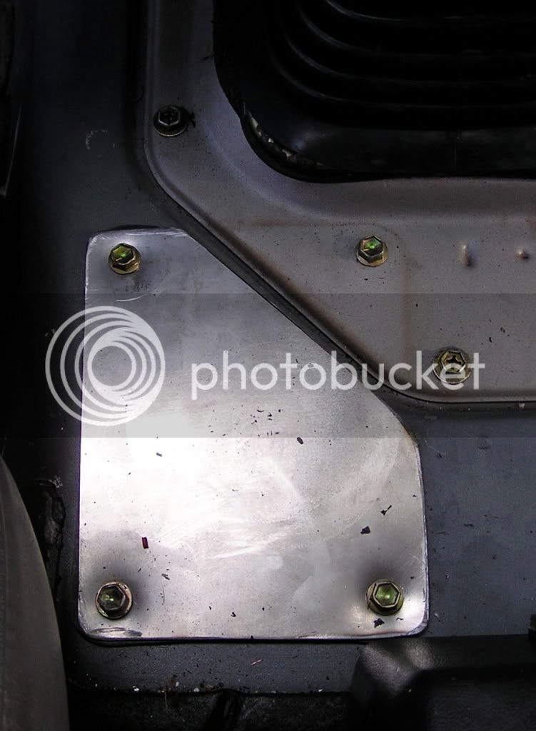

Auto transmission hole panel. I used 1/16" steel plate.

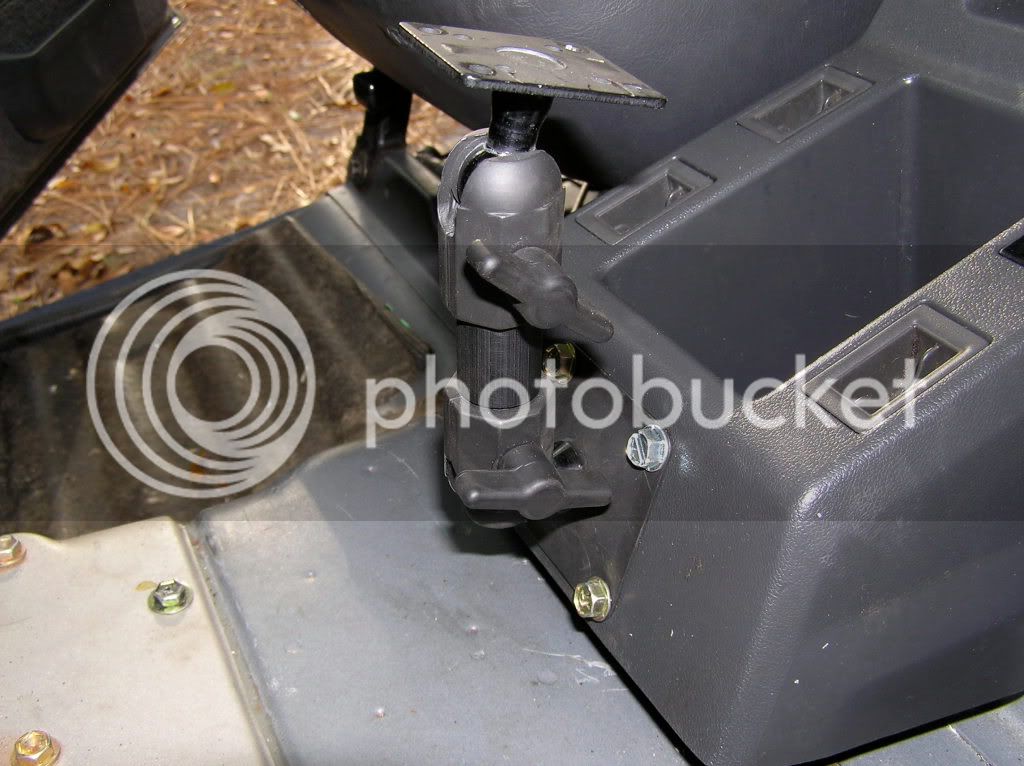

A "Panavise" 8 lb. speaker mount, mounted to the front of the console. Double knuckle design, for twice the adjustability. Two adjusting points offer a full range of motion 210° tilt, 360° turn and 360° rotation.
16-gauge steel surface mounting plate. Awesome for GPS, a small laptop, clipboard, etc. http://www.panavise.com/f/speaker/speaker_8lb.html

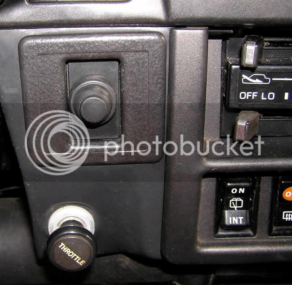

New improved location of the glow button, old 4WH button.

When I moved that glow button from its first position (the spare dash hole to the left of the steering wheel next to the dash light dim knob) to the spot where the 4WH button used to reside, I bumped both terminals against the back of the metal dash and there was a nice spark, pop, and some blown fuses. I replaced them all but never thought that might have fried my EDIC relay too. After a long process of elimination and checking for continuity and ground on all ignition-related wires, I finally had no choice but to pop open the EDIC relly itself for a quick examination. The burnt smell, the hot spot and scorch mark on the circuit board told the tale. $100 used unit from SOR (the ONLY 12V EDIC relay I could find, including Neil at RooDogs). I get it in the mail today.
