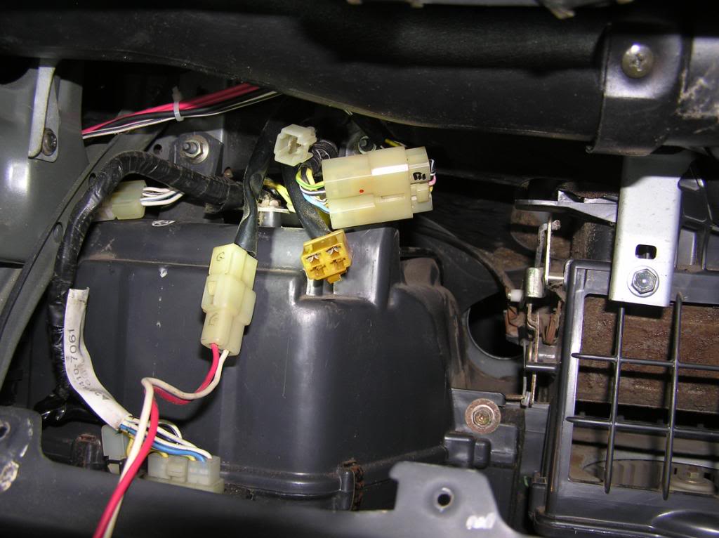

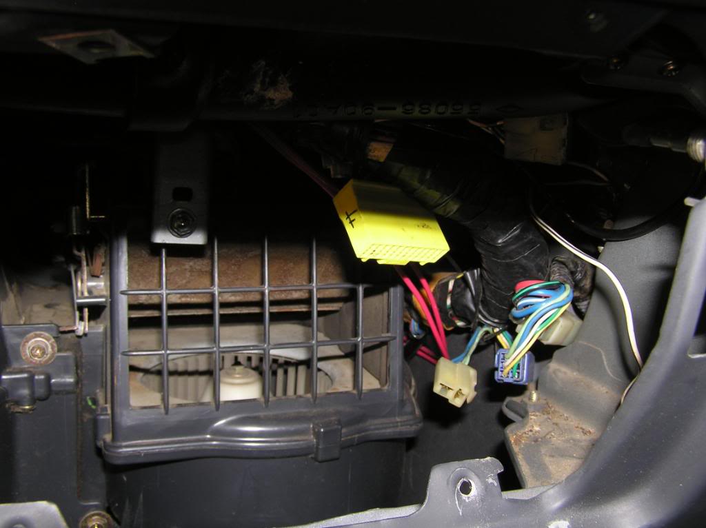

Can you identify these plugs?
White plug above, yellow below, behind glove box, on R.
Yellow plug and white (below), also behind glove box, on L:

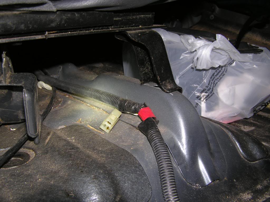

Under passenger and driver seats are these. Were heated seats an option?

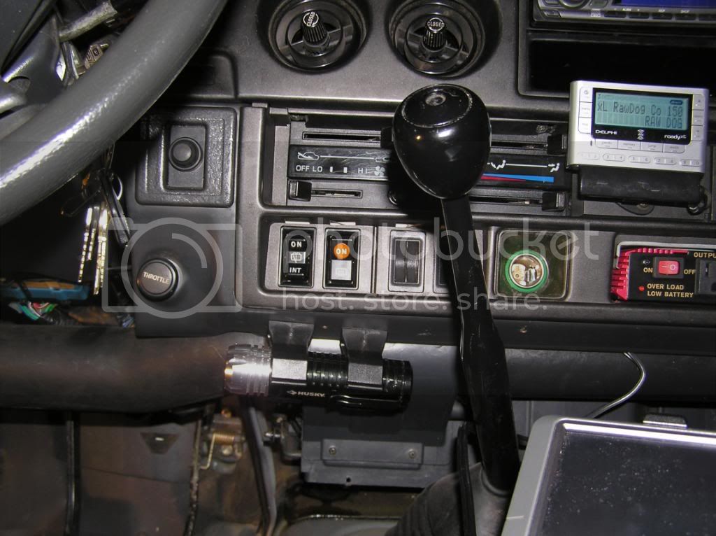

Recent upgrades:

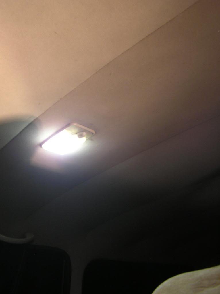

George Scolaro (TaskLED)'s dome lights, the new ones, front and rear, very bright and white not yellowish like the festoon bulbs, WAY brighter than the PepBoys LED festoons. Worth the $.

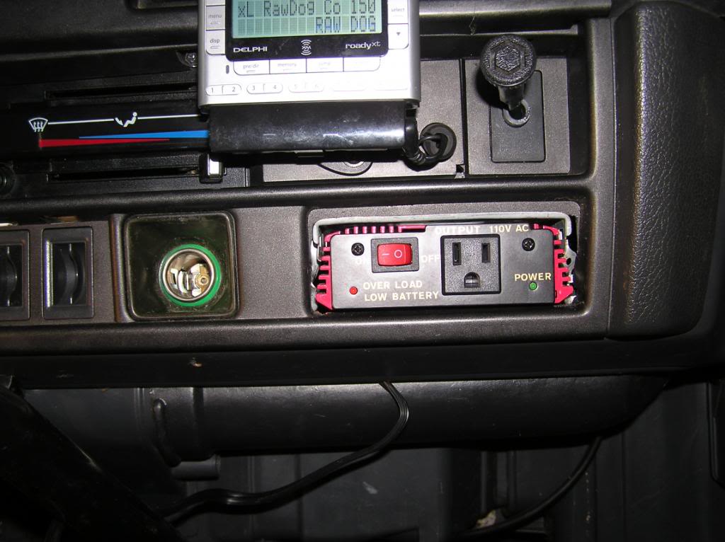

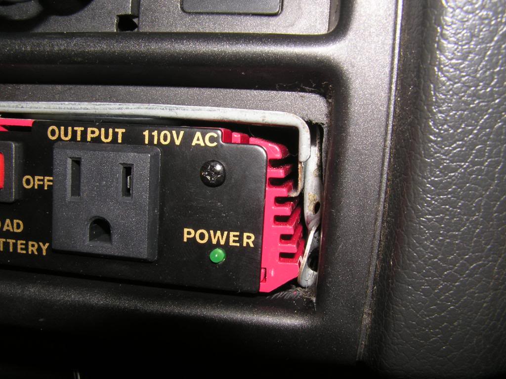

Inverter, same one as IH8MUD Forums - View Single Post - Best Mods under $50... (thanks klinetime574), but apparently, the 62's ashtray is narrower than the 60's, so modification to the metal tray (that the ashtray slides into) was required, but nothing big. In the end, it is a snug, solid fit, with about an inch all around (behind the panel), so nothing will prevent it from cooling property. I'd say DAMN close to perfect fit. I may fill around the face, for an even cleaner looking install.
And a close up, you can see how the cooling "fins" make for a nice place for the tray guide to grab.
Husky 2D 4 watt Cree torch ($24!), mounted to the A pillar via a pair of Nite Ize clips. THE brightest torch powered by 2D cells, BLOWS AWAY the 4D Maglight.
And for tighter spots/back up, the Husky 3AAA 3Watt Cree torch ($14). I count a total of 12 (or 13, depending on how you count) mods to this photo, some subtle and free, some big $.

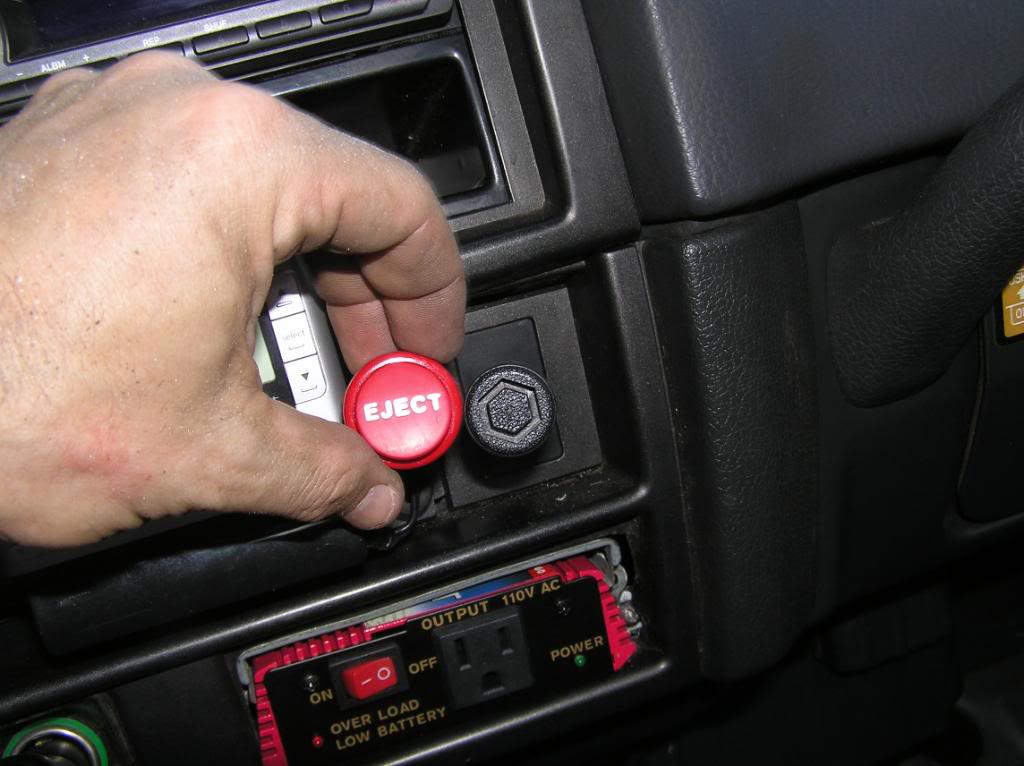

I've been busy today...
Thanks Amaurer! I just need to resize the threading on the rod, and my eject/kill button will be finished.
