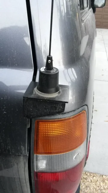

Mine is also the entry level Kenwood 271A. It fits below my single DIN radio in the dash of my 80 very nicely using the OEM radio brackets with spacers and longer screws. The flash in the pictures really did a fine job of illuminating all the imperfections of the mounting job I did. In reality it look almost stock. The front firing speaker is loud and clear and the radio is simple to program.
For the antenna mount I used a Diamond K400SNMO with a 10' RG316 extension cable I had made, so it makes it to the dash easily.
I have 2 different Diamond antennae that get mangled in trees so I went with a Larson 150 whip that gets the crap beaten out of it and doesn't care.
Some pictures below for your amusement...

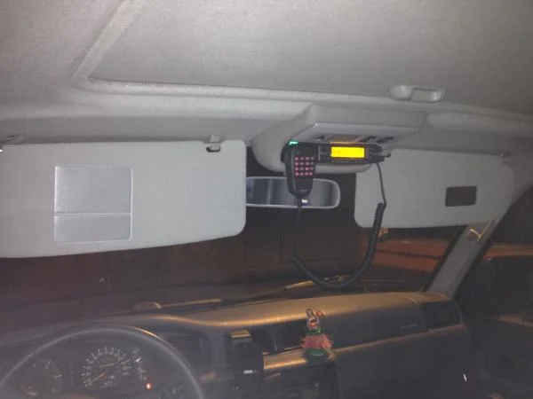

I'm in the process of installing a kenwood D710G. It's just like the D710A that was mentioned earlier but has a built in GPS receiver so you don't have to have a separate unit. The main radio unit will be under the driver seat. And the faceplate is going in front if the transfer case shifter on my 80.
Going with a Larson dual band antenna with an NMO mount on my stock front bumper.
I'm adding a blue sea fuse block to provide the power. Just waiting on it to show up.

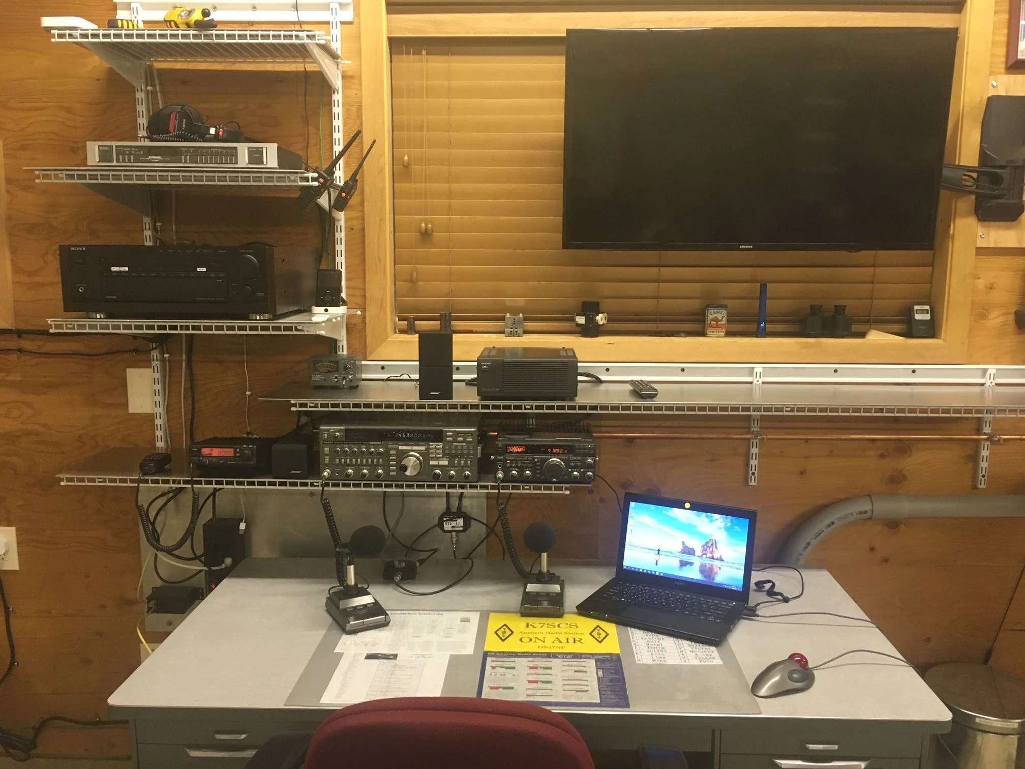

Shack in Rig = FT-8900R
full
Shack in the workshop...a bit more complex = FT-2500M (will go into the 45 eventually), FT-736R for 70cm, 2m and 6m, and FT-890AT for HF. Obligatory computer, stereo, and TV to round out the entertainment options.
full

Did the coax follow the weather seal and route under the vehicle? Im getting ready to install the same type of mount. Do you still use it?
That install was on my old 91. For my LX450, I used the same mount in the same location, but I ran the coax under the outer lip of the hatch gasket and into the body behind the left tail lamp assembly. This keeps the hatch gasket in 1 piece and protects the coax.
