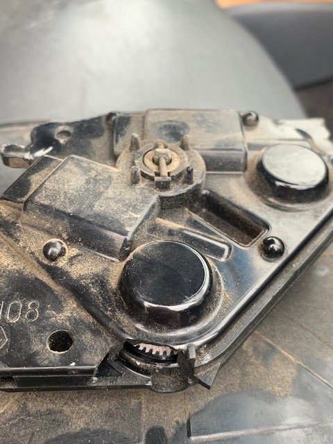

What's the fix if my bottom tab is broken like this?

I would like to throw in my 2 cents. First off, excellent fix! 2nd, every 10 minute fix is one bad move away from a daylong PITA. Passenger side mirror was problematic when it came to getting the center post to slide in to the "pocket". I did read in this, one comment about cleaning the area where the center post fits.
I will wholeheartedly add, definitely clean it, the dirty parts the mirror bracket and the cradle it fits into. I did this and the passenger side mirror went back in, finally.
On the drivers side, followed the instructions, CLEANED all of the dirt, dust, and grime from the "pocket" the post slides into, the mirror bracket, and the cradle it fits into. The driver's side mirror went back together very easily. Drivers side was a 10 minute job due to cleaning before reassembly. Now for the test drive.
