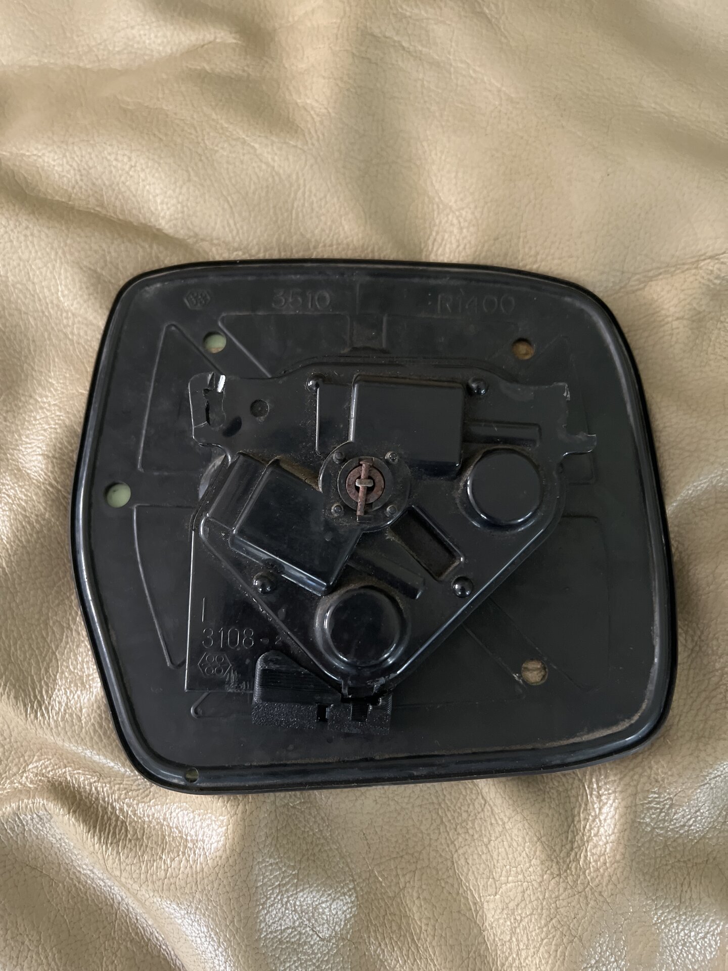

Am I am idiot? I can't seem to get the bracket to work. No matter what I do, I can't get the window motor to go behind the bracket
Have you watched the videos?
Yeah I watched the YouTube short and the guy said to fish it around but no matter how much I fish it around, it won't catch behind. I also have the bottom post piece on too but I can't get it to sit on top of the whole in the inner mirror bracket because I can't get the motor fished up high enough behind the bracket
Maybe post some pics? I did this fix, was straightforward enough with the youtube video as a guide. Either there's something you're doing wrong, or there's a physical difference with your setup.
I'll get to that here in a bit. I have a few I can send now, but I can get better ones and videos when it stops friggin raining out here.
Pretty much just pictures of the setup before even putting on the 3d printed mount. It's on there now but don't have a pic of that yet
You may try loosening the screws on the 3d printed bracket by about a half turn, the mirror still needs to be in their tight, so don't loosen them too much.
Thank you, I originally thought they needed to just be open instead of completely removed. So doing this plus loosening the bracket a bit seemed to do the trick. Happy to have my mirror back!
