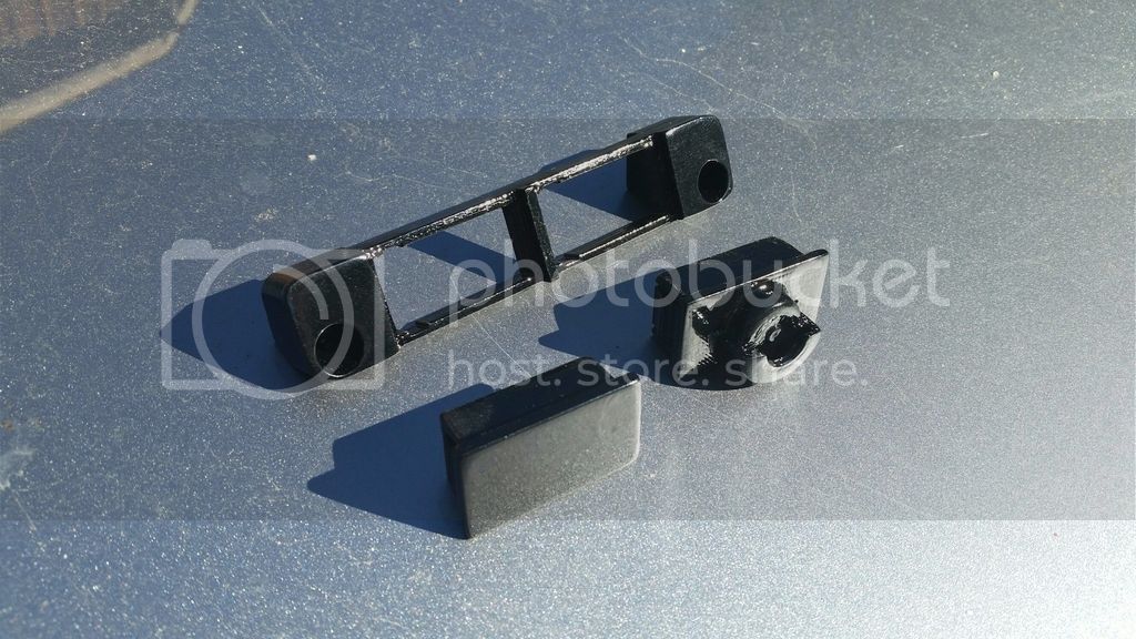

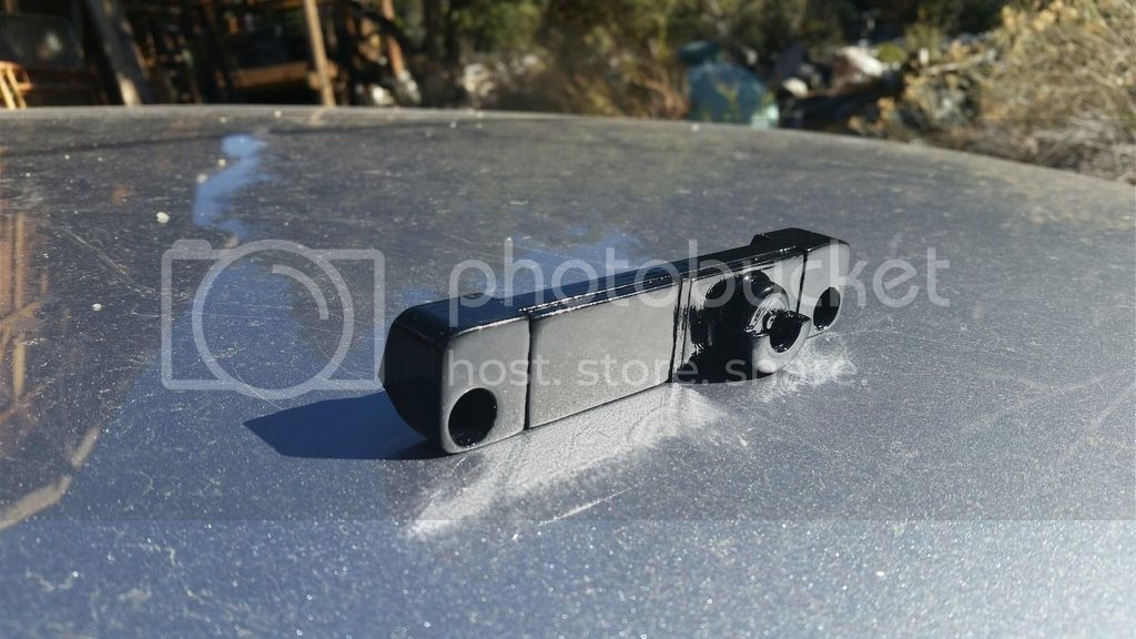

And finally prototype #3. It turned out great. I made a blank plug for the folks who will only need one accessory to start with. It's easily removed. I also made the CB Mic holder as another plug. Everything is snapping together perfectly. The finish right now is a bare plastic gloss black. I can probably do a sating black paint job on them for a extra couple bucks. I will get pricing figured out over the next couple days. I'm looking at about $25 for the bezel and maybe 5 for the blank plug and $7 for the CB mic holder. It's not a lot of filament used but a ton of work removing all the supports, then sanding, then doing an acetone bath. It's more labor intensive than I was expecting. Now I just need to make sure the entire bezel fits into the dash perfectly. I'm rather confident it will be I want to be 100% sure before I ship any of these.

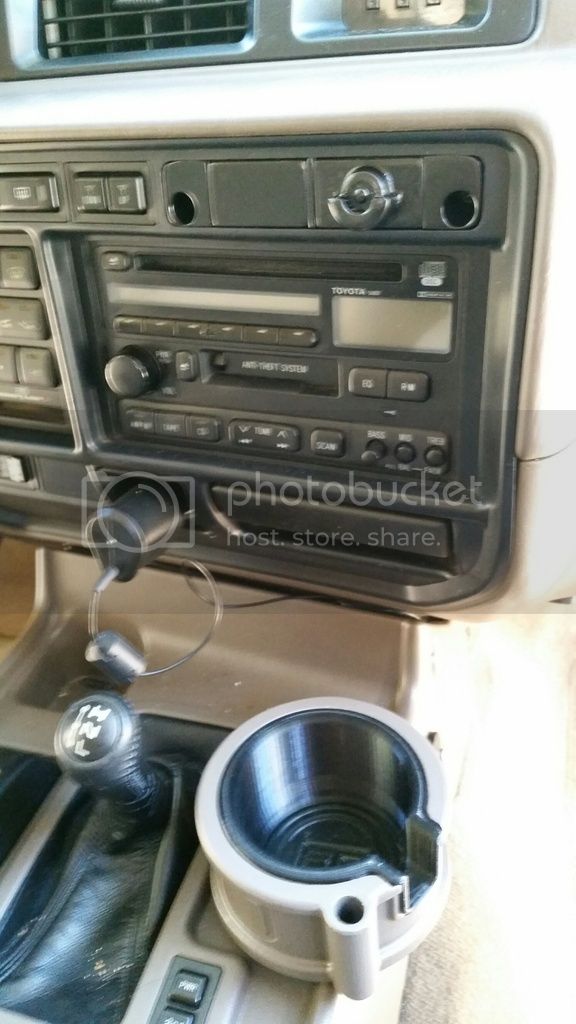

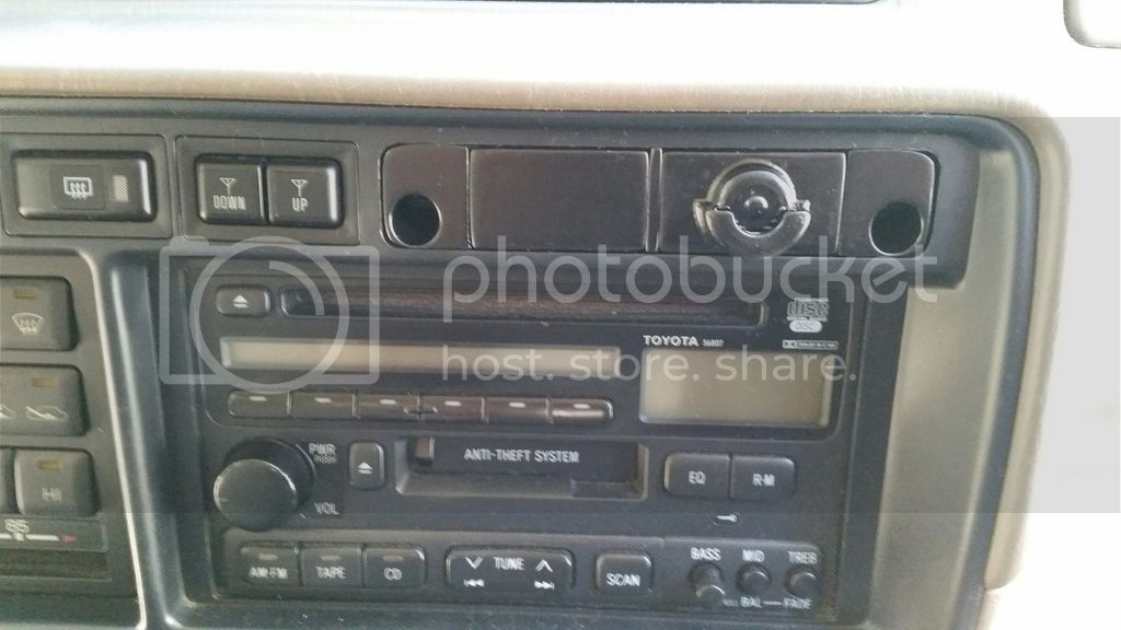

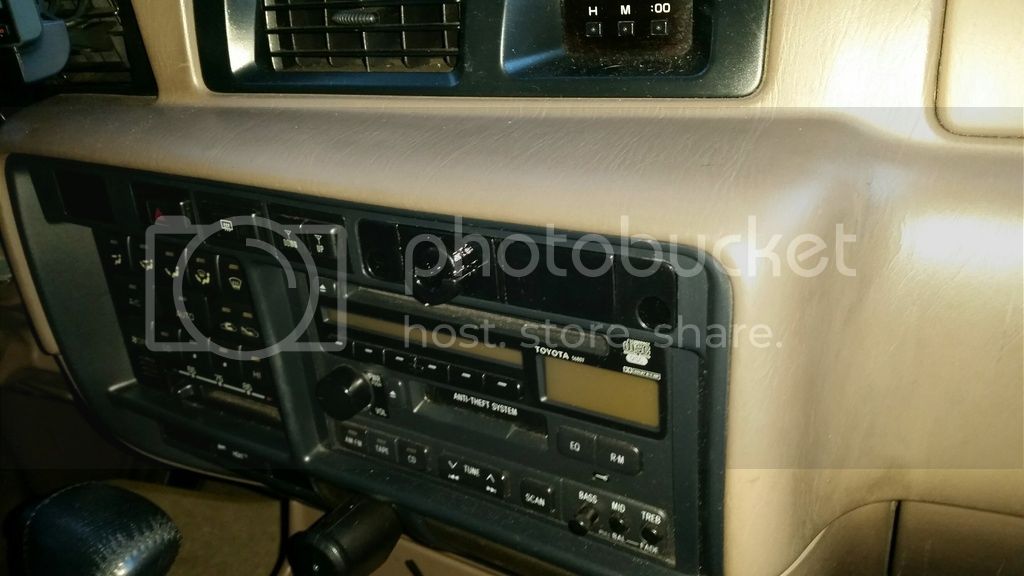

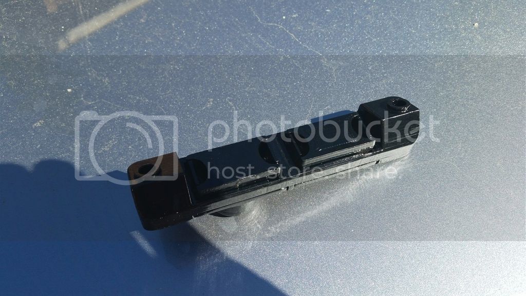

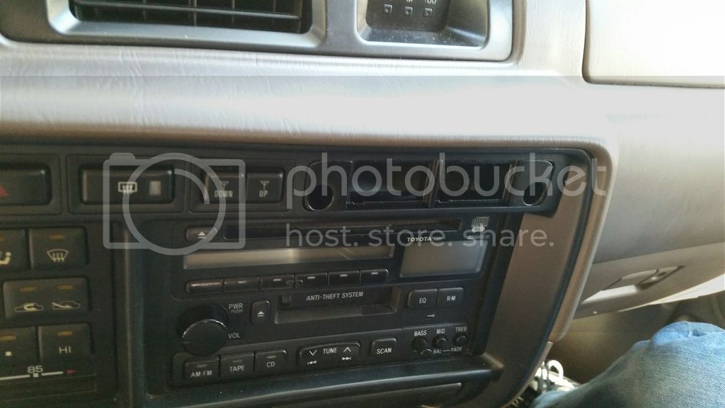

Good news. A local (THANKS DAVE) allowed me to use his 80 series for a few minutes and fitment was great. The only issue was that the holes for the screws was a tad too small. I could force the screw into the hole but I wanted it to slide in with ease. The final version 4.0 is on the printer now and I will run back in the morning to do final fitment. I should be able to start a batch of these by tomorrow evening and have them up for sale on Friday. Good timing for black Friday. Here is what I have. The gloss black isn't the best look so I will probably just make them all a satin finish to match better. version 4.0 pics will be with the satin finish. Sorry for the crappy pics. It was getting dark outside.

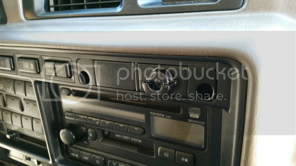

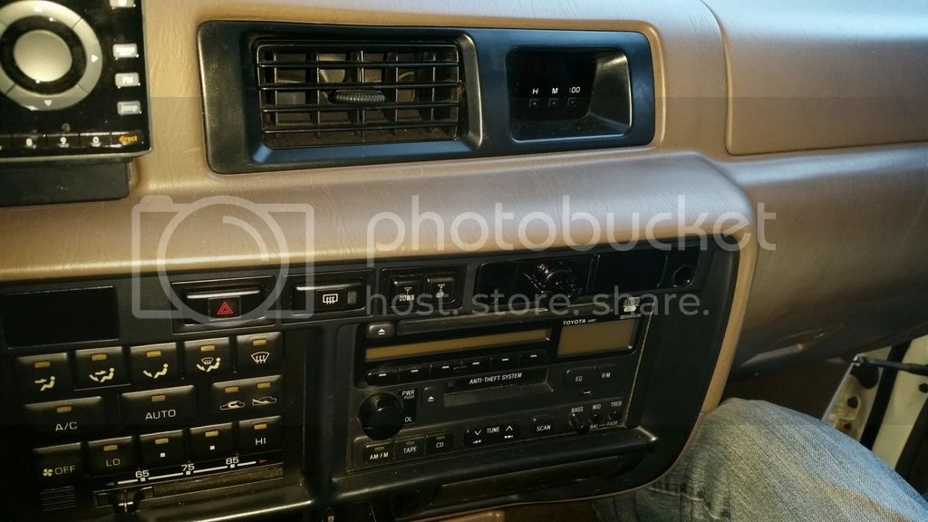

And now for version 5.0. I made a couple structural changes (no change to fitment or the outside). I wasn't happy with how much flex there was in the middle of the bezel. The gamiviti one had the same flex and I wanted it a lot stronger. After some stress testing in autodesk I was able to put supports, thicker walls, a filets in key places to give the needed strength for long term abuse. I also went with the satin finish and got it all installed today. Everything fit and function as I had desired. I now have 4 machines running full time to make a large batch of these. It will take a couple days to get the batch done and then Thursday will be put aside for family. I will get them all prepped on Friday and on my website by late Friday afternoon. Here's the final version.
