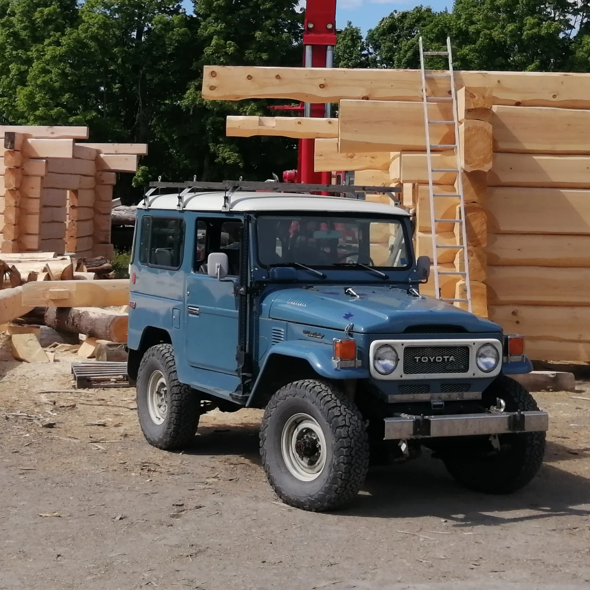

10cm = 3.94-inch back-space I saw these on a 60 a while back. Awesome conversation, friendly folk chatting about 2Fs and 4-speeds.
The owner sold the 60 for a 100, and was "just back from the Yukon hunting grizzly and caribou." Here for an elk this fall. I can't help but wonder, who cares about wheels when you are capable of hauling two to three-hundred pounds of meat over a mountain, by foot, to a dozen ice chests in the back of the Hundred-Series Cruiser?

Those metallic American Racing wheels look ok, they just need grey paint, and a photo in front of some awesome log-cabin construction.
