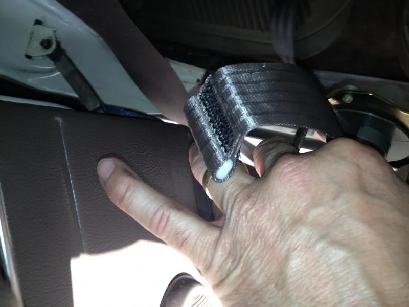

The only difficult part is getting the webbing out of the upper mount on the b pillar. It was more difficult getting it out of the Camry than back through the LC. Notice the enlarged area in the corners of the B pillar bracket. That extra space is helpful to get the doubled over strap through. Just need to get a small piece through, then grab it with small channel locks and then pull them through. tight but doable.

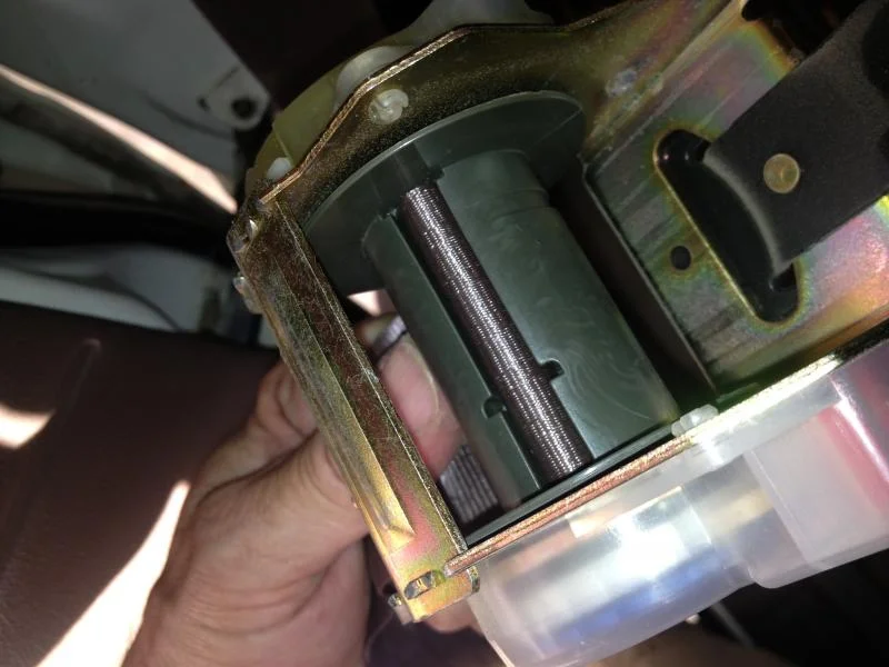

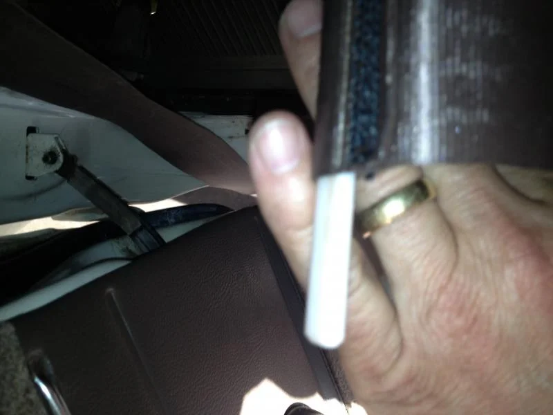

After removing the old belt and getting the new one strung through the upper mount, it is just a matter of removing the old from the lower spool and re stringing the new one through. I wound the tensioner spring about 4 rotations to add some snap back to the seat belt so it would retrieve the slack better. You need to push the seatbelt into the spool to remove the plastic dowel that holds the belt to the spool.

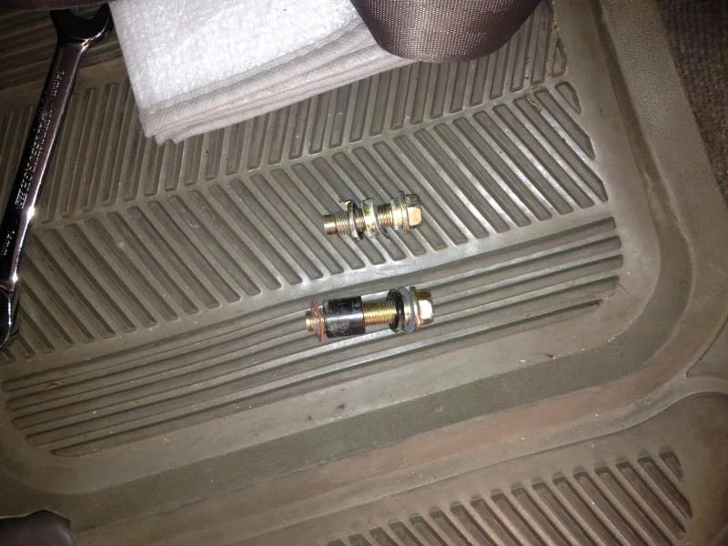

There are only two bolts to remove on the lower bracket, a 14mm and 10mm bolt, that's it. You will want a small screw driver to slide into the spool to keep the coil from unwinding while you work to get things back together. It was really pretty easy.

You will reuse the mounting hardware from the LC, the Camry uses a shorter bolt. You could save some time by cutting the LC seat belt so you wouldn't need to pull it through the upper bracket, I didn't because I wasn't 100% sure everything was gong to work out. I would cut it out if I was doing it all over.:meh:

Re tensioning is pretty easy, you would only need to pull the belt out of the spool on the tensioner, wind it up a couple times and re thread the belt through the spool. I would say that could be done in 20 minutes.

I just looked at my spare set. They have two clear plastic covers. One clearly shows the ball bearing for stopping the belt during an accident. The other has the spring in it.
Both are stamped do not remove. Neither has screws for removal but plastic pins that look as if they would snap if I tried to remove them from around the spring. I also cannot get to the end of the belt as the reel doesn't roll that far.
