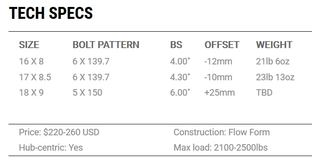

I think the back spacing is about 4.3". What is ideal for our rigs? 3.5"?

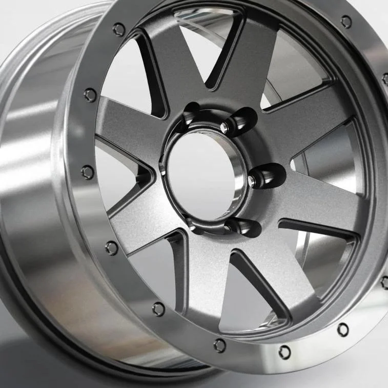

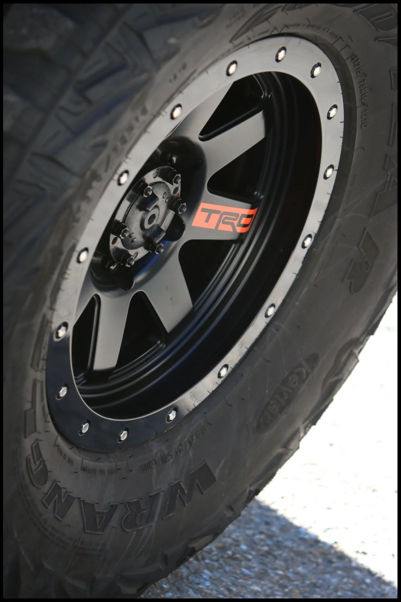

I am looking into the SR8 wheels for my 80 series as well. Curious about this question and whether the machined portion of the wheel is noticeable and will require additional powder coating etc? Anyone?do you have a picture of the small lip that had to be machined off?? did it damage the finish of the wheel and had to be repainted?
Not noticable at all. This is the best photo I could find online that shows the lip. Its pretty small on the inside bore. It's only there to hold the center caps.I am looking into the SR8 wheels for my 80 series as well. Curious about this question and whether the machined portion of the wheel is noticeable and will require additional powder coating etc? Anyone?

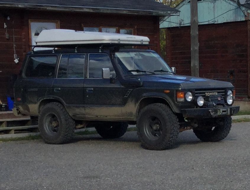

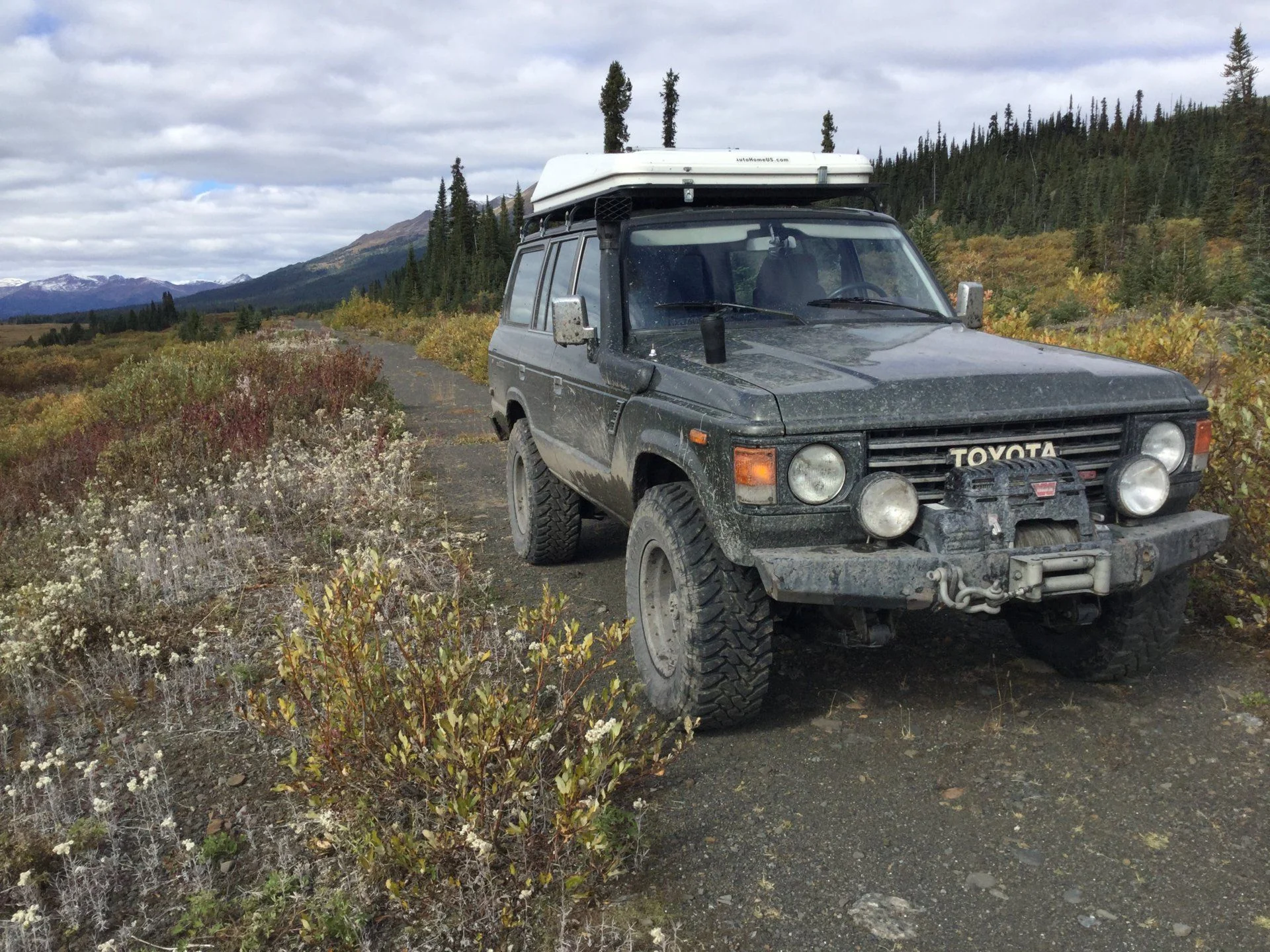

Anyone running scs on a 60? Or 61 with flares?

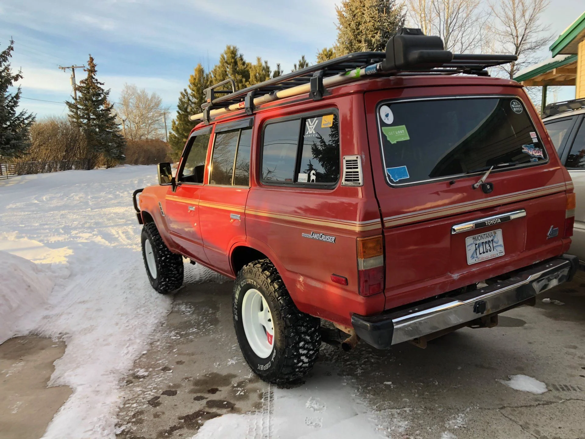

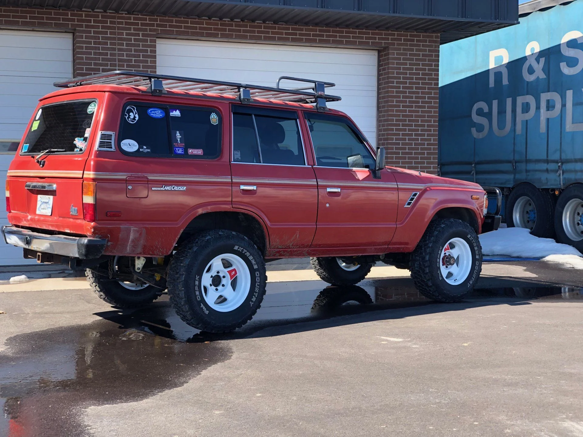

I'm struggling to find something that will still keep a 10,5 wide tire just inside fender.
I run Cooper Discoverer STT in 37x12.5R17 on Tundra wheels, with 1.25" spacers, if doing it again, would go with 1" spacers. There is room on the inside, but under some conditions touch body work on the outside. The Tundra wheels have more backspace than stock wheels, so this setup is about like stock wheels with ~.5" spacer.
