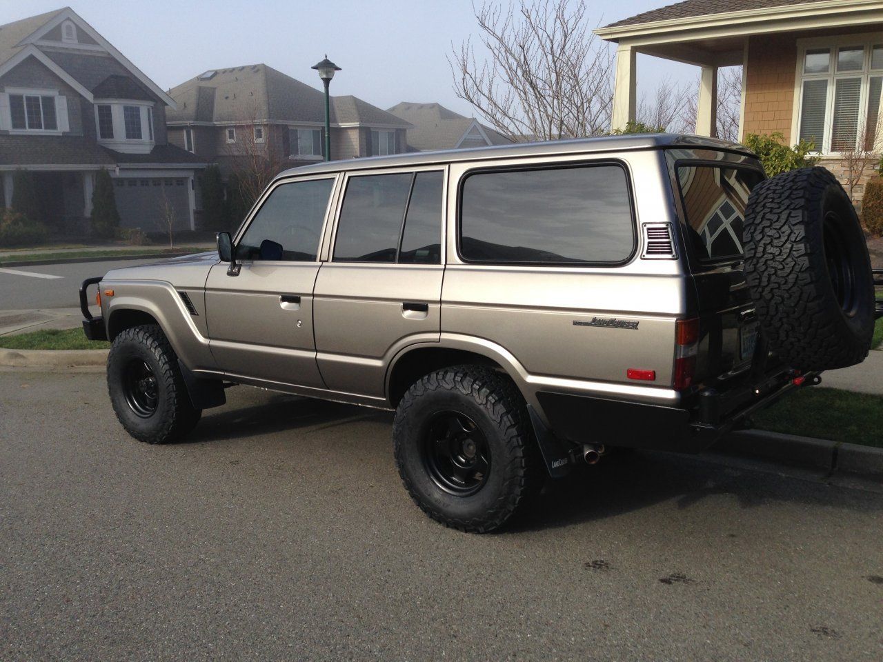

I really like the latest size (17x8.5), lots of rubber options in that size but the 4.3 BS seems a bit much on a 60 series from what I've read. Cruiserpilot did you order some? 5 Matte Gunmetals has me drooling.
The BS is too much for the 60 series. You'll need to run 3.5" bs or less to have proper clearance. To make the 17s work, you would have to run a 1" spacer with the wheels.
