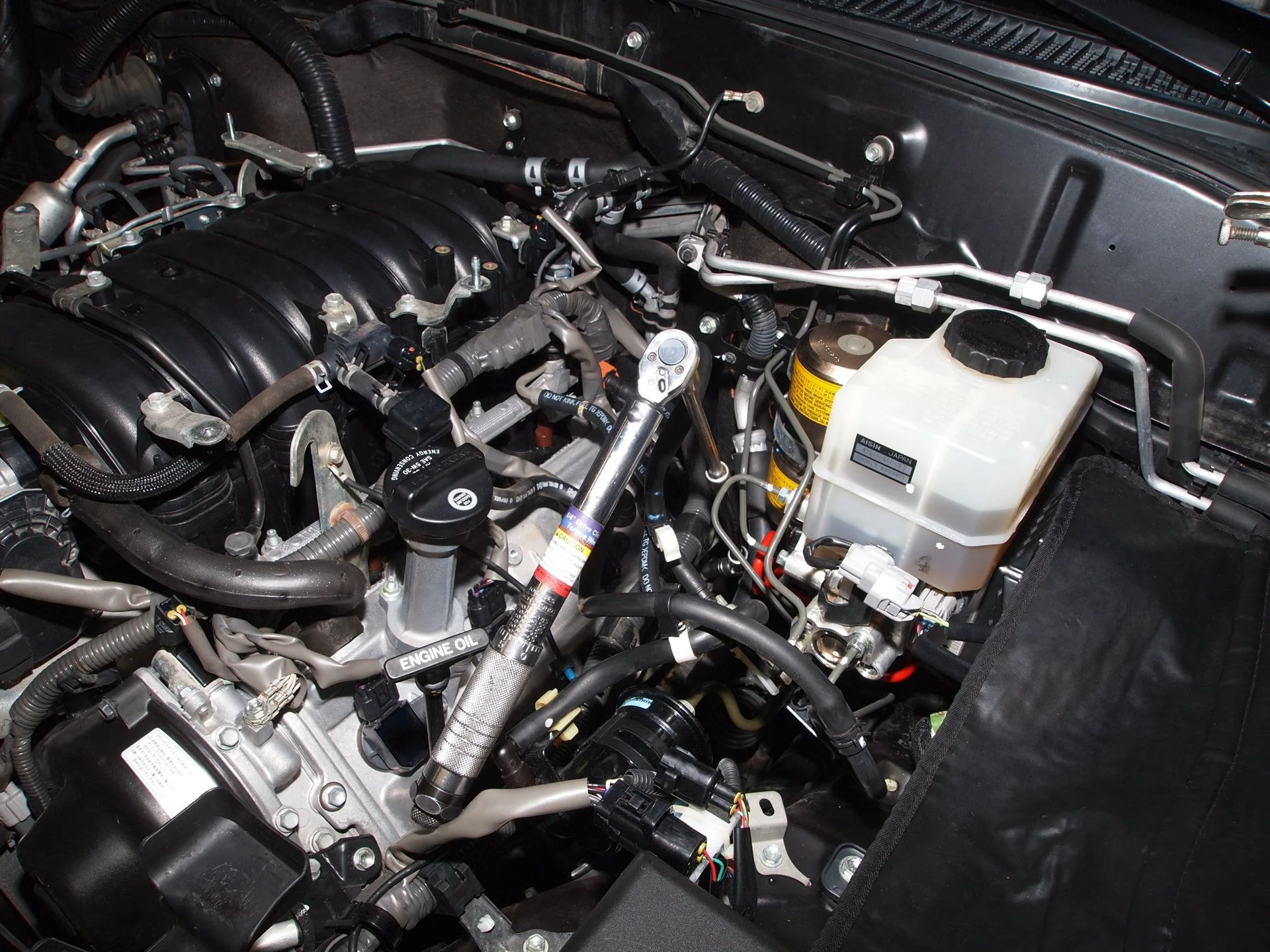

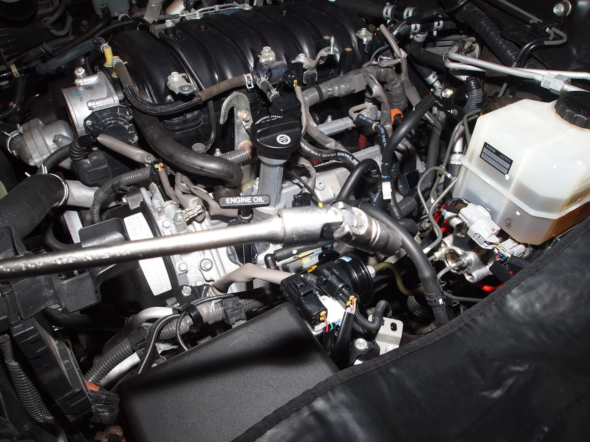

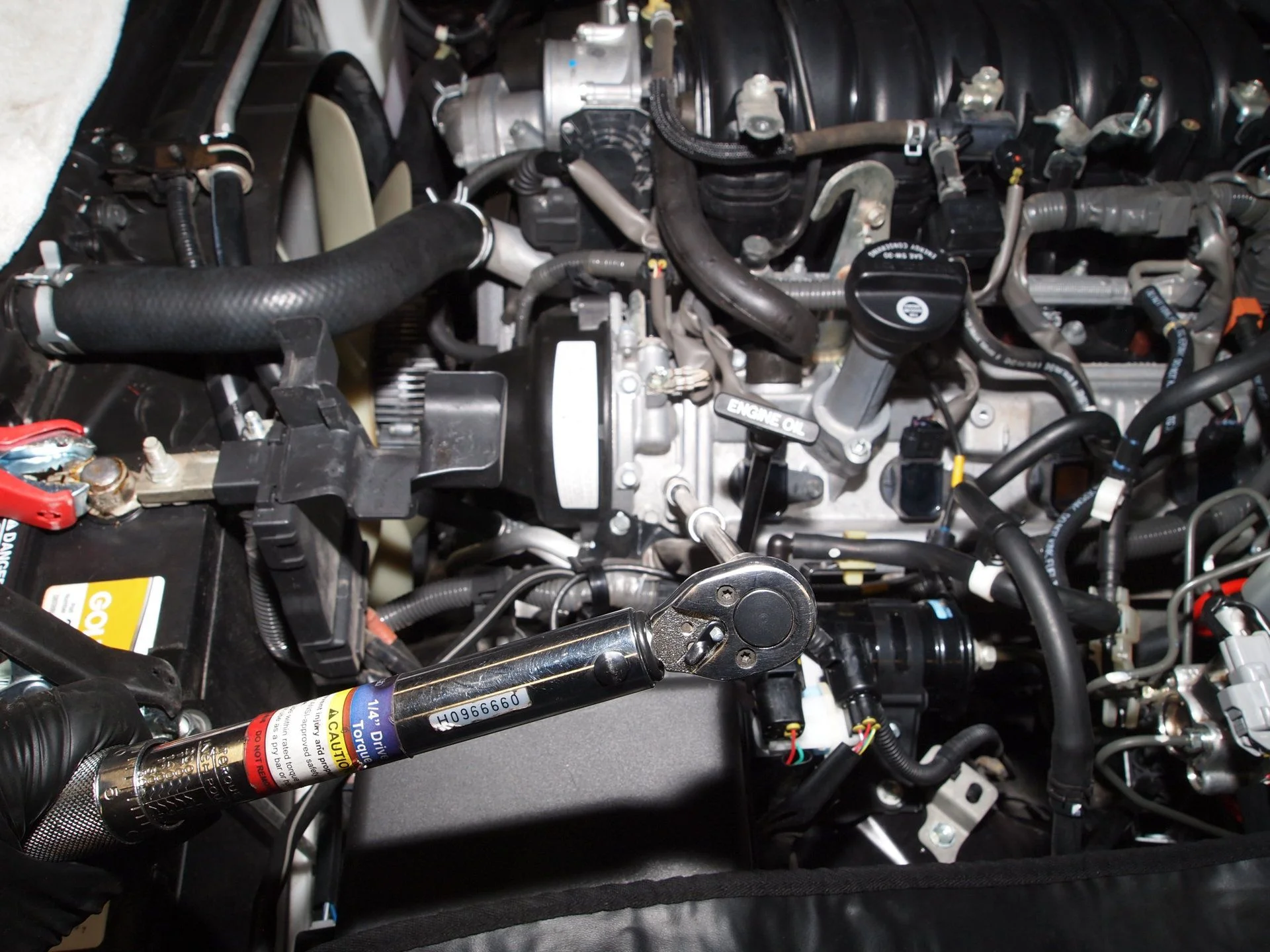

Head cover bolt re-torquing has become a standard PM to prevent oil leak for me. I've yet to find one that didn't need it.
53IN-lbf
  • Like
Reactions: BCM
Good question.
I do a cross pattern and go over twice. It's not supper important to use a cross pattern, as this is such a light torque, but it can't hurt.
Being such a light torque, it almost always takes a little more second pass as seal settles.
Note: on older rigs especially those from rust belt, they can be frozen. Those can take more than 53IN-flb just to get started.

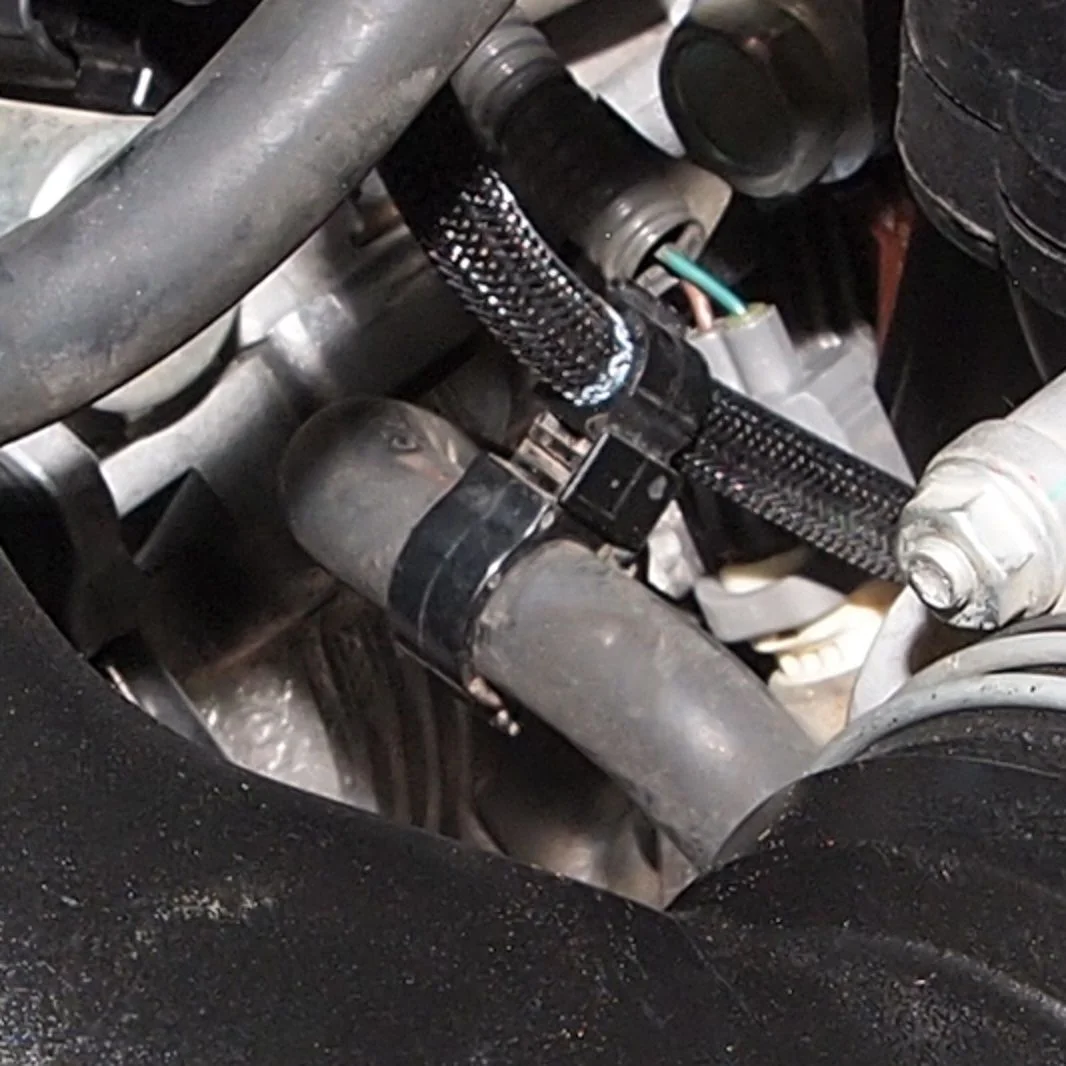

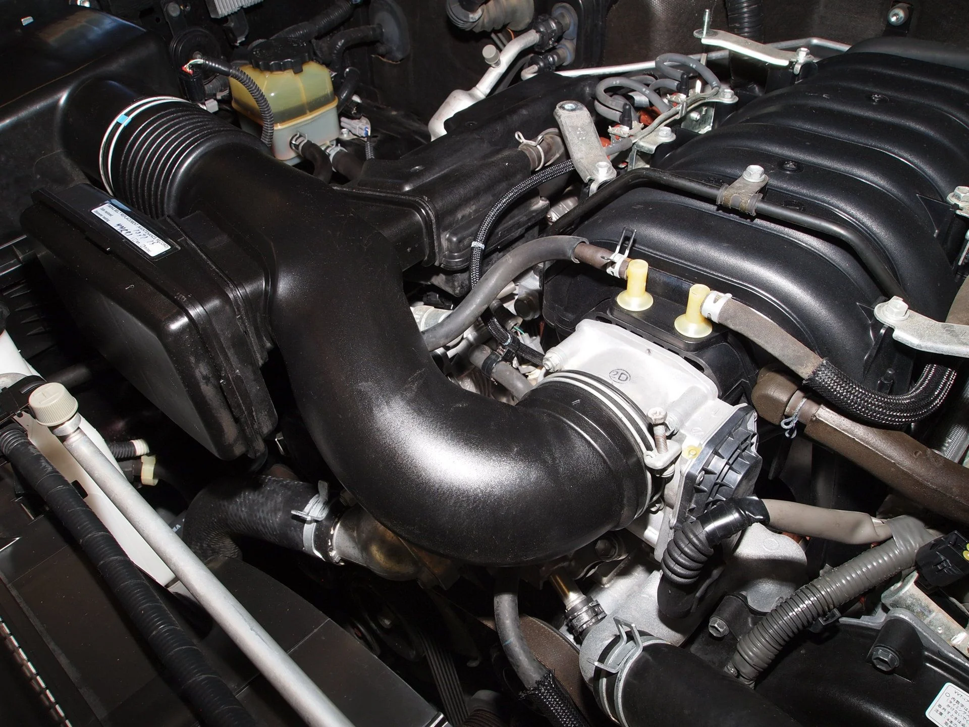

I find this two line retaining clip used to stabilize vacuum lines, so often broken.
I replaced this one, with a swivel type I had lying around. It isn't actual the same offset fix design as what factory had there. But this style should last much longer and do the job just find.

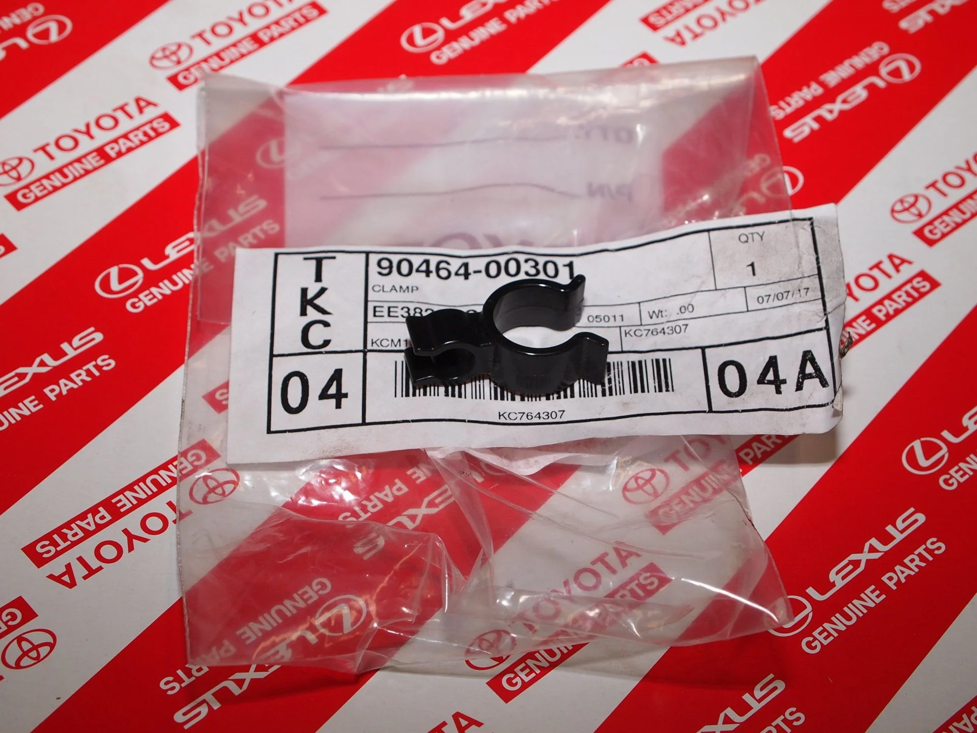

FWIW, Here is the factory proper PN #.

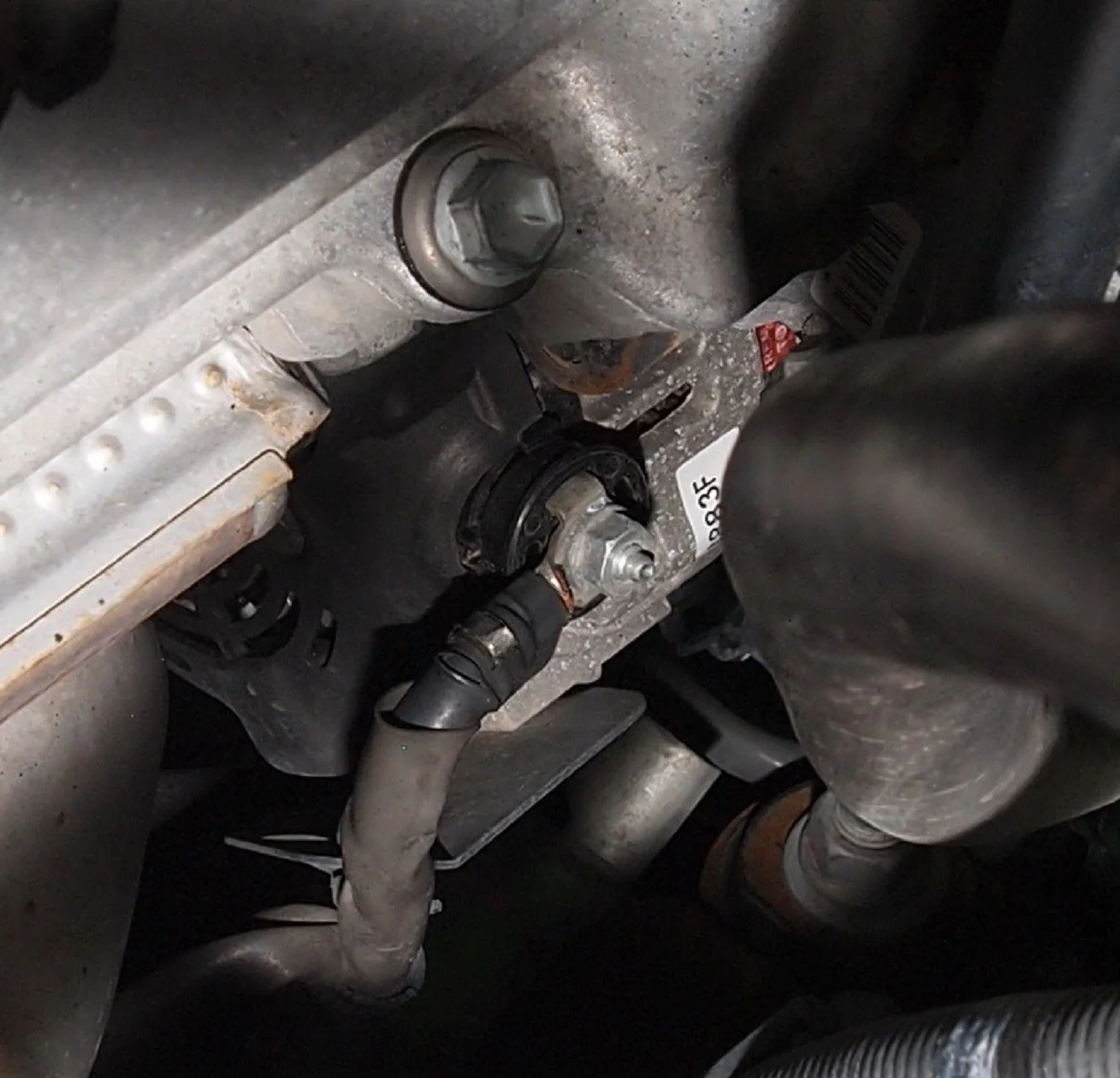

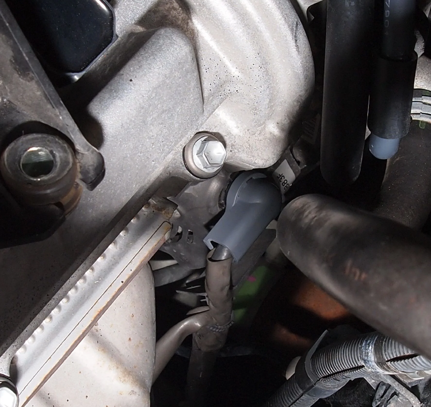

Found the cover for hot lead on alternator missing.

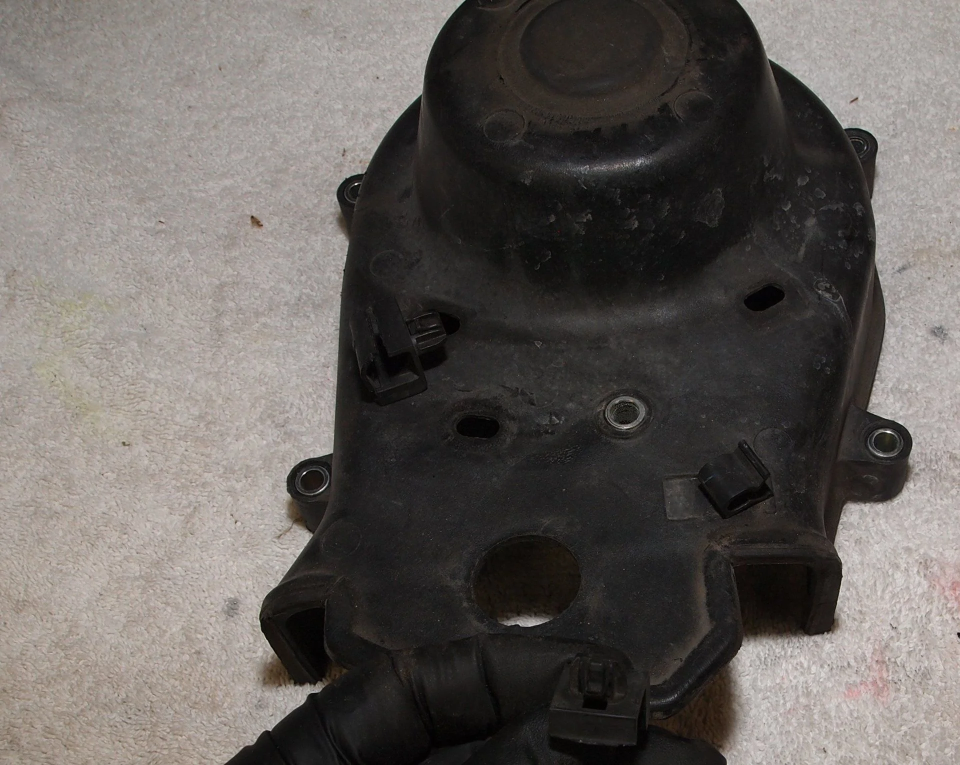

Timing belt job was done, which often means broken or missing clip from front of DS top timing belt cover. One of these clips was missing, leaving a passage/hole for dirt to enter. Not a big deal, but I do like wires tucked in away from drive belt. I've not found one of these clips from Dealership parts department yet... Luckily I had a cover in the shop I was able to pull from to replace it with.

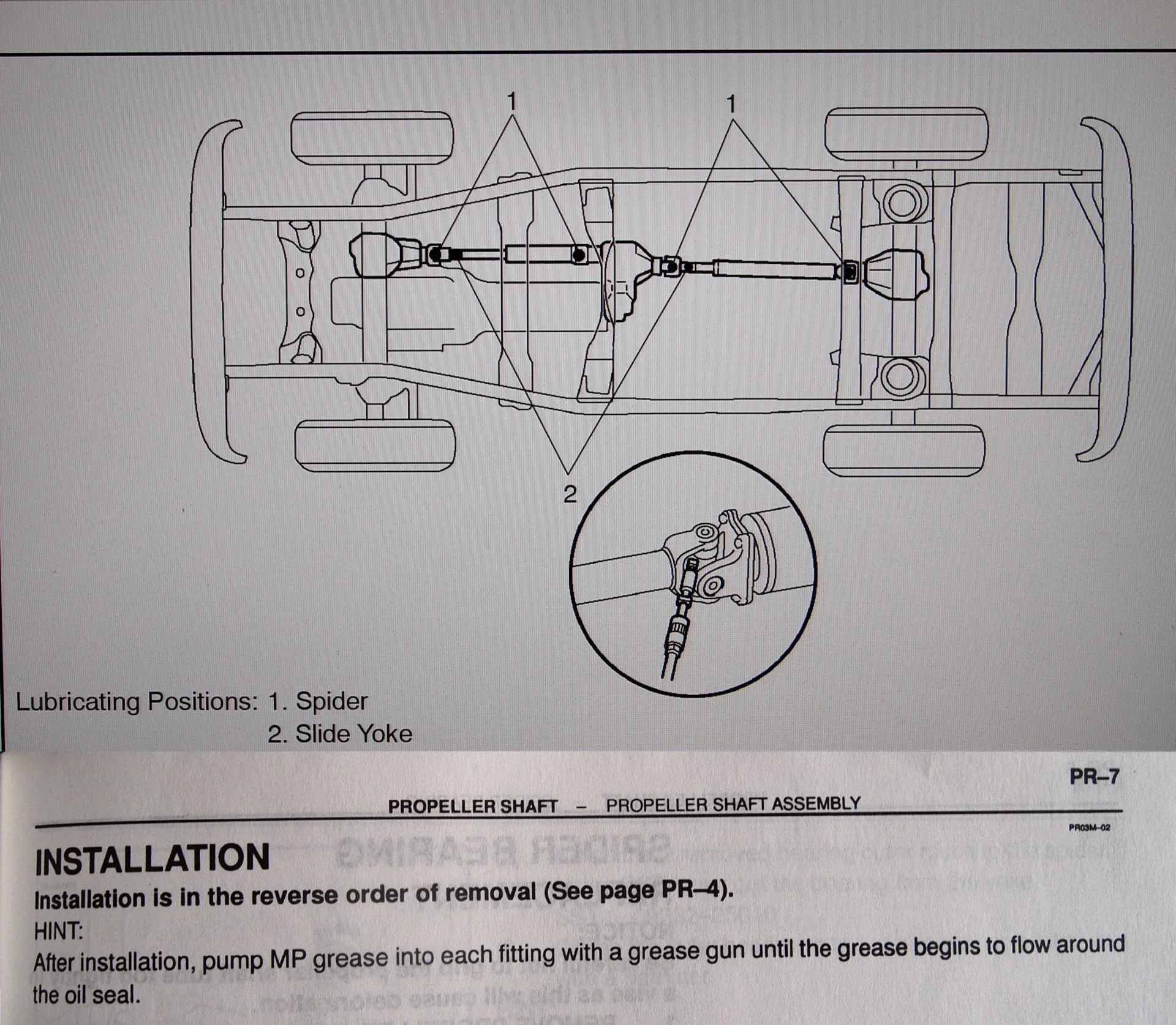

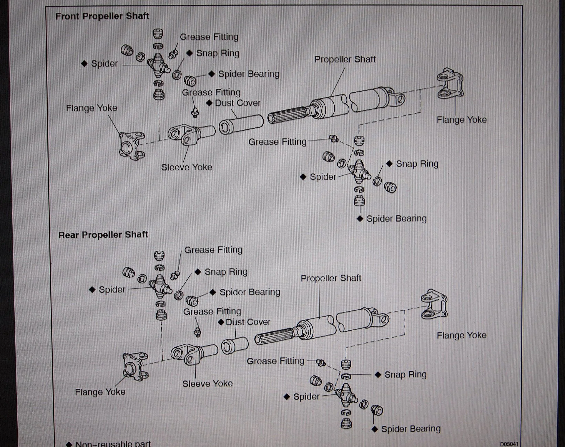

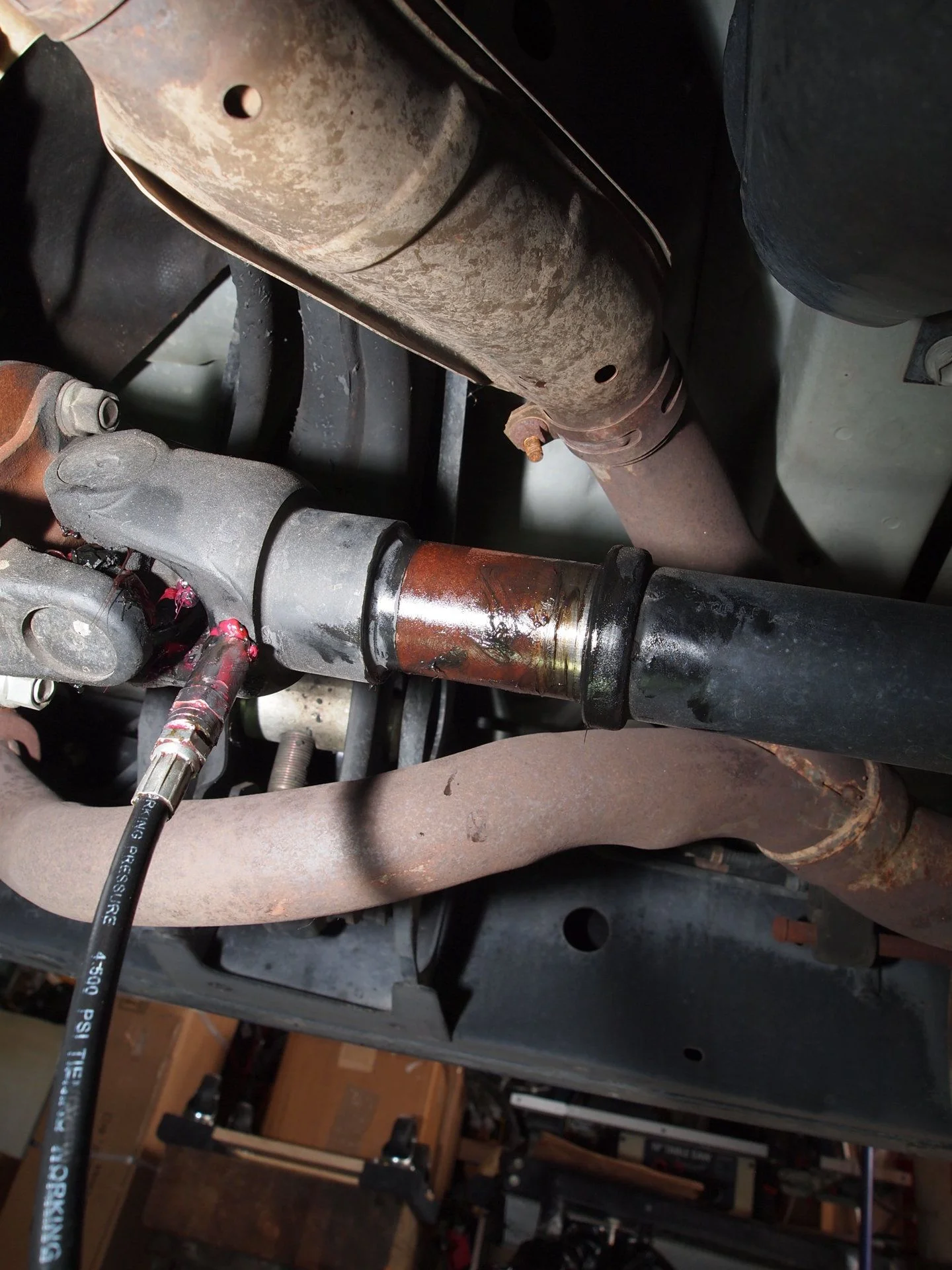

I just notice I have not posted lubing propeller shafts and spiders. I actually did this during warmer weather. I avoid doing when cold as grease does not flow well cold. IIRC In 2003 Toyota flipped the rear propeller so that slide yoke is forward near transfer case, as opposed to near rear differential. But lubing is the same.
Toyota has now changed the recommendation on lubing the slide yokes from grease until grease seen passing seal. To grease until yoke begins to extend. I'll add: keep rear drive shaft in neutral position. Either keep wheels on ground or support under rear differential. If AHC
equipped keep in "N". With spider I just grease until new grease flows out seals.
If dealing with a high mileage that's been under lube, I do grease slide yoke until grease passes seal. But I've a very special technique when I do this, so I don't over extend the propeller shaft yokes. In this low mile, I just did until extension, Also I did see signs it had been lube in previously.
As always I wipe off tip of grease fitting before hooking up grease gun to them. Don't want to push dirt into the fitting.

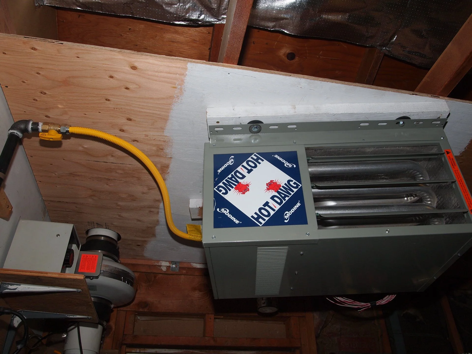

Decided to heat & insulate my garage. Bids I got where running $17k to $23K, heat, ceiling and one wall with drywall & R13! So did myself at cost $2,300. Still need to replace doors and do the walls $2,500 est.. But man what a difference, I can make it toasty and stay cooler on hot days
Once done installing heat in shop. I got cough up helping other local mud member's and neighbors work on their rigs. From 1998 to 2011LC Land Cruiser and LX's. Some just leave with me, some worked along side me to learn.
Oil & filter, spark plugs, coils, vacuum lines, brakes, steering rack, ball joints, wheel bearing & knuckles, etc. You name we did it all.

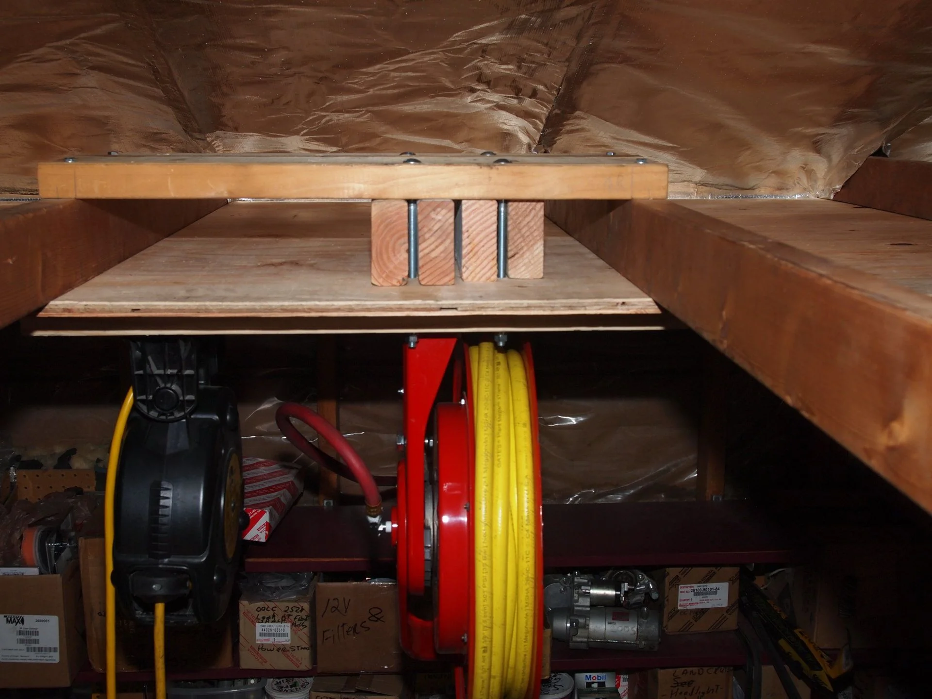

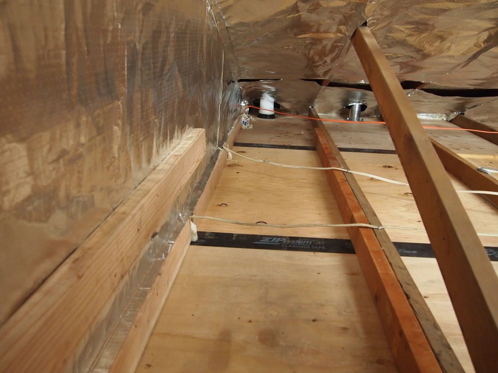

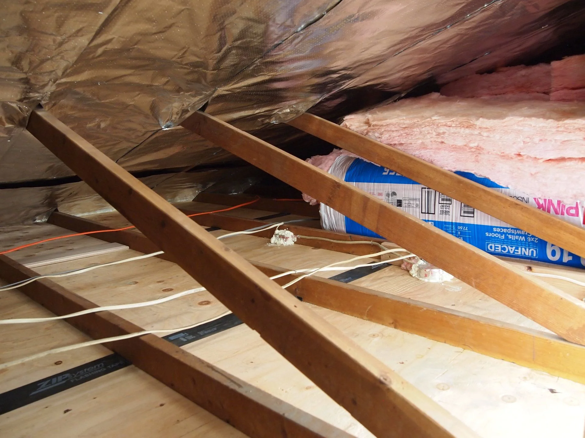

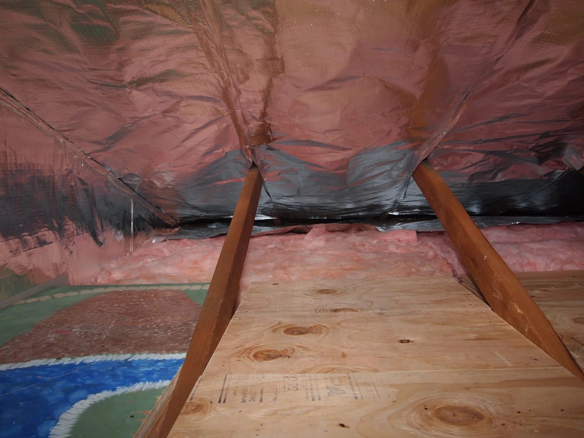

Took most of winter researching, buying materials and install heat in my shop. This included learning how to run new Nat Gas line and tooling up!. Which as I learned proper configuration, found my utility room was configured wrong. Re did utility room gas line and ran line further to my shop. Installed radiant barrier on underside of roof (summer temp hit 110 F in shop last year and shad tree dying), 5/8"plywood ceiling, electrical, hose & cords on ceiling, insulation up to R55, tape & foam in gaps.
1951548
1951549
Built storage with scrapes wood, ton of parts up there now.
One of the really slowing factors was all the stuff I had/have in rafters and shop. Moving stuff including two engine torn down, all the time moving really slow job. Took 45 day to get done, man am I slow and it was cold until last ceiling piece put in. I was heating all of Colorado until then. Then running wiring and hang stuff like shelves, reels, door hangers, etc. That 55' of a very heavy 3/4 air line and top of line reel About 120lb I est.
