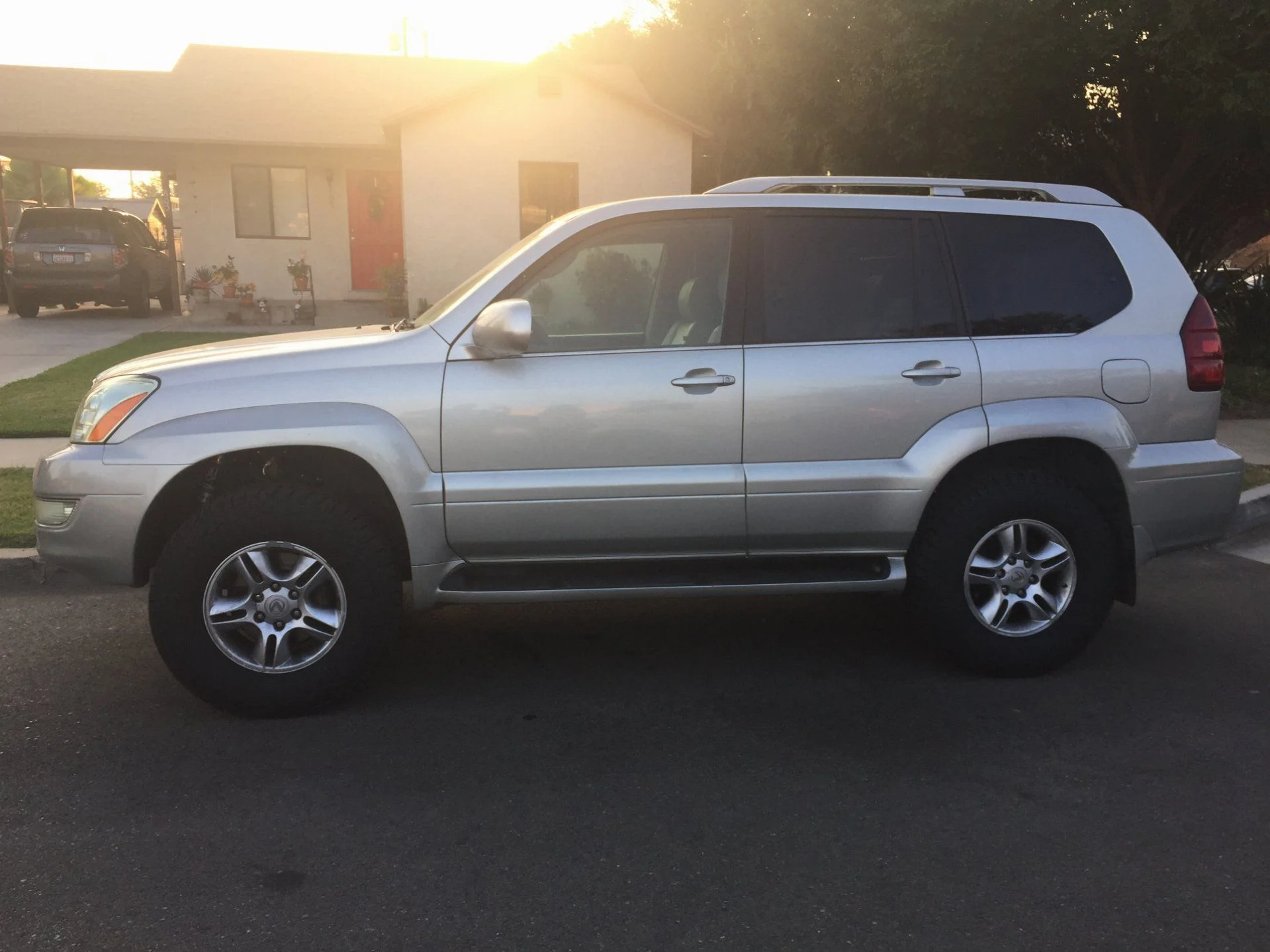

i had the shop set the caster to 4* to fit the 285 70 17 falken wildpeak at3ws. According the falken website these are 33" exactly.
I need to do some fender liner movement, but all is well. Also, time to rip off those side steps and see if my 5th Gen T4r sliders will mount up ok.

View attachment 1527141 i had the shop set the caster to 4* to fit the 285 70 17 falken wildpeak at3ws. According the falken website these are 33" exactly.
Nice tires, I was trying to get some of these when I was shopping for tires but they didn't have any left in my size.
