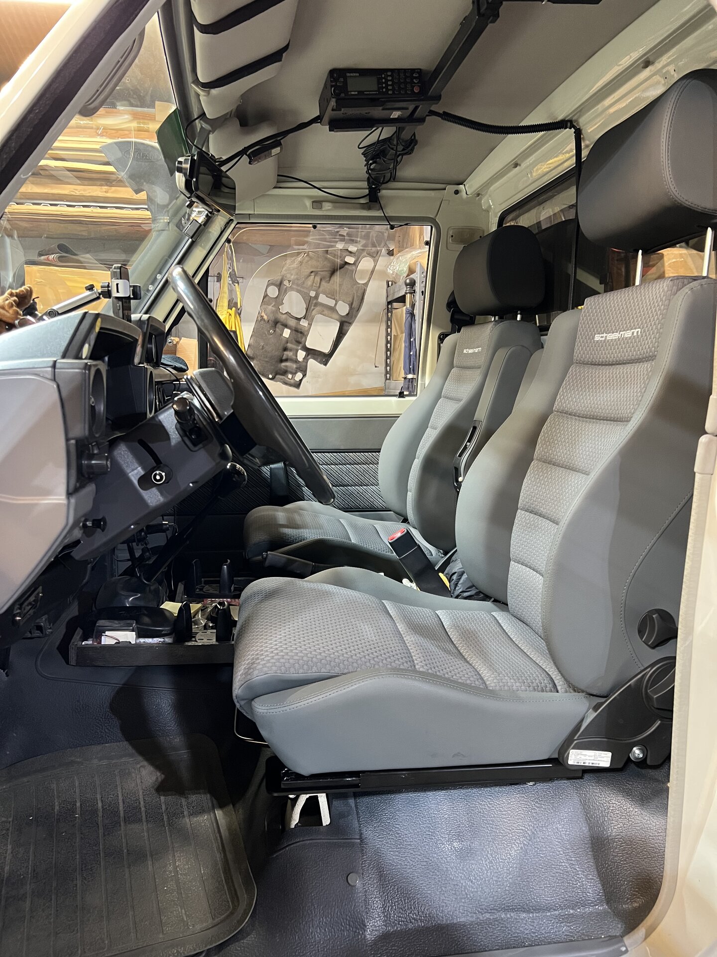

Anyone have a Scheel Mann VarioF in a 75 series? I’m wondering how they fit in the smallish cab.
The "Sportline " seat is 2" thinner on the seat back by eliminating the lumbar. That may or may not be a big deal to you. They may find their way into my fj45 someday to gain some room. I have the Vario XXL in my 61, if you want a thickness measurement at any point on the seat back, let me know. They are near the top for mods I took a chance on and won big in satisfaction
I have set in my 60. The best. We are going to try one in this 75 I have coming. The owner likes to sit more upright that I do. I think it will work out.

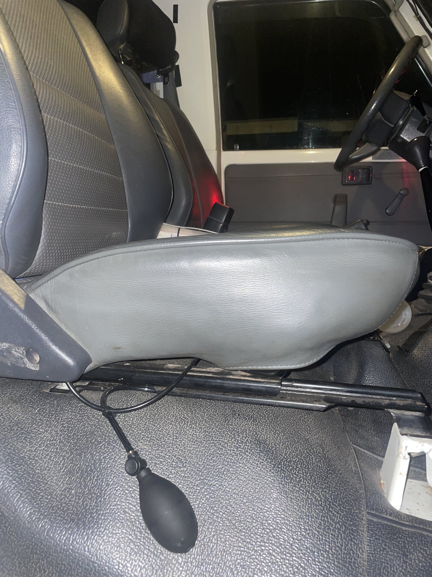

Please allow me to add some experience at an angle, so to speak.
I've kept the original seats, but:
I've had a shop look at them where they make hand crafted solutions for handicapped people. I simple asked what they would advise.
The specialist there started with telling me that the chairs were fine in principle - no need to consider any fancy stuff.
He did observe that some steel links in the driver seat were broken, so that was an easy welding repair.
The main thing was, he added small inflatable/deflatable cushions at the lower back of both chairs, just above the hips. They each consist of three interconnected air bodies, plus a hand sized bellow to inflate te cushion and a push valve to let the air out. We are therefore able to adjust (while driving) for fatigue, individual preference etc. The interconnected air bodies let the air find the right spot where the back is most hollow.
Last year we've made a journey of over 10.000 km travelling on and off road, and the chairs are excellent as they are now.
My wife's back pain had vanished from the first hour driving and has never returned.
Paid just €500 for the job.
In total.

Do you have any pictures of this? It sounds like a cool idea and it make a lot of sense to be able to customize it over time.
I wish I could make this more impressive to watch, but from the outside this is all there is to see. In de back of the chair you have to imagine a plastic bag about 25 cm in height consisting of three horizontal compartments - also quite unassuming. It works.

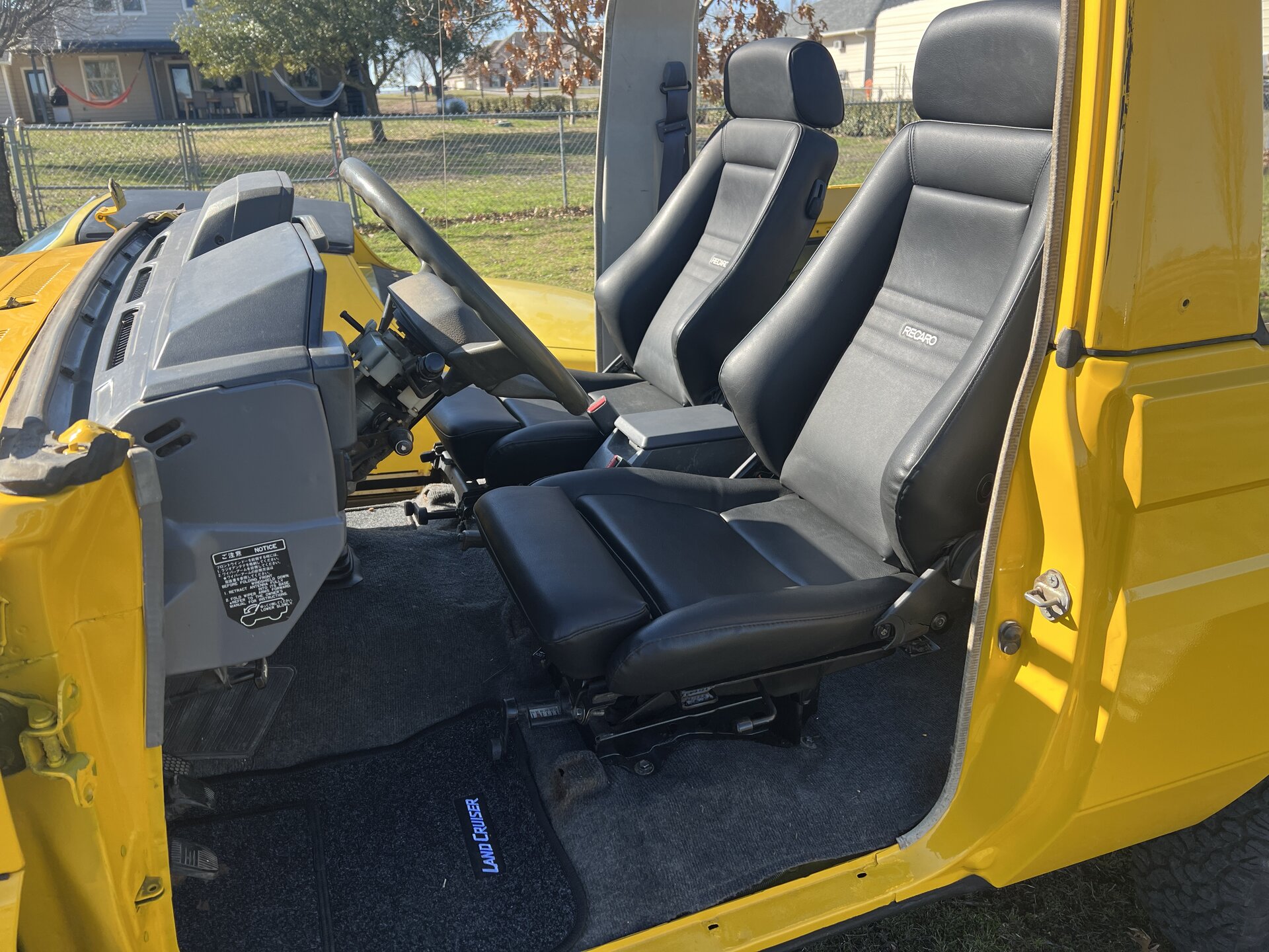

Haven't read all the thread, but scheel mann seats was very difficult to test-seat-drive, the dealers in Europe behave like they are dealing with gold, delivery takes months, and custom changes (no logos please! and same color as vehicle interior) cost quite a few dollars extra.
Instead I went with Recaro Specialist M and Delta Bag seat covers on N4 offroad consoles. Plug&Play. It's much cheaper than SM and readily sourceable. The Recaros are also lighter and thinner, which you may consider in the single cabin pickups.
To me this is a clear case for the Recaros and against Sheel-Manns.
Wow, I just got another set installed in my regular cab Tacoma not long ago and I was kinda afraid of this outcome initially but I have slightly a bit more room to tilt mine back and can make adjustments. Looks like you have zero room in that ute.
Did you keep these or swap them out?
