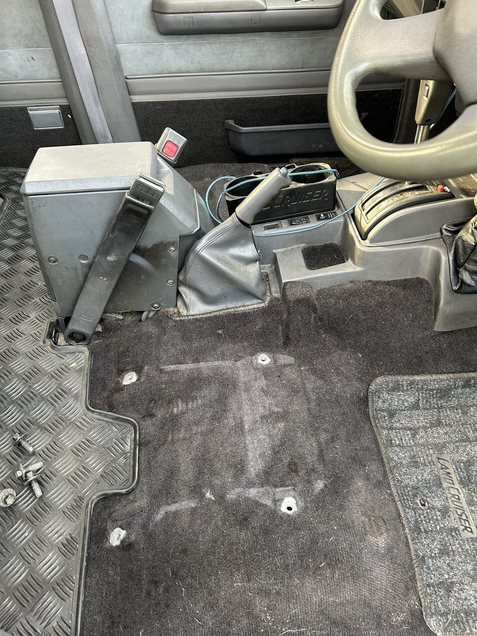

Removed the old seats and did some cleaning:

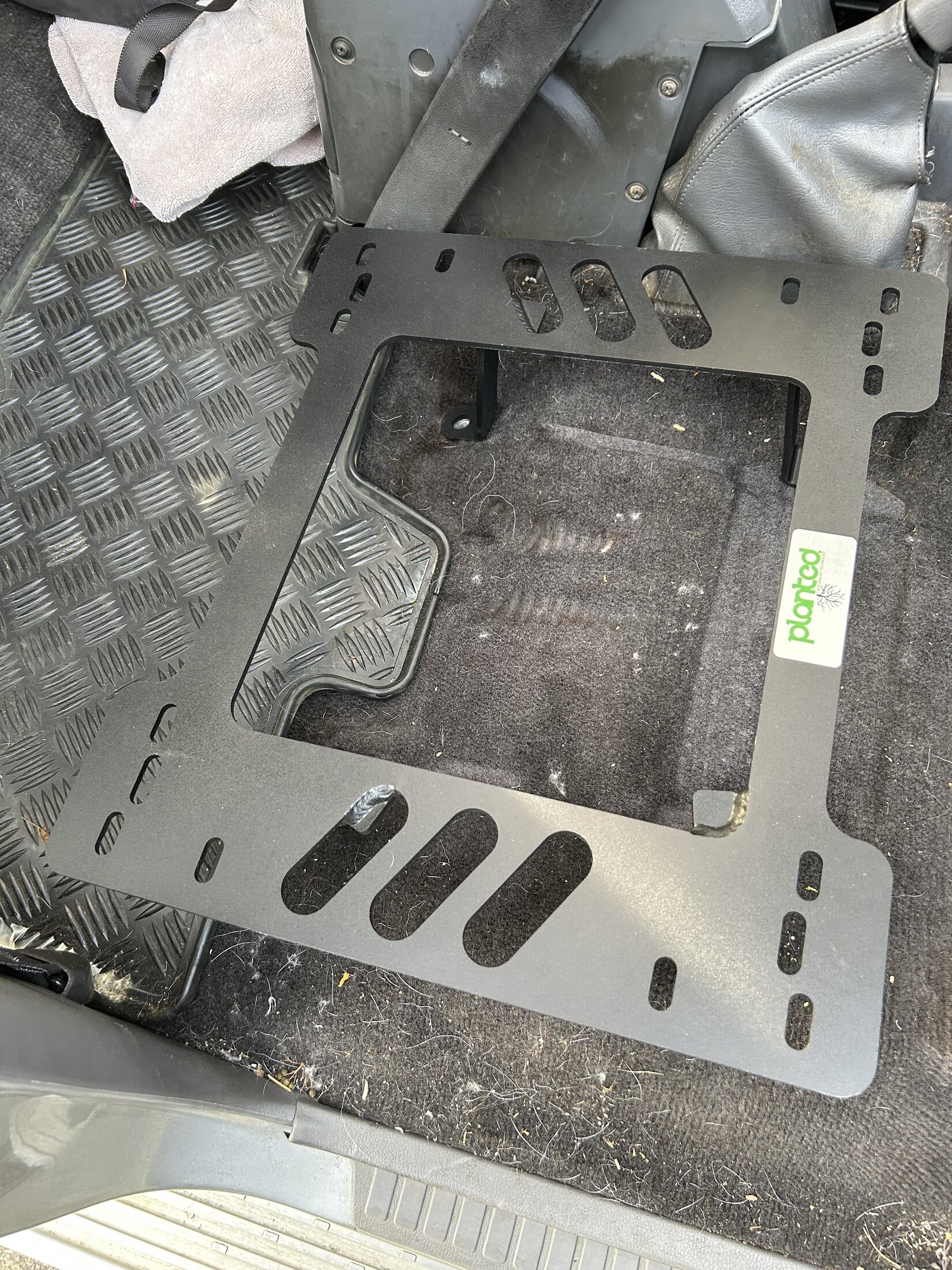

It's a good idea to test fit the new seat bases so you know which is right and left and which side is front.

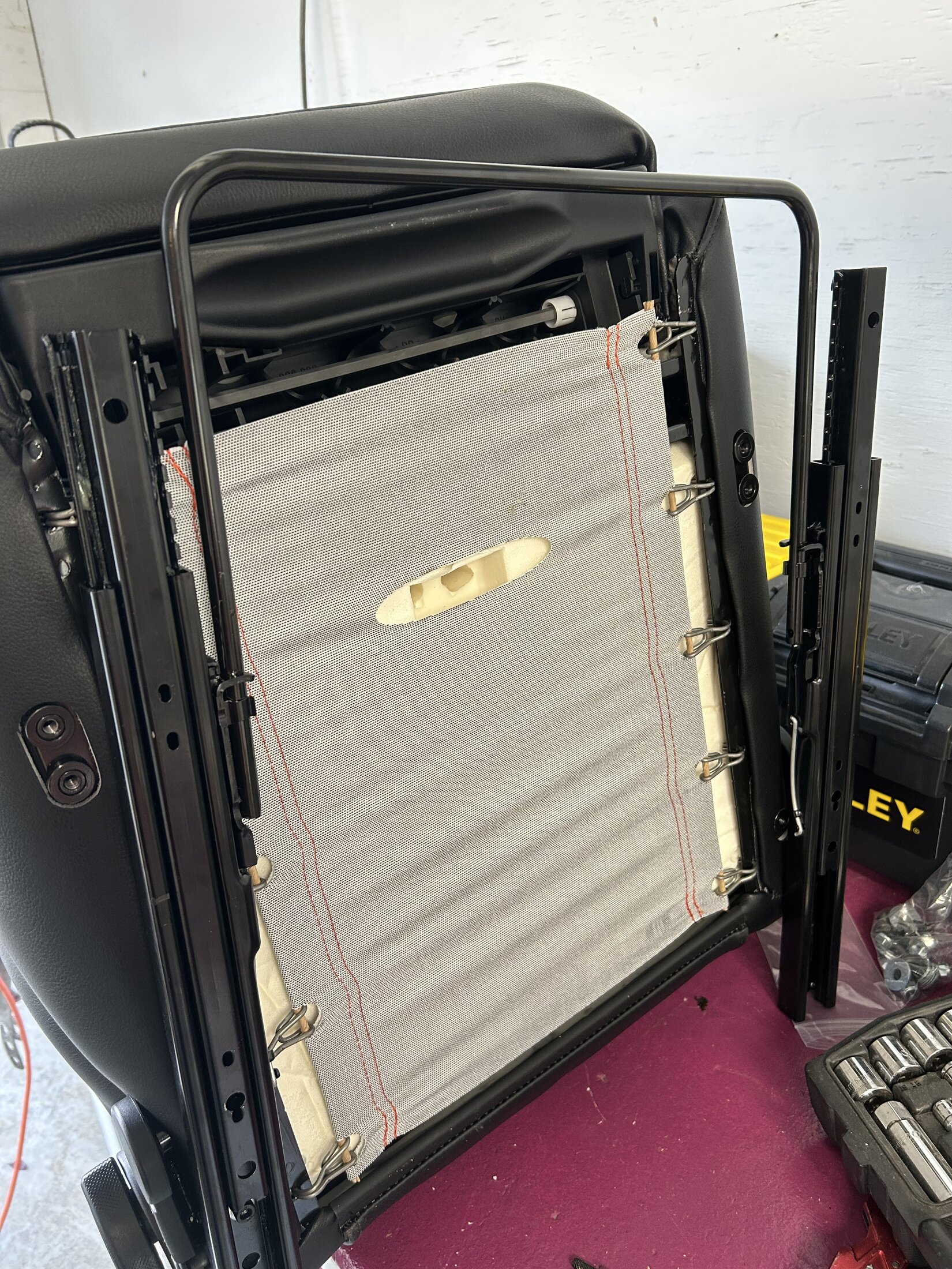

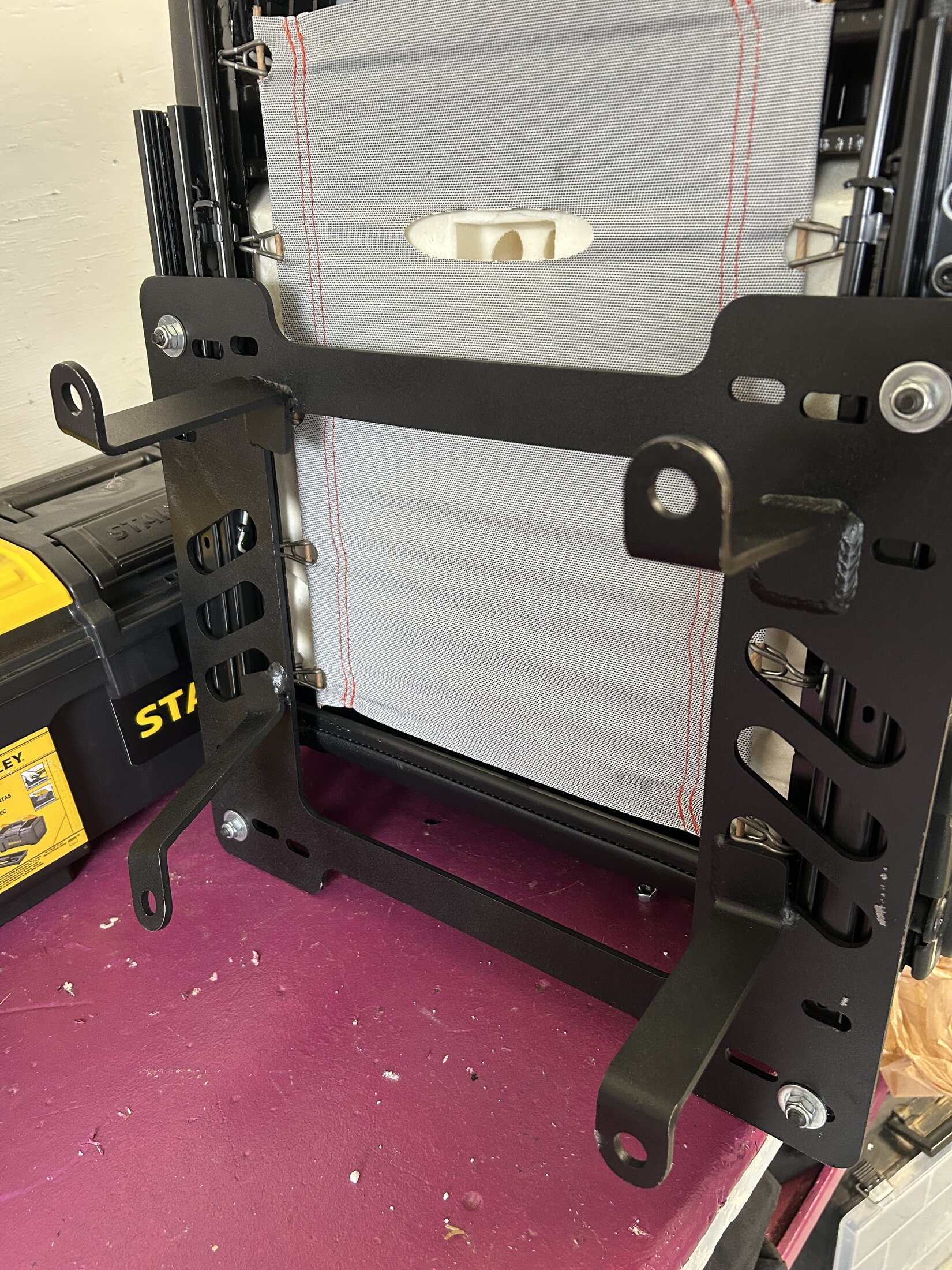

Recaro's instructions for attaching the sliders to the seat are adequate. I recommend attaching the adjustment bale to both sliders first before bolting the sliders to the seat.
When attaching the seat base, be sure to run the sliders back and forth a couple of times before tightening up the bolts. Otherwise it might bind due to misalignment.

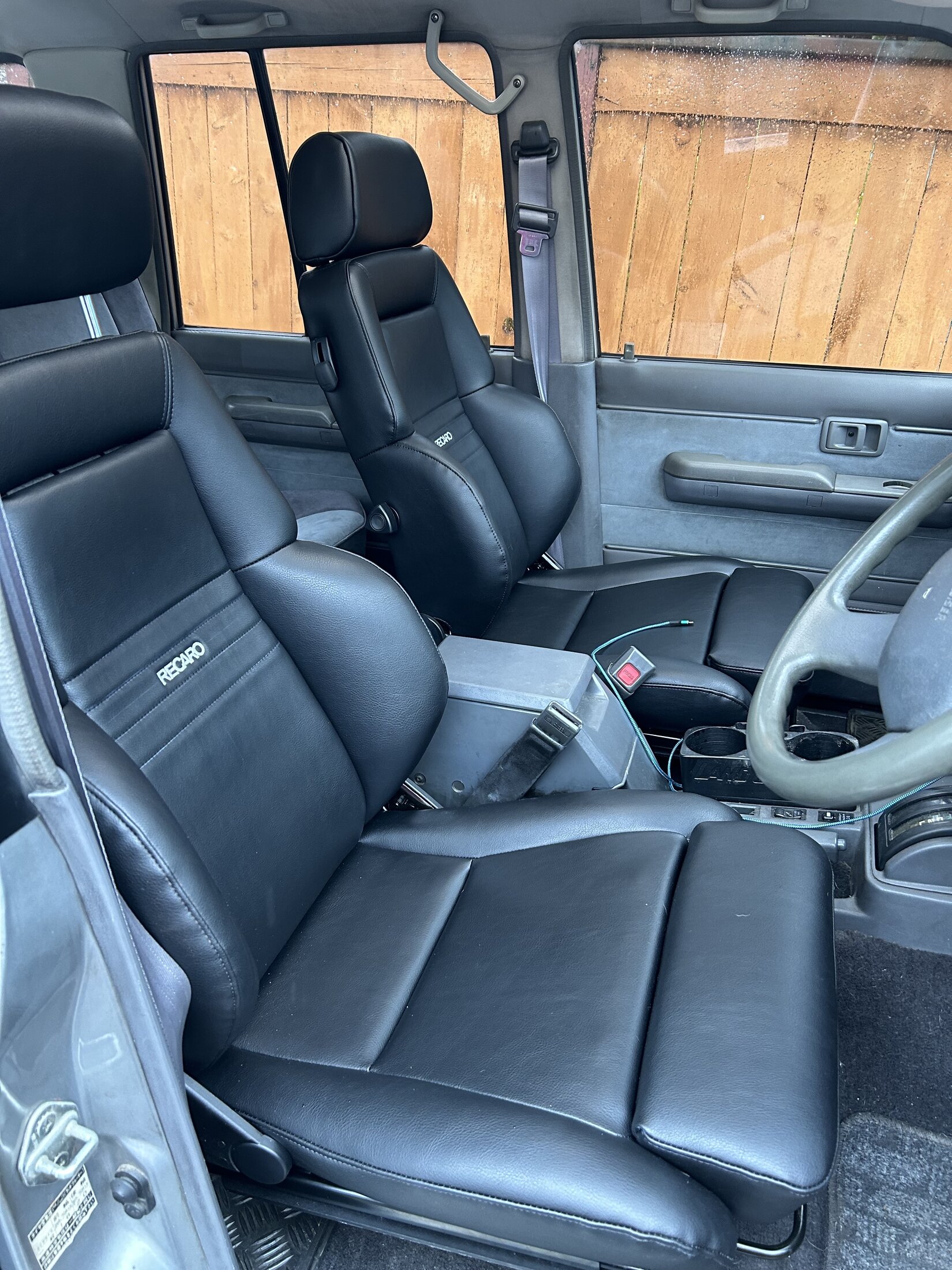

Then they're ready to bolt in!
The whole operation took about 2 hours, including numerous social media breaks.
Verdict (so far): Still getting used to them. I had the height adjustment of the old seats locked at the highest setting just to keep my legs from pressing up against the dashboard. The height of the new seats is a little lower than I'm used to, but the slider moves the seat back farther so my legs are more comfortable. The steering wheel feels farther away, but I can get used to that. Best of all, no more deep vein thrombosis on long trips!
