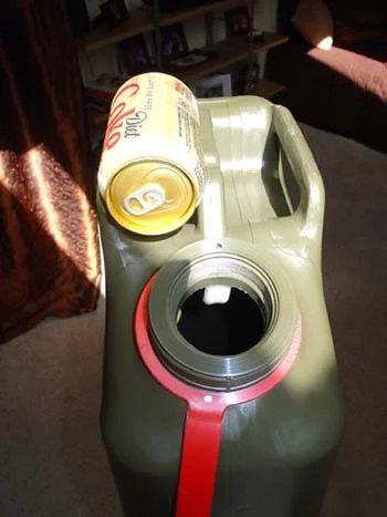

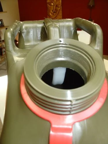

Scepter MFC meets all these CARB requirements except for #2 and maybe #5. For #5, if the walls of the MFC are not low permeation, then Scepter will have to change the plastic formulation of the MFCs. For #2, the design of the cans follow the traditional jerry can, with a built-in air vent to prevent splashing and increase flow rate. See the small hole in the wall of the opening thread and the vent tube beneath it

The design of the spout leaves the air vent open, allowing air to enter the air tube to increase the flow rate and prevent splashing. See under side of the spout.
Notice that there are no O-rings in the spount and the 5 holes allow air to enter the vent hole. This is in direct violation of #2 requirement above, where CARB spouts must have an internal vent inside the spout, allowing the air to exchange between the portable fuel container and the vehicle fuel tank.

The Non-Carb Blitz cans have a hole in the flat area around the threaded part of the can. This allows the can to draw air as the fuel is depleted. The pour spout uses a smaller gasket and allows this hole to be open when fueling. The CARB cans do not have this hole and they get air from the internal channel in the spout. When the cap is installed, the hole is covered with the larger gasket on the cap.
