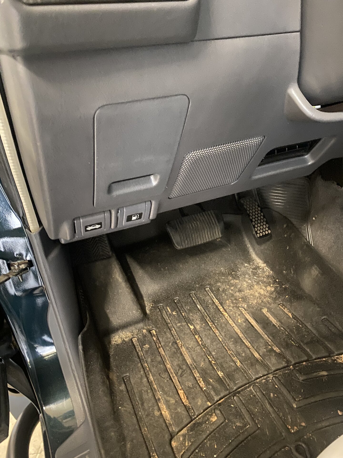

OBD II connection: Remember to re-orient the plug facing down. Remove bottom panels and route wire under dash and through to the ashtray location.

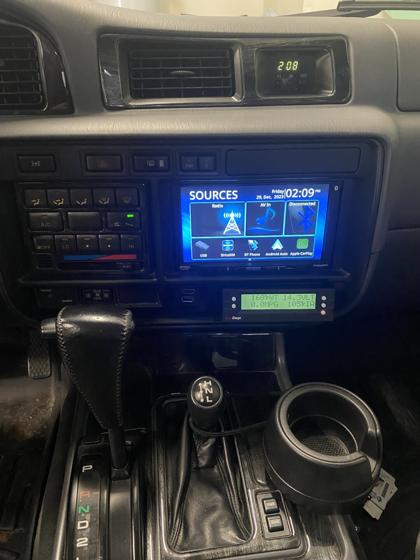

Drivers Seat View
http://farm8.staticflickr.com/7012/6697309937_fdc9842326_z.jpg
Passenger Seat View

Drivers Seat View
Passenger Seat View
