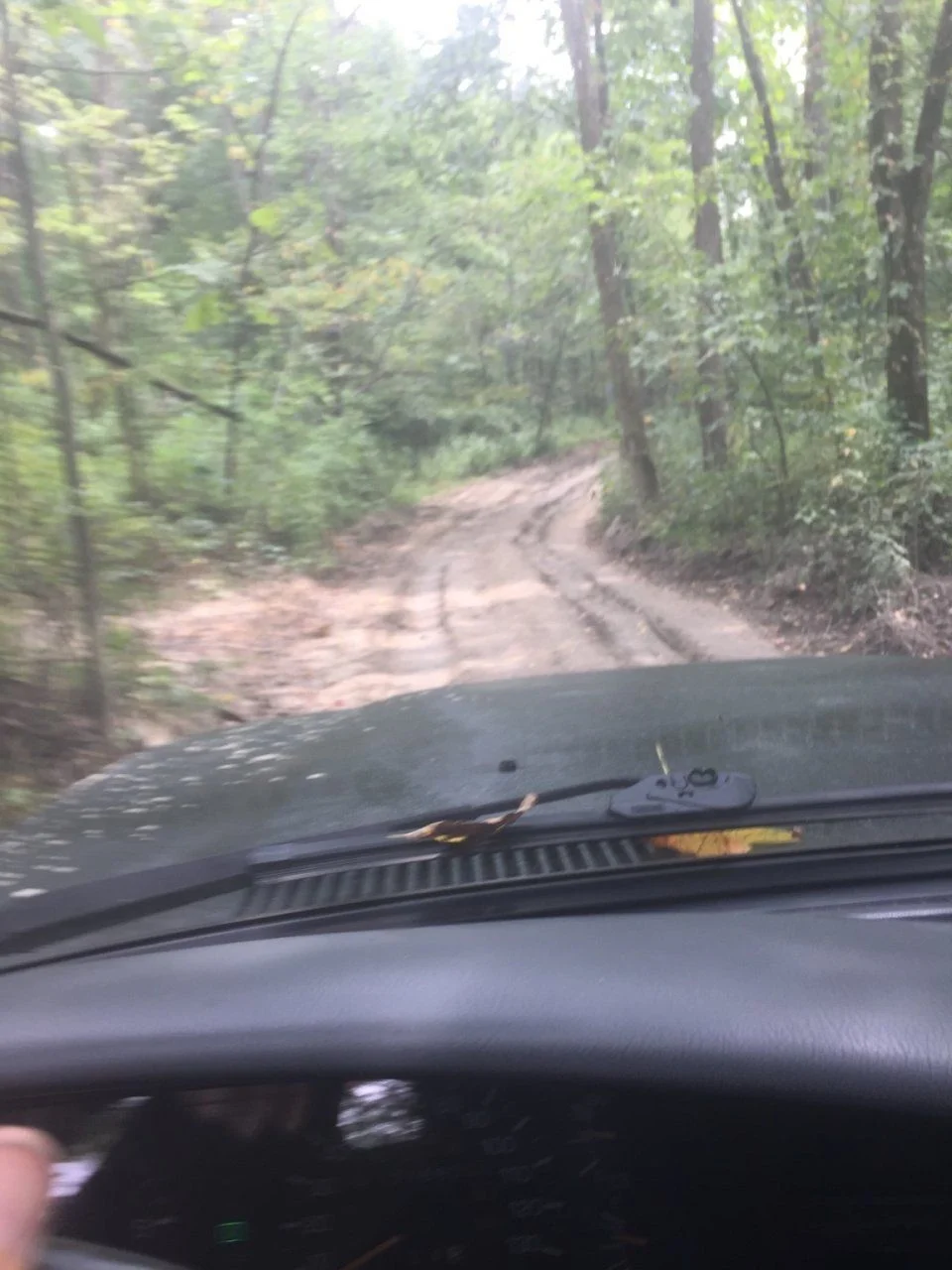

I still have more pictures and some videos I have to upload. I was really impressed with the 80. This was my first time taking it off road. It did really well for having stock road tires on it. Airing them down helped. The first hill we climbed the wife said it needs a lift and larger tires. Gotta love her. The j springs and 35s. I need to extend the breathers and water proof the distributor. I would also like to add a snorkel.

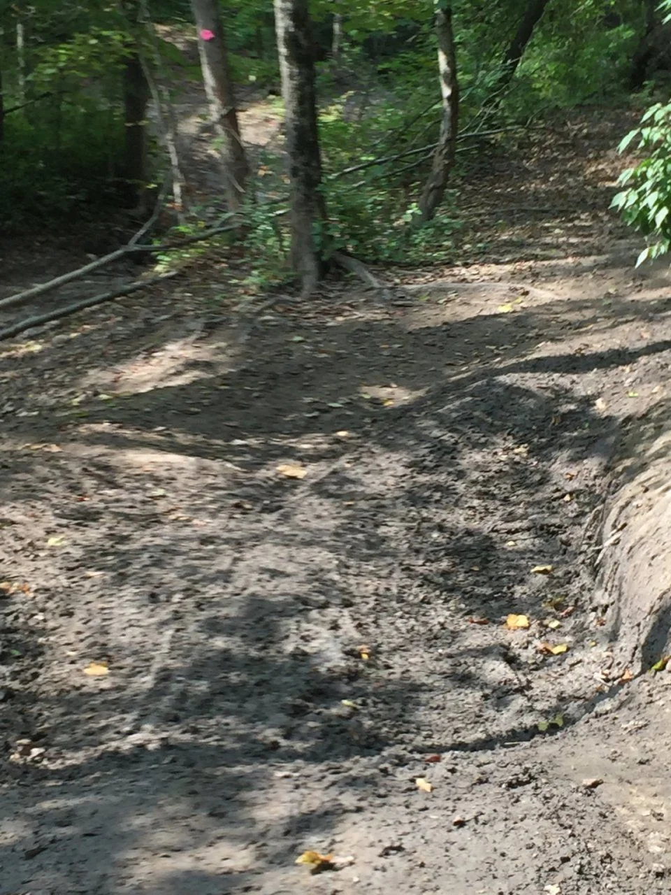

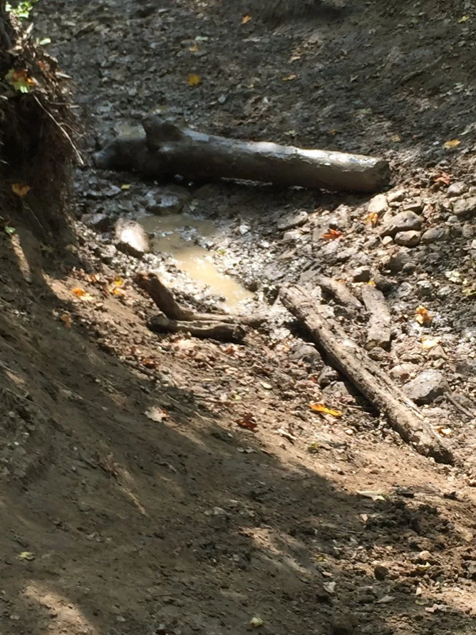

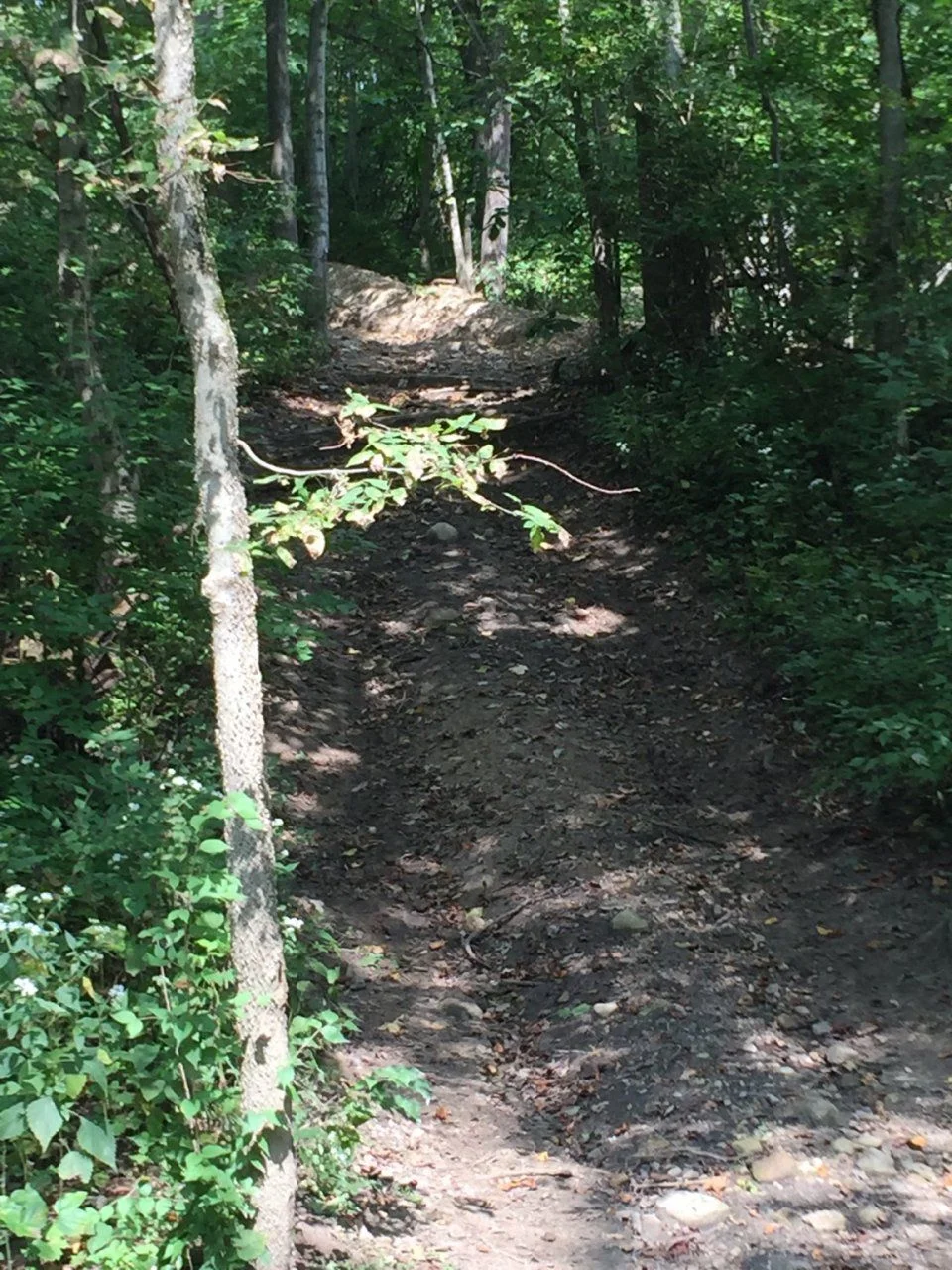

Went to cliffs insane terrain today. The front locker is not engaging but I am really impressed with the 80. It was able to do things that I was hesitant to try. Besides the spare and hitch bottoming out I had zero issues. It is time for a lift and tires.
Cliffs insane terrain 9/7/15

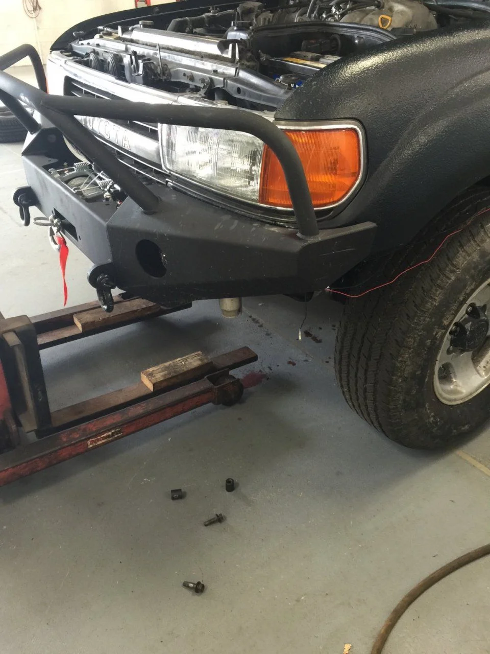

Turns out there a hole in the return line for the power steering. I decided to get rid of the cooler and add a trans cooler to the power steering with new hoses.
